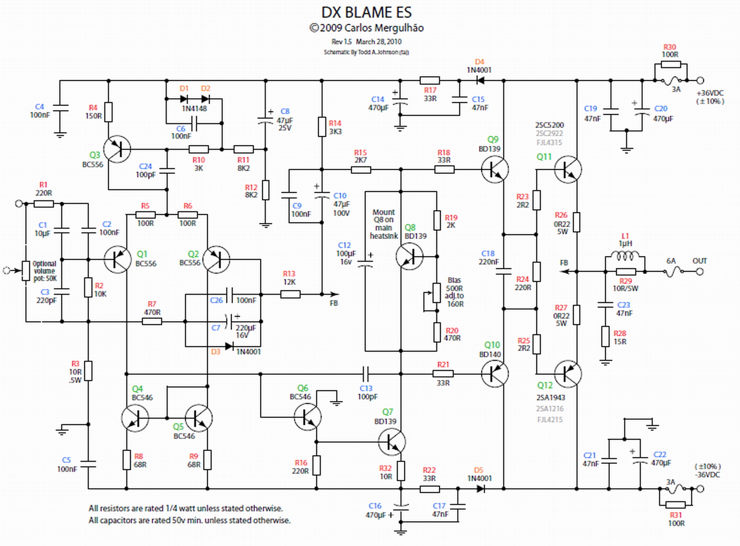

Logic is to watch these schematics and perceive they are almost the same
Small modifications, all them tested in several amplifiers.
One is the Dx Blame ES/ST, the other one of the blameless designs from Doctor Self.
Are you really saying Doctor Self has made a bad amplifier, with flaws and defects?
Really?
That's ridiculous.
regards,
Carlos

My philosophy is to design amplifiers whose internal bias currents don't depend at all on supply voltages (within a reasonable margin). This is mostly the philosophy in use today. Expending a few extra dollars in some transistors to get all currents well controlled is worth the effort, not to mention all the measurable improvements in amplifier output signal quality.
But consider that some people fear the complexity of using more transistors because they already have trouble getting the circuit right with a few ones. If you can't get a current source stable (no oscillations) or a complimentary VAS right, then bootstrapped VAS is for you 😉 It's not as "clean" but it's really fool proof 😀
All these notes come from experience, it's not preconceived belief.
Thanks Eva, I always enjoy your technical contributions.
Your design philosophy is what I imagine 99.9% of professional engineers in the commercial arena would have. It makes perfect sense to me.
I think it is actually easier to design an amplifier with multiple constant current sources because as you state it allows greater tolerances in the PSU and tends to isolate each stage to a greater degree. It wasn't till I was playing around with a simulator that I realised how sensitive to PSU and resistor values the basic non-ccs circuit is.
But here in DIY land we are not bound by professional, commercial or even logical design criteria. We are free to do what we like. 😀
Really?
That's ridiculous.
regards,
Carlos
You're right, it is ridiculous 😀
There were times when people believed that something as small as bacteria could not pose a threat to human health.
Many people died because of this preconcieved belief.
(Of course nobody dies because of your amplifiers - please, misunderstand me here 😉 )
Even the little things can make a big difference.
And we are just looking at the schematic level here.
Self pointed out, that the schematic, that you quote, alone does not make the blameless a good amp.
You can still ruin everything with a bad implementation/construction of this very schematic.

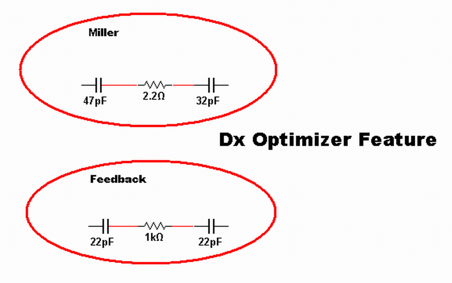

You know.... i am working now..... and i will present you a Dx Optimizing Feature (DOF).... these resistances in series with capacitors...picture may show you..also you may see a small inductance and a tip of wire... all this works together and result in better results to my amplifiers.... the DOF will be applied in all Dx Amplifiers.
Also, i would like to say, i have my portable engineer..this ones works for me...makes me not need the envy platoon help...i do not need you... i have Doctor Self and the Green engineer you see in the picture... this one does not discuss, does not complain, do not criticise and give me all the answer i want.
