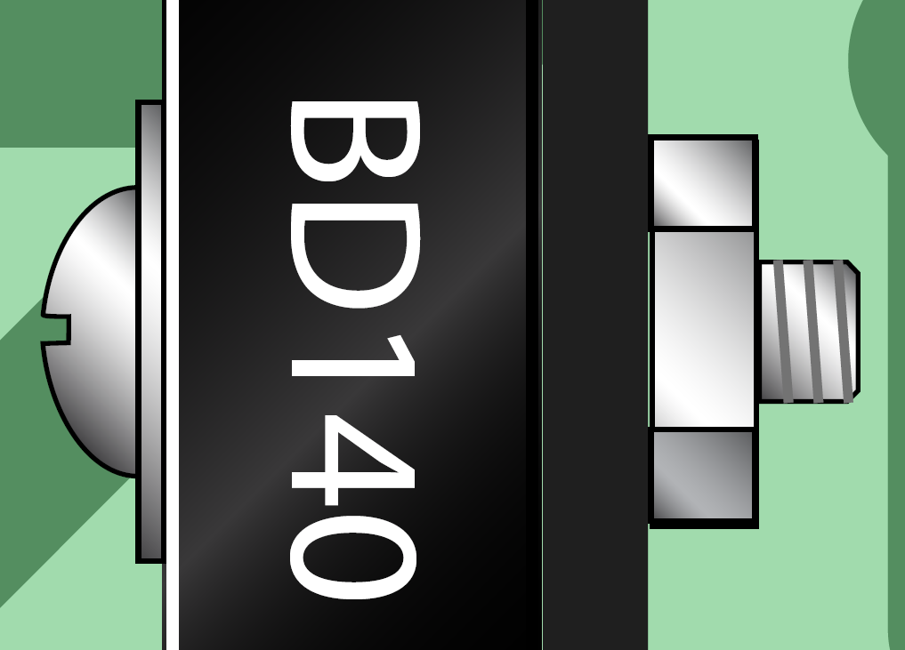

Carlos. You don't understand. That artwork file is a very complex vector based file. It cannot be reduced. You can make low resolution pictures of it all you like and show sections of it, but that is not my drawing, just a picture of my drawing. A PDF file is a container that can contain low resolution pictures, like the ones you have created, or it can contain vector-based (infinite resolution) drawings like mine. They are very different.
If anyone wants the real (vector-based) file, they will have to email me. There is no way around that. If people want the low-resolution pictures, the ones you have created are available in your previous messages.
This file is not necessary for building the amplifier. It's just a drawing I did for my own fun. I don't care if it's on this forum or not. It's not important. I'm sure you disagree, but that's life.
..Todd

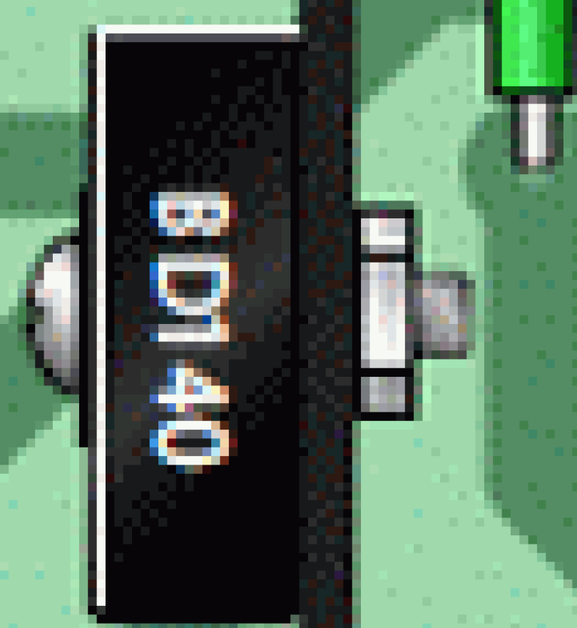

this is the best i could..without lose quality.
Yes, you did lose quality.
Zoom in on yours then zoom in on the real one. The difference is obvious.
But it really doesn't matter. It's not important.
..Todd
Hey Taj, I recognise your hard work in creating this drawing. As you have mentioned, it is not necessary for building the amp. If one wishes, the high resolution picture can be photo-framed or layers can be screen printed to create this picture on the top cover of the amplifier, perhaps, with another picture of the schematic.
However, one thing that would be useful is to post a good quality pdf file of the PCB track pattern alone (instead of combining the artistic view of the whole amp on the same pdf page). Better still is to have two images of the track pattern marked as L(eft) and R(ight) so that people can roll their own PCB through the ironing method from a single sheet of laser print. Thanks, all of you for your tireless efforts.
Sadly, the 'art' file is too big for both this forum and Greg's DX website. It's really not very big, but certainly over the limit at 460K. This updated and corrected version of the drawing offers 'layers' in Adobe Reader, allowing you to hide/view different component types. For example, you can hide everything but the resistors, if you want to see them alone on the PCB. That may be helpful to view while populating the bare board.
If anyone wants it, just contact me via email. (Click on my username, to the left of the Canadian flag.)
..Todd
Hi Todd, even though I said it was too big, I still uploaded it. All that will happen is it will be one of the first things deleted if I run out of space. So everyone can get it now. 😀
