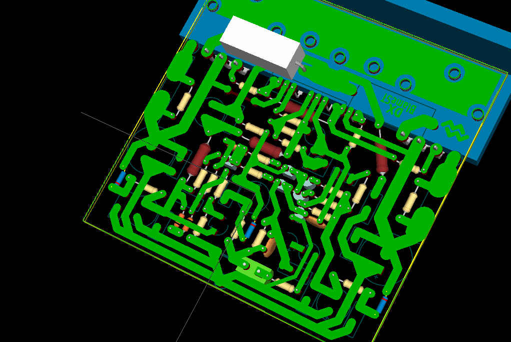

Dx Blame ES .... based into the Blameless, i am trying a new amplifier
@Dudaindc,
the marriage between my BlameES and my "DIY - PreAmp" will be soon.
So far: everything works as designed.
Allthough Stefan Dreyer's DIY - PreAMP also contains a relay-board
I will assemble one by myself because I do not really need 8 sources (too big for the back-panel of my wooden enclosure)
and I want the RCA plugs alone to be fastened to the back panel and will run wires to "my relay-board" - but of course
will maintain Stefan's schematics to control ""my relay-board" with the µC.
@Carlos:
You know what I like: sound, sonics.
I will finish the BlameES - the best one I ever heard.
I will of course use "my design" of the PCBs.
This PCB-design (incorporating the PSU and a LS-protect circuit, drawn with MICROSOFT's PAINT program) plays "rock-stable" since more than 3 months at Volker's home - and it sounds "like a divine".
This is the BlameES - thread.
Maybe: there will be a "FOKKER" thread.
And maybe: I will ask Stefan Dreyer to publish his "Universal Pre-AMP" - a GERMAN DIY - project, an absolutely "MUST-HAVE" - in this forum as well.
Best regards - Rudi_Ratlos

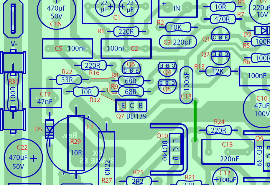

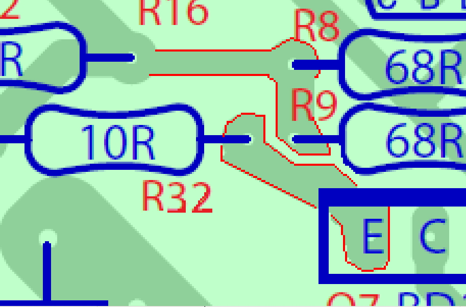

No!..it is not dear heinz..thank you very much to point the mistake
I am turning very old.... i could not see that..also Todd Johnson, and he is much younger than me.
Will be fixed.
here some images.
regards,
Carlos

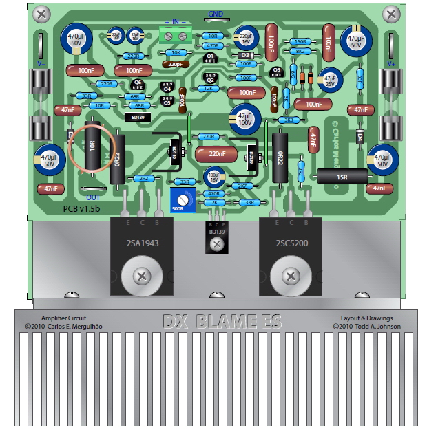

Thanks Heinz. I am getting old too. Catching up to brother Charlie. Need stronger glasses and stronger vitamins.
Here's the updated drawings (PCB and layouts rev. 1.5b), including the updated copper and BoM this time. the schematic hasn't changed (still 1.5) but I included it here again just to keep things organized.
Sorry for the confusion. Hopefully no more mistakes.
..Todd

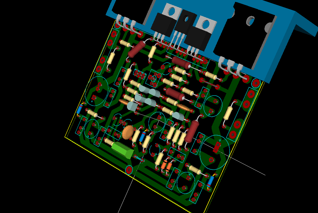

I started and assembled the right channel of my BlameEST - my "Rachel Board":
Some of the parts (power capacitors and MICAs) have gone out and I have to drive downtown to Hamburg and buy some.
But I will finish tonight/tomorrow.

Here you have.
This helps a lot after construction, helps to check when building, and after you build will be an excelent tool to check if have assembled parts correctly.
Sadly, the 'art' file is too big for both this forum and Greg's DX website. It's really not very big, but certainly over the limit at 460K. This updated and corrected version of the drawing offers 'layers' in Adobe Reader, allowing you to hide/view different component types. For example, you can hide everything but the resistors, if you want to see them alone on the PCB. That may be helpful to view while populating the bare board.
If anyone wants it, just contact me via email. (Click on my username, to the left of the Canadian flag.)
..Todd

This is a pitty Todd.
Forum is much more important, so, you should have made them in separated files... and i think you have the master ones to convert to pdf...this will allow us to post.
Also, i am afraid will be a problem to Greg....he used to reduce image size in the past..maybe to save bandwidth..well..he can talk by himself.... i do not know his know a days connection and size of memory he can use.
Greg site is super usefull and important..but forum..here is the main advertising site for DIYers..here we need the good image first.... after people felt passion watching your image, then they decide to build and last they go to the site to collect details without the need to read all thread.
At least, this is what is happening those last years.
regards,
Carlos
