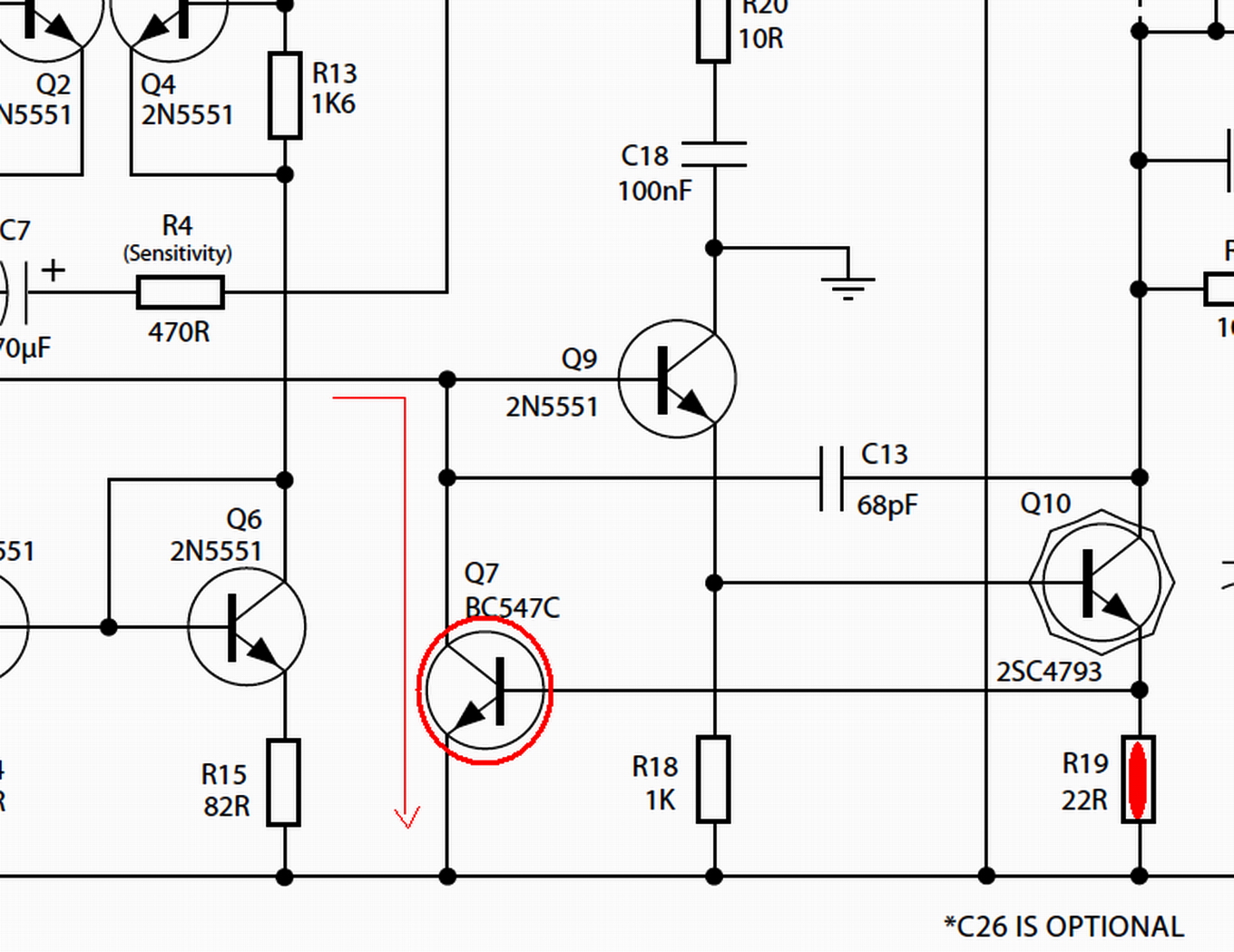

In the full power sweep video, clipping behaviour is completely abnormal with heavy sticking to the negative rail. This can cause the amplifier to self destroy. Current limiting the VAS will most likely solve this, as already pointed out several times.
Andrew T and some other forum friends have criticised the absence of
limiter installed to the VAS.... i have told them, several times, this was tested (in this case was the Precision 1) and the transistors have survived to all torture i could make.
But they have insisted a lot.... came other, and more other...and them a group of forum friends were there making audio electronic terrorism, saying gonna explode...they are always the same folks.
Happened that i have perceived builder candidates where going to be scared to build...because of that i give up to defend my point of view where i was saying this produces harm effect in dinamics.....this appear clearly limiting power peaks.... amplifier turns lifeless...the best you adjust the threshold of action, having huge currents (huge power), the hell thing will drain current to the negative line...and this seems reduce the level.
This time, i will not accept their pressure..they can come in groups of hundreds and i will not suggest your to install the limiter.
Here you have the image, the hell limiter that reduced, a lot, the Precision 1 performance..... it is up to you....not suggested...not with my appointment.
Those guys are not flexible..they have theories and books alike bibble...we cannot go against because they come to defend these things...and they communicatte one each other..they come in groups..the boring platoon.. i really think they have never tried with and without these things...if they do that..they will finish with this boring conversation.... the amplifiers these three most boring folks design may be very bad in sonics...i have built one, from one of them.... terrible..... the problem is that they watch scopes and do not bother with listening tests...so...their scopes and themselves feel good...but when you play...aaaaagh!
Almost fifty folks have built the Precision 1...they have not complained.... i was lucky they have removed the protection by themselves.

I do not know Andrew..... take a look at the schematic, i think you are able to
calculate this, and fast, and without the need of a handy calculator.
It may be in between 5 to 8 miliamperes...this is the current i love to use in the VAS...my prefered one is 7 miliamperes.
We need much less..but i think some reserve may be interesting.
This 22 ohms value was your suggestion..from 15 to 22 if i can remember.

Waveforms on oscilloscope usually reveal many potential amplifier failure modes.
Also, I used to check bias stability by making the amplifier play loud for some time (to produce some heating) and then immediately removing the signal and the load and measuring voltage drop across emitter resistors. This test may give some surprises on traditional designs, where the bias deviates a lot from the expected value when outputting some power (as much as 10x with the corresponding stress to output devices). That led me to use a two transistor Vbe multiplier and experiment with sense transistor/diodes placement.
An amplifier with traces of instability near clipping is a blown amplifier. This partial instability may turn into full destructive instability randomly depending on temperature, load, supply voltage and the batch of transistors used. Midrange and trebble transients will make the amplifier clip for very brief periods of time when playing loud, that's not hearable at all, but is enough to trigger oscillation and kaboom 😉
I believe all your designs suffer from that problem because you have never cared about it until now.
Any trace of instability means less than 0 degree phase margin, which should always be at least 45 degrees.
Oh, are you still ignoring my posts? I have many many lessons to teach you about making class AB amplifiers work as expected. Translating simulation circuits into real circuits is not a direct process, models are not accurate. Then we can start with class D 😀😀😀
Sorry Carlos, but schematic posted in 1068 ("precision") shows that You are gain repeating the same mistakes. Using BD140 (Uceo max. 80V!) exposed to voltage swing about 110V is more than 30V over allowed rating, destruction is very near..
Capacitors C23-C25 are in wrong placen (should be paralel to R27), they supres unction of base stopers resistors, again potentially instability.
C26 is "must" not optional. 2SC4793 is not suitable or VAS (it is driver..) too big Cob, R24, R25 bypassed by capacitors have no sense,Q7 will not save Q9 at overdive (this configuration has sense in amplifiers with overcurrent protection), whole current (needed to activate Q7) to R19 will flow thrue base of Q10 (no chance to flow via colector Q10), so Q9 is exposed to Pc about 1,4W..And Q7 is source of local instability (local NFB acting against global NB..) No output inductor means again instability with capacitive load (amplifier with relatively strong overal NFB). Fuse in output, causing distortion at LF (fuse resistance thermal modulation). CFP input (potential for slightly lower distortion), but no CSS for input dif. pair... And here are much more mistakes, but You will not hear it.
Eva is 100% right, Your videos shows very heavy stability and recovery problems after overdrive. So, i suppose, You will ad me to block list..but your amplifiers do not stop to blow.

Here is the Precision 1 schematic.
BD139 is working here with plus and minus 55 volts.
It is 80 volts by specifications..must turn your mind a little bit more flexible..this does not means with 81 volts it will burn...that is guaranteed voltage..of course, factory is not constituted by idiots, and the transistor, for safety reasons, can withstand much more voltage.
