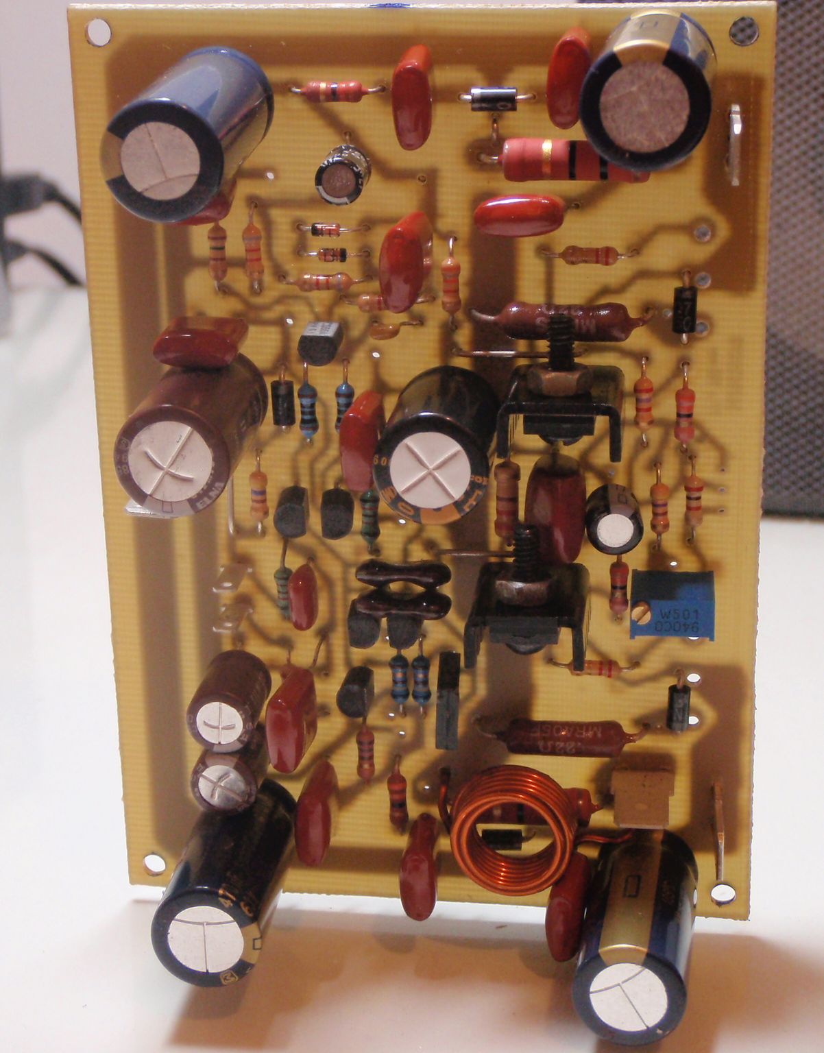

Nice board Sound..... pretty picture, beautifull construction
thank you very much.

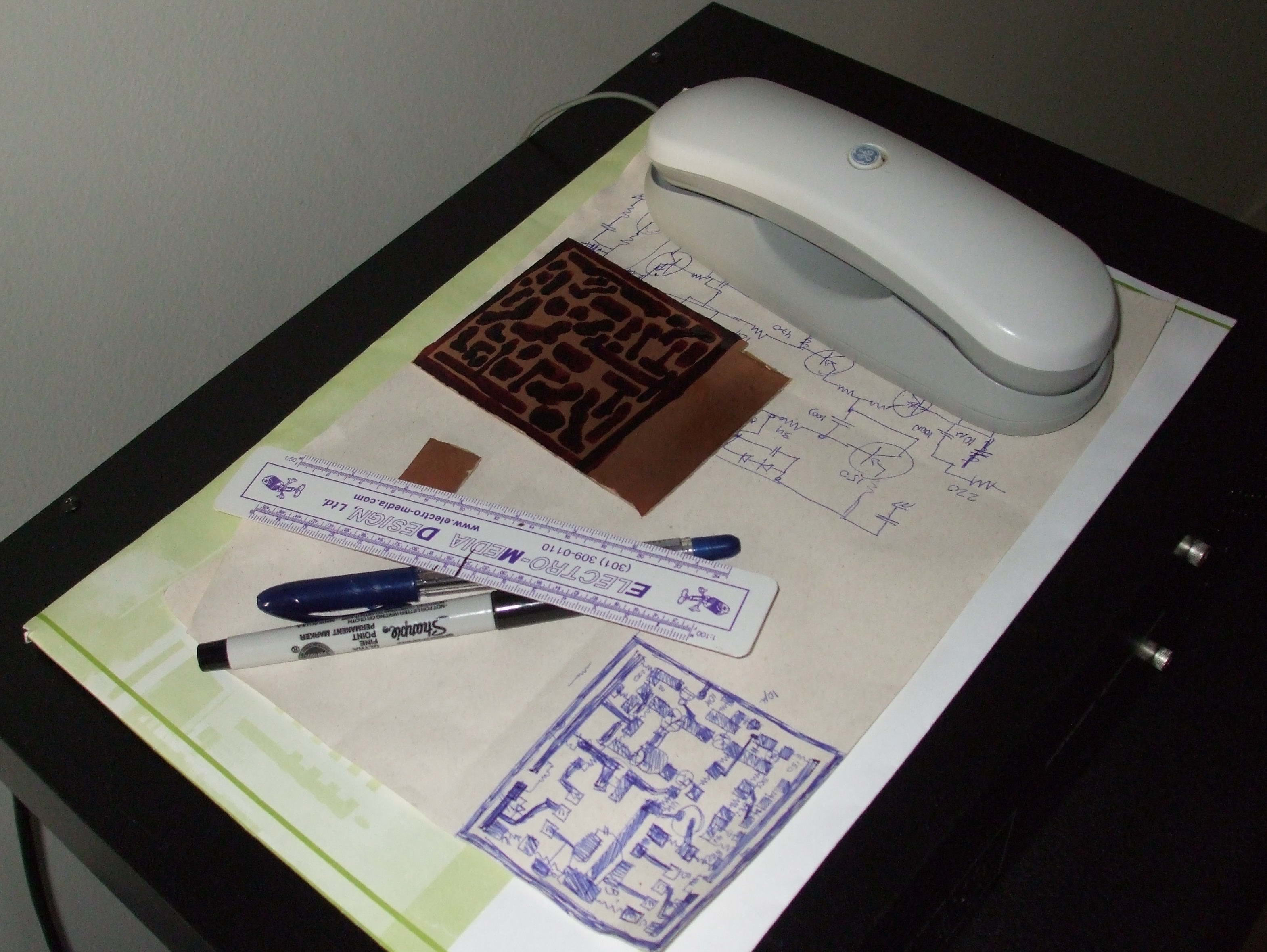

I will assemble another Dx Blame ST..this one will use BD139 (wahab will dislike)
because the supply drop to 40 volts (not a good transformer) when loaded...so, in the reality, to maximum power swing....we gonna have plus and minus 40 volts minus the losses we usually have in the output.....so...the output swing will be around 70 volts peak to peak.
BD139 is made to 100 volts...but this does not mean that if you connect 101 volts it will explode..there are safety room...of course...the same you have in electrolitic condensers too.
Latter will open a Spartan thread to the Dx Blame ST....only schematic and some pictures, the adjustment and link to Greg site... easy to people...have not to read the big thread..... people does not like to read big threads.

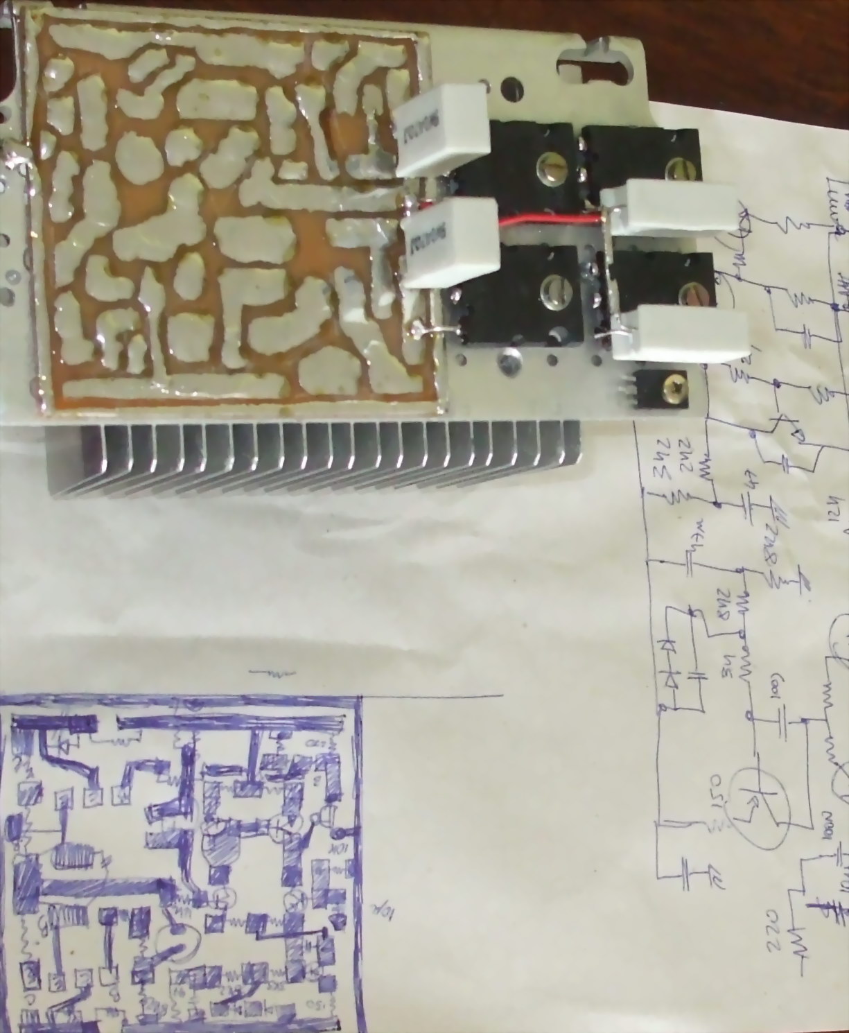

Board is made using nail lacquer , because the chemical product i will use to etching attack the permanent pen traces and dissolves (dilute) the lines...i will use Hydrogen Peroxide combined with Acid...board will be glued into the heatsink...so, construction will be made in the copper side.
The thread will be "Dx Blame ST - builder's thread"

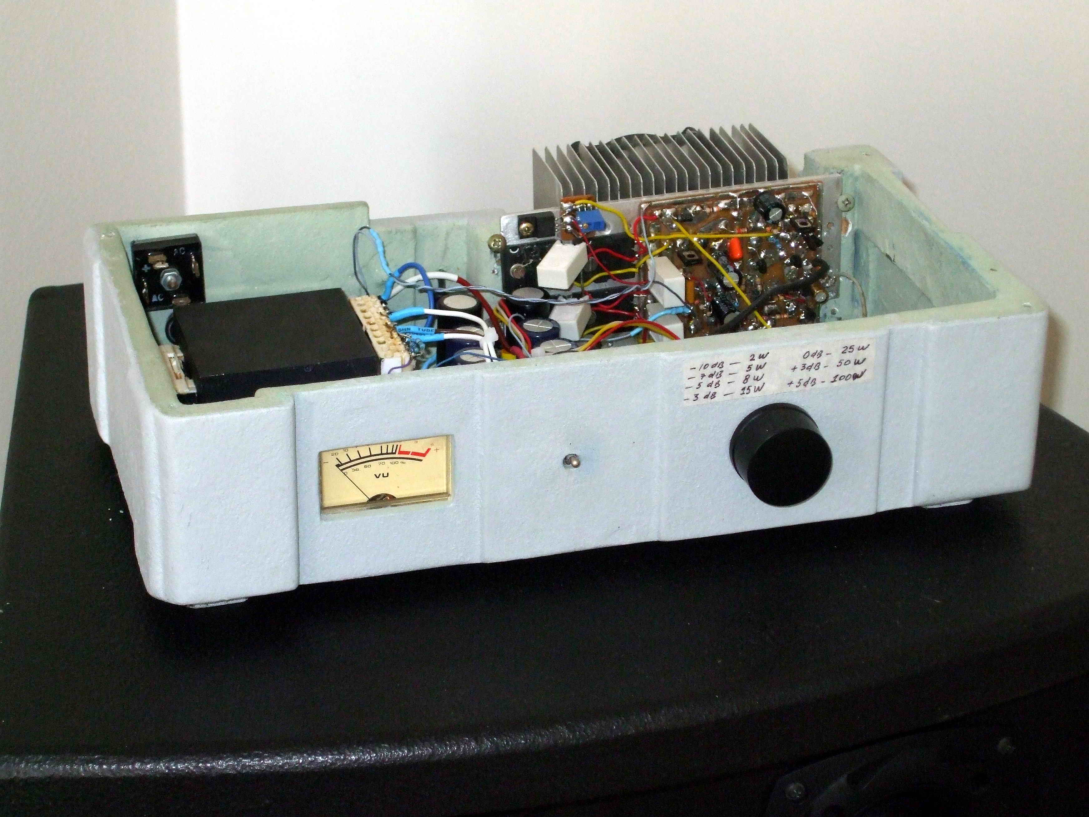

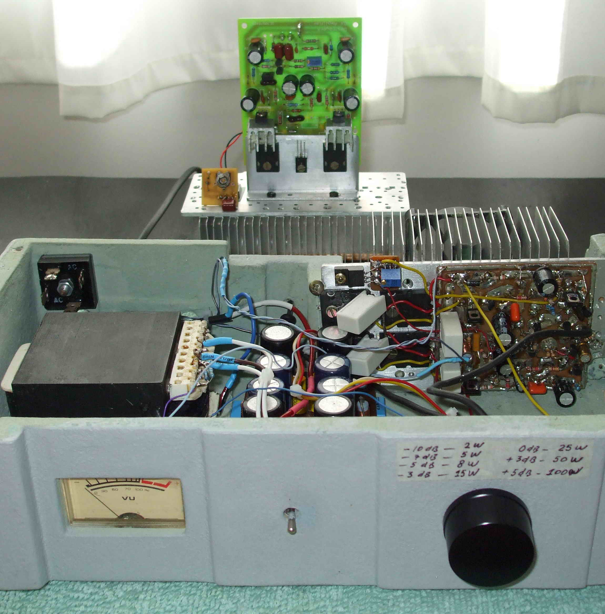

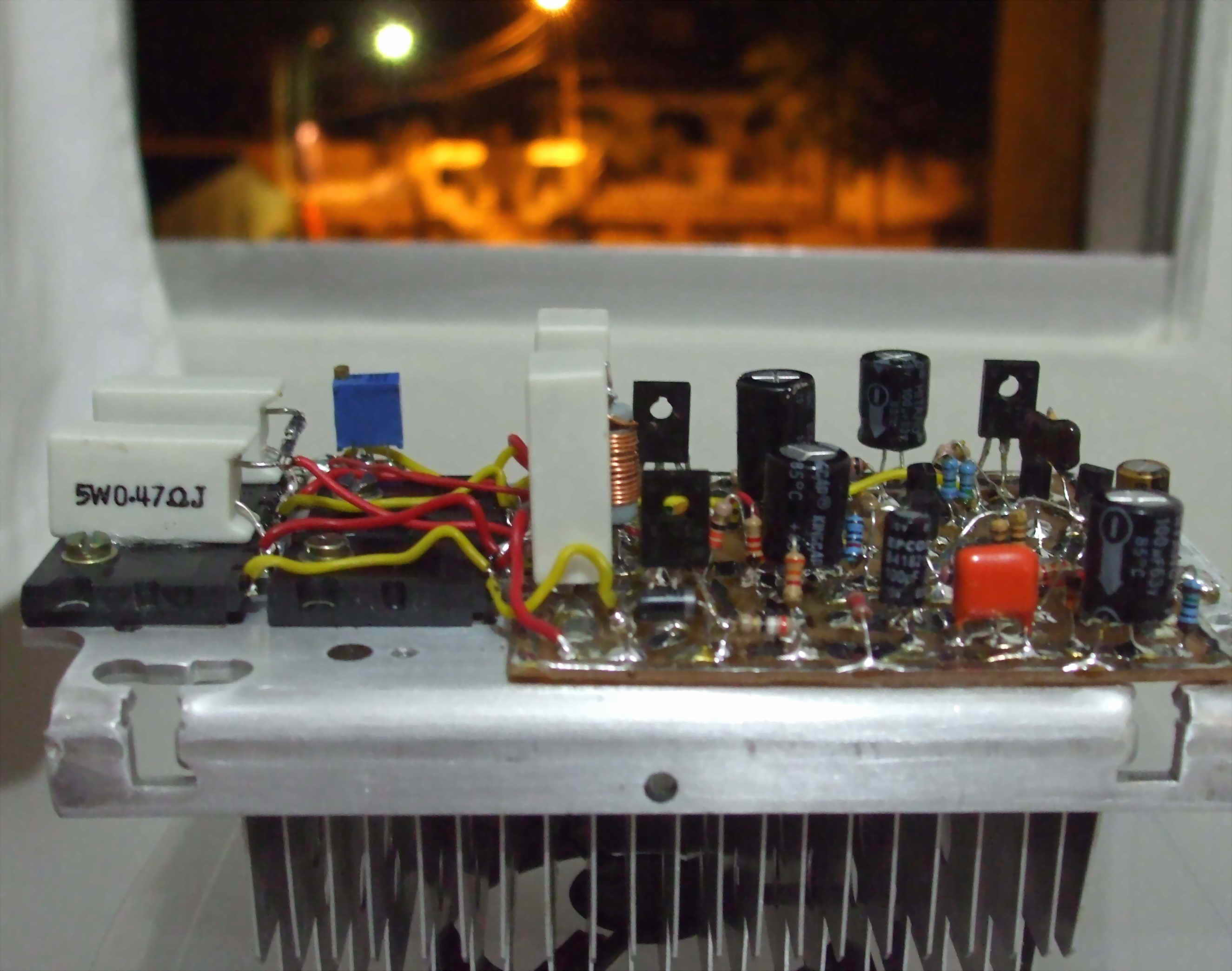

I am already listening the Dx Blame ST - 55 Volts - less than 100W at 7 ohms
Because the supply voltage drop..also the condensers are not enougth.
It is using BD139 and BD140, in the VAS position and also as drivers... because the supply voltage drop is keeping the maximum VCE swing below the maximum voltage these transistors can face.
Also, BD139 and BD140 has not obligation to explode if you increase one volt above the limits..they have no zener inside!..... they have some room..some headroom.
I am uploading a series of videos to youtube (18 videos), showing you VBEs into all transistors, currents, maximum voltage, of set, bias adjustment, frequency sweeps observed in the scope...this will take the entire day...the videos are big in data size.
Construction of audio amplifiers produces a lot of hard work, it is not something good for lazy folks..we work a lot!

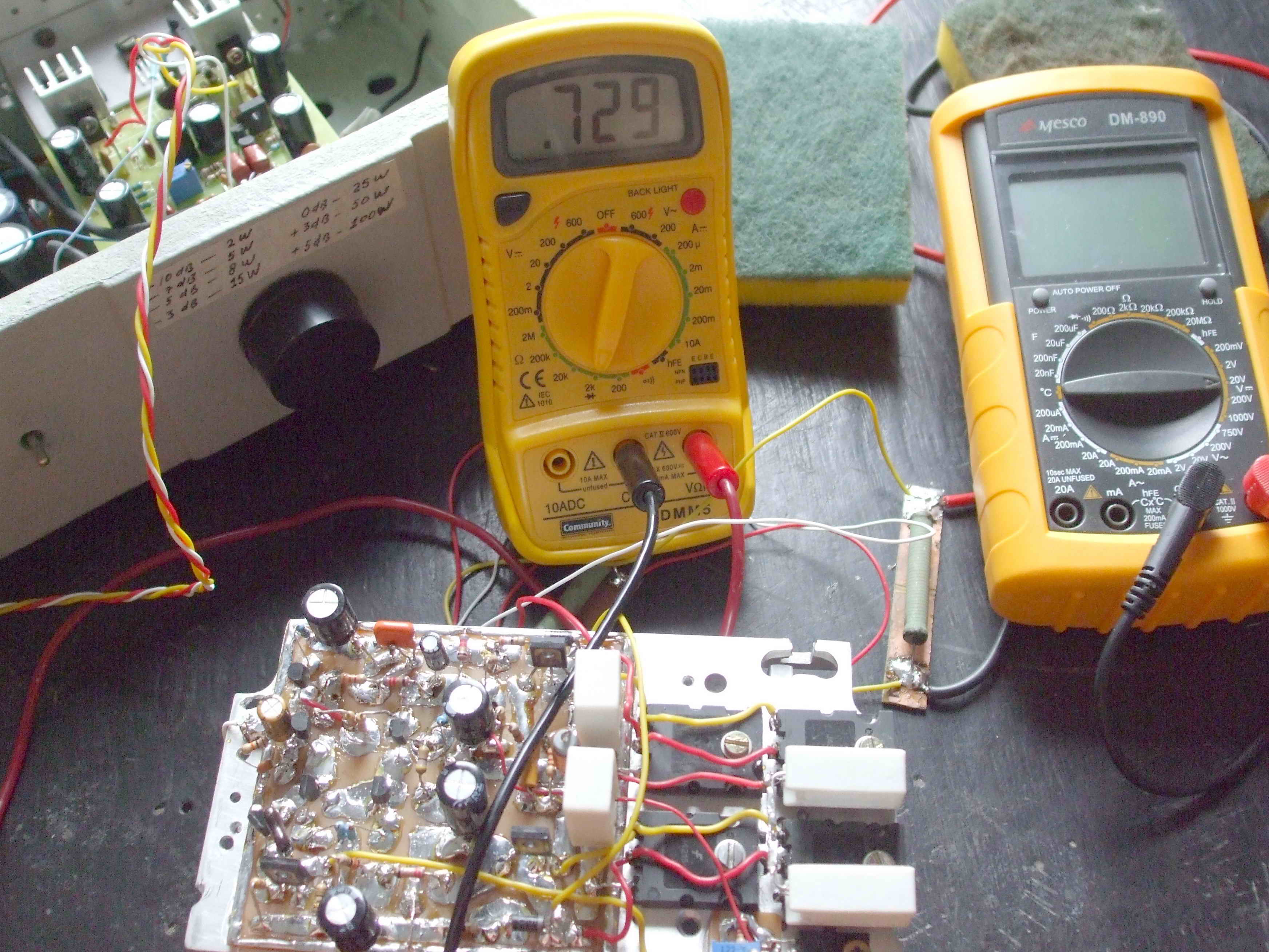

Showing you, the picture, the total resistance measured in the VBE multiplier..resistance from base to emitter..the correct one to this voltage, to result in less than 50 miliamperes stand by current to each rail.
regards,
Carlos

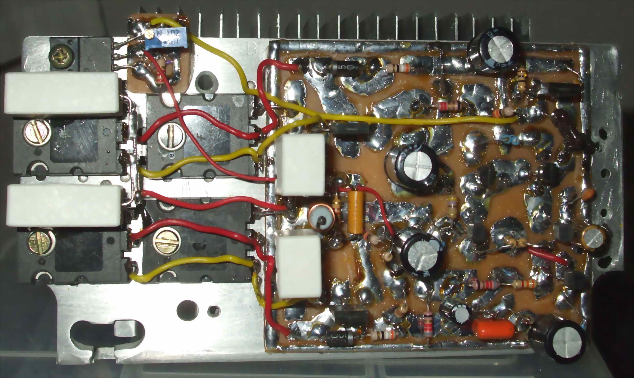

The ONLY modification done was the installation of one more output pair
Because my supply drop, these two pairs are fine...you may need more, if you have huge (good) supply.
No modifications..the same Dx Blame ST schematic...the condensers insulating voltage, of course, increased to face 55 Volts (stand by voltage...with consumption it drops a lot)

BD139 and BD140 are 80V transistors. They are known to whitstand up to 100V, but going further is just not sensible.
+/-55V is up to 110V and rail sag is not instantaneous, it takes some time to happen, particularly when playing music. So the transistors will be subject to 110V for brief periods of time (midrange and trebble transients) no matter how much the rails are sagging with bass. They can fail.
Transistors are matched...the small ones are 320 of gain
BD139 and BD140 are 167 and 175 of gain.
The power transistor are 98 and 105 (NPN and PNP).
Multimeter gain measurements...low voltage naturally.
These chinese digital multimeters provides a gain measurement socket.....
VBE measurements...videos will show that too:
The output 540 milivolts
Drivers are 548 milivolts
Second VAS is 544 milivolts
First VAS transistor is 570 milivolts
First differential, first stage is 560 milivolts
Second differential, the feedback one is 570 milivolts
Stand by current is 44 miliamperes each rail..of set around 8 milivolts, supply voltage (without load) is 55V.... supply voltage loaded with 6 amperes...3 amperes each rail, then voltage drops to 40 plus 40 volts (reason why BD139/140 survive)
regards,
Carlos
regards,
Carlos
Currents.... using 55 volts supplies.
All currents are from colector to emitter:
Input CCS current is 3.277 mV
Each differential transistor 1.624 mV
Fist Vas 3.481 mV
Second VAS 9.262 mV
Drivers 4.47 mV
Output... each pair.... 10 miliamperes
regards,
Carlos
Fist Vas 3.481 mV
Second VAS 9.262 mV
Drivers 4.47 mV
regards,
Carlos
- Dx Blame ES .... based into the Blameless, i am trying a new amplifier
