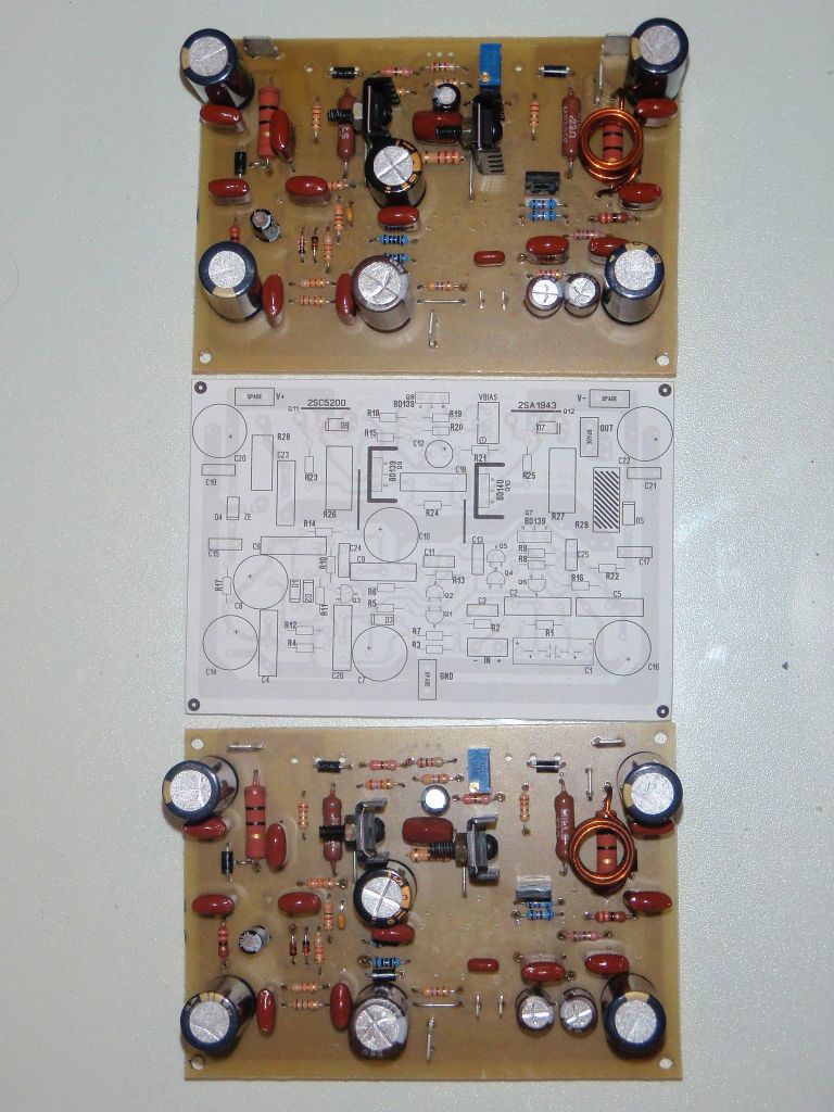

Hi, Carlos.
This is my Blameless ST version. The layout is based on Taj's original, with the fuses stripped in order to gain space. Work still in progress.
Best regards.

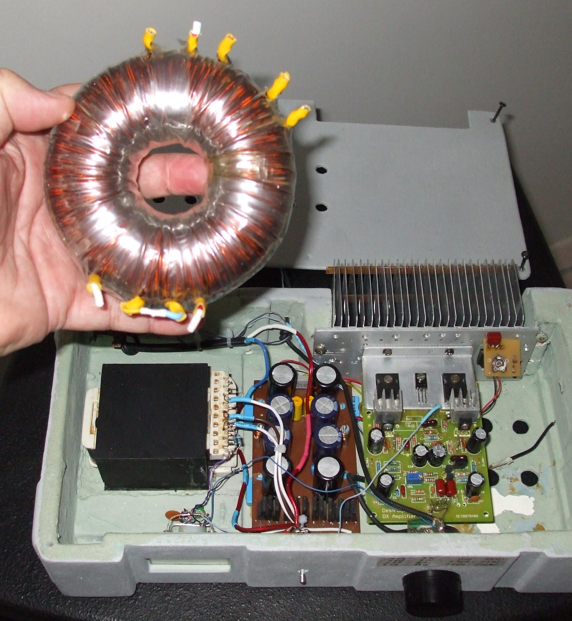

I think i have found one, between several reasons, made the Dx Blame ES
unstable...and this hell thing made me change a lot of things in my amplifier to face interferences i believe this one have generated.
The interferences, oscilations superimposed, have appeared in several amplifiers...even in the Destroyer Amplifier, the Standard and first one...i had in other amplifiers also, as Aksa 55, Symassym and DHR Turbo.
So, this explains the reason why folks had not troubles with their amplifiers...the main trouble was in my home...not inside their homes...they use to say the Dx Blame ES works fine and stable.
Maybe the transformer is the problem...removed, even the Dx Blame ES, the former one, had worked fine.
I would like to ask someone to explain me these things..if Toroidal transformers can do that, and also if you think i have a bad solder inside...or if i need to shield ...well..this is the first Toroidal transformer i have..... this is something very new to me....i tried several types of filters...but the transformer was the cause.
Maybe the entire Dx Blame ES unstability was because of this damned one!

If we are talking about transformers, I would always take the diodes into account too. Because they can do things (e.g. RF interference during switchoff), depending on their surrounding curcuitry.
So maybe you change the transformer, and see things are better now, and conclude from that, the transformer was the cause. But this does not have to be the whole story, as the diodes might be the origin of evil, but problems only occur e.g. in combination with a certain transformer, i.e a certain set of impedances around the diodes.
After all, how should a transformer cause oscillations directly?
I think it is the combination of it all, that can cause trouble. Change one thing and it may resolve the problem. But maybe changing another thing can be just as or even more effective.
regards,
krachkiste

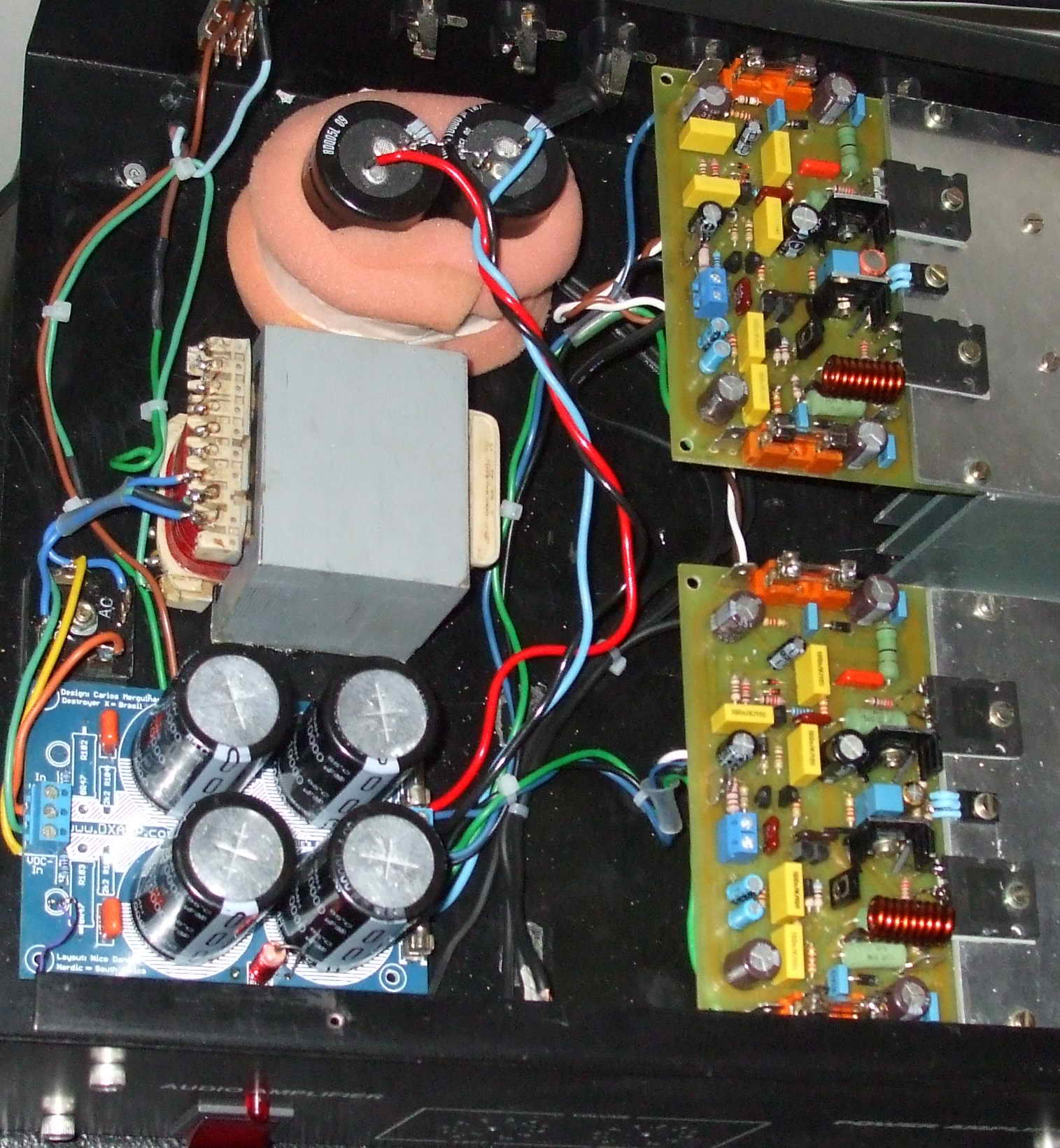

A time ago I build an classe A amplifier and while I was adjusting the bias it was very hard to do.The bias was dancing so I measured my power inlet and it was going from 220 to 239 that could be a reason too.When I used my special regulated psu of Thel Audio I didn't had that problem.
Nice one Tinitus...thank you.....but folks!...the most interesting thing
is most of the troubles we face are simple things..and we use to tweak the amplifier, to include and remove capacitors and so on..... we never think in simple reasons, simple problem causes.
We never think an amplifier is not playing because the coaxial input cable is shorted inside.
We never think in the possibility, the chance we have inverted supply polarity...and things alike.
I have spent so many time tweaking the amplifier..when the transformer was the trouble.
I have runned three wires from the other supply, the one you see in the Dx 1000 years Reich enclosure (now a day it is gray).... i capture the AC wires..from the secondary..almost the same voltage..less than 10 percent difference..then i disconnect the toroidal transformer wires and then i installed those three wires that came from the black E/I standard transformer.... and problems... Disappeard...no more oscilations.... anything!>
So.... everybody, not only me...redesigning the amplifier..and suggestions came..do this!..do that!..others said the amplifier was not correct.... they said it would burn, this was wrong!, that was not perfect!..remove this!.... include that!.... increase this resistance!...reduce that other!....
ahahahahah!
The transformer was the trouble...but i could not understand the reasons..but for sure it was the trouble....so....in the reality, there's nothing wrong with the Dx Blame ES...exception is that 100 ohms resistance that must be substituted by 220 ohms (first VAS emitter resistance)
The Dx Blame ES is the best amplifier i have ever listened....so...i will return my schematic to "almost" the original..... the 220 ohms will be there, and will remove 470pf and will remove the 18pf too.
regards,
Carlos
I do not know Krachkiste!..... but i am sure it was the trouble.
When replaced the trouble finished..then i tried once again in other amplifier...and once again.... with the toroidal i had oscilations together the high frequencies (high level).... replacing the AC from the toroidal from the AC that came from the other transformer everything was fixed..... i also could not believe and i have repeated this several times...no doubts..was the transformer.
I have not tried to take it out from the enclosure (magnetic field)...but i will try that soon.... i have other transformer, and that one inside the enclosure...and no problems!...so..the suspection about that other transformer may be better because outside the enclosure is not correct.
You suggestion, the 18pf removal, really made the amplifier more stable..that one was not good..this is real..but only this removal could not fix...what fixed was the transformer substitution.
Observe the picture...another transformer...and the amplifier is rock stable...no problems.... it plays fine...no signal can unstabilize it anymore (18pf is out)...you see, even my Dx Supply was suspect..i have removed all snubbers and filters and the series coil bypassed...and nothing positive happened..the only way was to introduce another AC to the rectified...i have tried other rectifiers too...was not the rectifiers.... was the transformer....interesting... something new i am learning....
It is hard to me to believe..and i am the testimony what is happening...toroidal transformer working (the one..i have dismounted and mounted once again and will test it once again) and problems....no toroidal transformer working..then no problems!
It is very simple that way....hard to believe..but it is the truth....with the toroidal i have problems...disconnecting it and installing AC from other transformer secondary..(two tested) and the problem finishes.

This is very curious, indeed.
Still I would be carefull with drawing conclusions. (Allways!)
Especially the one that all torodials were bad and unusable for audio. (I don't think that is what you say, but i could get the impression, if I wanted)
We don't even understand yet, why the use of this your torodial causes trouble throughout all your designs.
It's an interesting fact, but solely blaming the xformer is not the only possible conclusion that could be drawn from that fact.
It would be important (to me) to understand, why this is the case, to reduce the set of possible conclusions, and build up a theory that explains all the facts.
Only a valid theory/model can lead to reliable predictions. (If it leads to one false prediction it is no longer valid).
So for example the theory, all torodials cause oscillations, would not be a valid one, as there are working amps out there using torodials and don't have trouble.
So, maybe there is something special going on with your torodial. Maybe there is something special with all the things you power up with it. And still it would be unclear what that special thing was.
If we knew that, we could make a prediction like, torodial T (having a known special property) and design D (having another known special property) will result in trouble if combined in way C.
