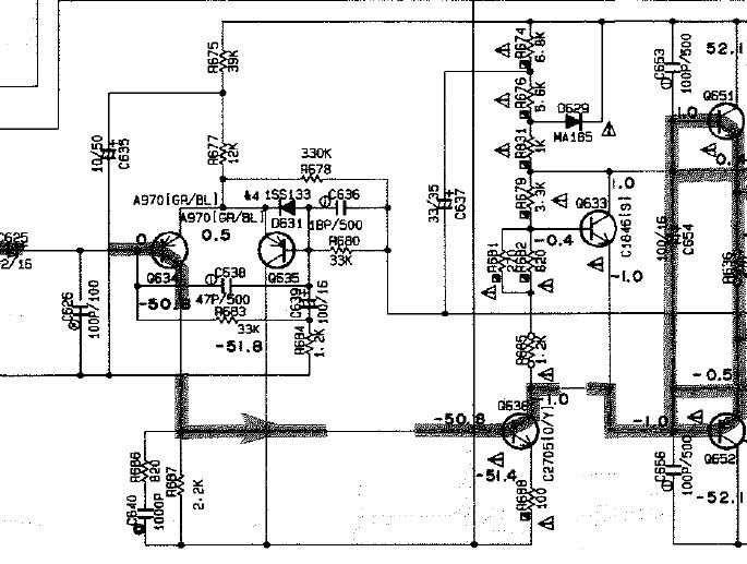

Yamaha uses several channels feeded by a single supply
Yamaha amplifiers supply voltage drops bellow 30 volts when these several amplifiers are operating.
When an amplifier operates with 30 volts...and the bootstrap circuit is using this same 30 volts (sometimes is lower, from a regulator)...the boostrap condenser will face around 15 volts at the positive terminal.... the maximum swing voltage, the maximum negative swing..the maximum possible (supply negative voltage limit) is 30 volts negative.
This 30 volts negative will appear at the output line, where the boostrapp condenser has it's negative lead connected....so.... the voltage in the negative side will be - 30 volts (that moment..the negative swing will charge the condenser this way)...the positive is stable...or more stable..almost fixed in 15 volts, or 20 volts...so...maximum voltage will be 50 volts (-30 added to +20V).
So...it is fine...it is all rigth..nothing strange there.
We, forum people, diyers, audiophiles, we try to make better..to go to the safe side...some supplies can have more than 35 volts... the AC mains can increase 20 percent... this results in 42.5 volts in the supply output... now imagine the supply is huge and does not drop the voltage!.... them the negative swing, that cannot be bigger than the supply rail voltage (usually is smaller) can go to -42.5 (less of course)....and positive voltage in the boostrap condenser, in the Dx Amplifiers, use to be 20 volts...so.... the condenser gonna face 62V.
In the real world..a 50V condenser can work under 62V....but.... some folks feel unsafe this way...so..condenser suggested is 100 volts..this will face all kind of possibilities/changes, to face tragedies my dear friend.
I really think the 35 volts there was a mistake from the one has drawn the circuit...it is dangerous this way...or...the voltage will drop down to 35 volts more or less..this is possible when the transformer is not big enougth to feed several channels... i have some transformers here that can drop 30 percent...and when feeding a single amplifeir operating 4 ohms...now imagine to feed 6 channels.

Carlos is not doing the voltage math right.
With 50V rails, no more than 25V will be applied to the bootstrap capacitor during normal operation.
On the other hand, if for some reason the output of the amplifier sticks to the negative rail, the 3.3k resistor will limit the current available to damage the capacitor to approx 22mA or less (assuming the capacitor breaks down at 25V or more). This means only 0.5W available to damage the capacitor, so no fireworks this time, only heat, it may take hours to vent.
I used to include a zener in my bootstrapped VAS to provide regulation and make VAS biasing and capacitor stress not dependent on supply voltage.
Any sensible designer would use a 25V or 35V capacitor, as in Yamaha schematic.
