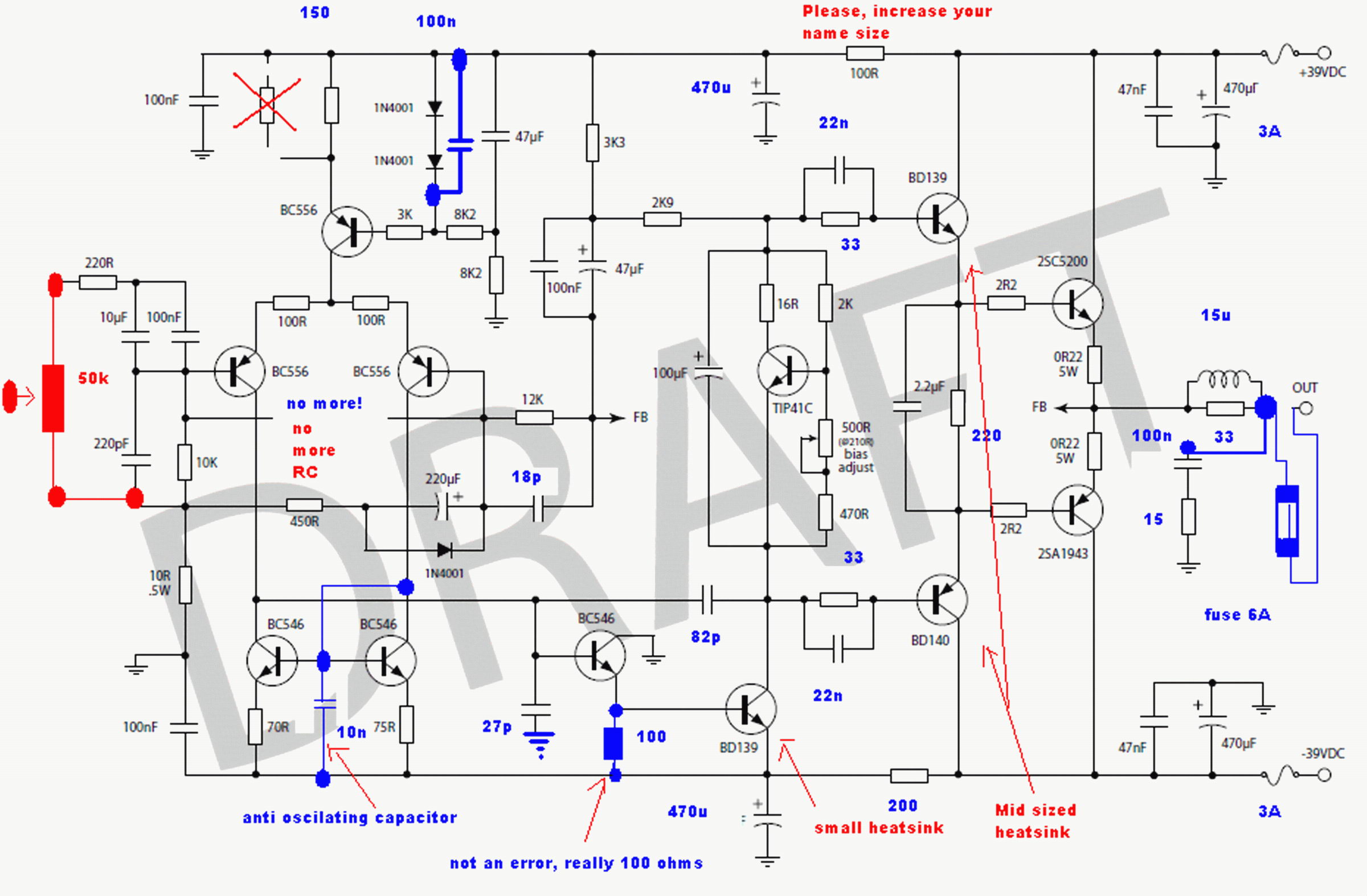

will not kill the one till Todd (taj) say OK! to that, because that helped me a lot, he even made schematic and was producing (starting) boards.
No problem here. My enjoyment is drawing and learning. Already a success in my mind. 🙂 You can kill it now, I've had my fun. Well, it would have been additional fun to build it and listen, but it's your amplifier, not mine.

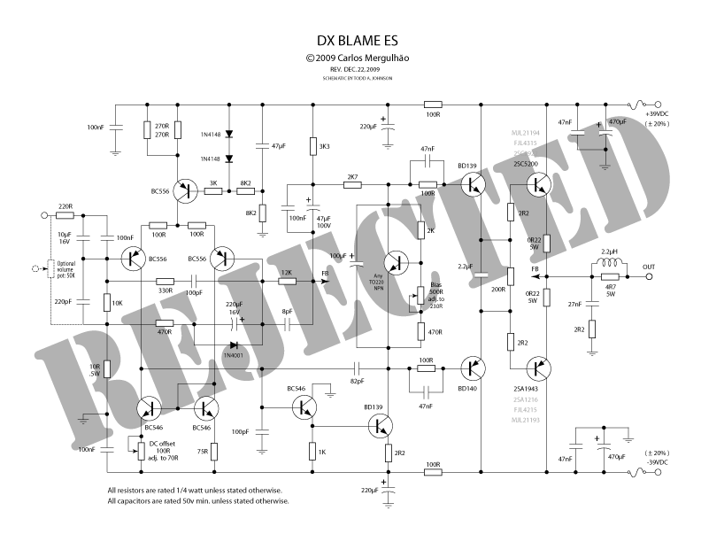

I will give another try on it, to compare with the HRII.
I have built the HRII and i felt the Dx Blame ES have a better sound reproduction, even unstable the way it was.
Will try this week or next week.

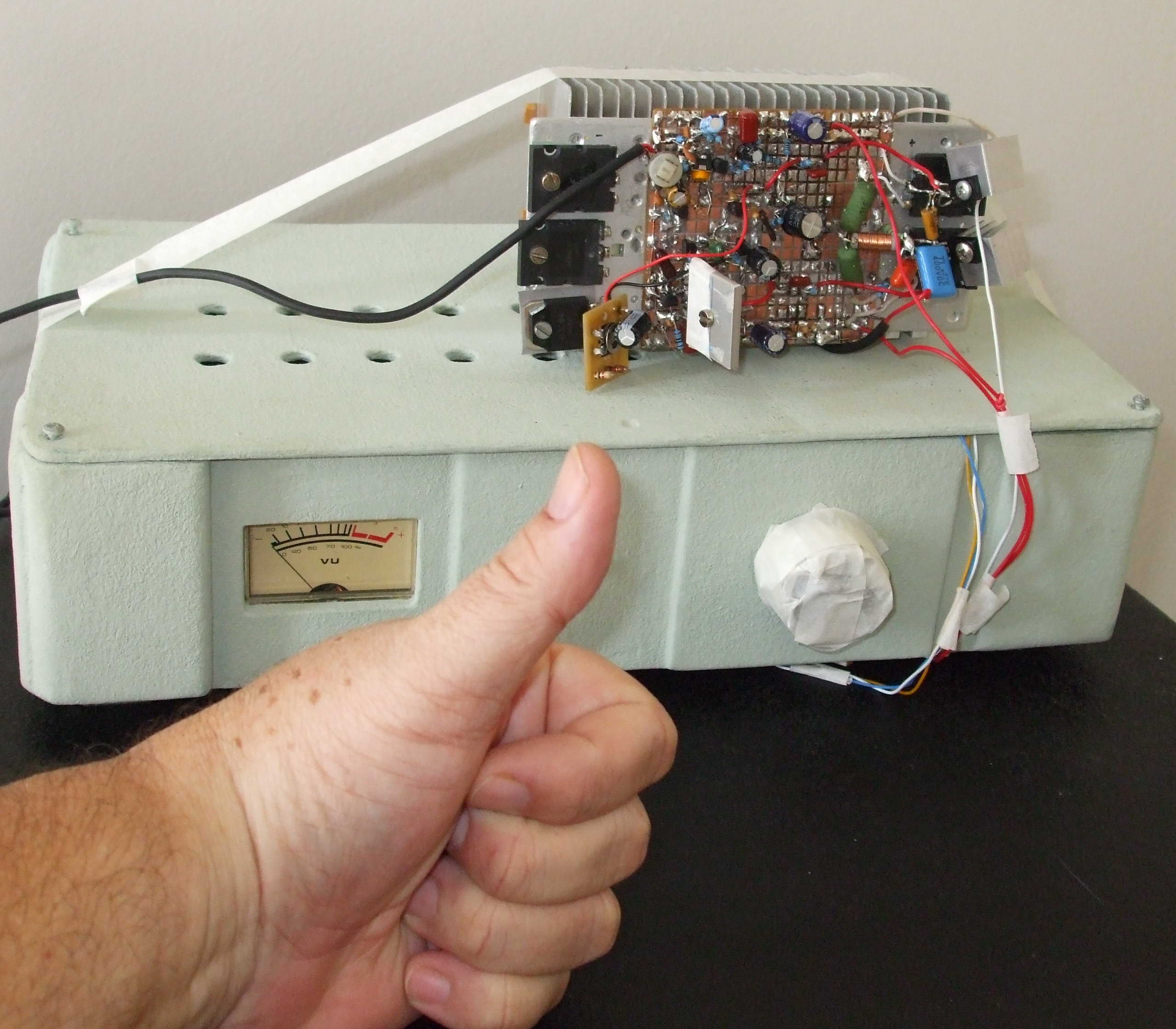

It is playing rigth now!...MY GOD!...the sound is almost perfect...
To my personnal taste....naturally!
If the Dx Standard was rated and evaluated by myself, it would give 75 quality points.
The HRII would jump to 82
This one would have 96!
My Orkut group of friends will assemble...all them will do...they sai:
- Sounding the way you are telling us, if it work for a whole day long... and them explode, the pleasure it will give us will be enought payment by the parts and labor applied.
Distortion is 0.0031% THD.... but will not survive 4 ohms and 2.2uF
Not an error, the zobel sounded better at this place and was more stable at the scope...why?....i have no idea!
Carlos

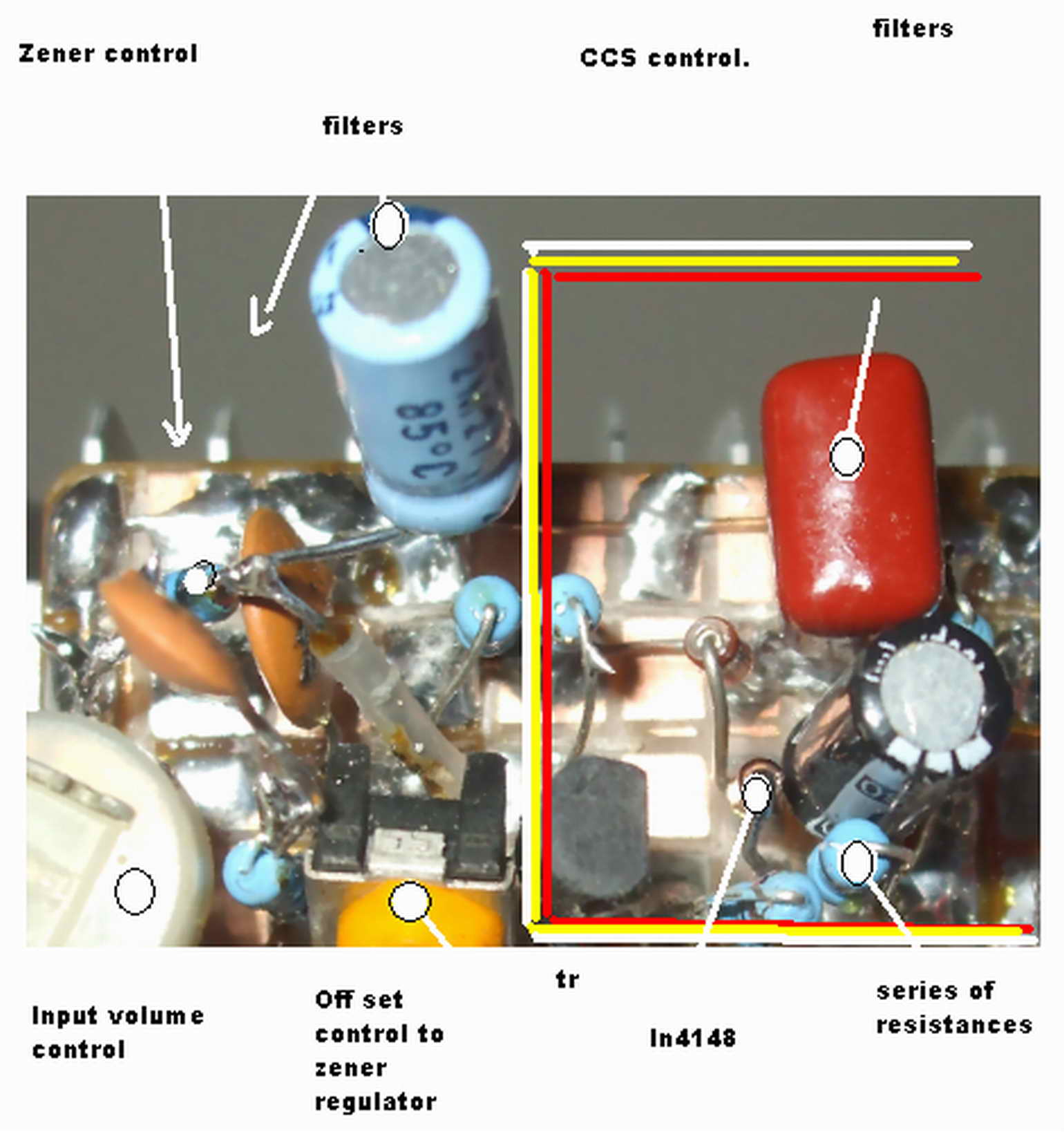

Dx amplifiers are not virtual or result of simulator or theories, beliefs or ...
imagination.
They are always real thing, tested and compared, deeply used, listened for several hours long, people is called to visit me to listen and evaluate.
You may see in this picture, rigth side the ccs control, left side the voltage regulator..it is a matter of switch from one to the other and fast compare...there are no doubts when you do this way.

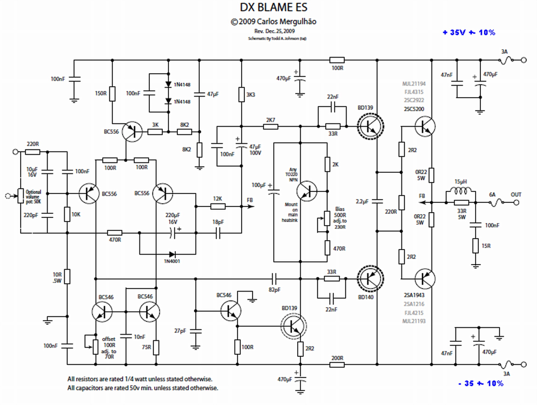

Beautifull and super fast dear todd.
I was making a revision and i found i made a mistake, plus and minus 20 percent will exceed the BD139 maximum VCE.... it is not very good.
Please dear Taj, let's fix the stuff, let's indicate 35 volts plus and minus 10 percent.
The trouble is only the BD139/140 maximum operative voltage, some of them are 80 volts.
