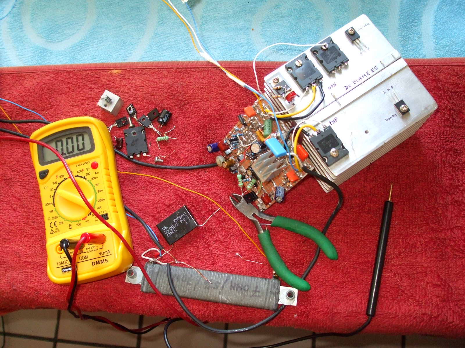

The amplifier died during the endurance test..DO NOT BUILD for a while
The amplifier have not survived the 3.5 ohms plus 2.2uf endurance test, while was operating into my speaker, not reaching the distortion level, using speaker loading plus resistance, plus capacitor, behaved fine...but doing the tests to Pavel, i have overdrive the unit with square wave, 10 khz and them plaft ploft pow!.... the amplifier gone.
Before this moment i was inspecting the waveform, was perfect, but when i have increased the generator level to see what gonna happens forcing the limits, the amplifier started to oscilate and gone.
I have fixed and gone once again, them my solder finished and also my good will.
The amplifier has not passed the endurance into 3.5 ohms plus 2.2uf, BURNED!, this means to me it is not stable enougth, because my other models survived this same test using computer generator without troubles.
DO NOT ASSEMBLE till i return, next year, after Christmas and a very Happy New year to everybody.
Will buy more solder and gonna change something and try once again, but, in advance this amplifier will Blame Dx in the place to be Blame ES..and i can put some money on it that it gonna receive a sledge hammer hit very soon.
Lovely sound, but if cannot be overdriven..no way!...the supply fell down to 33 volts, so no problems about transistors..some unstability that i do not know where or why.

it s not the cap that did kill it, as thanks to the RL output filter, it was
stable under such a capacitive load,...the thing is that when coming from a clipping with a square wave, the power device that is supposed to be switched off had to first resist a spike of current in excess of 20 A with a full rail voltage...with a 10KHZ signal, it s deadly...

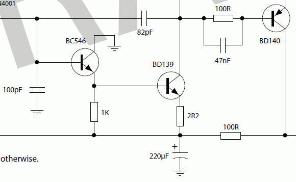

That Cdom was really from base to colector, so, nothing very strange with that, only the value seems too big for you and also for me.... i had to use, without it oscilated as a crazy donkey.
First transistor had the coletor to ground, so, if you install a capacitor from base to ground you are, in the reality, installing a capacitor from base to colector.

there s a problem with square waves, as when the amp go from a rail
to another, there s a crossconduction which exceed 20A during a short
time, but at 10KHZ, this is much too repetitive, so surely one of the output device will blow first, saving perhaps the other..
the capacitor must be seen as connected from a collector of the
differential to ground, thus slowing the input stage, as explained in
a post earlyer by BV, it seems..
this slow down not only reduce the bandwith, wich was wanted,
but also reduce the ability of the differential to control rapidly the vas..
i can t elaborate more, as i need to study the thing a little more..

Time to add some protection circuitry!... i have overdrive the unit with square wave, 10 khz and them plaft ploft pow!.... the amplifier gone.
Perhaps you think that will spoil the sound, but I think you will find it improves the smell. 😀
burning, it goes in flames, yellow flames, when other pops a blue ligth and the transistor case is opened with a clear hole or a slice is busted!
Also the unit burns the stop resistors...i do not know if those resistances are too much weak (new ones i have received from Greece) but they carbonize easy and smells a lot.

reduction of current reduce the transconductance in an
aim for stability without increasing the degeneration resistors..
the RC circuit from inverting input to non inverting input must be
suppressed, as the end that is connected to the non inverting input
is in fact closed to the signal source , thus making the amp response
amplifying more at very high frequency, creating instabilities..
as you can see , the eventual place of this RC is between the two
collectors of the differential, but in principle it s not needed..
it can replace the 100 pf shunt capacitor, but as you can see,
this latter was also suppressed..
the offset problem you experimented has his source in the
VAS buffer resistance between emitter and negative rail..
1K is not enough, as the buffer will see only 940 uA curent,
thus, the current pumped by the following transistor is too
high in comparison, shifting the dc balance, and making
the amp try to adjust this bias, thus creating DC offsets..
with the new value, no need of different resistances for the
legs of the current mirrors.
beside, a reduced resistance allow better switching of the vas..
also, the two base of the differentials have now the same 12K
resistance...the measured offset at the output is now 60uV,
on par with the high loop gain at dc..
Cdom is increased to 68pf...here, it is a matter of real world
adjustement...
also, this cap see the full rail volatages, and must be of quality,
preferably a stiroflex..if you use ceramic caps, it s perhaps better
to use a 150 pf in serial with a 120 pf, as they will sustain
more voltage while being still linear....
the Vbe multiplier use a better transistor, as it s important
to use a fast one...
also, the cap that shunt it is suppressed, as it can generate
oscillations...this caps is neutral only if the VAS collector current
is perfectly constant..in the original blameless, a current source
was used to load the vas, not a bootstrap...
i did not connect it, as it s your role to experiment with it, although
i can only warn you that it s a sensitive issue...
the output RL filter is suppressed..in principle, the amp is
stable under any capacitive load without it..
nowadays, i did draw it, if ever it s needed..
high values of L and R are only the prove that the amp
is not naturally stable, so rather than increasing these values, it s better
to tackle the origin of the problem..
here we are..i surely did miss some things in my explanations,
so if i did forghet something, just tell me about it, i ll come back
with the numbers...

i have some remarks about your test conditions : it s genuine
torture....your 7R load is unductive and amps don t like that..
add the 2.2 uF capacitor and the RL output circuit, and that make
an explosive mix, literaly...anyway, it seems that your earlier amps
did survive this mistreatment...
i send you two schematics, the modified one as ES2 and the original
as ES1, for comparison purposes..
in the moded shematic, you can see components that are not connected,
as the amp doesn t ned them, they are here only if the cautions i took
are not enough and are here mainly for explanation of their eventual role.
now let s look at the original schematic :
the CCS is moded to reduce the tail current, as proned by BV...
also, it s simplified as it was the plan that was used in
douglas self schematic, and it was badly flawed in fact..
adjustement...
with the numbers...
regards,
wahab
