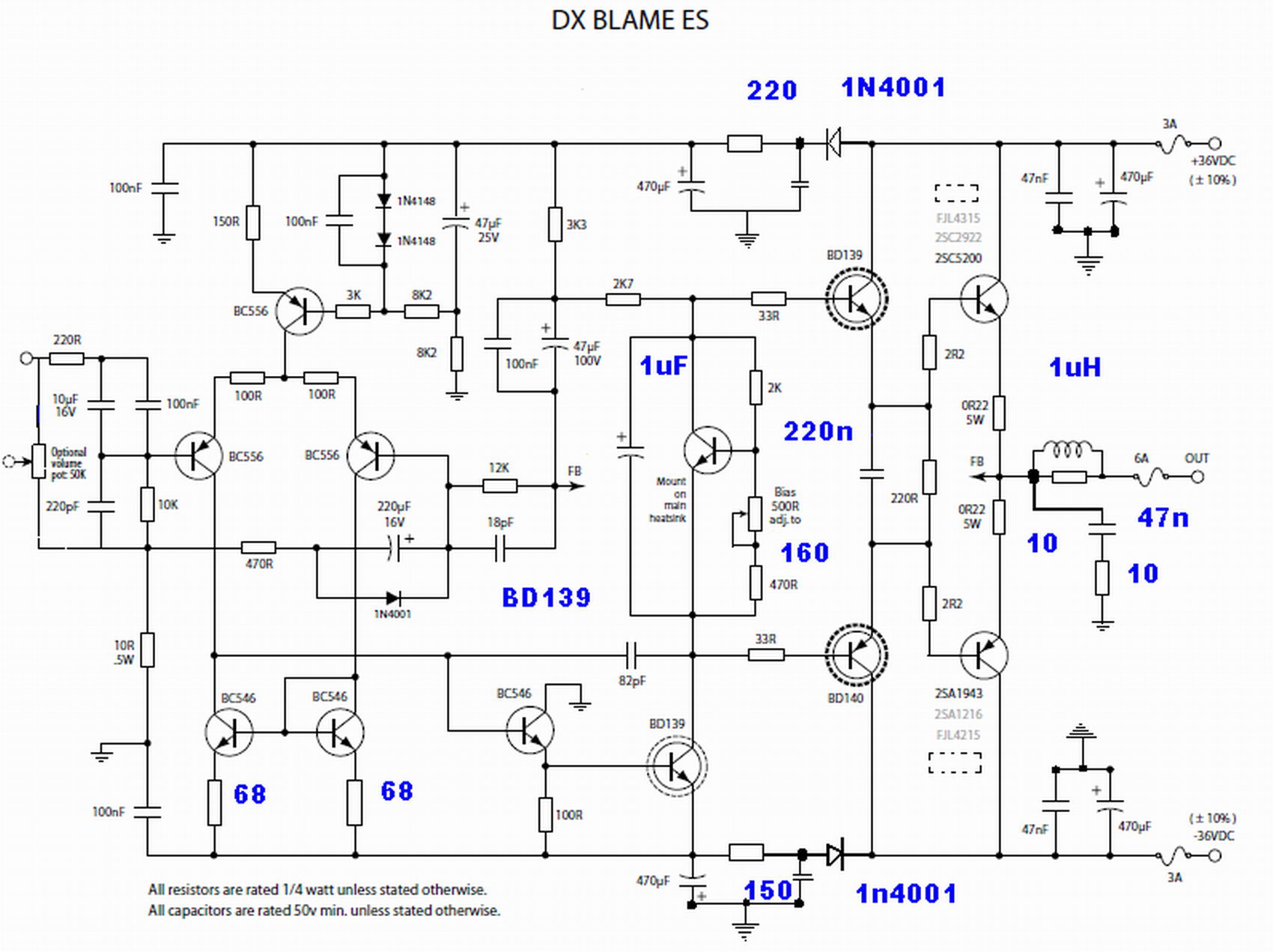

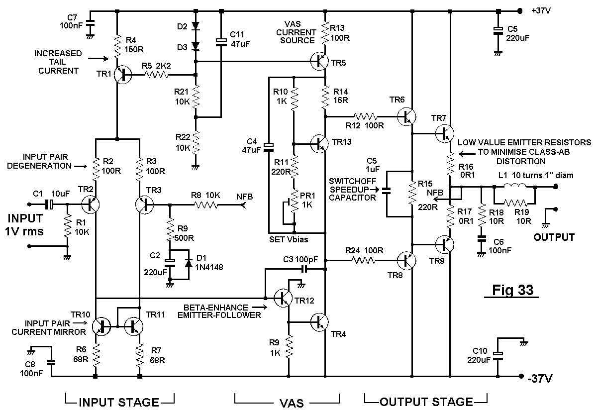

Carlos,
output Boucherot cell is in wrong place (schematic in post 100), it must be direct at output, before ouput inductor..And 15uH is very , very much. And try to remove 10n and 22pf capacitors..
Yes, i know it is in wrong place and will be there till i found another way to face
2.2uf capacitive loads.
The amplifier was better into the scope this way..read the entire thread, this was mentioned earlier.
Done intentionally, on purpose, so, was pre meditated, planned this way, created this way, measured this way, consciously drawn in the wrong place, outside standards, against rules.

15uH will show 1 ohm at 10khz and 2 ohm at 20khz. This may result in rolled-off highs with low inductance high end tweeters, not to mention low impedance ribbons...
If this amplifier can't drive a capacitive load with 10 times less inductance, there is probably some mistake in design 😉
The RC load should be at the other side of the inductor. Stability should be much better that way. The output stage really needs a low ohmic load above 1Mhz for proper phase margin and gain control.
Yes, i do think the same as you Eva, but i do not know how to fix
I will love to reduce this enormous output inductor, i just do not know how to do it...i have enormous over shot without it, reason why it is there.
Can you help?
It is wrong, i know that, but this is the only way i had, my technicall resources are limited, i use hard work, try and error basis to overcome my limits.

The 10nF capacitor impairs the current mirror above 200khz, it should not be there, it does not improve stability.
The 100 ohm pot is not the way to trim DC offset. There should not be any substantial DC offset in this amplifier without any trimming.
The 33R bypassed by 22nF on driver bases are calling for trouble, you usually want resistive input impedance at high frequencies and low impedance at low frequencies (R and L in parallel).
The 100uF in parallel with the Vbe multiplier is calling for local instability, a capacitor should not be placed there without series resistance, the output impedance of a Vbe multiplier is actually quite low due to the high local feedback.
You may find that diodes work better than the 100R and 200R on the rails.
2.2uF between the emitters of the drivers is also calling for local instability. Sometimes things don't work as expected (when you are only interested in the simple answers to complex questions).
The output stage usually needs 2 to 10 ohm of resistive load above 500Khz-1Mhz, that's the purpose of the RC at the output.
I think the the 27pf capacitor from the base of the BC546 to GND is not doing anything useful.
The 100R to 2.2R ratio of the BC546/BD139 emitter resistors is also calling for trouble (45). Emitter degeneration is used to force a lower current gain and get low phase shift up to a higher frequency in return. Theoretically a 100Mhz Ft transistor with a forced gain of 50 will roll off at 2Mhz, this is too low. Forced gains are usually 10 or less to get higher bandwidth.
Have you ever tried frequency compensation with two poles and a zero rather than a dominant pole?

I wonder how someone could understand from my explanation that I was recommending to suppress the 2.2 ohm emitter resistor from the VAS...
I was complaining that the forced gain was too high 😀
The kind of mistake that tells a lot of things 😉

You fixed!
Soon i will provide fixed schematics...no more overshot, pure square wave, full power till 20 Khz.

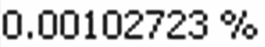

distortion is even lower now.
Almost all your suggestions were used, not all, but the ones fixed.
The output inductor is now 1 microhenry.
You are very good Eva.
My deep respects and congratulations.

Zobel returned to the correct point, extra 27pf capacitor removed
10N capacitor removed, 22n from the phase advance system (Sansui) removed and now playing stable....but really, the phase advance has a lovely "touch" into the treble...a pitty to remove this one...well... was needed...was one from the unstabilizing factors.

Now accepting 2.2uf, the square wave is not perfect this way, but very good.

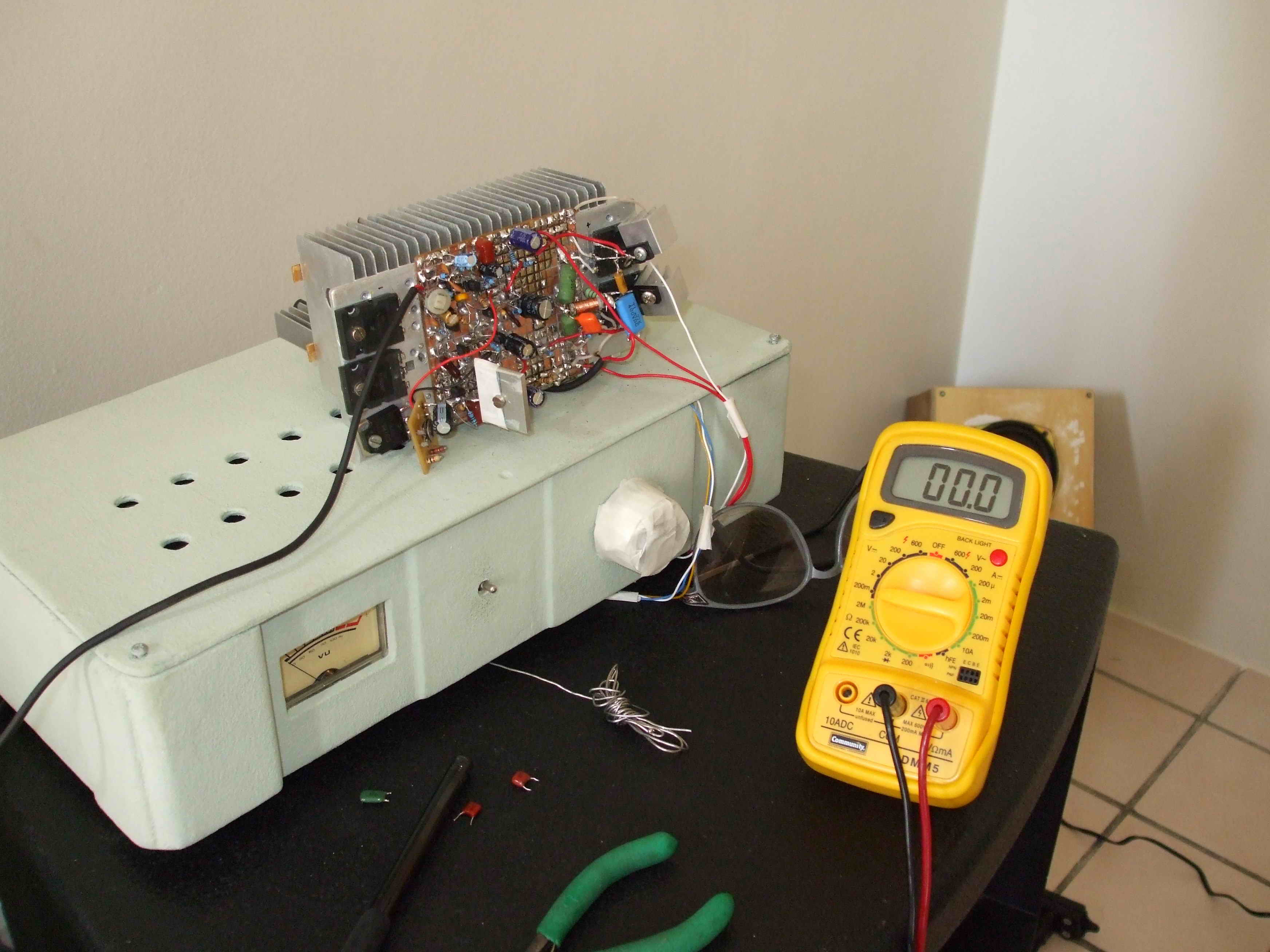

I ensure you, and i can say that because i am watching and monitoring what is going
on here.
the amplifier is more stable when the zobel is installed with the speaker, or, in the wrong technicall and traditional position.
My board is a mess..well.... was made this way to unstabilize, and it does very well such kind of things.
Measuring dc directly over the emitter resistances, the output section, and i felt it oscilated because the readings increased a lot..fast i removed the probe point and switched the amplifier off.... then i have repeated and once again...then i moved the zobel filter to the output and this finished...in my personall unit the zobel will at the output position.
I do love this amplifier, but really folks, i have not courage to suggest you to build because i can see it may be problematic depending the board, speaker or installation.
I will be selfish and will not tell you do build...will be only mine..ahahahahah!
But, other friends will use, soon we gonna have boards made by Taj, also an Orkut friend is producing boards, well, these boards will be tested and we gonna see what happens further.
Maybe my hand was touching the BD139 (VAS) colector while adjusting...i have a heatsink, and this can pick things too...do not know.... you know, touching both same time, the output line and the BD139 colector may have created that trouble.
