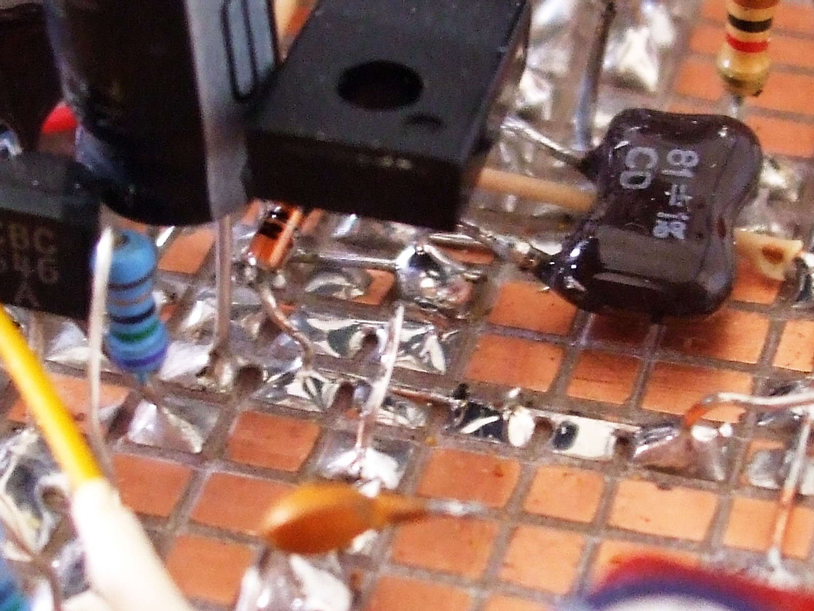

Here you have, i have cutted and continue to play stable, but i will not take the
risk....will solder it once again
it is the one out of focus, the small ceramic one.
But do that in your own amplifiers, install pressing your finger tip over the ceramic and remove it, just bent it to the circuit and return...please, use a non magnetic tool..plastic or wood.
And listen..then return to me to say that i must remove the unit.
Will stay....and check by yourselves, a excelent chance to check some beliefs, rules of thumbs and theories into real life..difference is audible.

Here is the capacitor, sound was different, and heatsink started to be too much hot....soldered in place once again, with reduce gain and so on, but stable and sounding much better.
Of course was tried from base to colector...but resulted better this way.

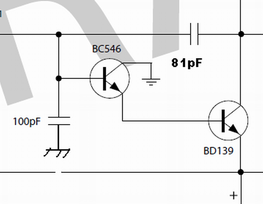

Sorry folks, that capacitor is connected to ground, so, it is a miller spreaded
One to the VAS first stage (100pf) and other to the VAS second stage.
Error into the schematic and will be soon fixed.
That capacitor was never connected to the negative rail.... error into the schematic, my mistake.
The schematic was correct, error was into the board layout i have produced.

the result is the same, safe that connected to ground
it has to stand the full rail voltage rather than 1.2V when connected
Here you have folks, the layout fixed with the capacitor in the correct place.
The correct position, for the capacitor is from Base to Colector, in both transistors, spread Cdom
Dear Carlos, something like "spread Cdom" is very bad thing:), believe me, I know this topology quite good, verified on hundreds pieces .Booth transistors (BC566 and BD139) acts as one VAS transistor with high DC gain (better linearity with closed NFB), hf gain (and stability) is determined by Cdom (NFB at high frequencies) value. Her is place only for one Cdom capacitor, from colector BD139 to base BC566. Both capacitors, as conected now, acts " mixed way" as capacitive divider at hf for NFB, and as capacitive load to ground (serial combination) for VAS. 100pF capacitor is not conected to output signal, it is only feeding hf disturbancies ( from voltage between GND and minus bus) in signal path..
It seems to me, you are using too high current in input stage , too big input gm and stability problems.Use Cdom about 100-150pF and lower curent to about 3-4mA for dif. input(2ma per transistor), or increase degenerating resistors to 150-220ohm ( but it is increasing noise)
