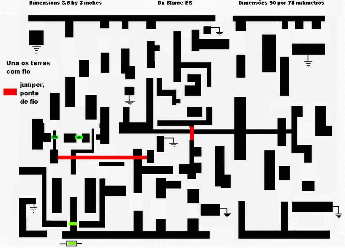

The preliminary, temporary, draft pcboard offered was made for my Orkut friends
Soon we gonna have something professional, my Orkut group have not demanding people, they want to build and listen, they do not mind about how the things looks....of course they love pretty things, but this is not priority for them (not for me too).
The dimensions are 3.6 inches by 3.0 inches, or 90 by 78 milimeters
regards,
Carlos
These are the copper tracks, i do not think this is good enougth but works!
Soon we gonna have something better.
This is "just in case" nobody presents to help, first one in the list is Taj.
regards,
Carlos

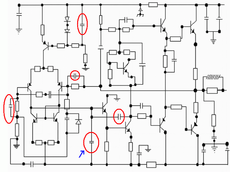

I had a very hard time with this amplifier while tweaking
If you remove one or two of the capacitors shown, for sure it will oscilate, in special the one with blue arrow.
I have lost several BD139, BD140 and one FJL4315.... when oscilating the base voltage is bigger than the maximum base to emitter voltage and the transistor burns.
Also if you forget to ground the heatsinks, when you touch bases with your AC voltimeter, the the amplifier will oscilate and the consumption will jump to several amperes..you will be forced to switch the power off (ahahahah, reset?) to reconstitute the stability.
Well, amplifiers are oscilators, input signal tracked oscilator, as the amplifier oscilates from positive to negative, but we want the unit to oscilate when you have audio entering...not different than that.
So, it is an unstable stability.
When oscilating you may be fooled, AC can be measure as DC into the output, you may think you have off set troubles, when in the reality the voltage you have is Radio Frequency, oscilations, rectified by your instrument sensitivity.
The bias trimpot starts not to operate correctly, you cannot adjust properly, you go increasing current reading over the 10 ohms series protective resistance and them the voltage jumped to several volts that means several amperes...and you try to return and nothing works..very crazy thing.... carefull with that stuff, bias control not operating properly means oscilations (or builder errors into the construction)
Carefull with this beauty!..... it loves to oscilate, the CCS into the input use to produce this effect... the amplifier turns easy to oscilate, or, at least the ones i have tried using CCS were sensitive to oscilations.....short wires, small length to transistors, ground into the heatsink and do not forget to install capacitors, the red marked ones are the main ones.
regards,
Carlos

I do not know Ultima
The one was very helpfull to stop oscilations.
If you observe the image posted you gonna see the waveshape is perfect for a sinusoidal signal at 100 kilohertz, full power. Also the THD is very, very low.
So, right or wrong is working fine, and this is what matters, to confirm theories or beliefs is secondary to me.
Please, stop before start to search for errors, try to observe the qualities. be positive Ultima. The amplifier was not posted for technicall revision, was posted to builders.
bye,
Carlos

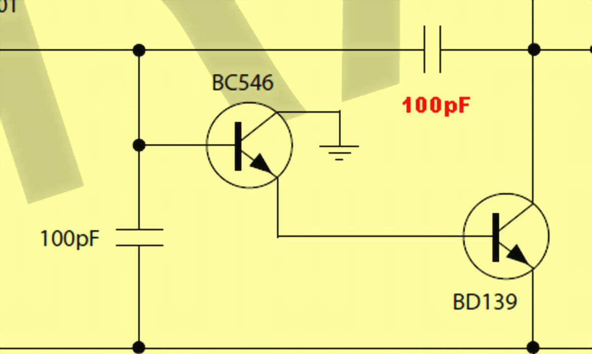

100pF from base of VAS "beta enhancer" to ground seems to me not a good idea..Straight way for hf disturbancies and possible stability problems. Use bigger value instead 33pF Cdom..And resistor about 1Megaohm in parallel with this capacitor will lower VAS gain (lower OLG-better stability) but at the same time you gain much better VAS linearity and lower VAS output impedance..
