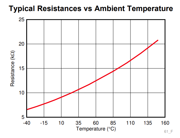

Here's a nice (nearly) linear PTC thermistor: https://www.ti.com/lit/ds/sbos921e/sbos921e.pdf.
Using WebPlotDigitizer to extract the Resistance-Temp data (WebPlotDigitizer - Copyright 2010-2020 Ankit Rohatgi), we get a nice fit with the function Resistance = 8638 * exp(0.00607 * Temp).

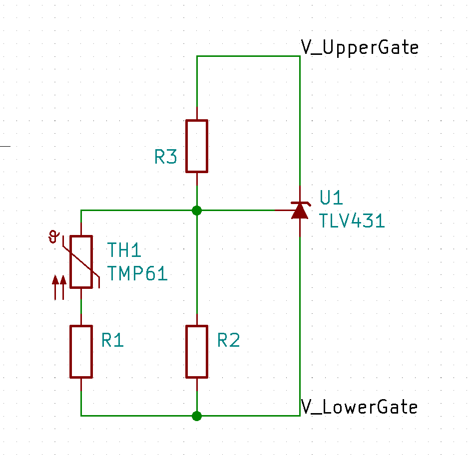

Since it's a PTC thermistor, we can use it to shift the reference of the TLV431 in the following circuit (attached)

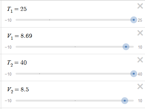

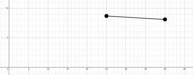

R1 is optional - it just makes the transition more linear, although this particular PTC is already quite linear. I put together an interactive calculator to determine the resistor values R2 and R3: PTC_bias
Alternatively, you could arbitrarily set R3 and fiddle with R1 and R2. Take your pick.
For setup, I imagine starting out with no thermistor and manually controlling the voltage spread. Measure the voltage spread at the desired bias at room temperature, and then measure (and tweak) to find the voltage spread that achieves that same bias at operating temperature. This provides the necessary inputs to find the resistor values to make the thermistor connects the dots.
ATL431, not TLV431
Correction to the above: TLV431 has a max cathode-anode voltage of 7 V. Instead of running the TL431 at low shunt currents, perhaps the ATL431 would be better.
