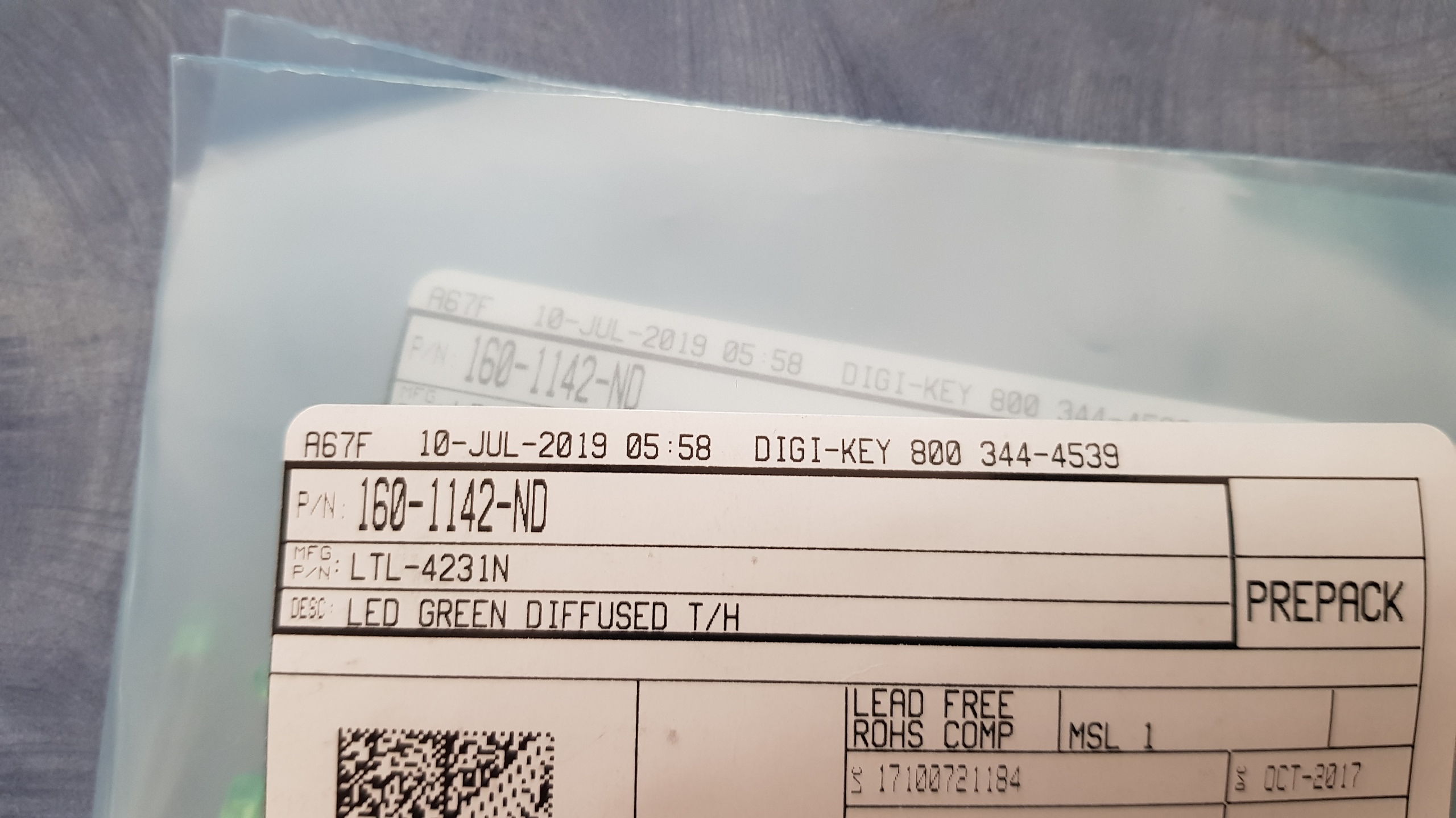

Just noticed there are a few versions of LTL 4231.
I used LTL-4231N.

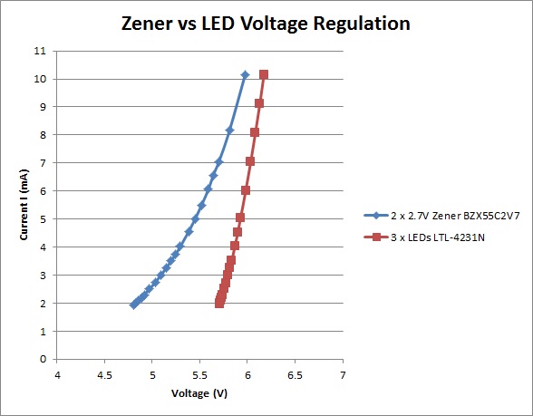

Zener vs LED Voltage Regulation
Decided to do more measurements and produce IV curves of both configurations.
The LED combination is clearly better than the Zener combination.
The Zener combo requires way more current to approach anything that is near the performance of the LED combo.
