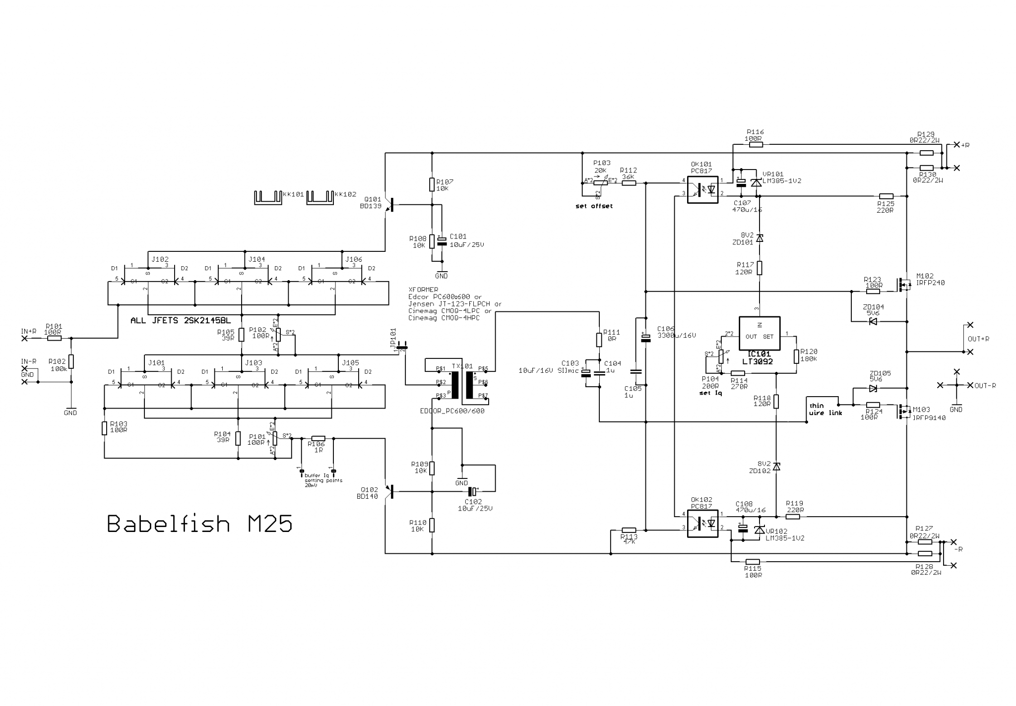

We could use a version of the F6 that supports interchangeable buffers in front of the Jensen transformer. Sort of like the M2x.

I just had a thought about the possibility/feasibility of designing a conversion board so the 4 pins common on all Mark's M2X input boards to match up to the diyA long pcb F6 circuit and this would enable any of the optional M2x input stages to then plugin to the 'standard' diyA F6 pcbs - duh! (should have thought about that before ...)
I have a rather different layout for both the IPS7 (includes a gain option) and for the F6 amp but this won't be compatible with the long diyA boards but a simple adapter/header board would be a rather neat little item, and maybe also to the diyA shop.
Yes to that ^ IPS7 with gain and others. Needs a ground connection to do it properly. Then you also get to use Yara preamp compatible cards.

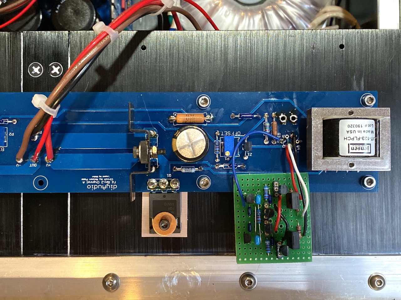

Here is a picture of how I replaced the JFet buffer with an Austin-inspired Diamond buffer. It is somewhat of a tricky build, but it worked well enough. With the current PCB layout, the only way to tap into the necessary electrical connections is at the holes left by removing the JFets.

James, that's nicely done especially using the different colours to avoid mistakes - the vero-board layout is as seen previously? Playing around with the gain option and using the 0v point at Z1, now changed to the 3 leds.
Neat little heatsink on the R1, and presumably R2 - what resistors are they?
I ended up using the PBH ones from Isab.h with clipon heatsinks - they're exorbitant price these days ...
Yes, I showed that same vero-board ealier. Just repeating it here for any newcomers.
The resistors at R1 and R2 are 30W thick film 0.4 Ohm, 1%. I wanted precision values at the source resistors to get more repeatable results. Especially since I was experimenting with splitting the resistance above and below the junction with the big capacitor.
