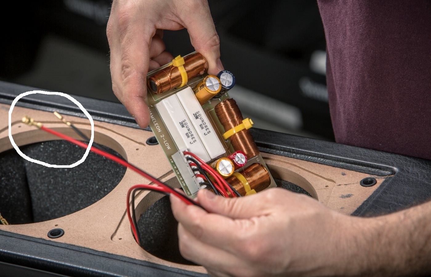

For speaker crossover wiring, one rigid cable makes more perfect wiring to the eyes.
I agree that it is important as it looks, I would have to align the red wires of my crossovers ....
But here goes to connectors... I consider them more important than cables, since connectors tarnish with time, and sometimes make bad contacts,
For connectors I prefer to match the female/male material (to avoid intermetal effects), and use decent semi-expensive brands (or at least the Amphenol top series), for maximum time with shinny clean low distortion and low impedance contacts.
You think it's better to solder crimp? I ask because if a big brand like Sonus Faber uses these simple connectors, metal against metal under pressure .....

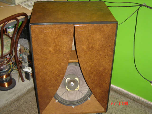

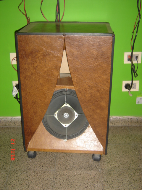

The bigger units are a 15" Sansui speakers re-enconed by a friend of the UTN who worked repairing them. Observe that the paper cone is original (From middle 70's), but the peripheral suspension is newer (10 years ago)
Tweeters are Jharo, 4" cone units.
The cabinets are more or less 12 years I made them.
No passive crossover, the separation is made in the pre-amplifier, at about 900Hz.
Osvaldo.

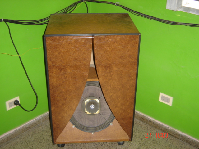

It is rare that such suspension has deteriorated, are like "oiled accordion". Which they deteriorate faster are the foam, although they can apply liquid silicone with a brush.
That gives them a few years of life, although in such cases hardens slightly altering the parameters of compliance.
But in a cabinet Karlson not affected, because they NOT need accurate tuning as a bass reflex.🙂

Karlson's cabinets are well recognized by this fact, they strongly increases radiation resistance.
