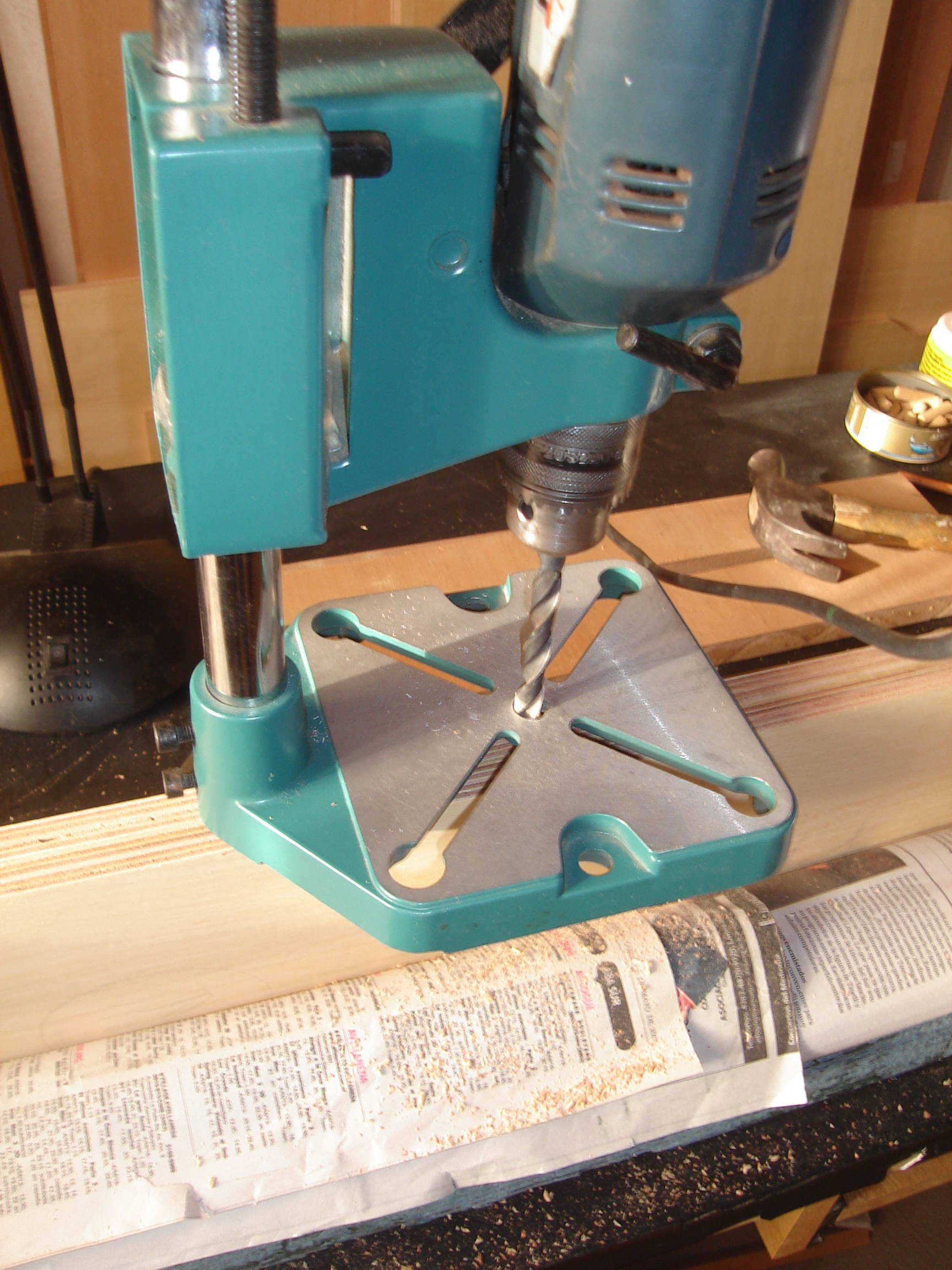

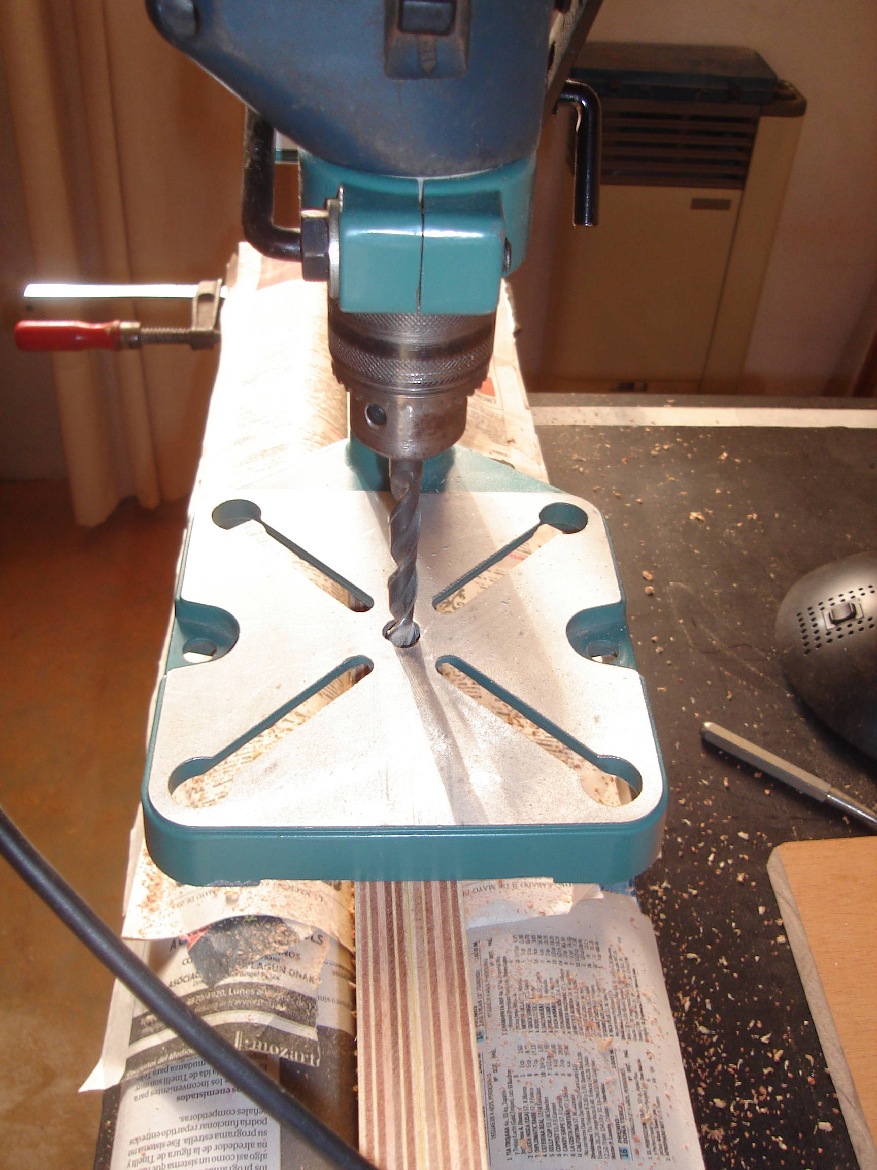

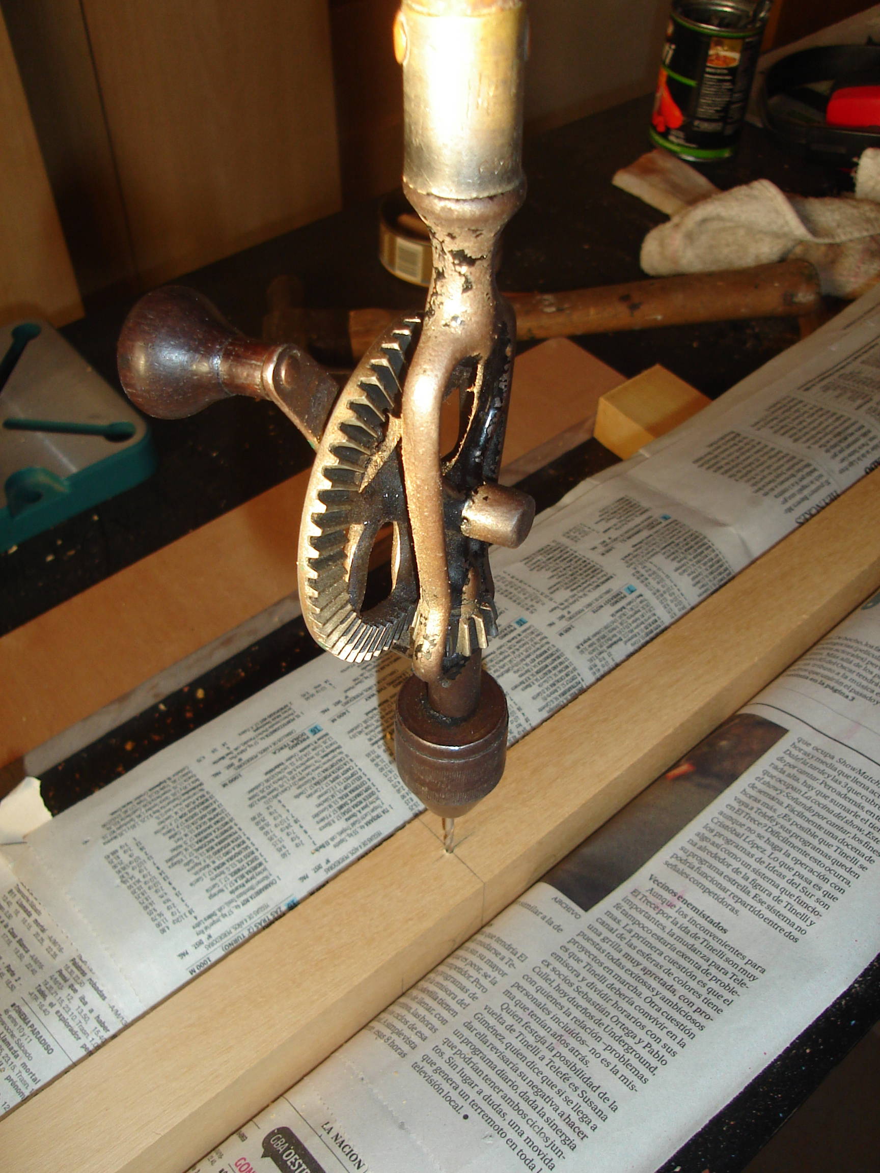

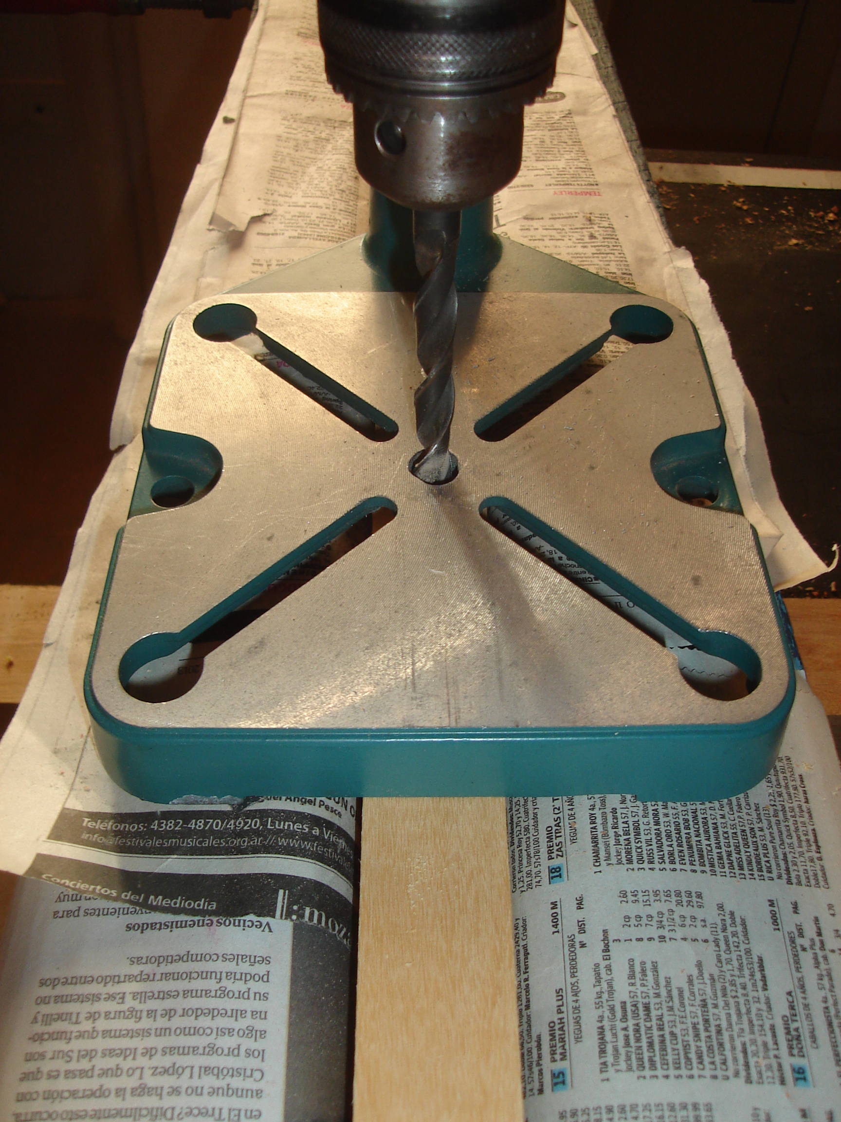

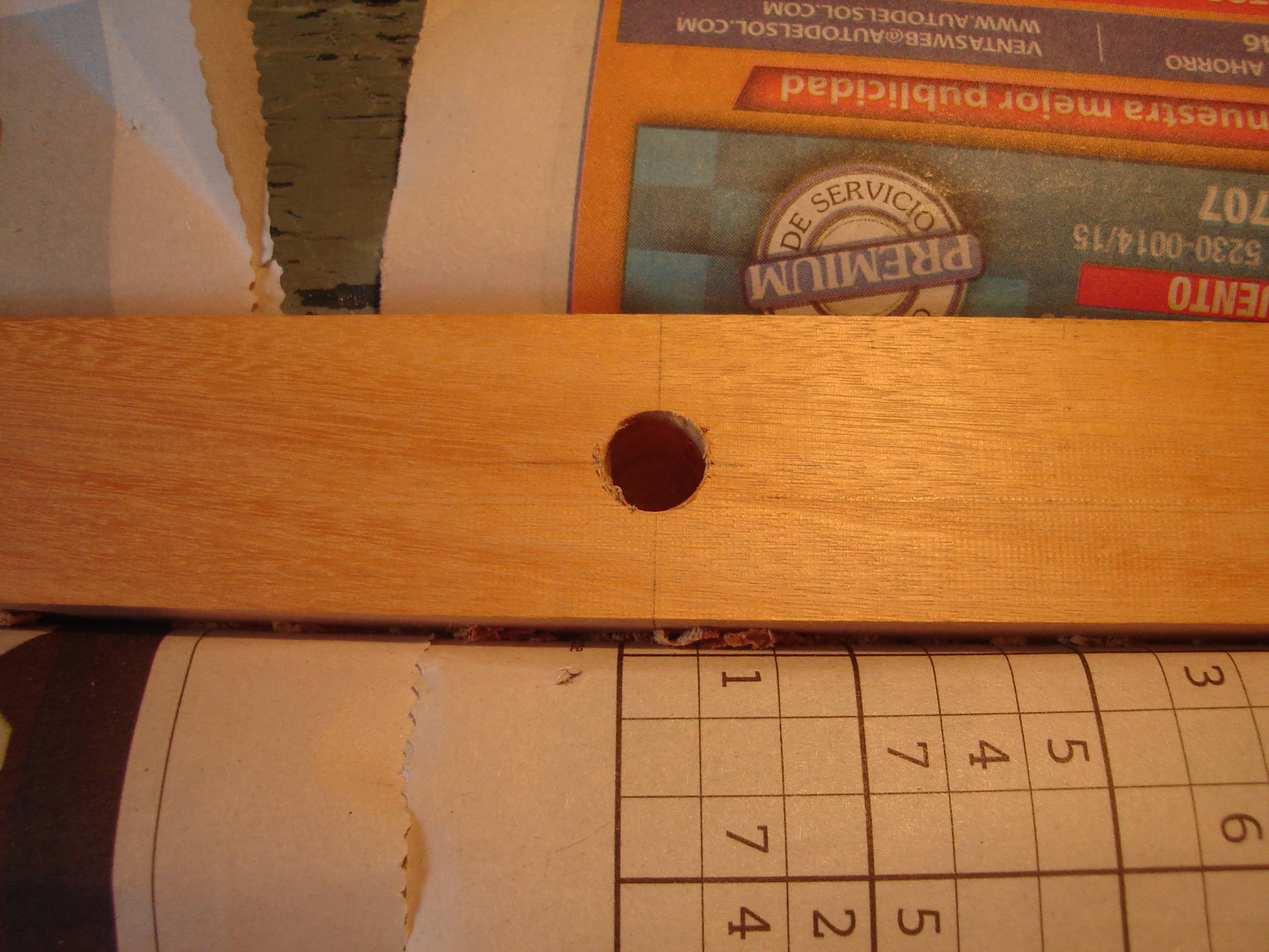

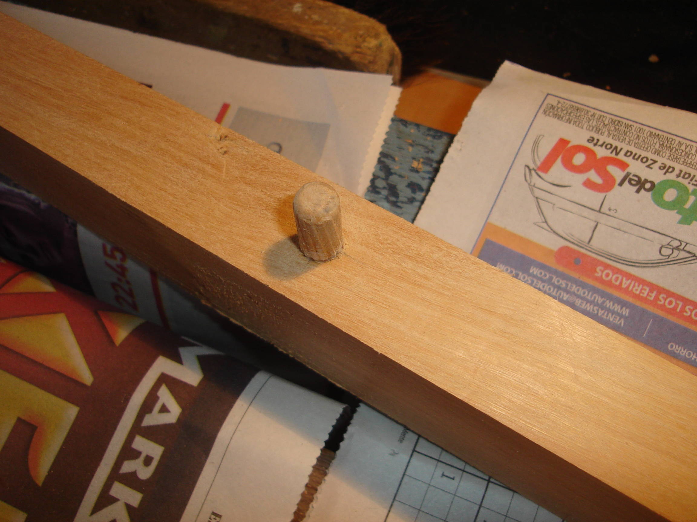

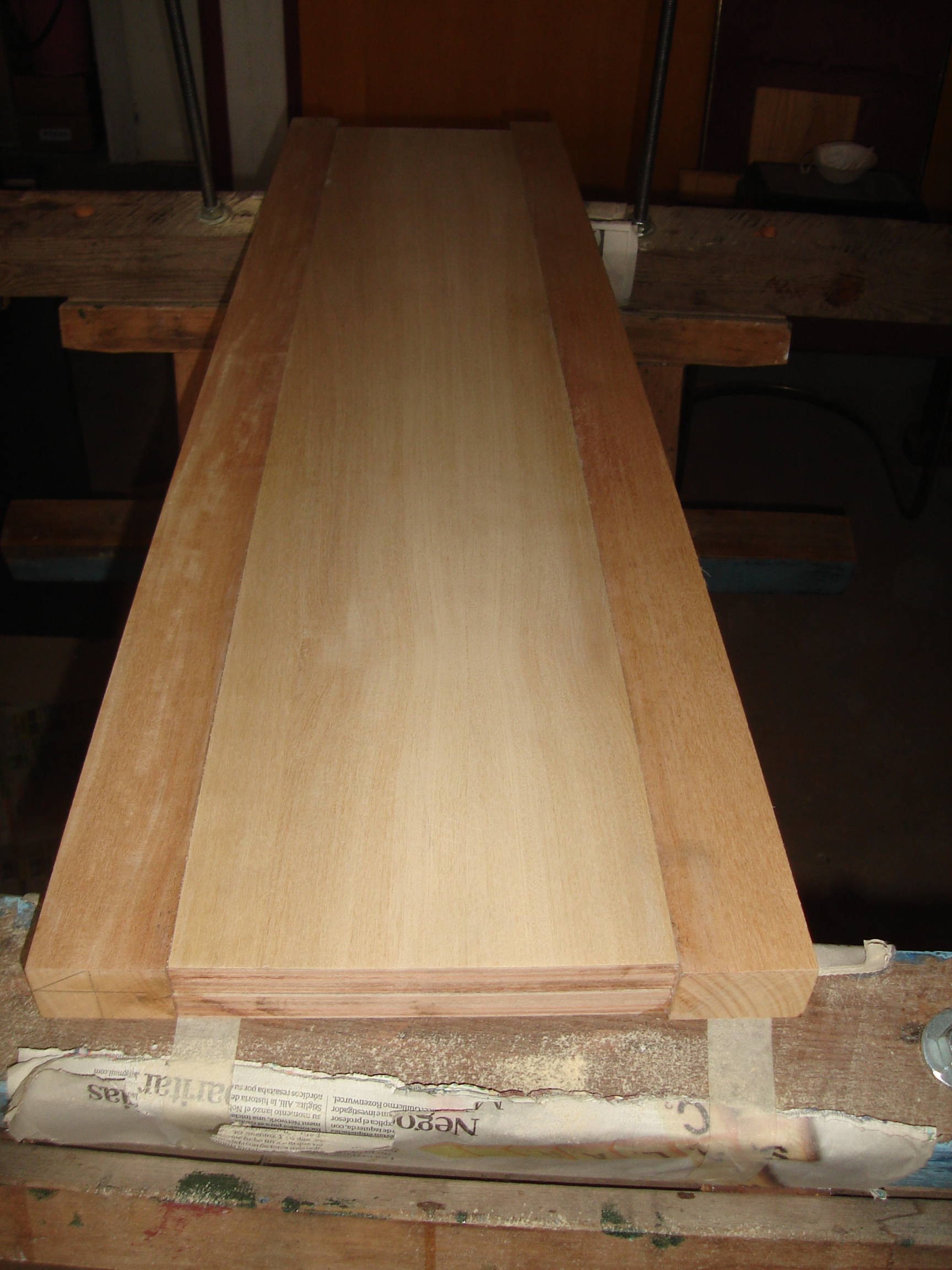

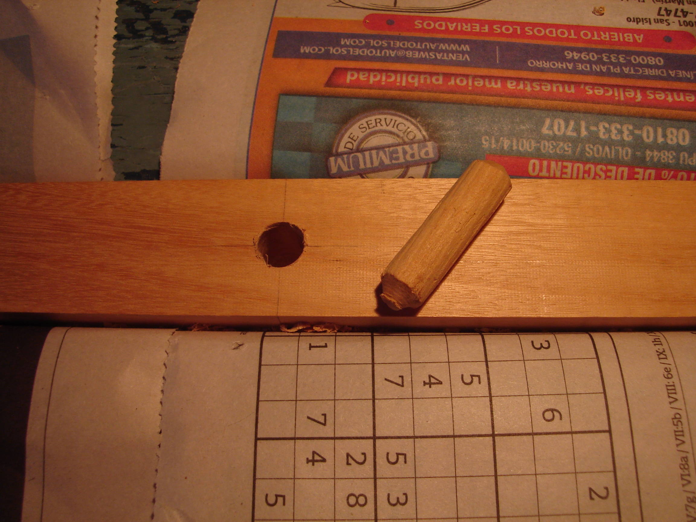

Hello !

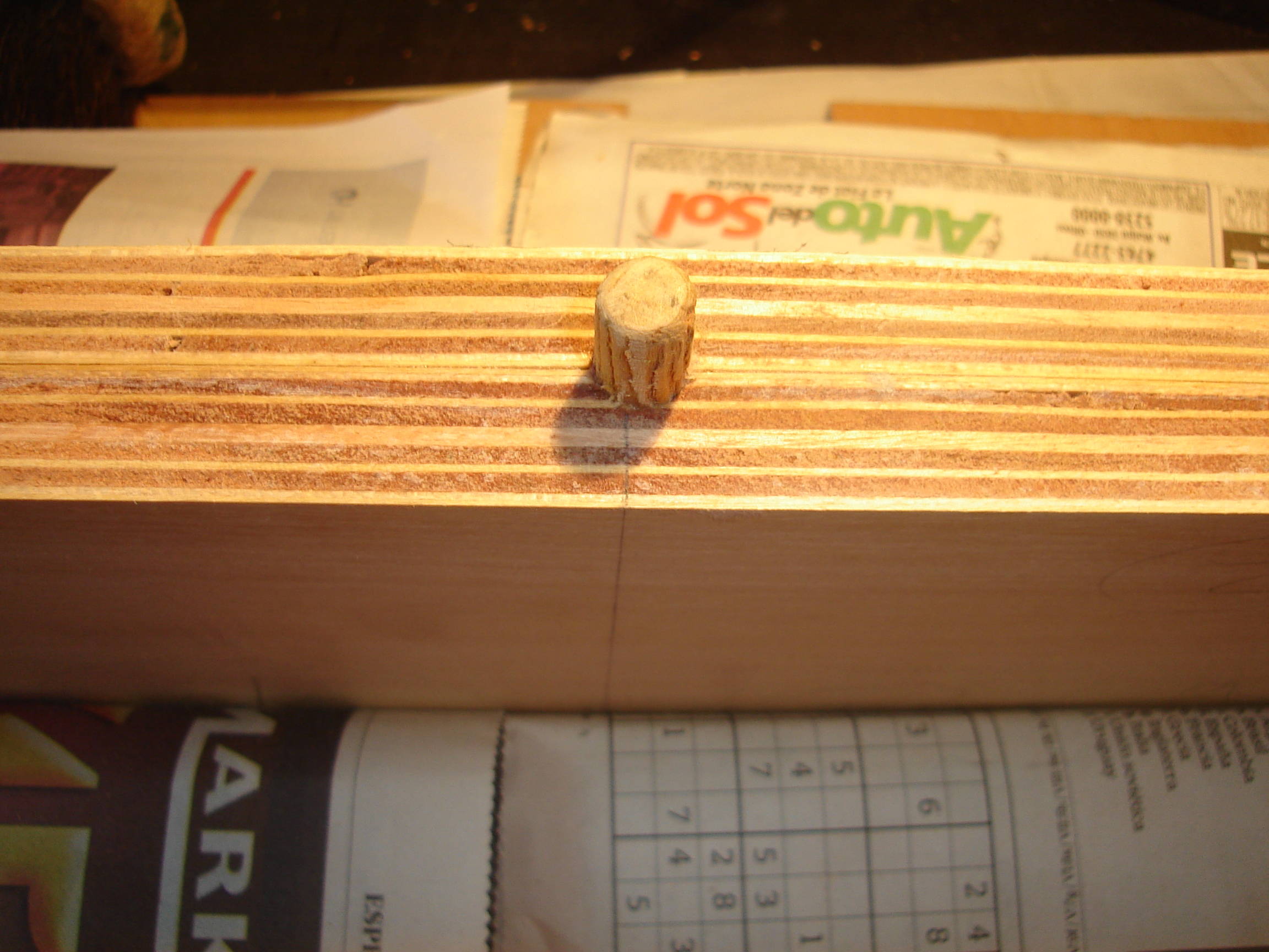

I have everything ready to glue the front panel with the side rails....🙂

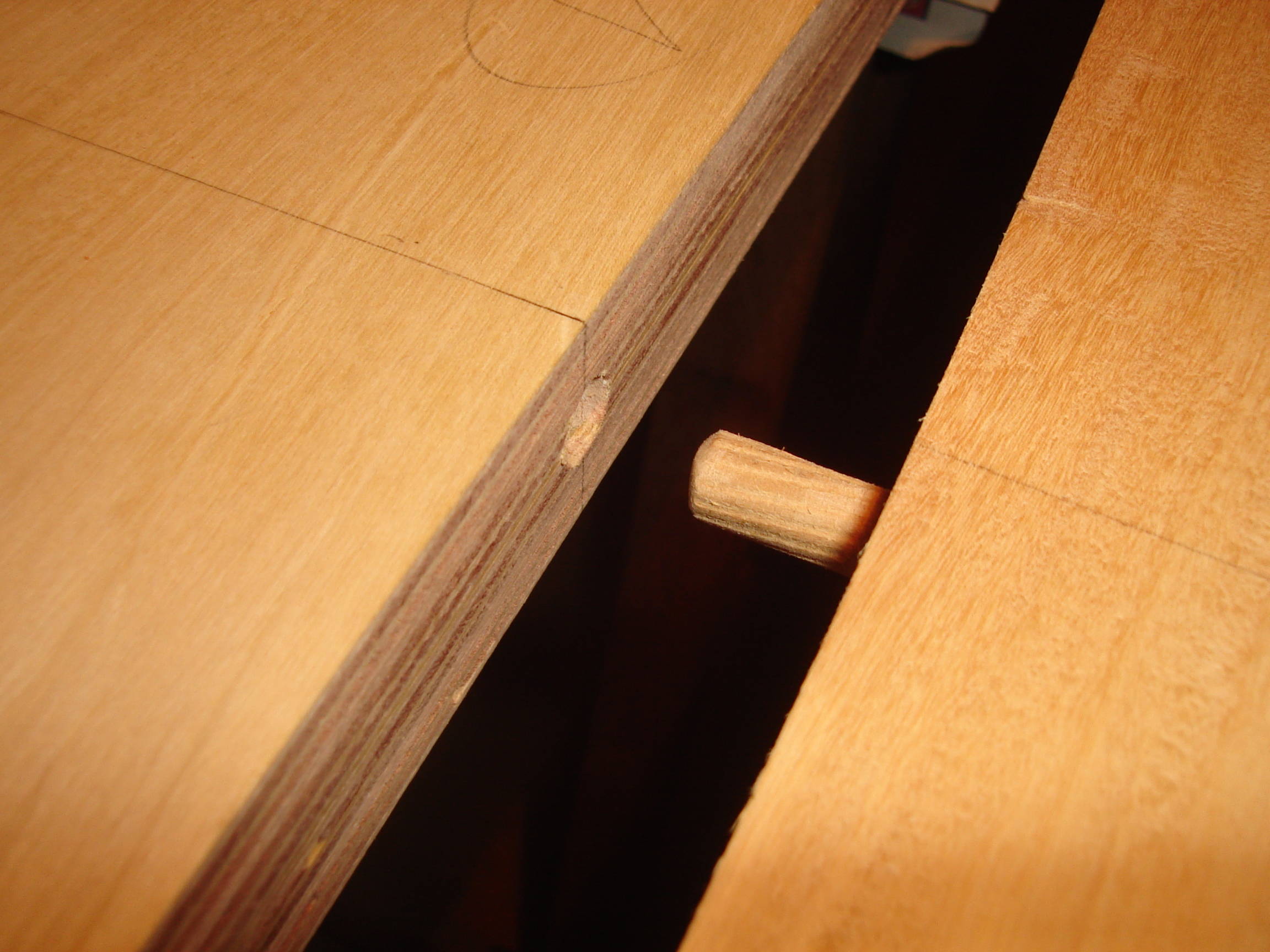

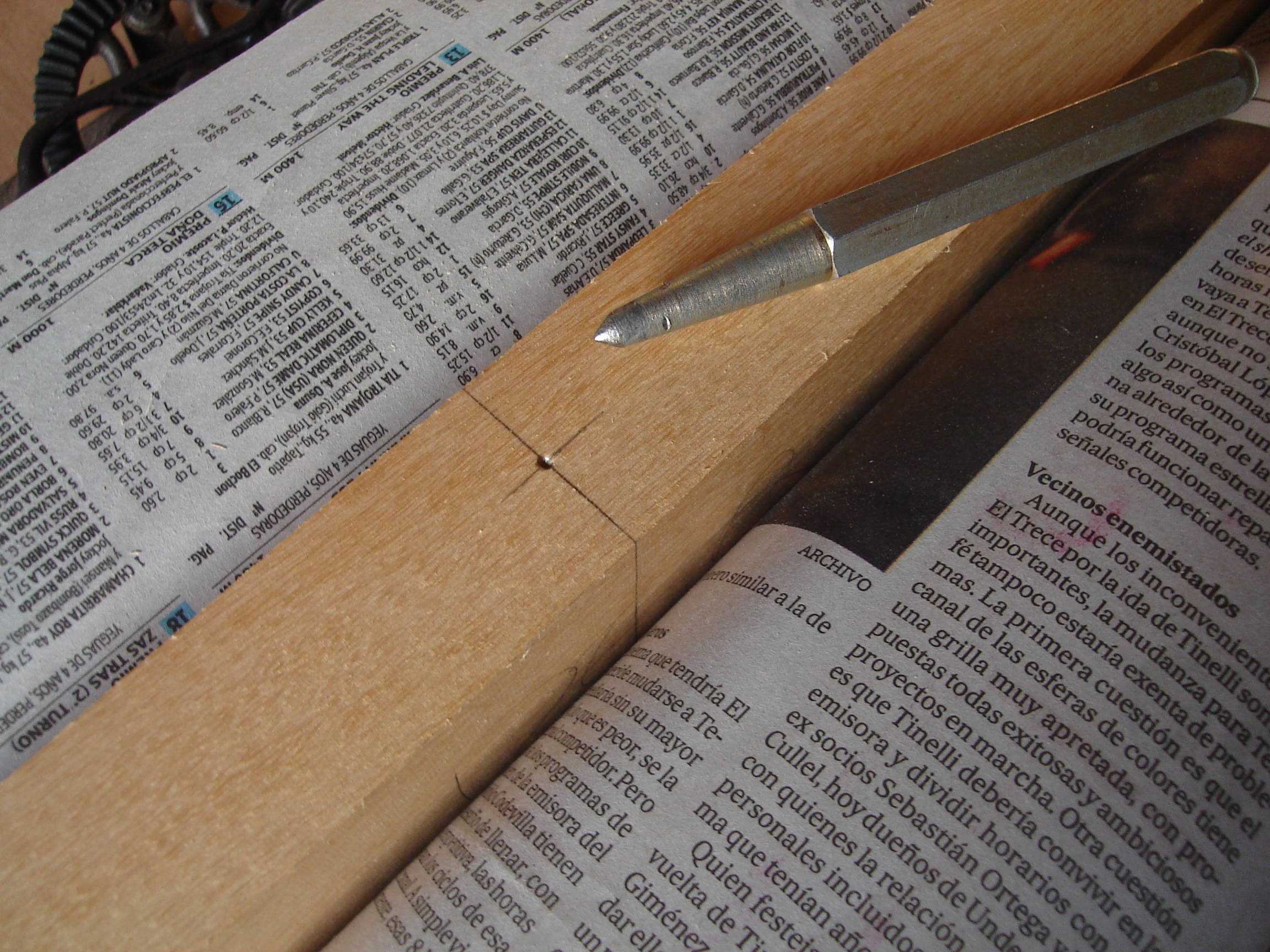

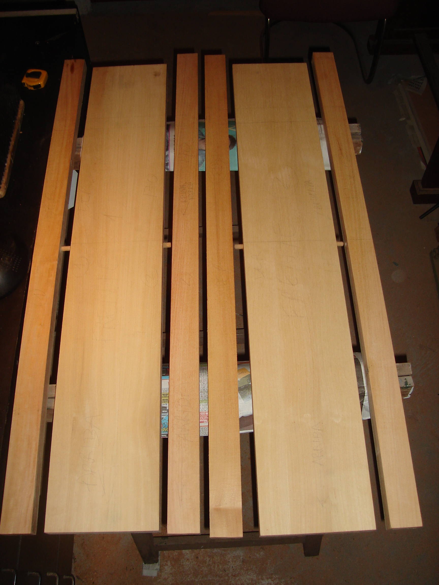

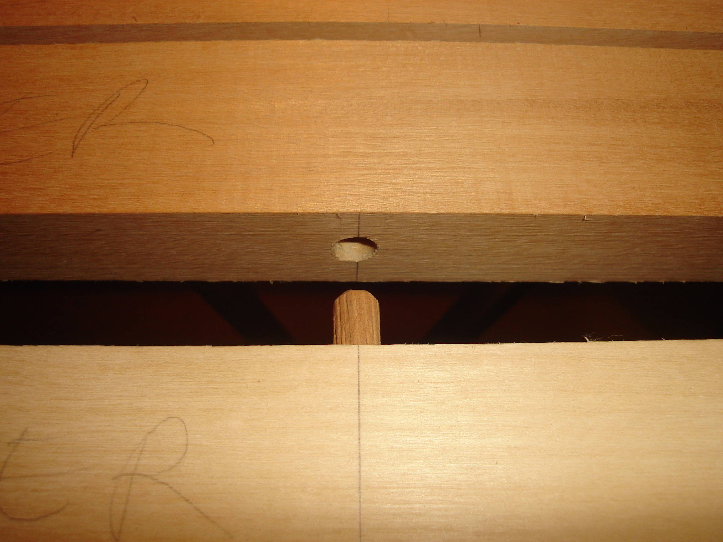

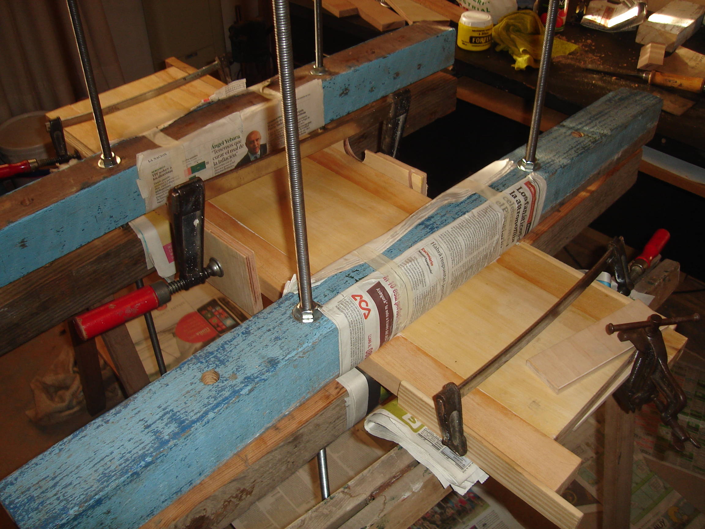

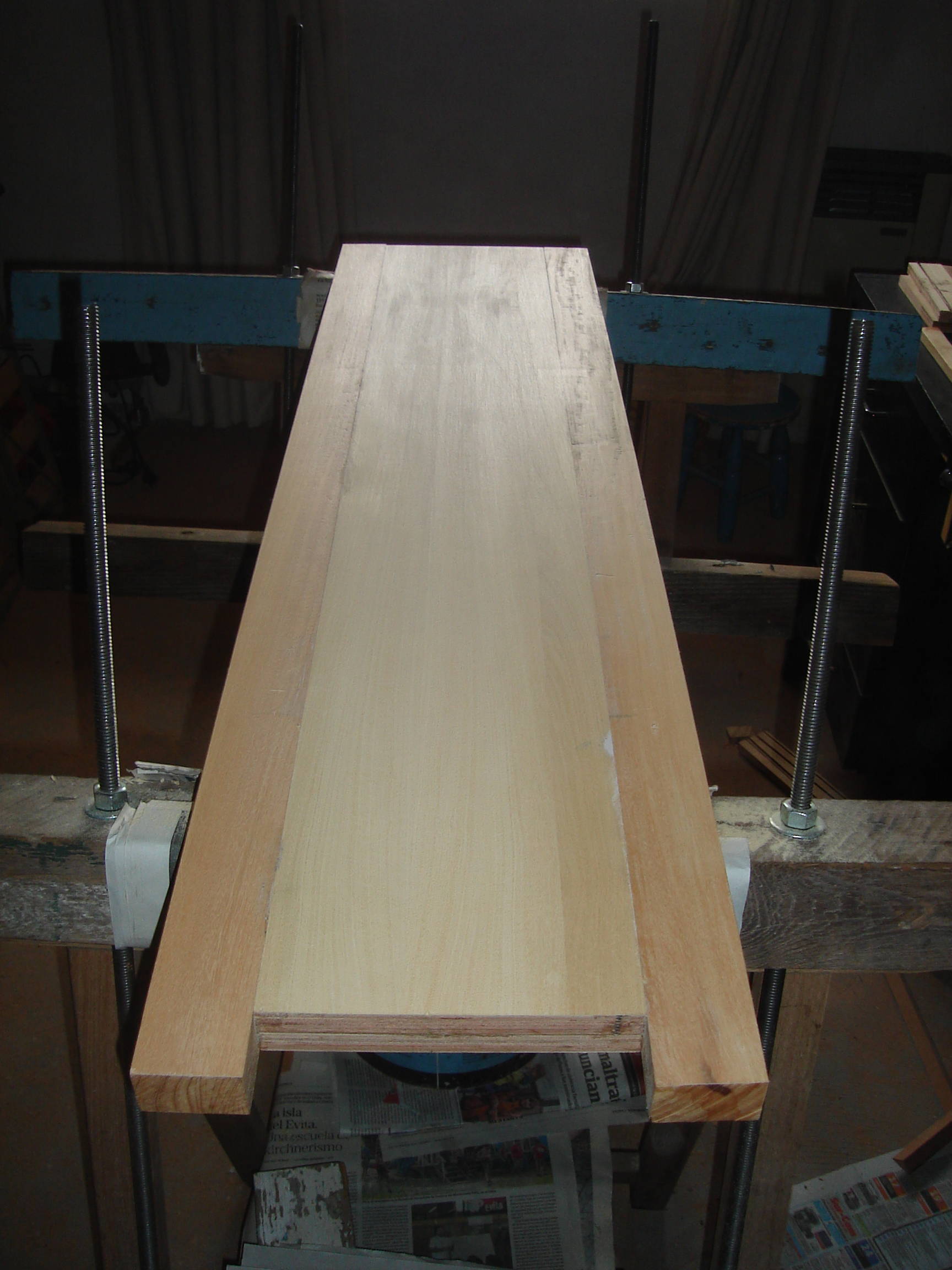

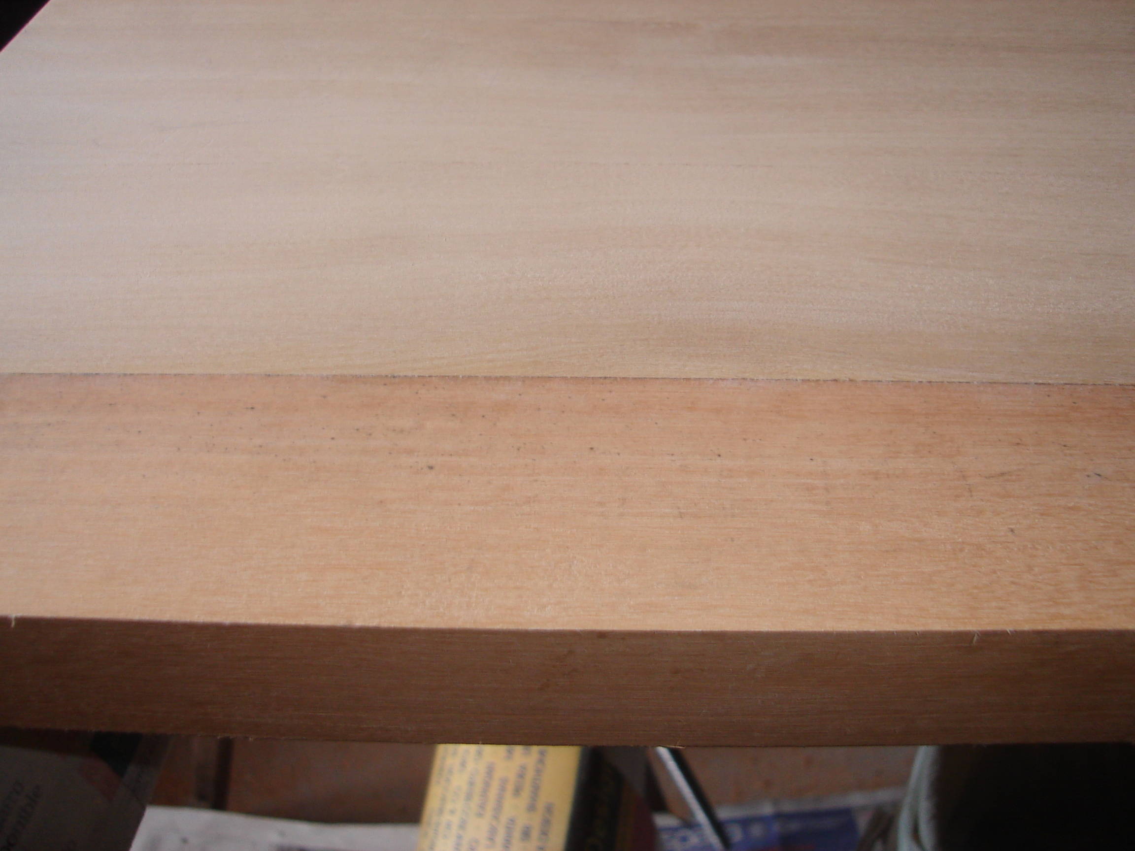

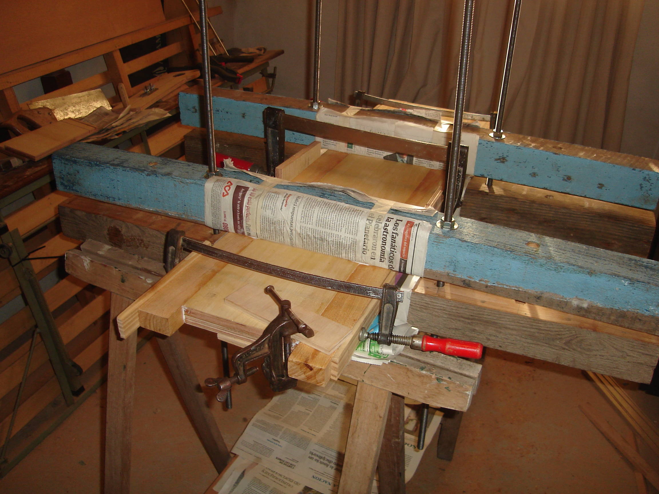

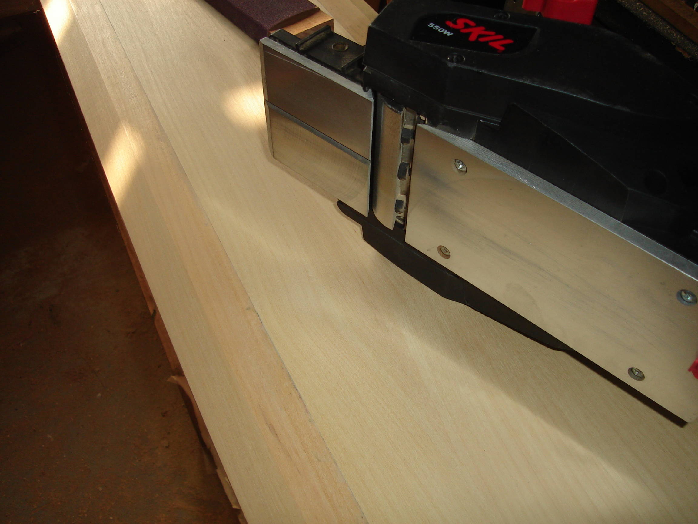

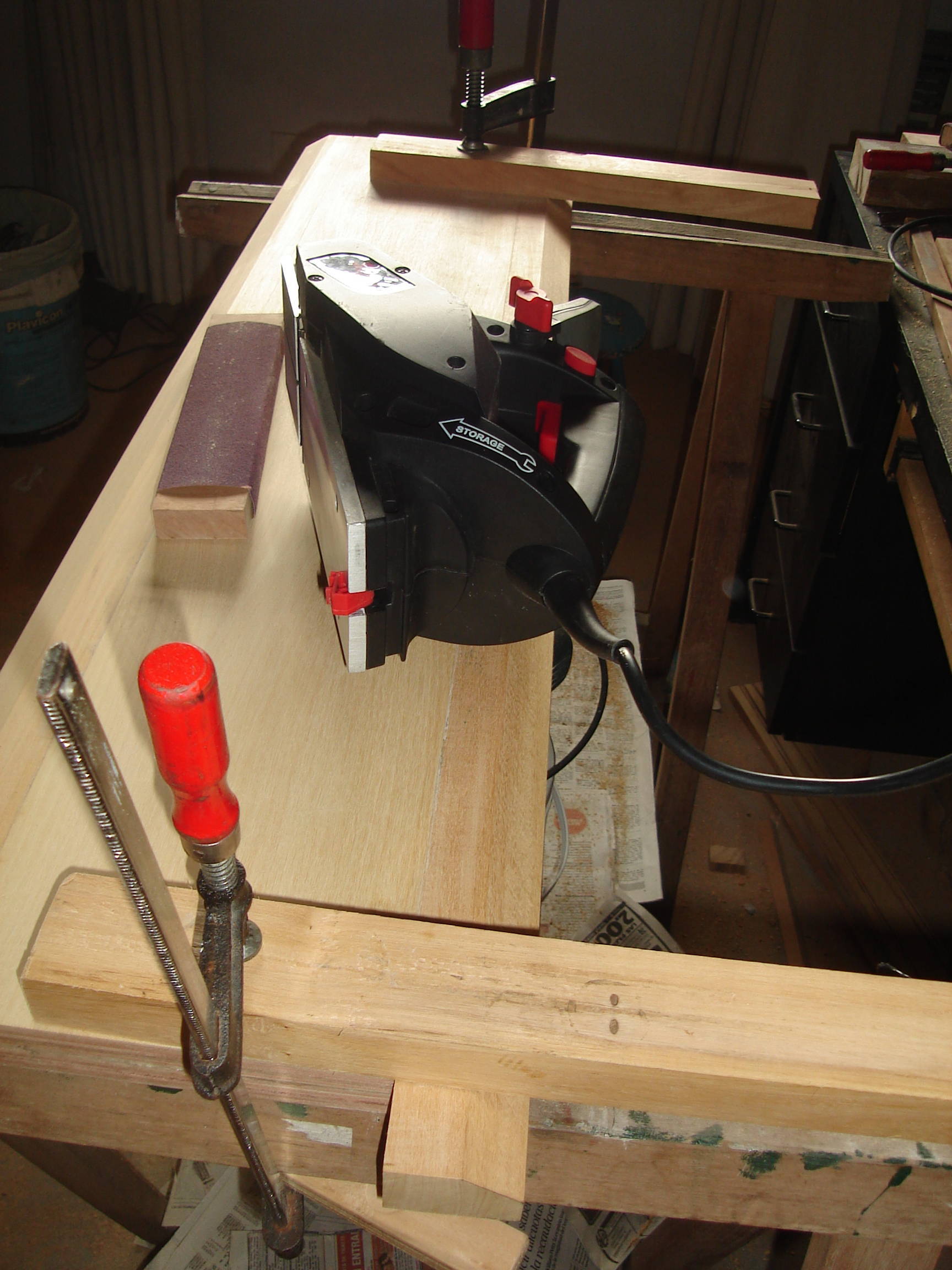

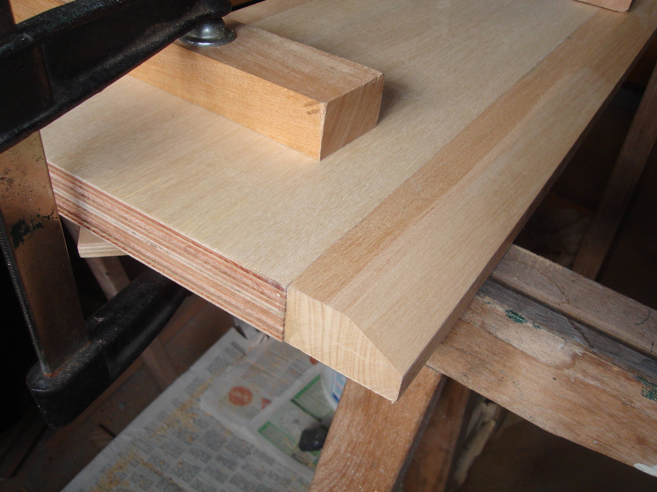

New photos of gluing the front panel.🙂
Manufactures presses I have worked well...😀
Some photos of an advance - very small - I miss, but it has taken much time and patience. It is not appropriate to use this tool. Not recommended, strongly .....
Very difficult, it is best to send a carpenter who has a router bank....🙄

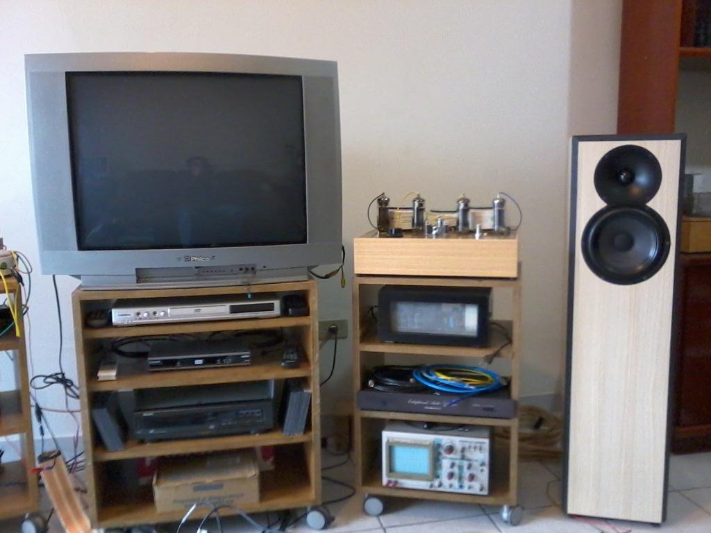

I assembled the TQWT mkII version (in attachment but please pardon my low res photos), which in my room, the bass play just right for my SPL tastes and fulfilled the goal. In fact the bass is strong and very present. So I imagine that DTQWT must be good even for bass-lean rooms.
I do not know what your musical taste, but for balanced tastes this design is very good because it has neutrality allied with excellent sound dynamics.
The photos look good, do not worry. I see there a push pull, the tubes are EL-34 or 6BQ5 ?
I look for low fastest and defined that in a bass reflex enclosure, a long time ago LE14C vintage JBL has time to go for something more current. I miss tests with the tweeter and the difference was remarkable for the Audax-waveguide ... I hope the rest behave better too.
Neutrality - low coloration - perhaps more than I care dynamic range, because I think my current speakers perform well in that aspect. They are very efficient and have good engine - BL - ?....

--The DIY PP amp in last photo uses PL509. Very rugged with lots of power with low B+. First stage with E88CC and second stage (phase splitter) with 6FQ7. But for my tastes I don't need so much power with the TQWT.
--for bass dynamics I consider the TQWT more punchier than all my sealed or vented tentatives. And more tonally correct. Part of this is because of JA8008 driver. Is very well behaved and don't have obvious vices/colourations like most drivers, even expensive ones, at least for my ears...
I see now that the board is fed out to the cable .... 😀
Delivery few watts that valve on your push-pull configuration ?
I'm glad to hear that, JA8008 now improved ... but hope I have not lost much with an old model ....🙄

As I have said, it does not provide other levels other than what is on the web.
I had to recalculate some steps that decided to use a thicker rear panel, you can see it on the plane that I attached, but it will not help you MKIII

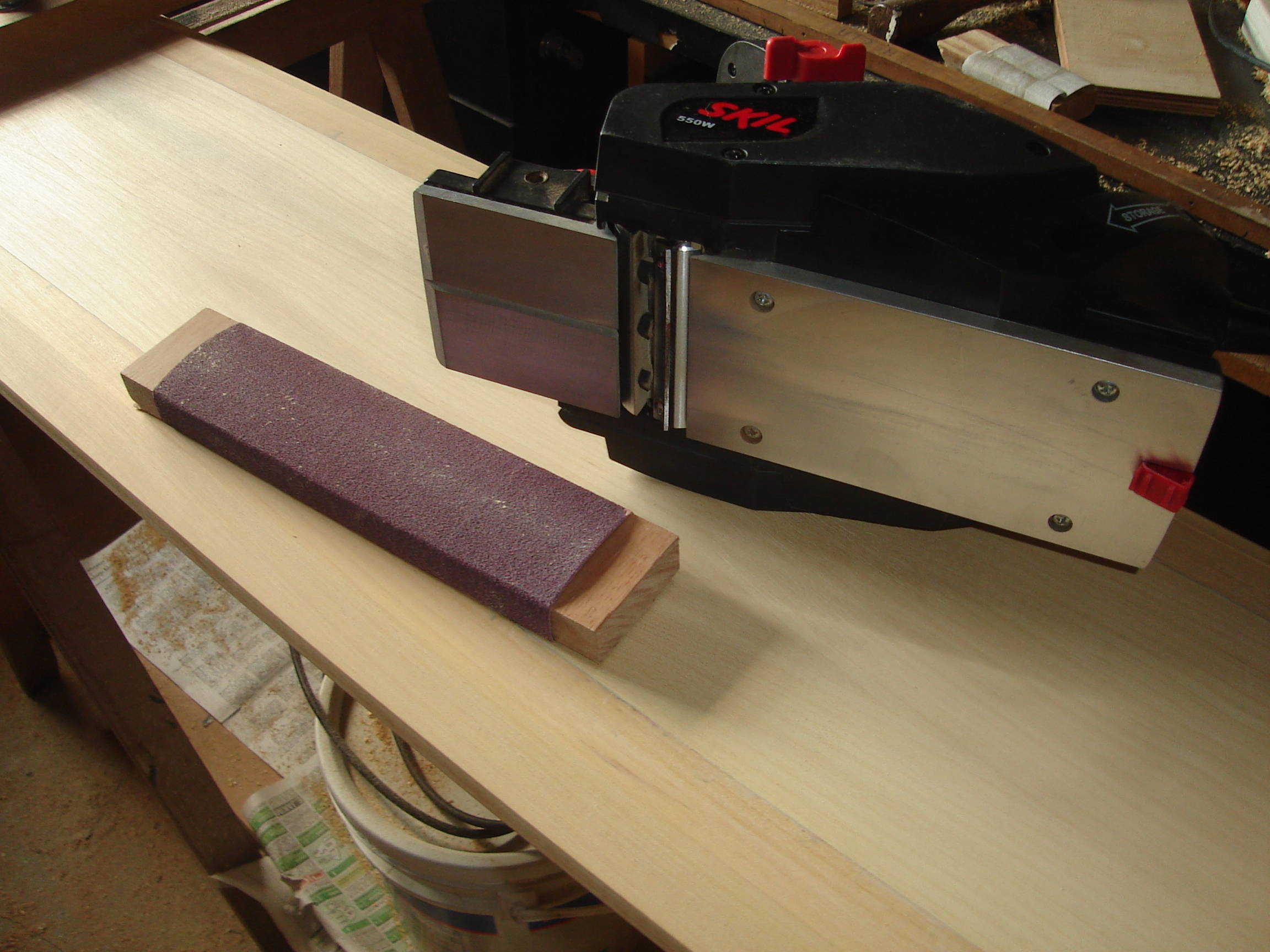

A planer is good also!
Hummmm, not help much if the panels are cut to buy the exact measurements .....
I think the success of the construction depends largely on this, calculate well before ordering the cuts and will ensure accurately.🙂
Thanks for your suggestions.
I suspect you suggest a planer so as to trim cut pieces a a hair to fit perfectly?
Since I have a small table saw. cutting big pieces on it will prove difficult. As an alternative I am thinking of cutting them with a circular saw with a guide clamped to the wood. However from past experience cuts are sometimes not exactly 90 degree edges. Any suggestions.
