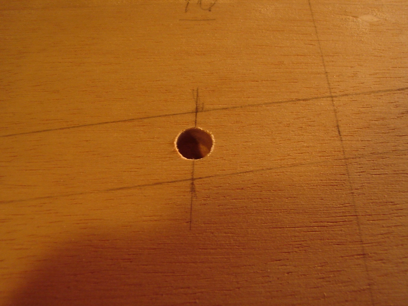

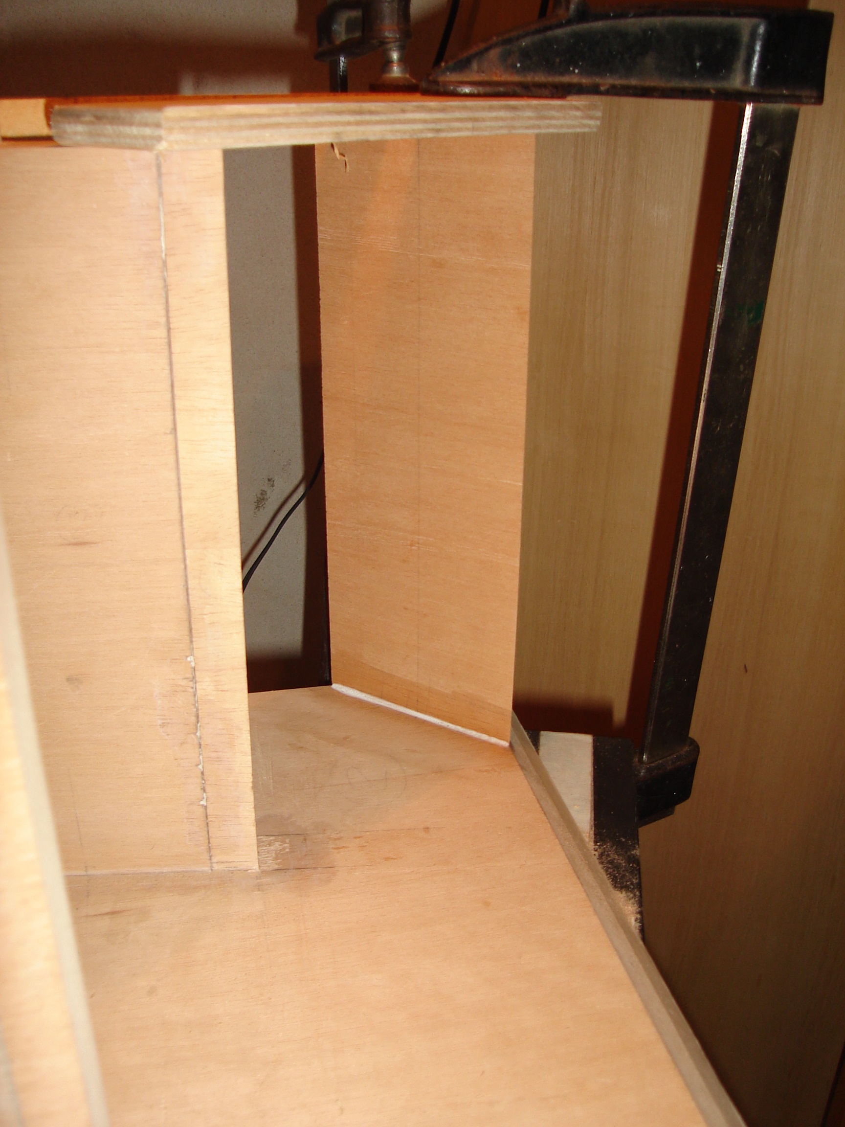

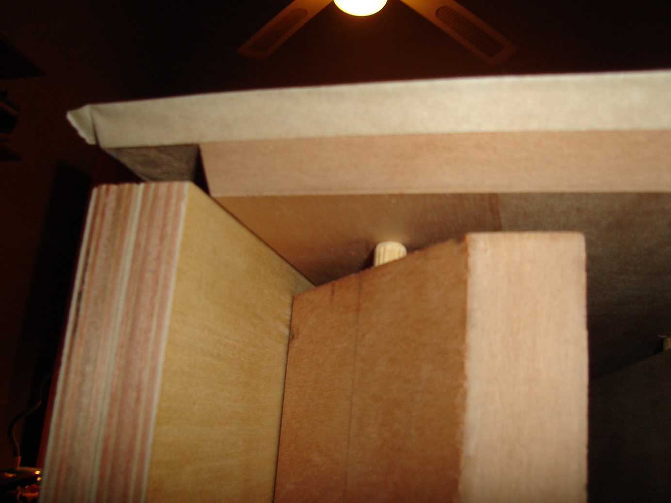

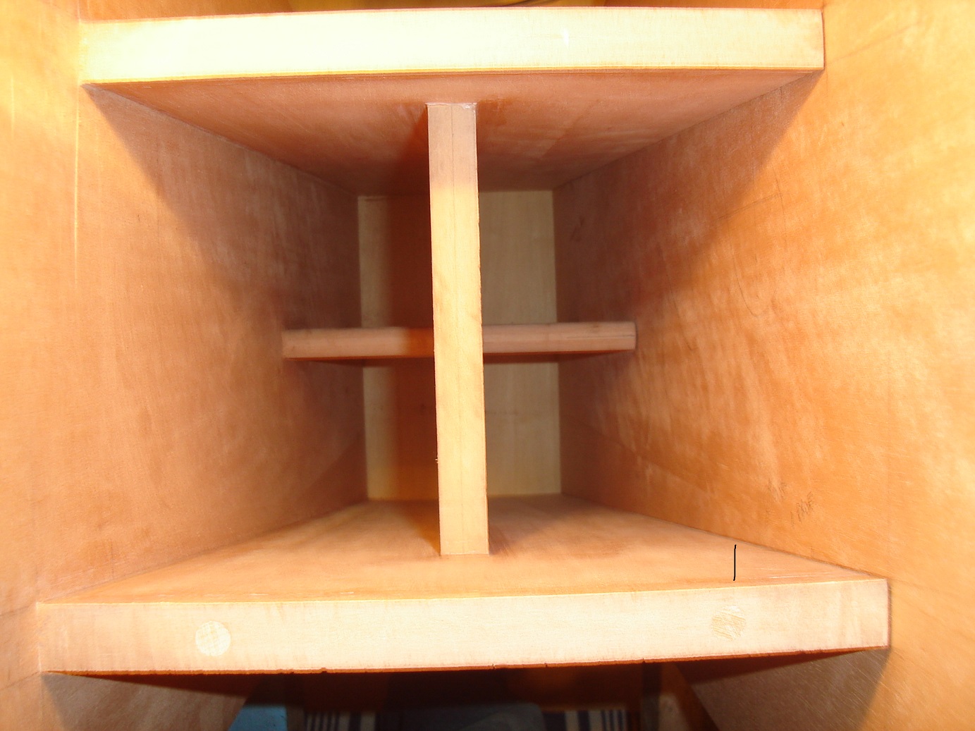

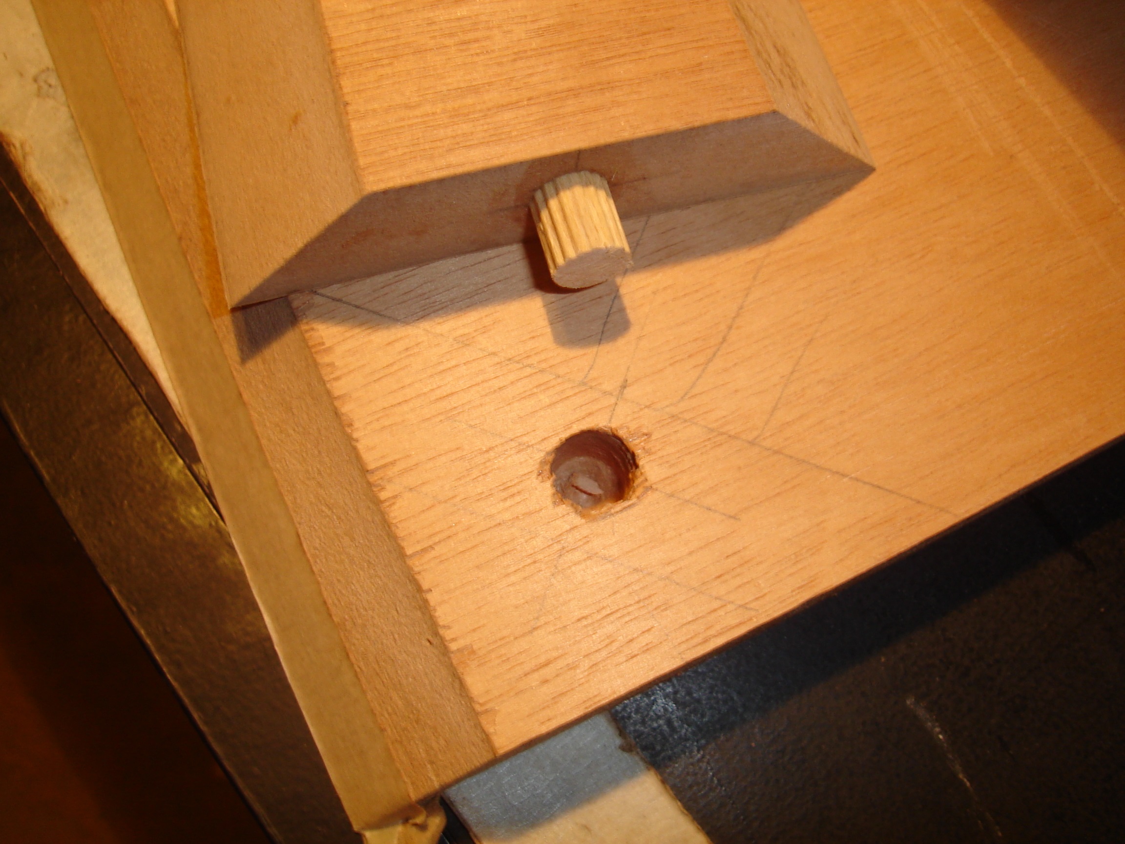

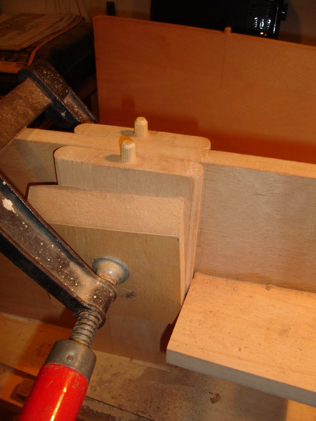

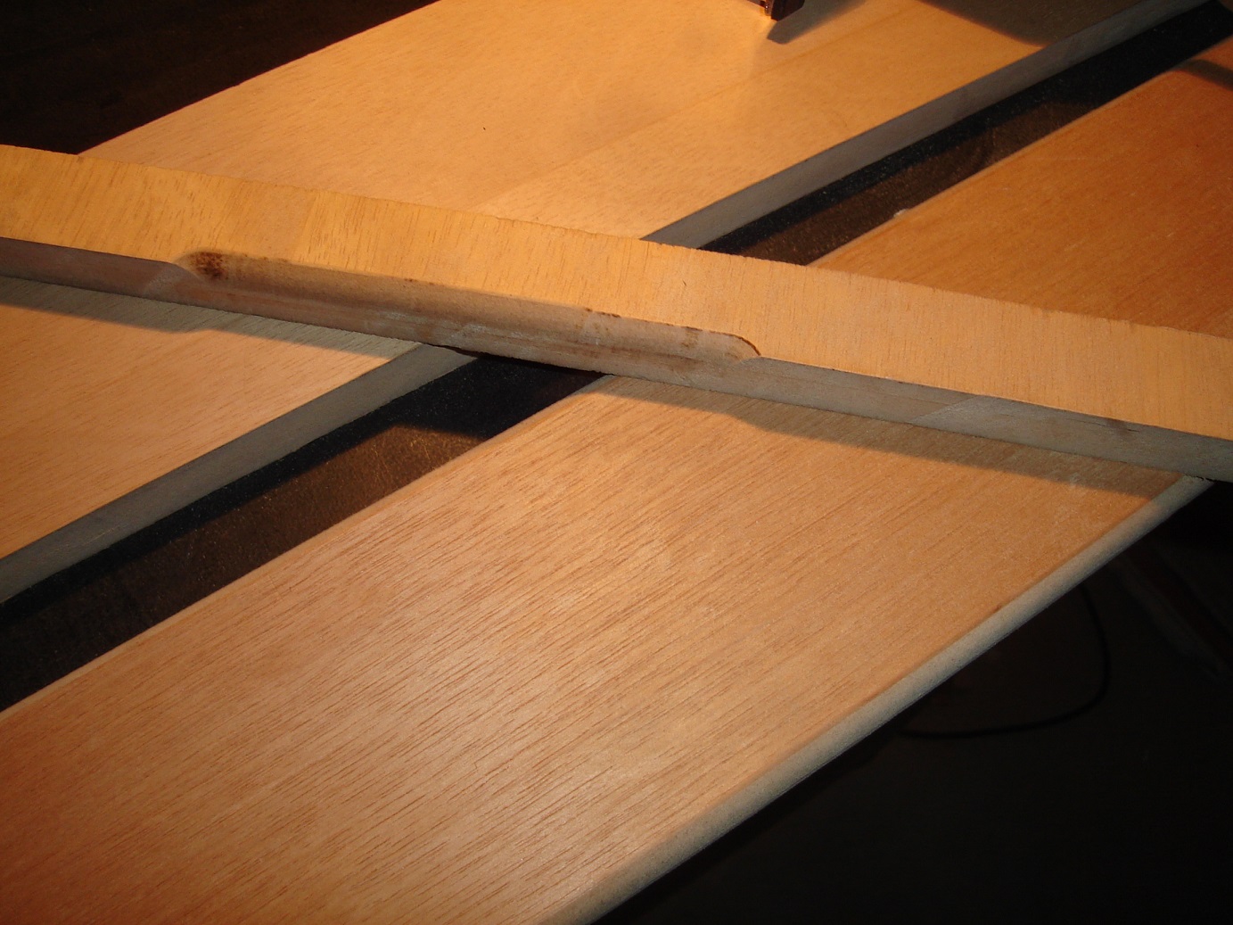

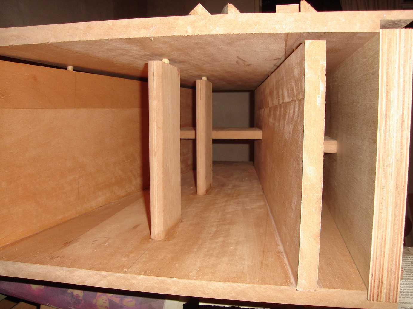

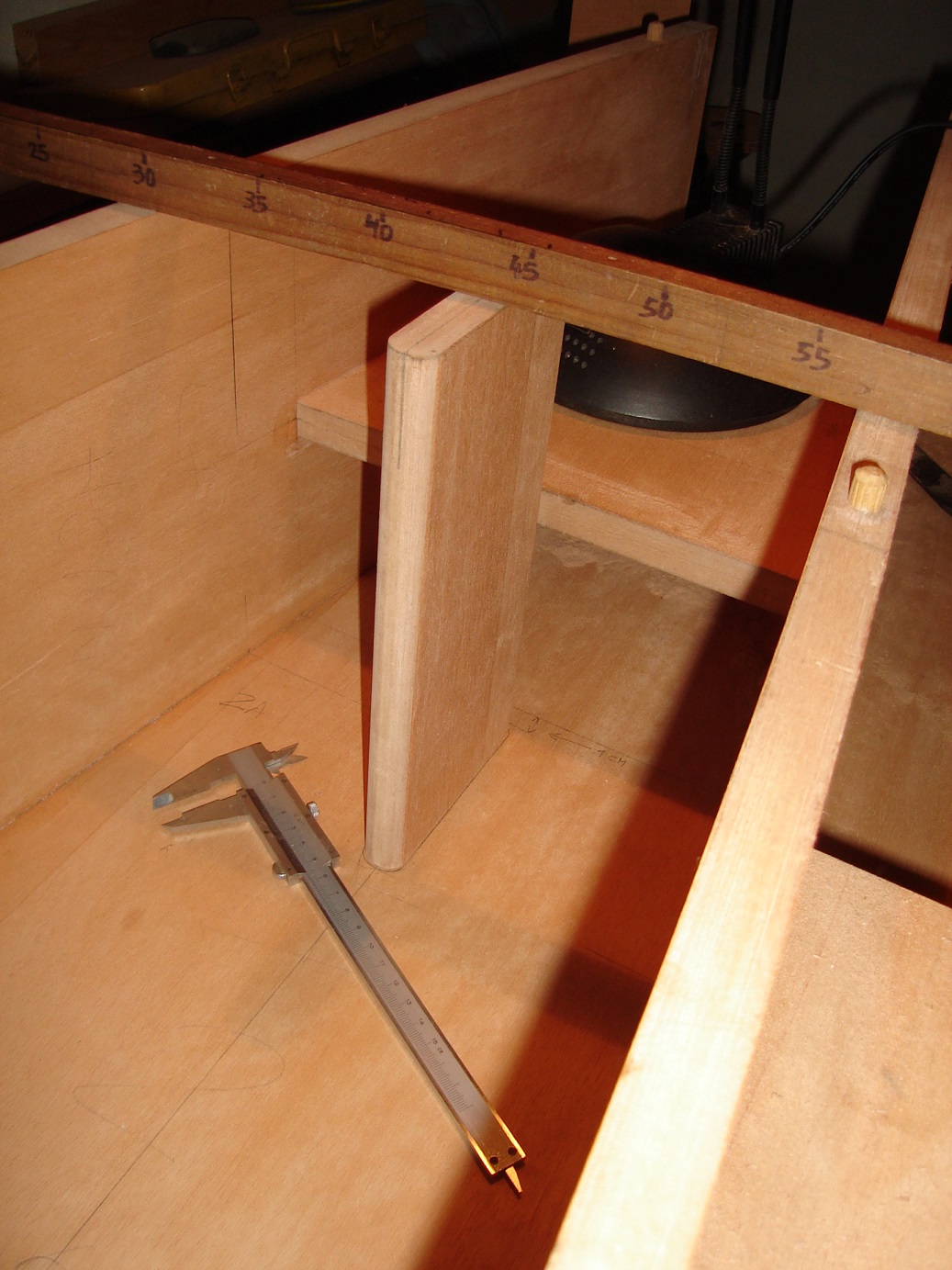

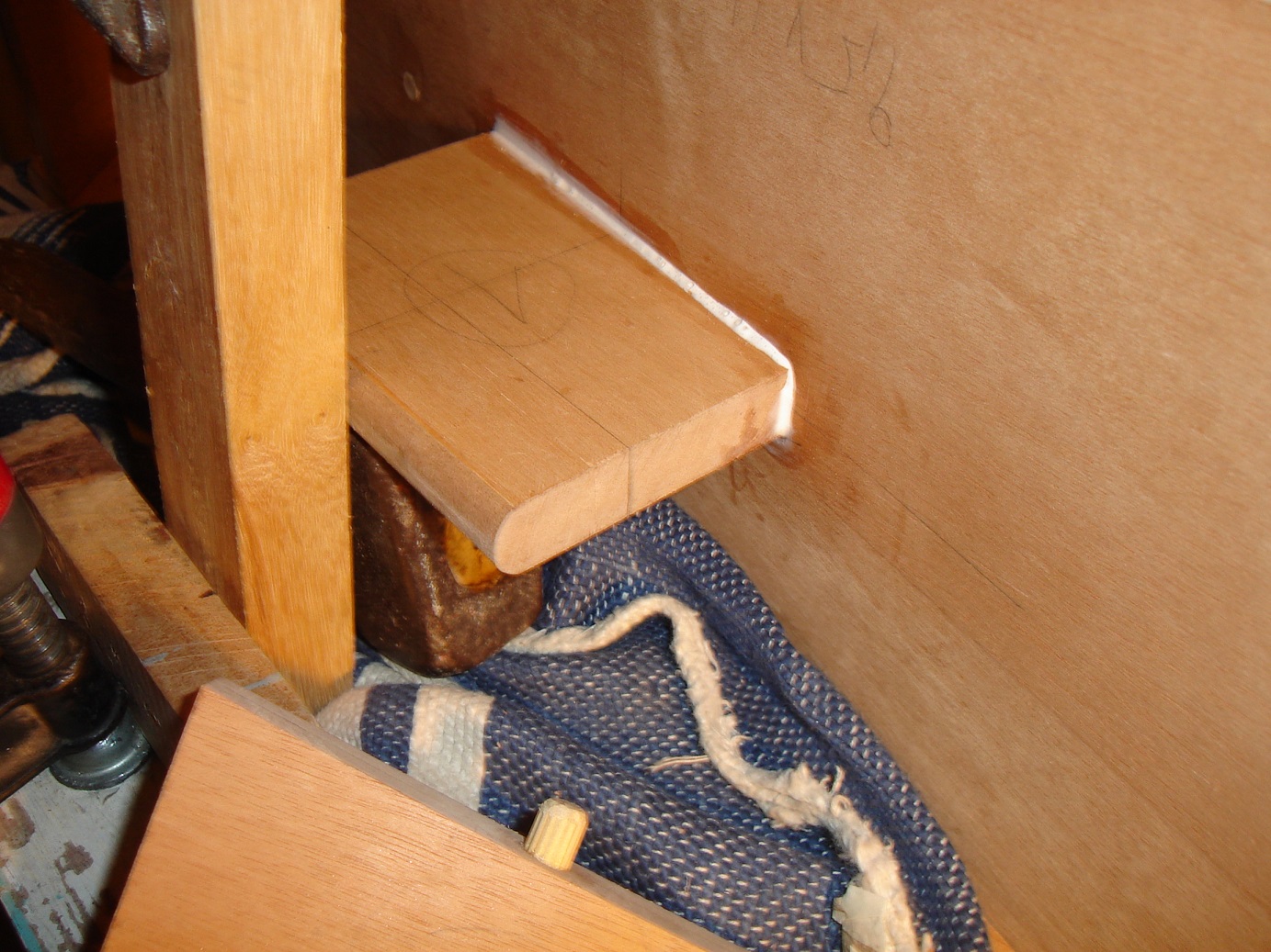

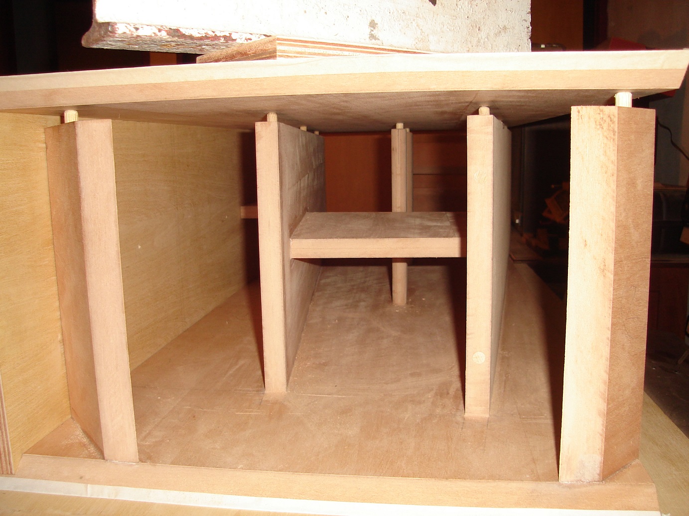

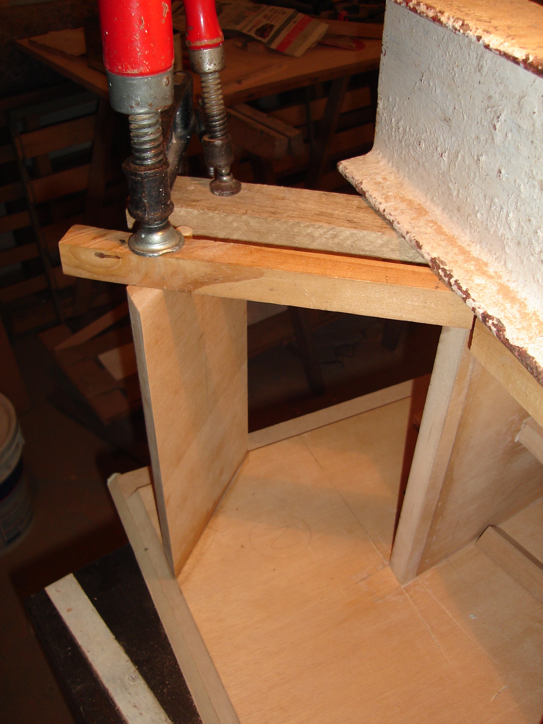

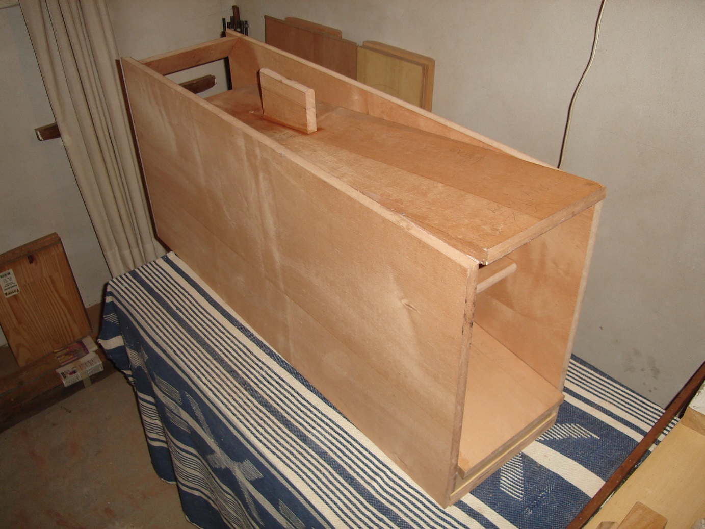

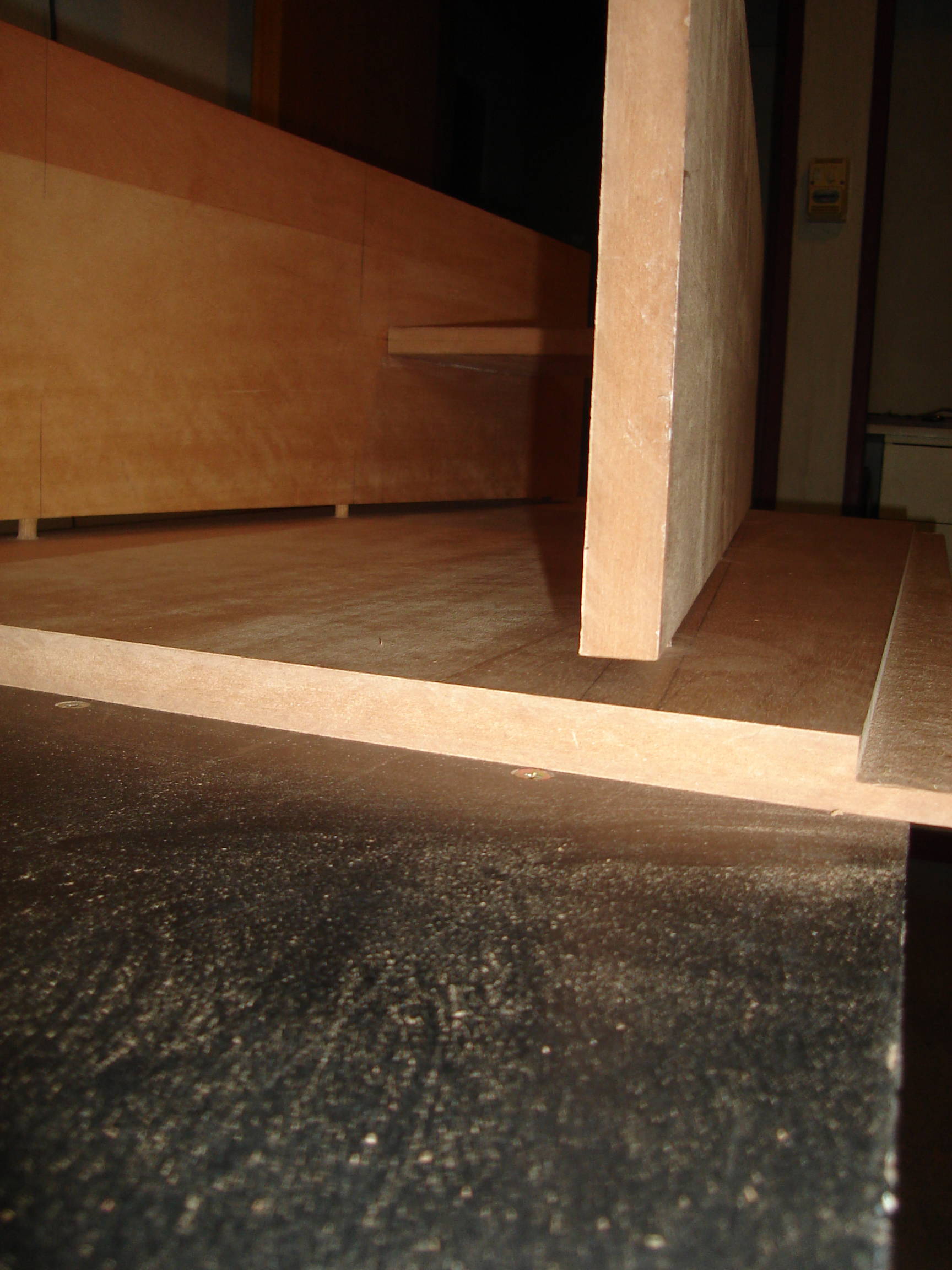

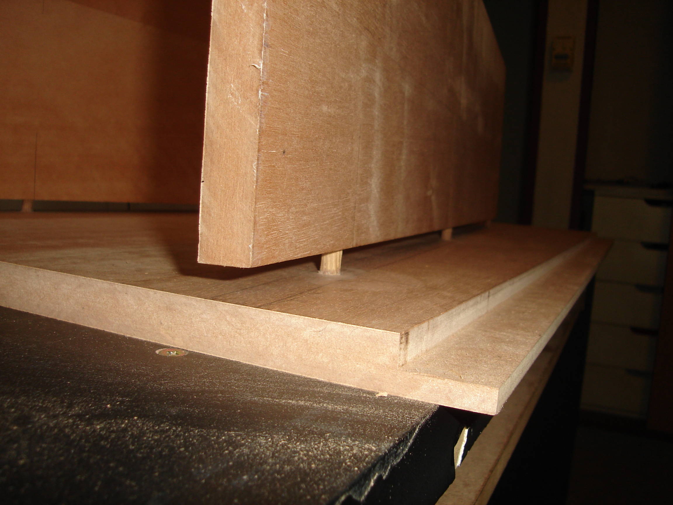

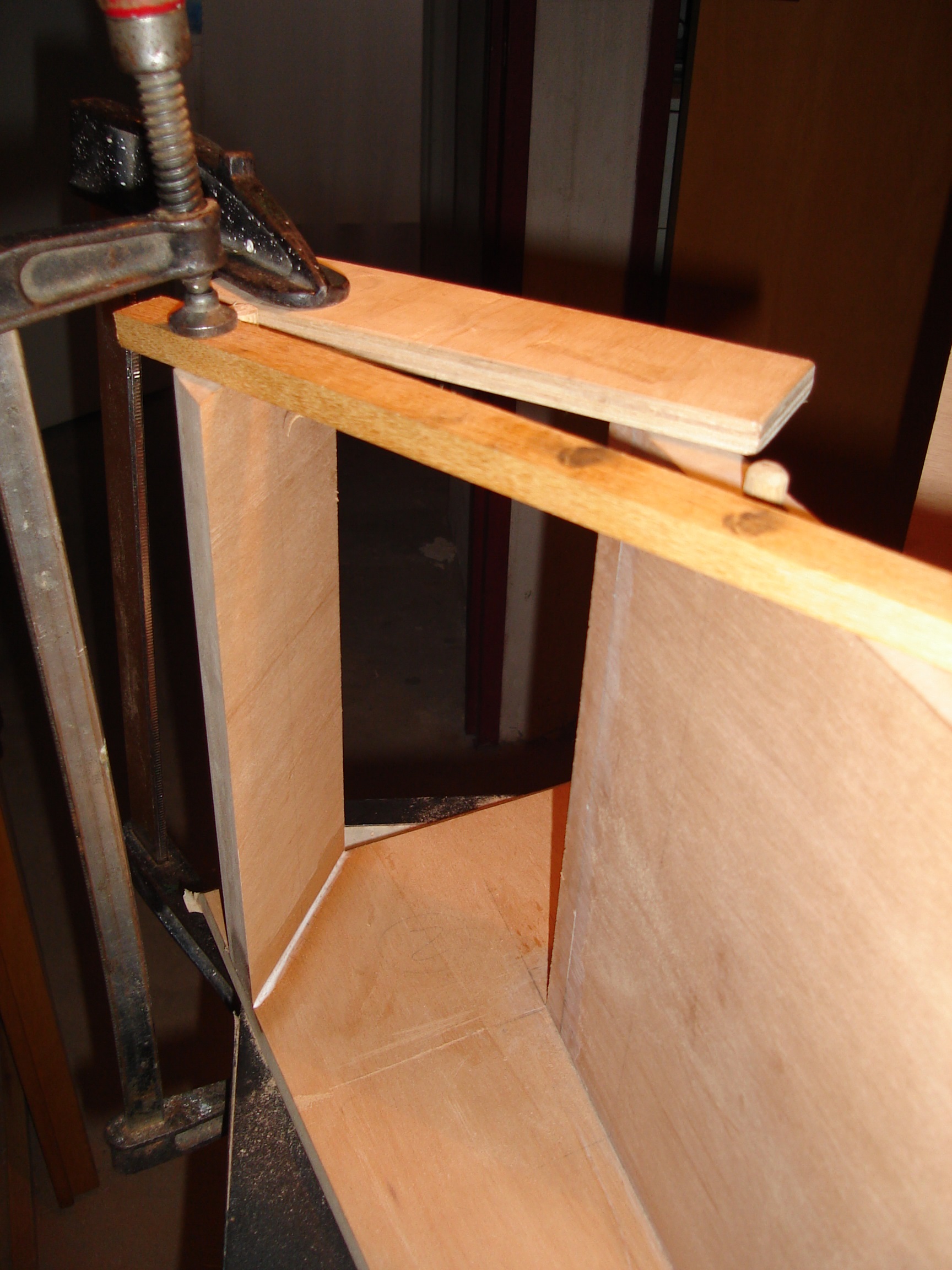

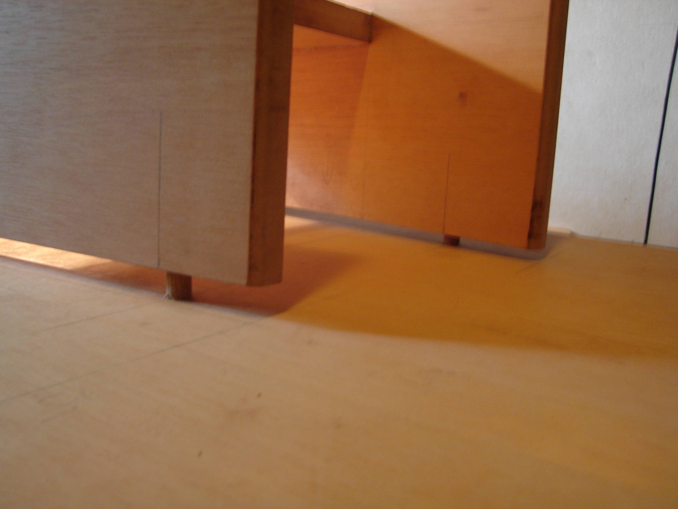

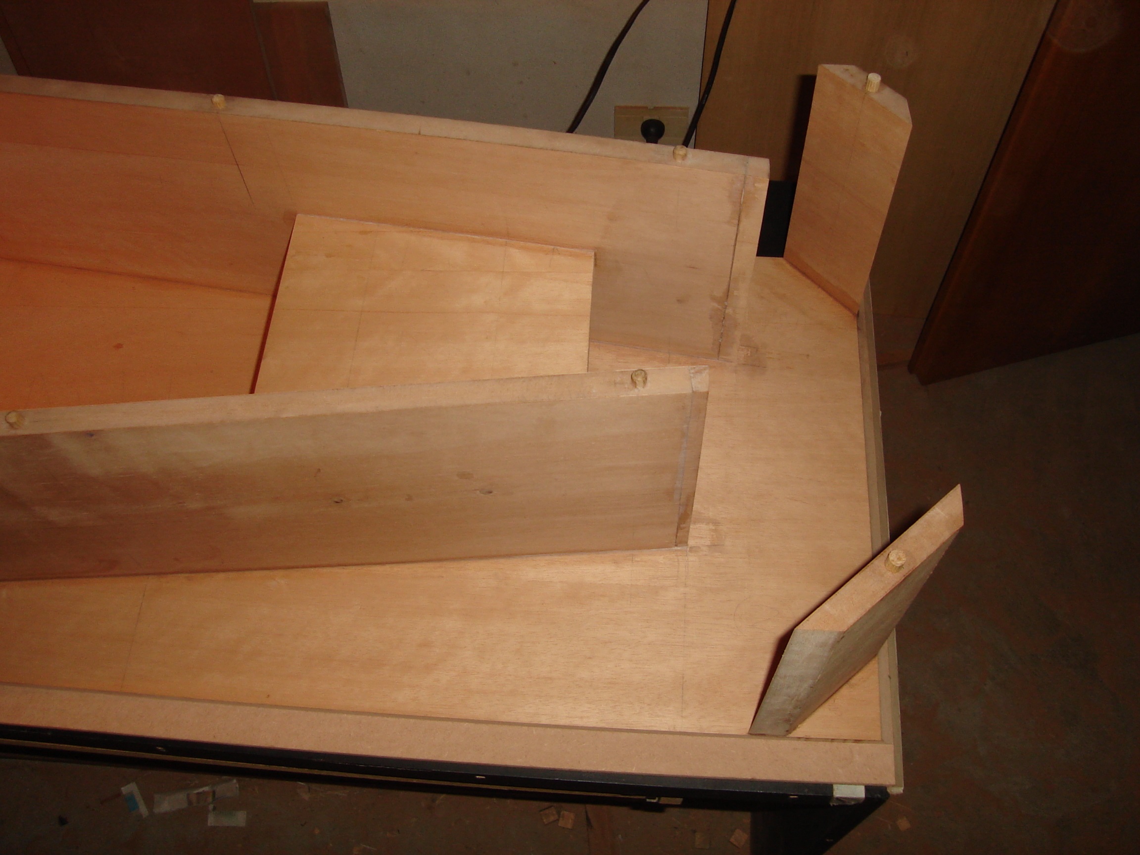

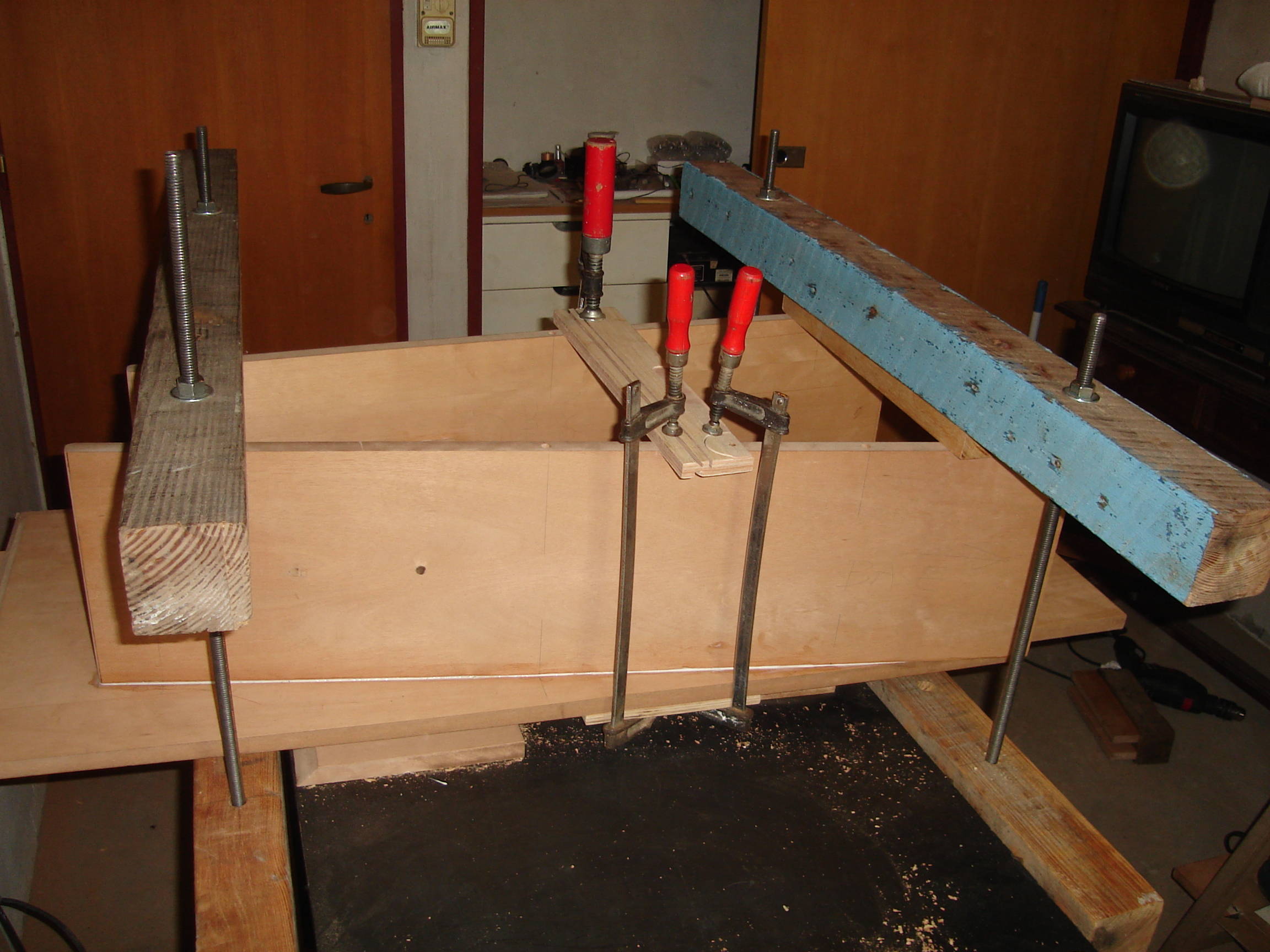

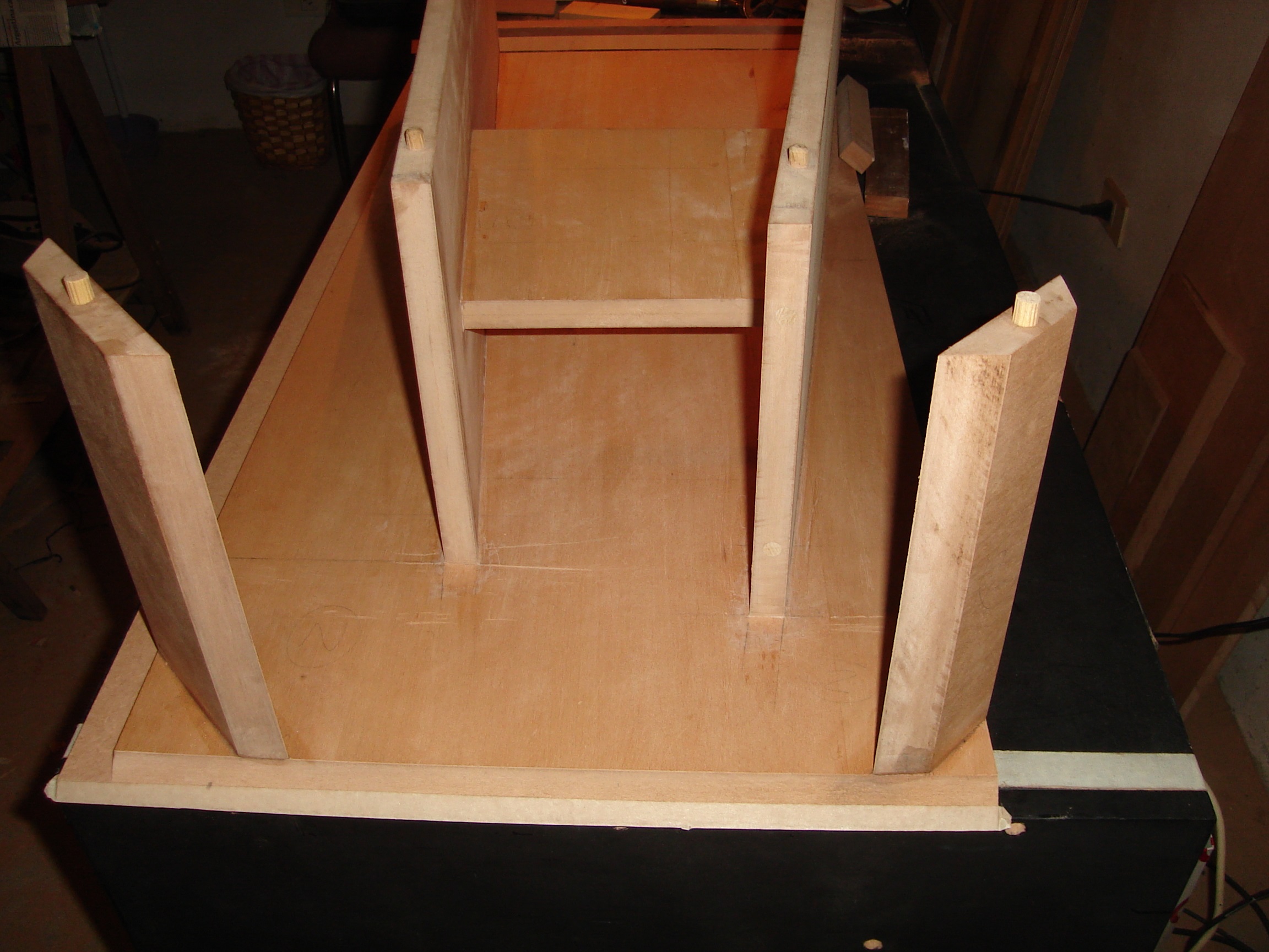

Hi :
I could restart the building after a forced interruption.
Here the inner corner, all in place with dowels, as always.
Greetings to the community

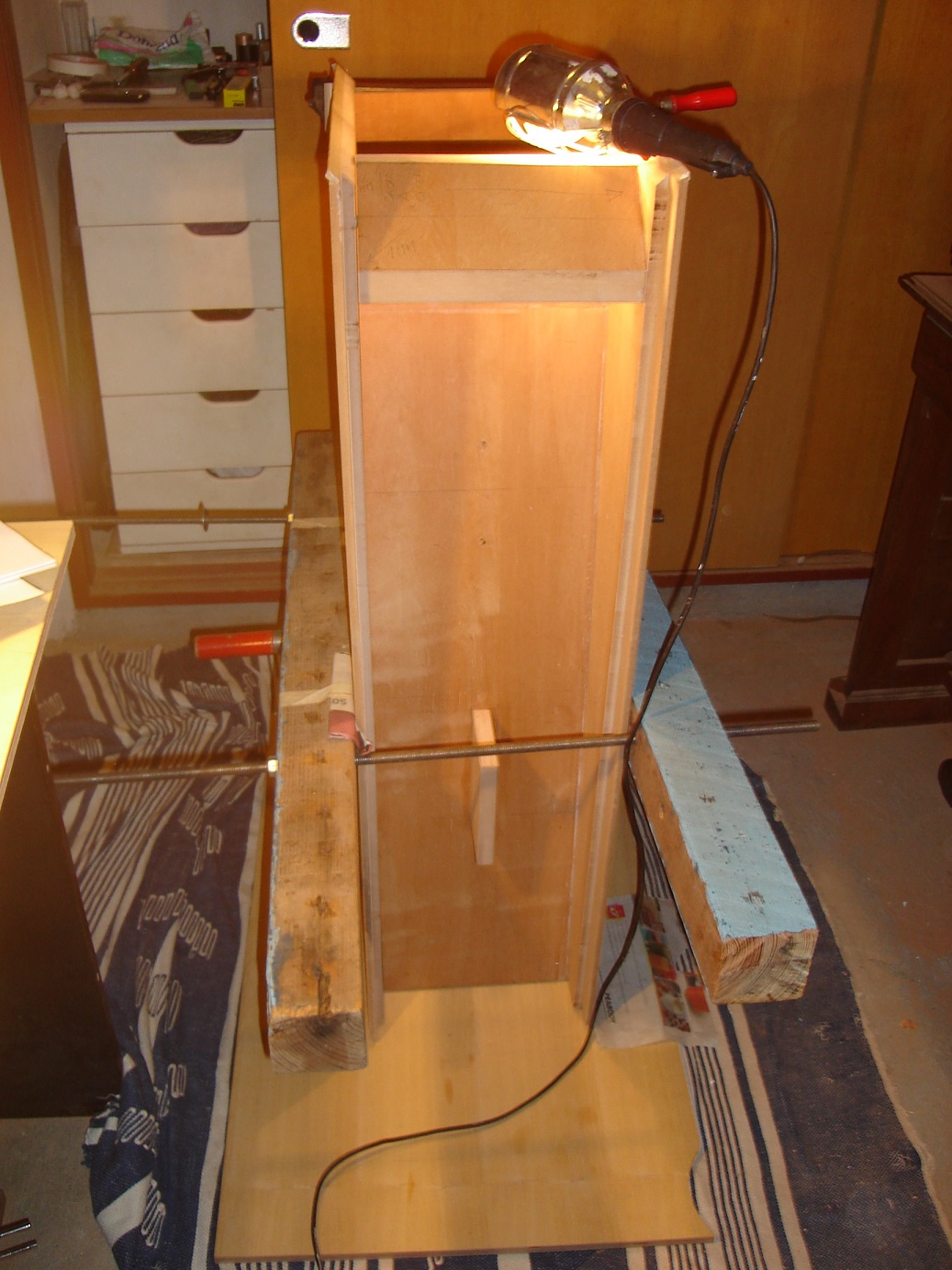

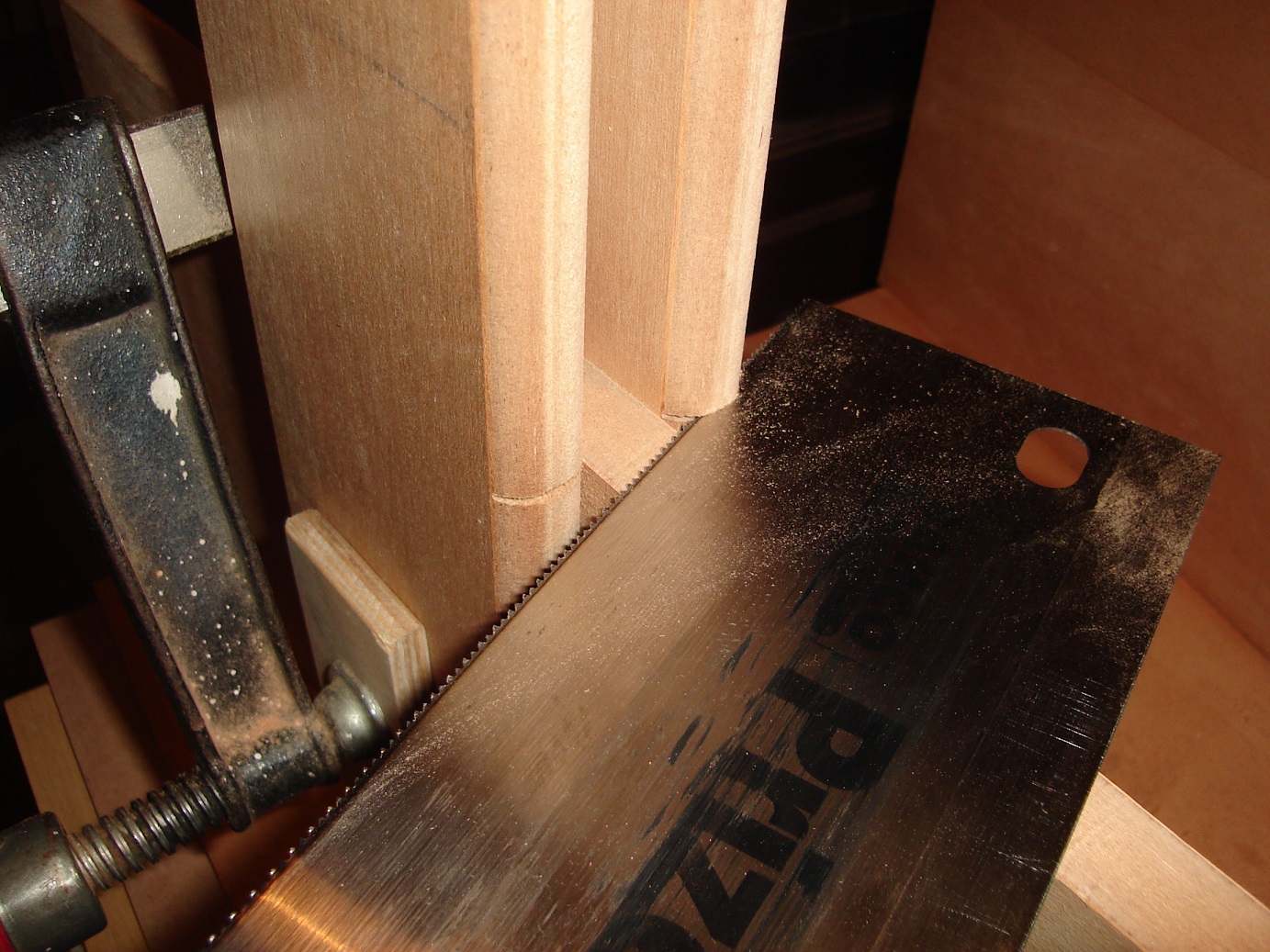

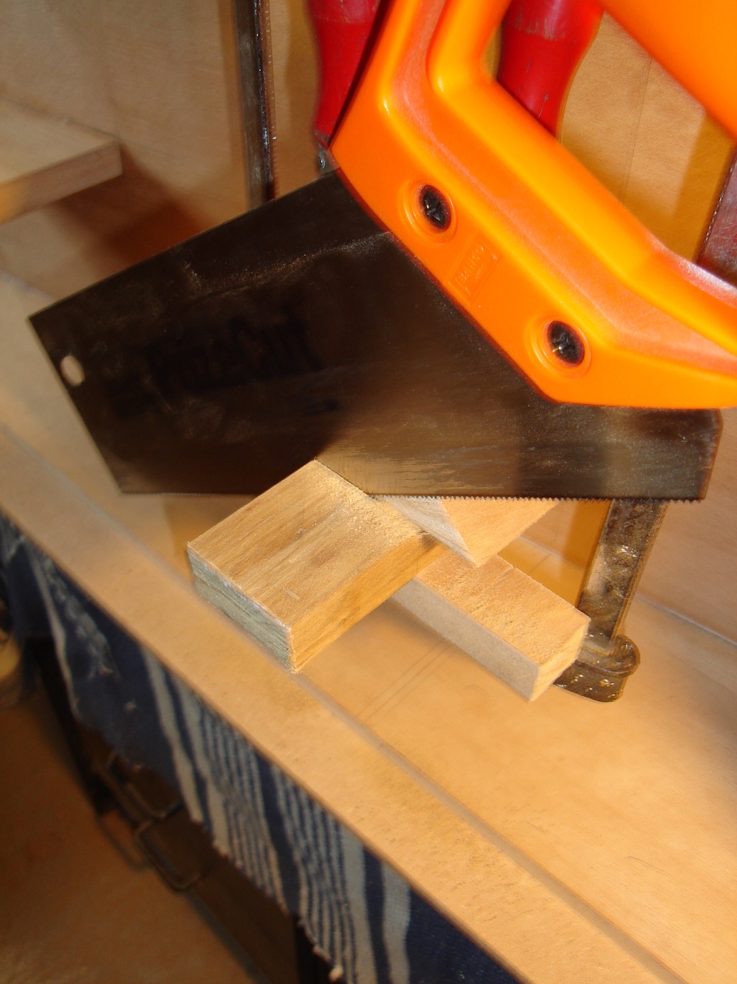

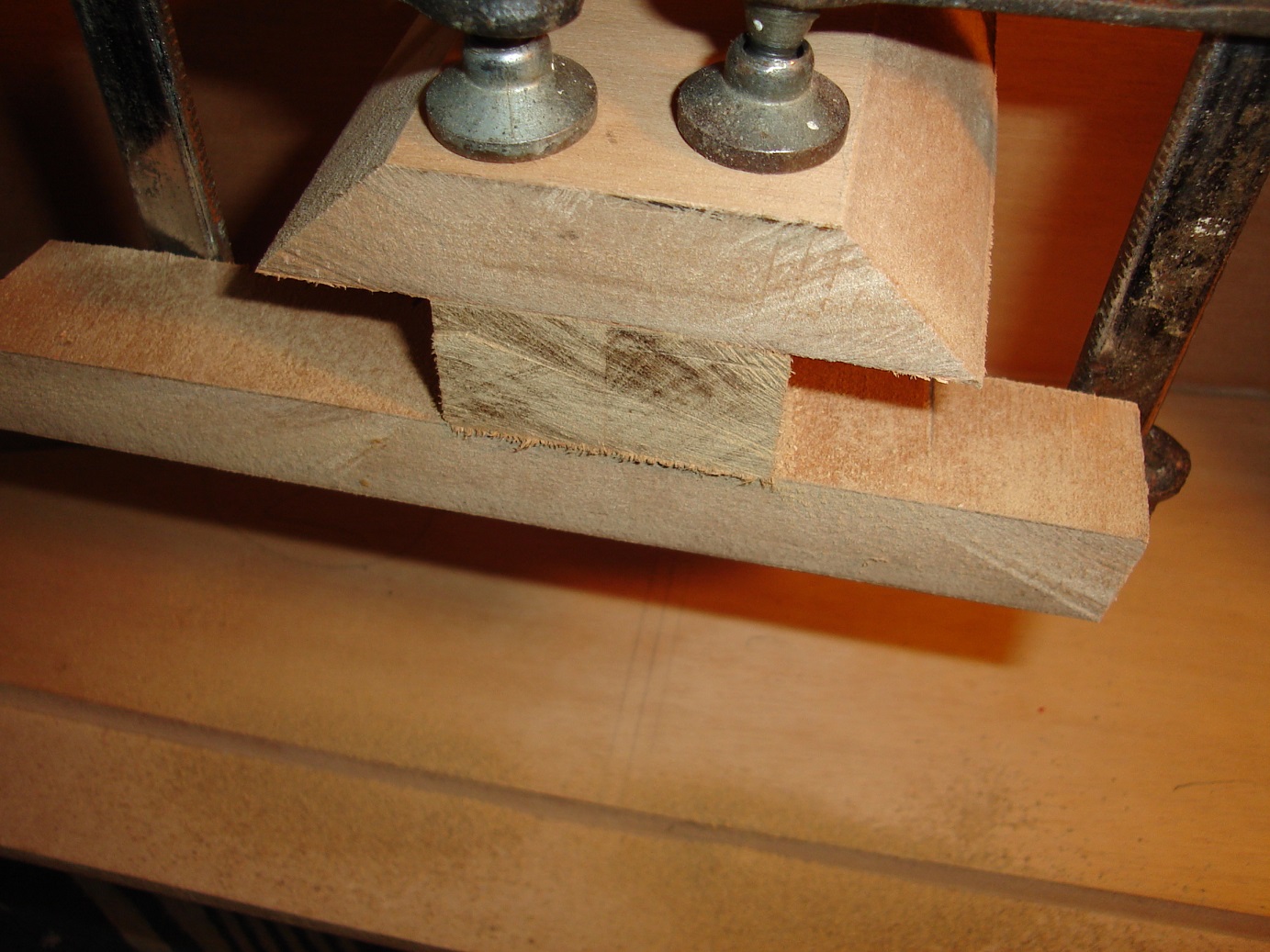

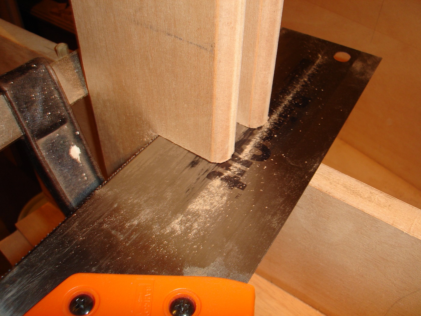

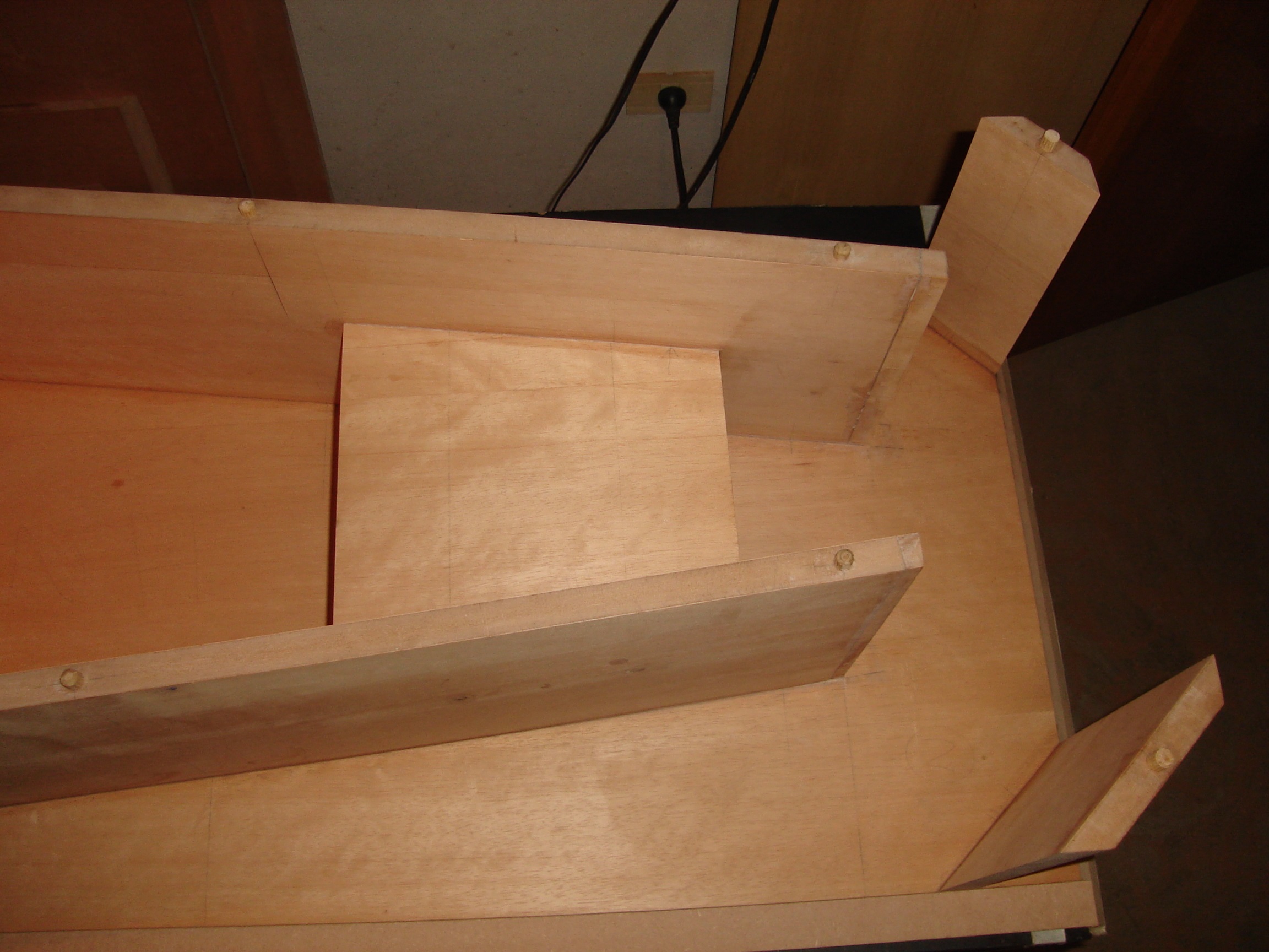

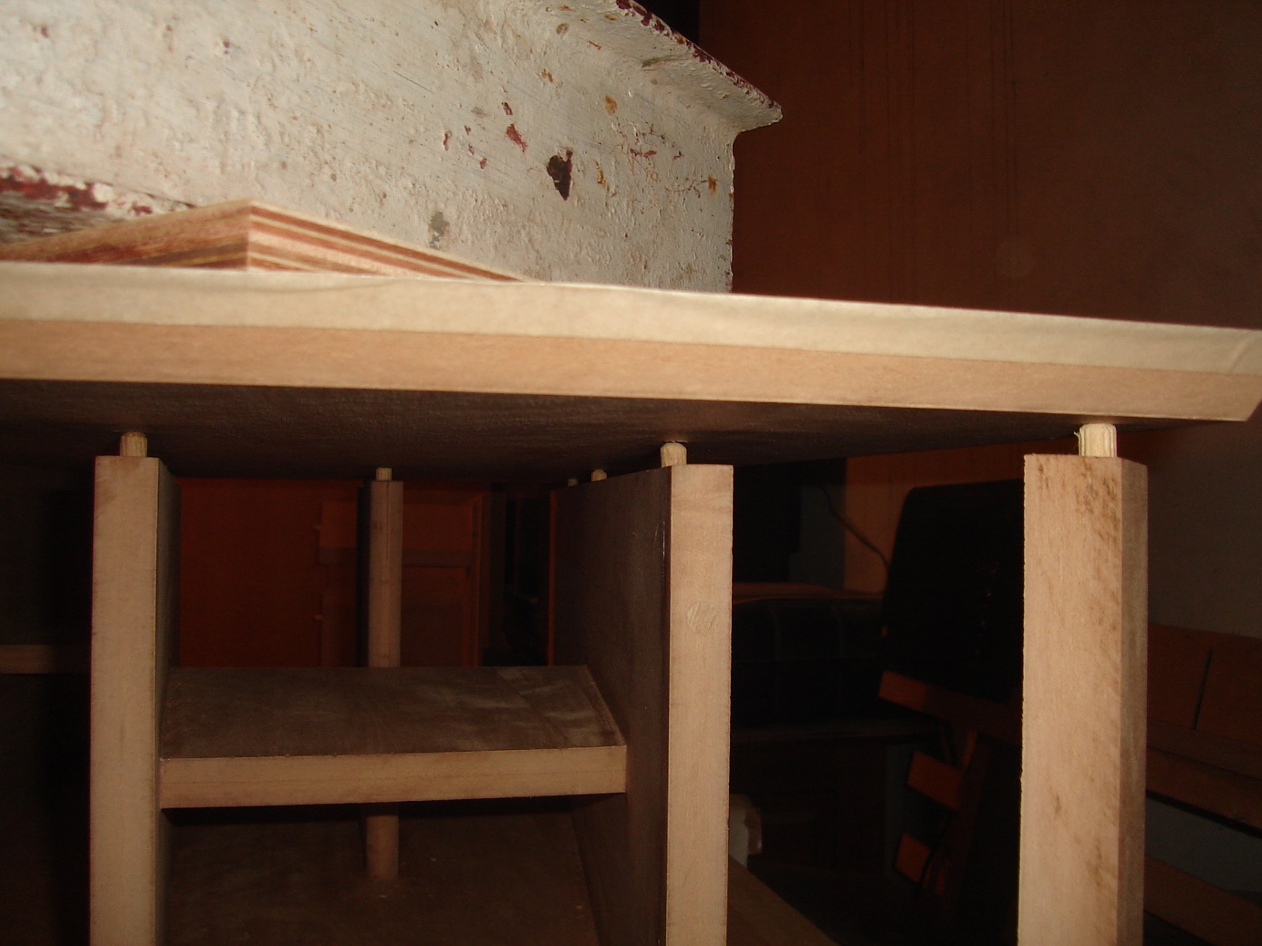

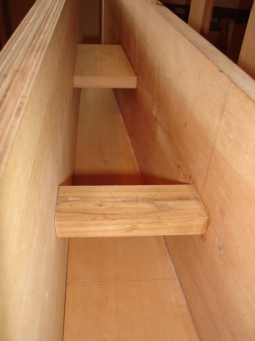

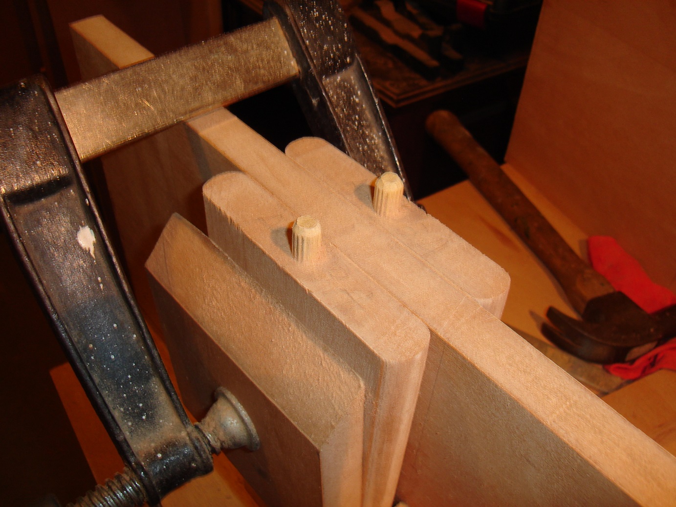

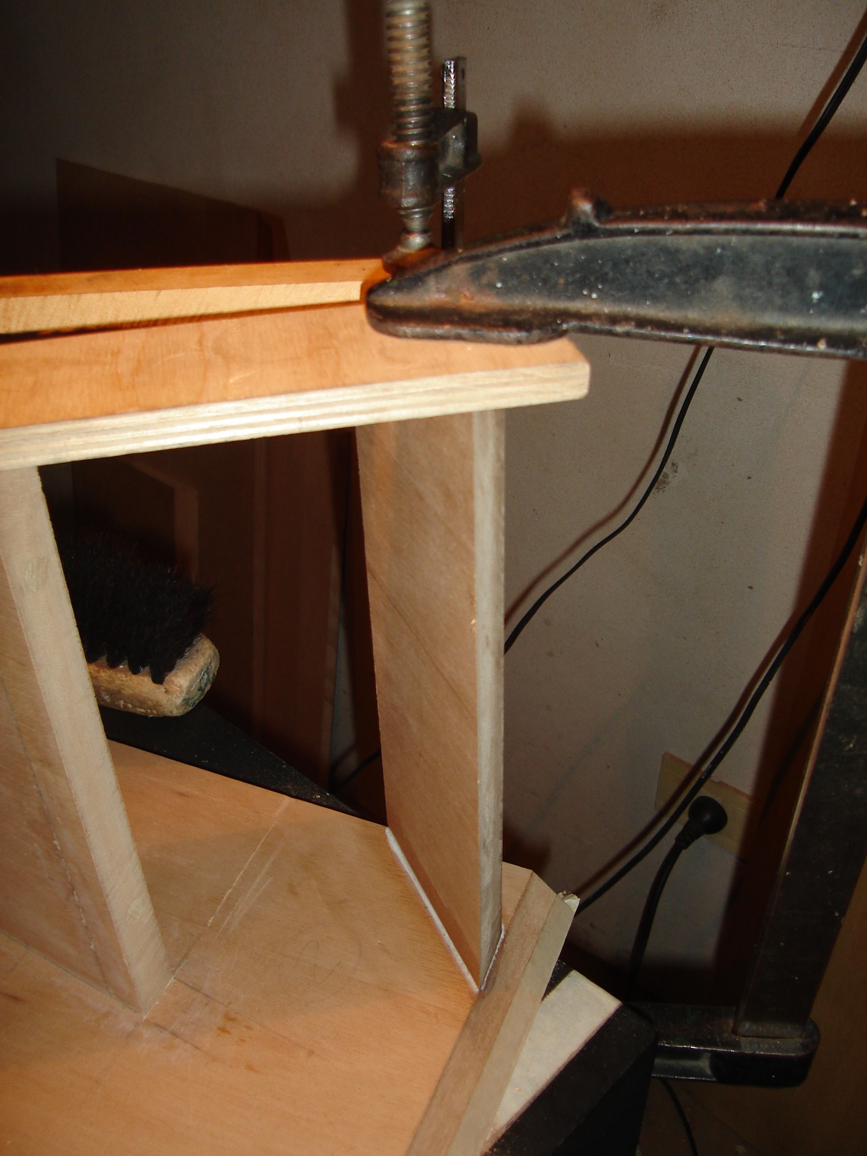

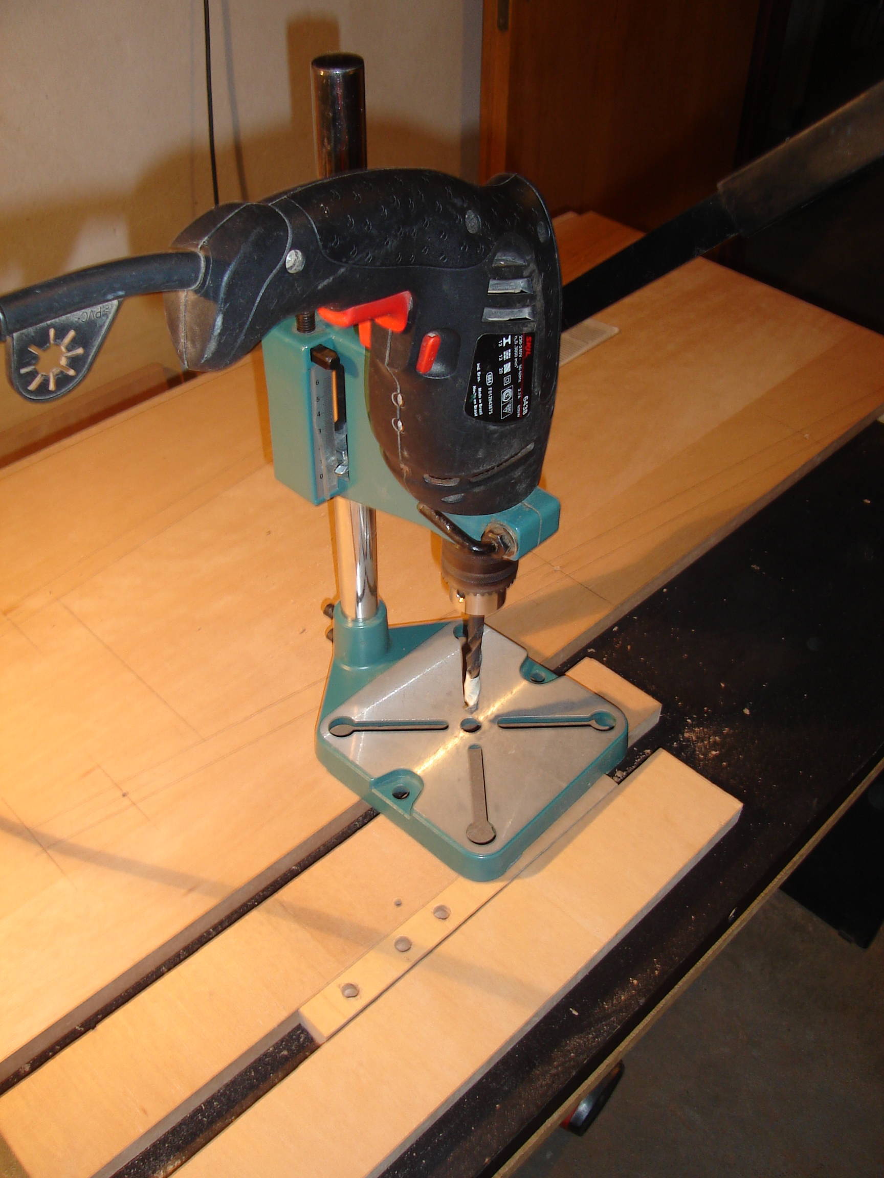

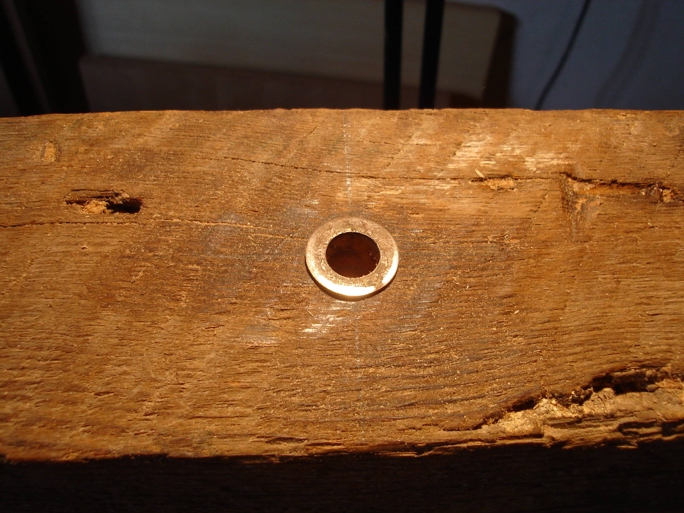

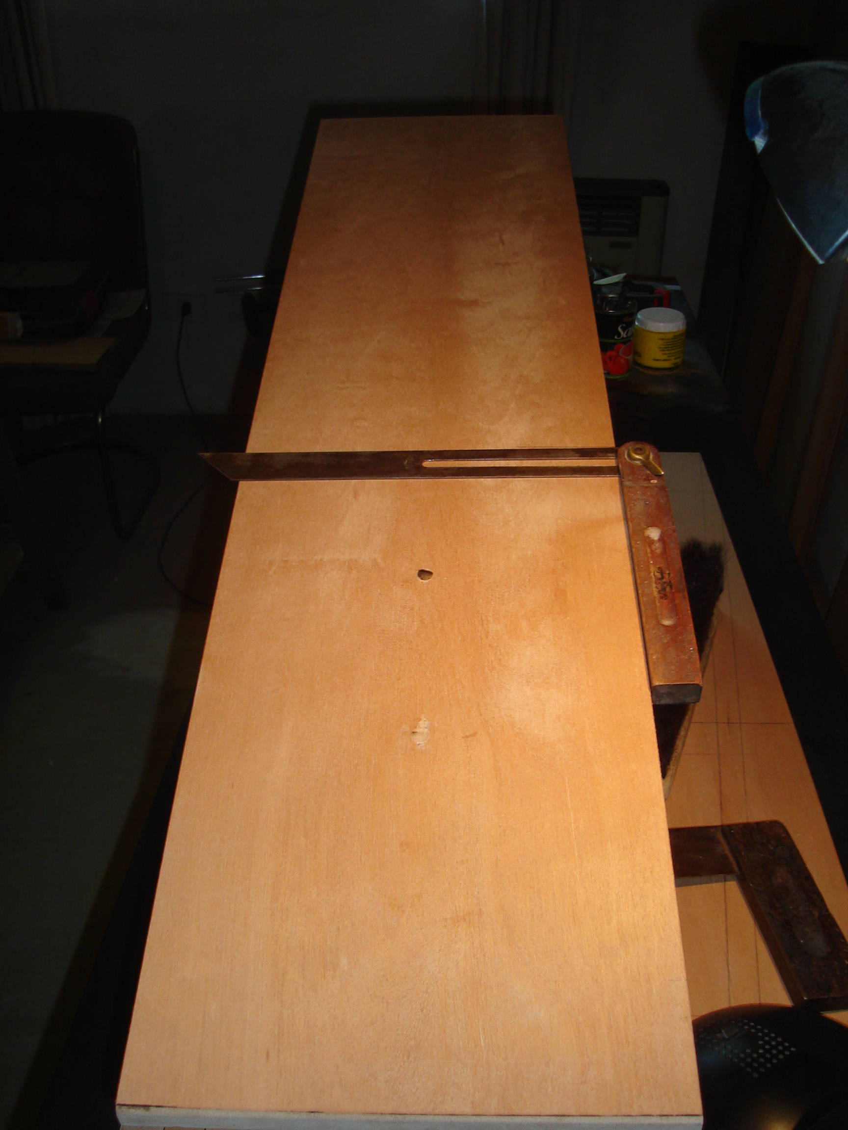

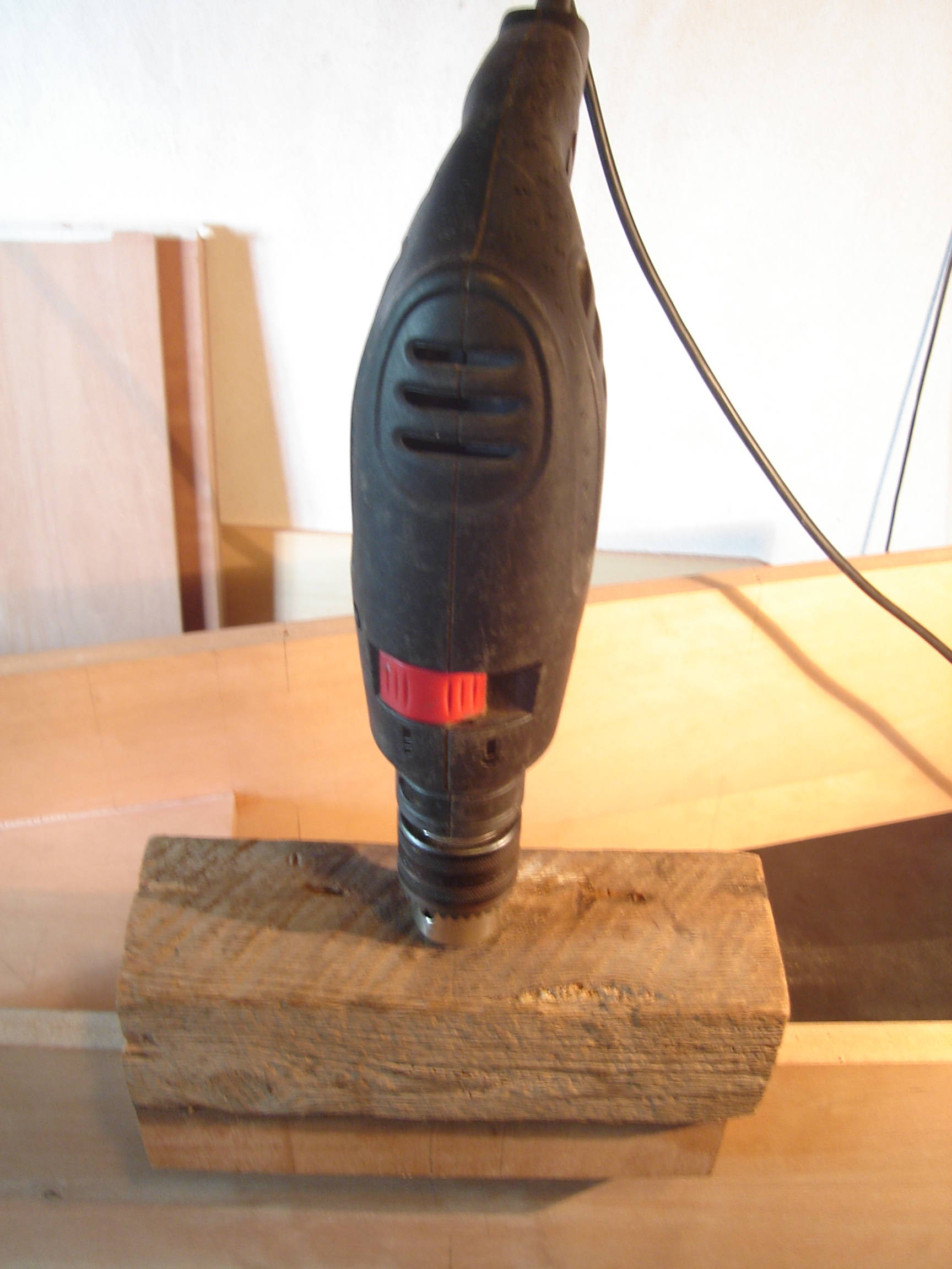

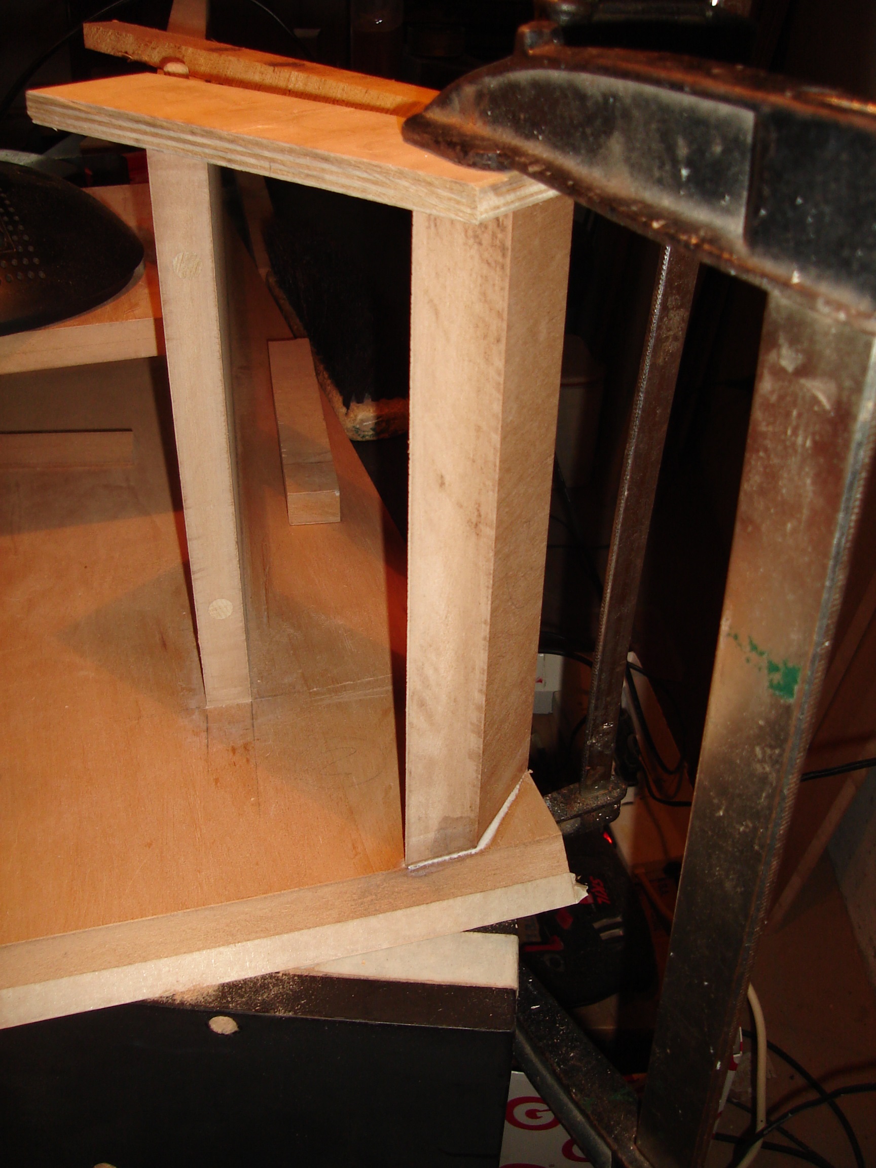

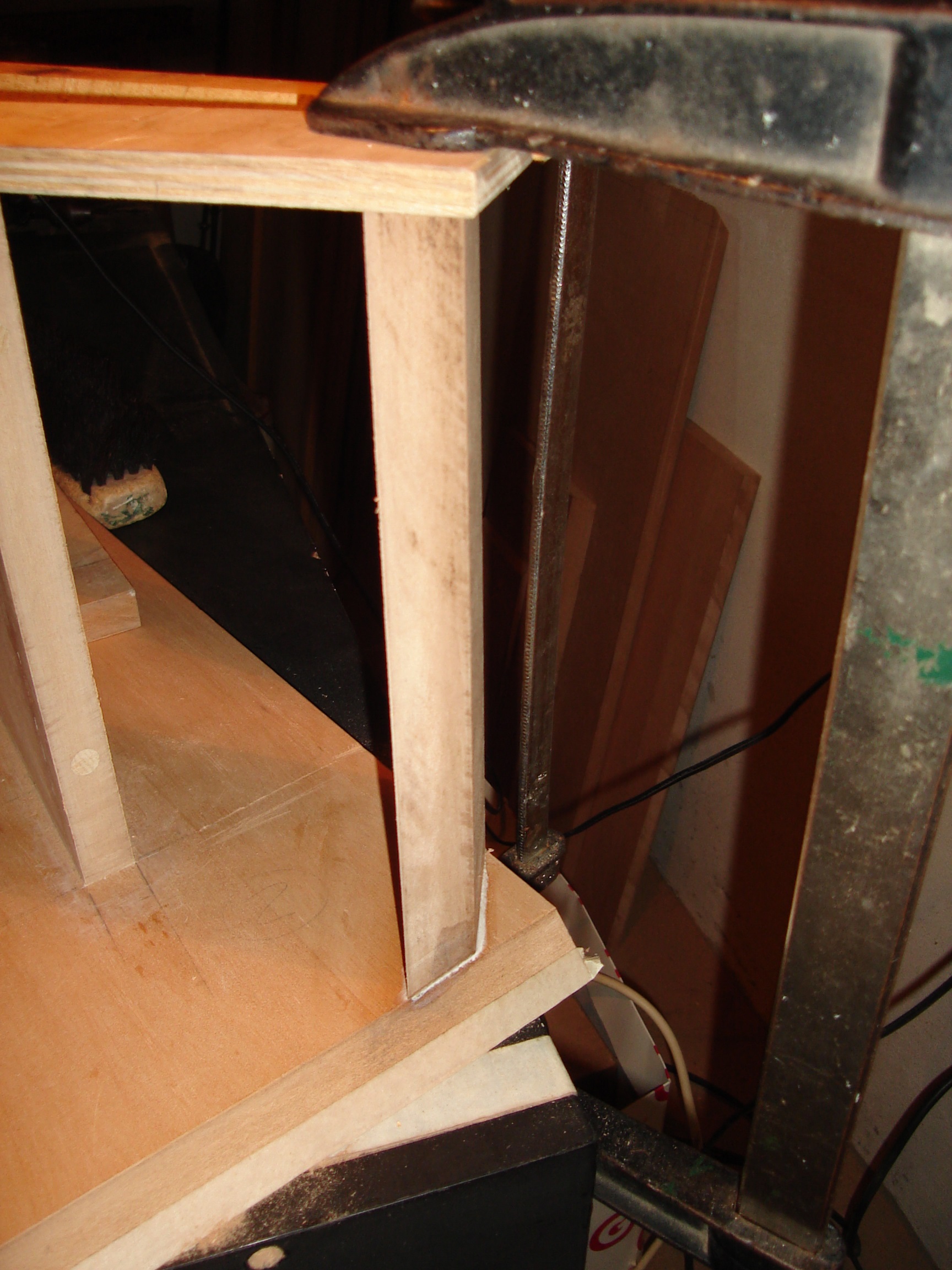

I leave pictures of angles - cornes - who have already been glued and finished in a cabinet, now I'm on the other. And then the other reinforcements that will be easier to do.
Make cuts of 45 degrees with a portable tool it is something really difficult, not recommended. Send to cut professional woodworking machines will relieve us great pain in the testicles 😀 and not have much wood waste ....

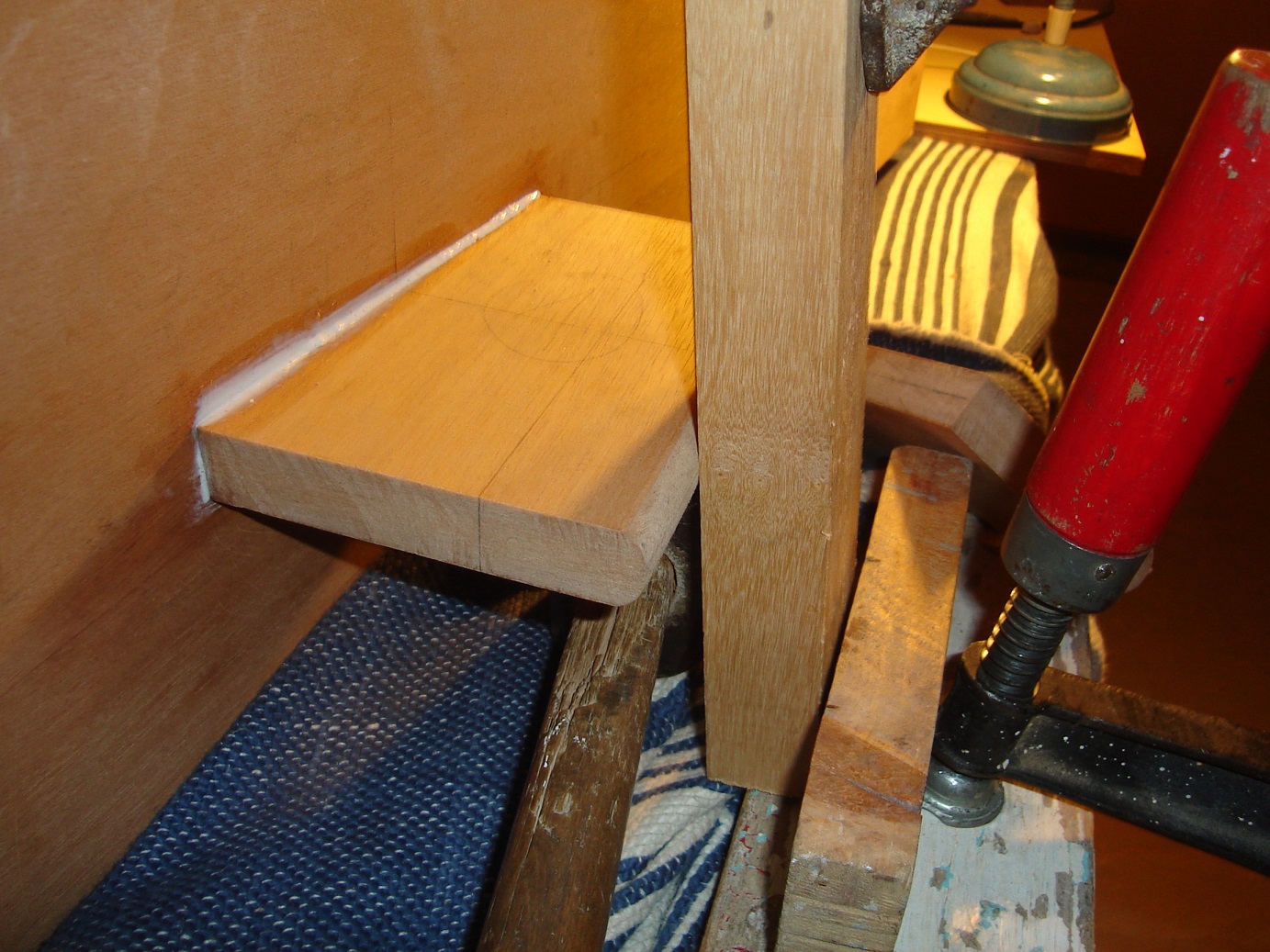

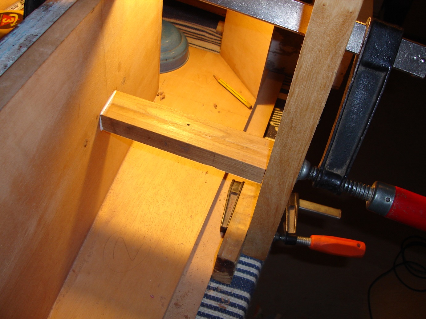

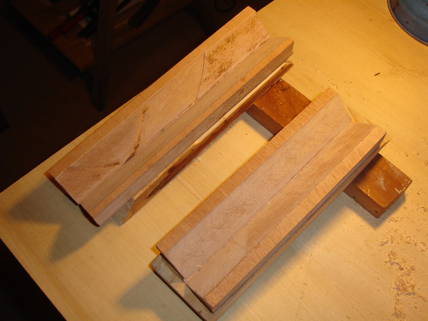

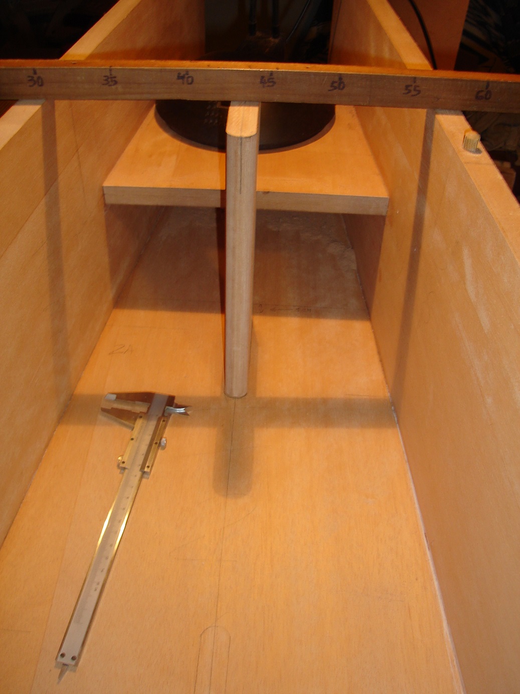

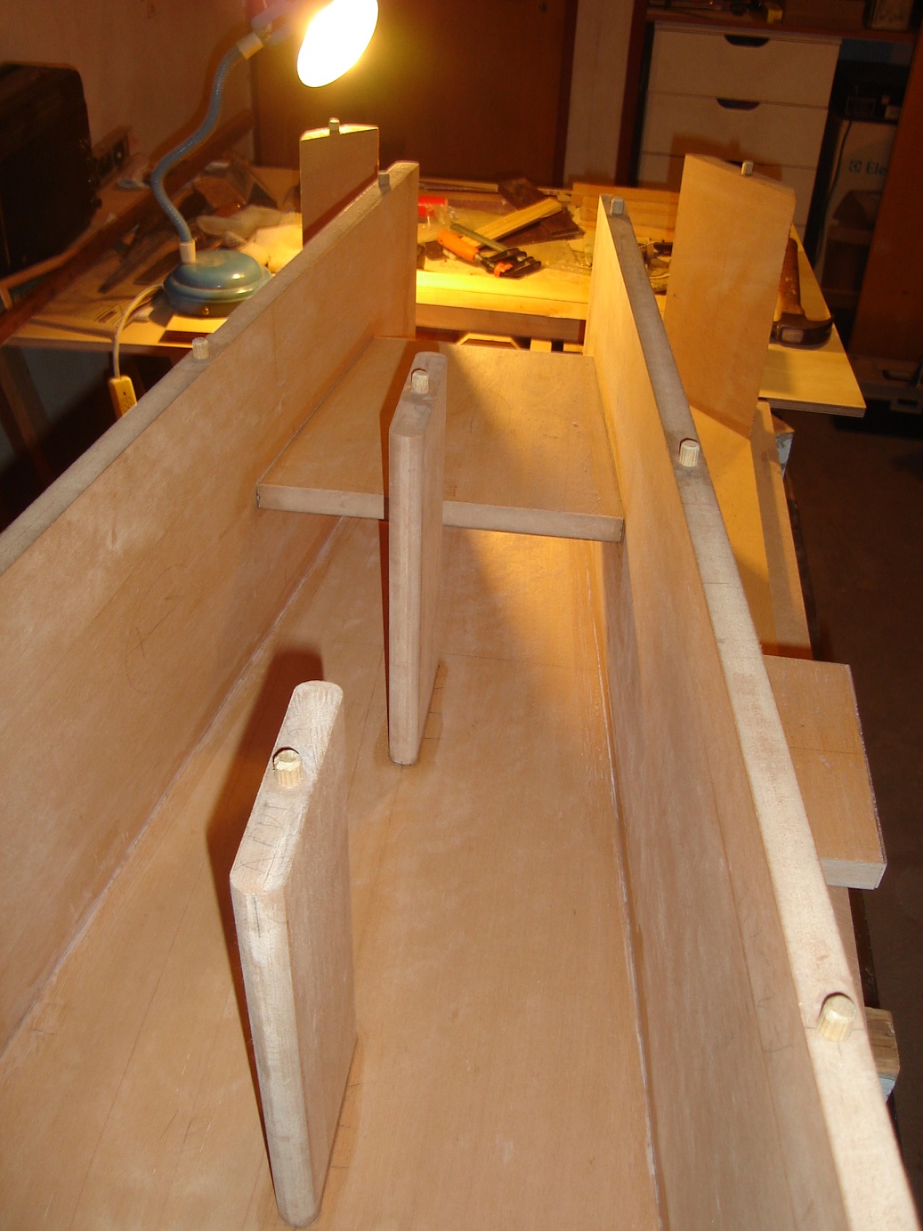

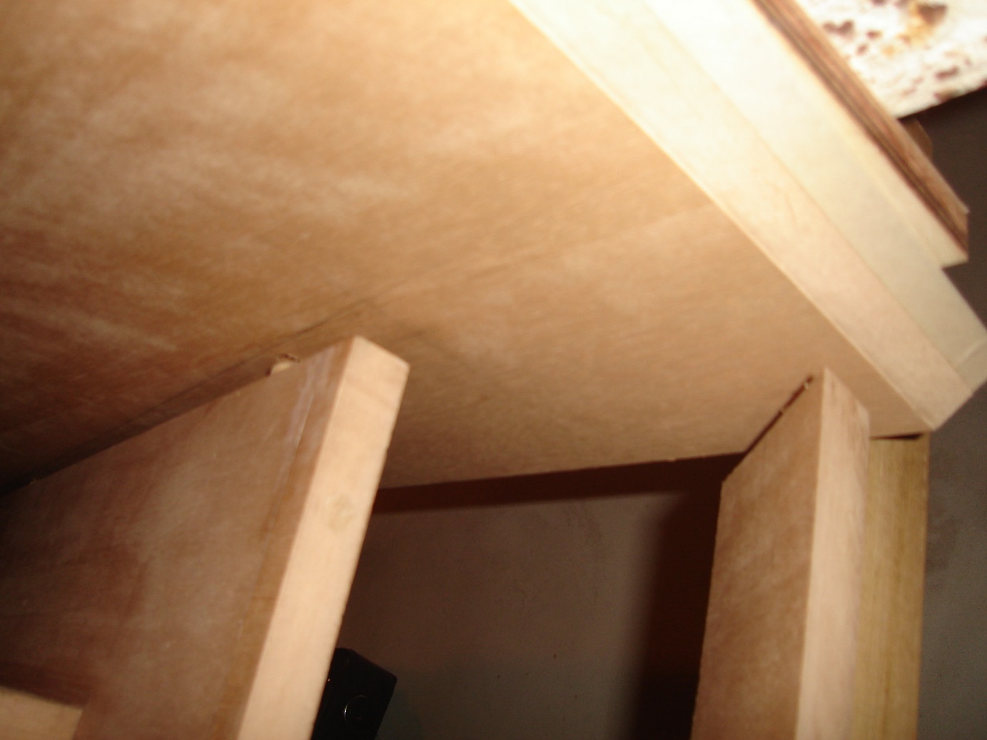

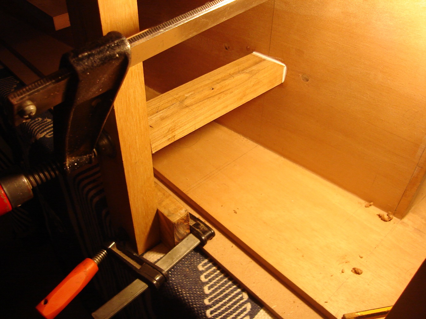

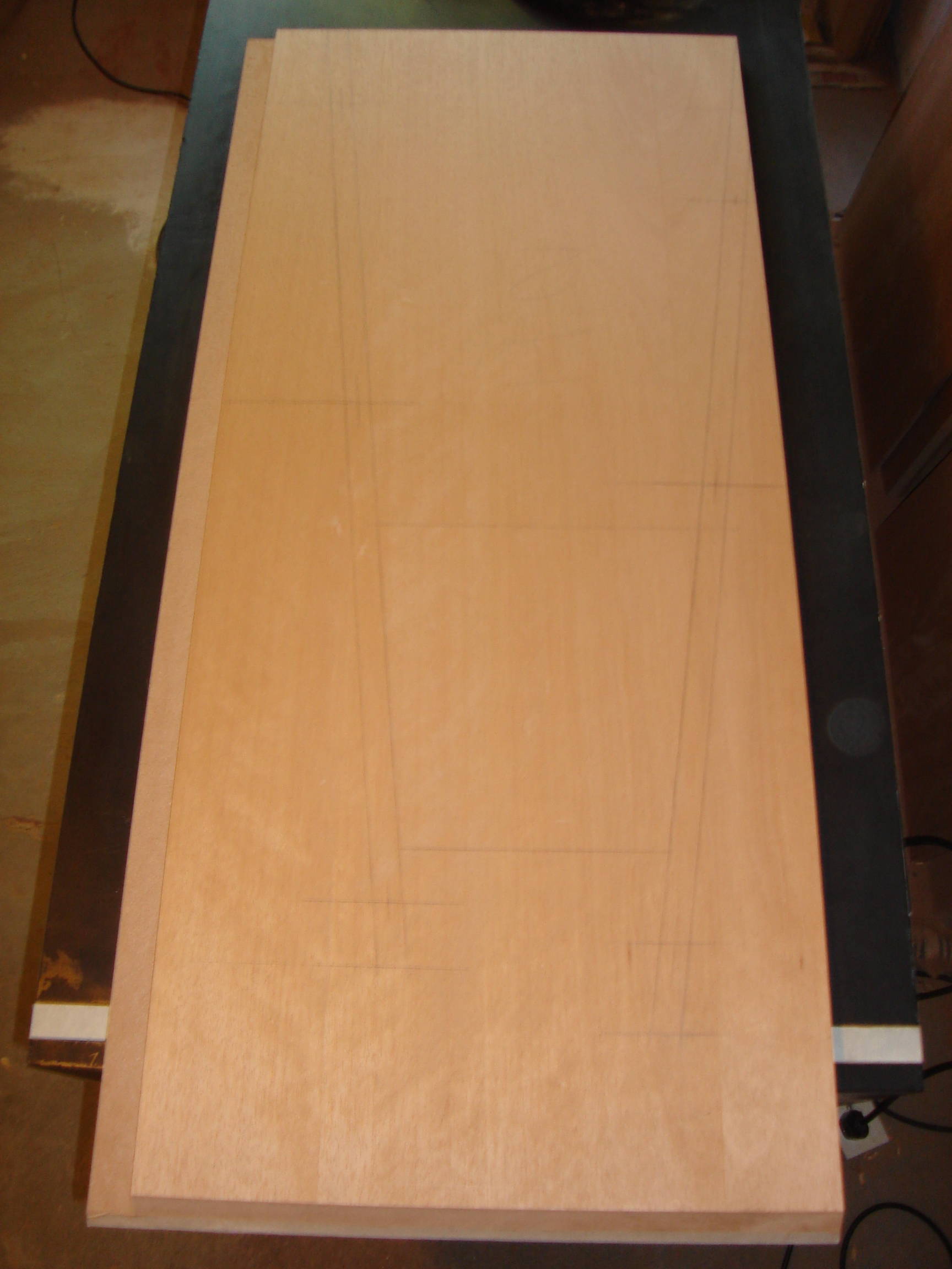

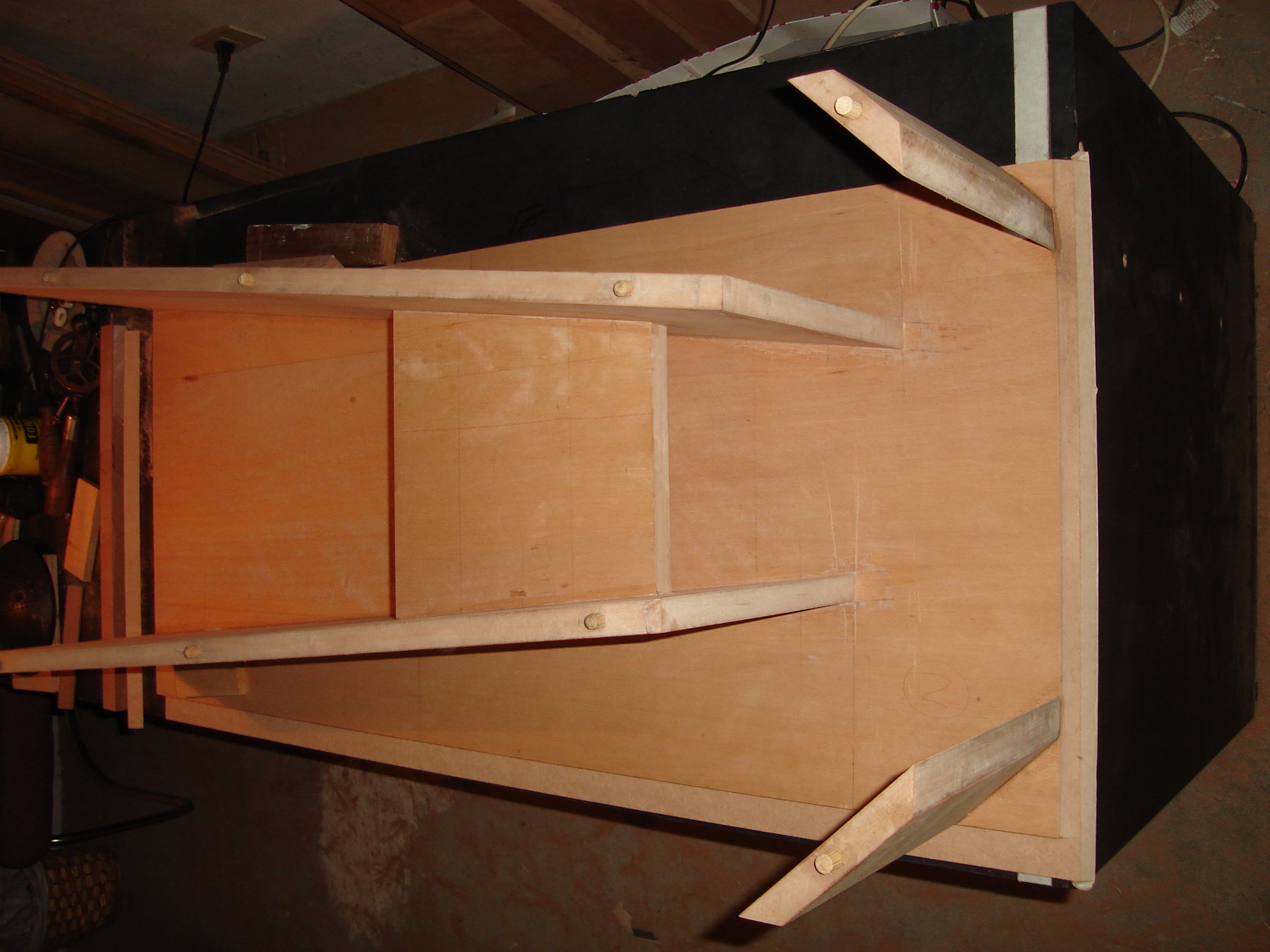

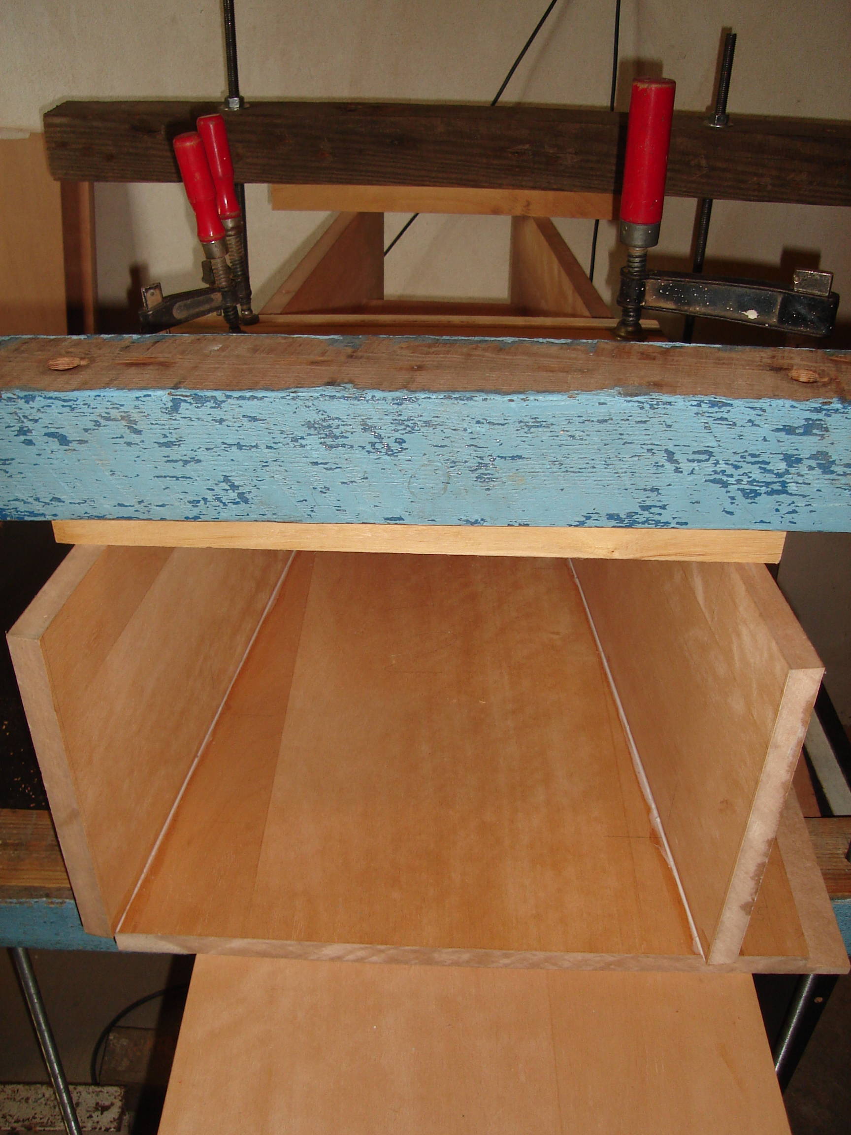

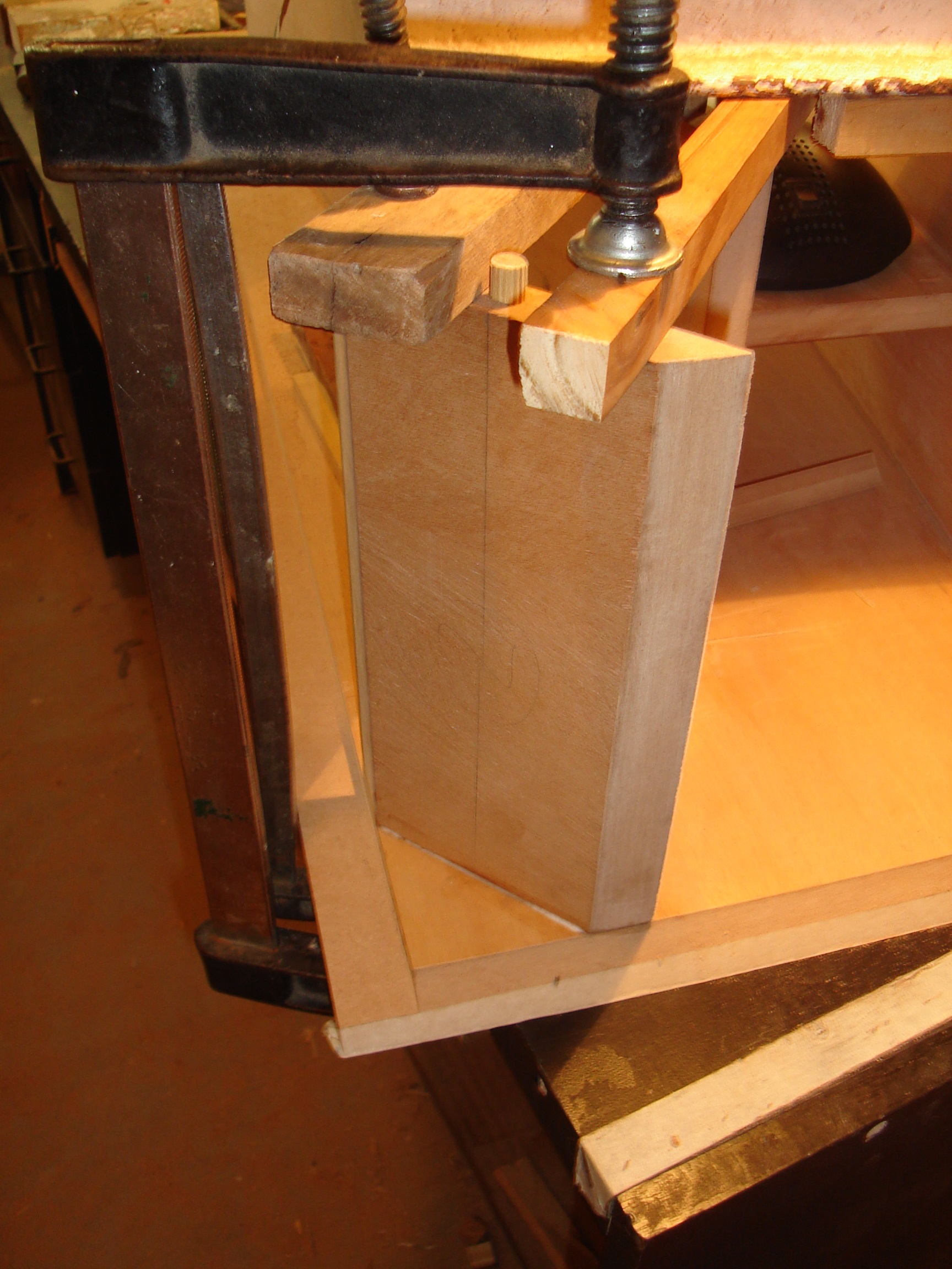

Preparation and gluing internal stiffeners 🙂 :

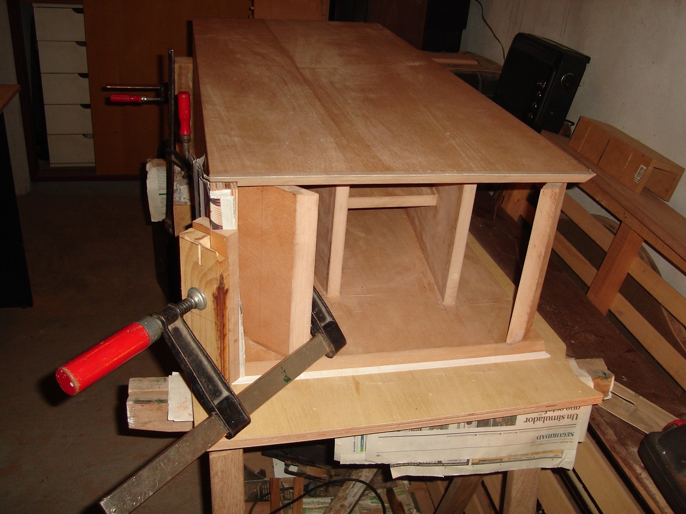

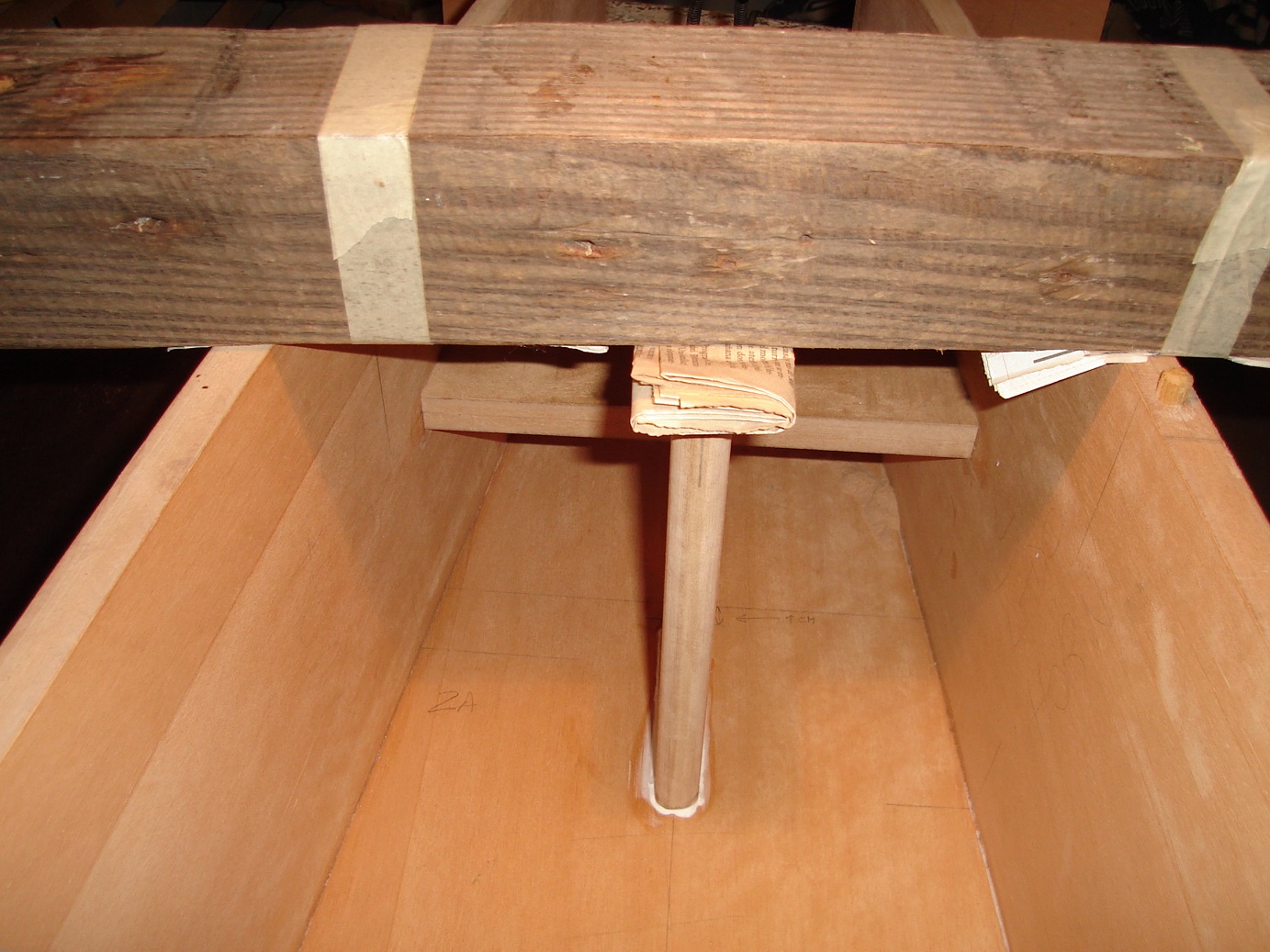

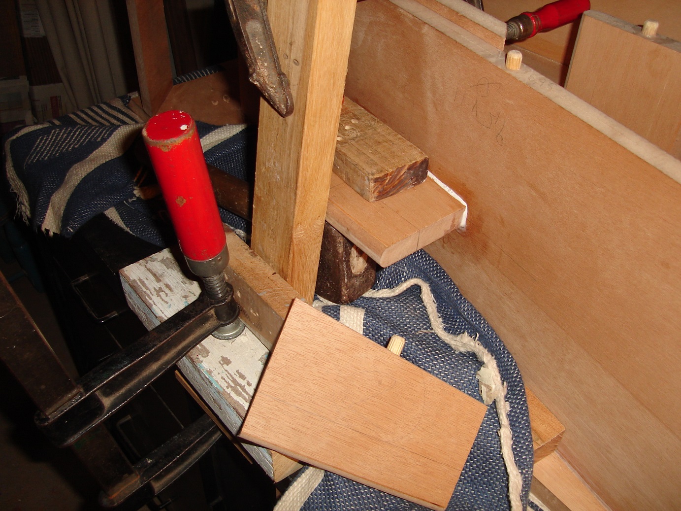

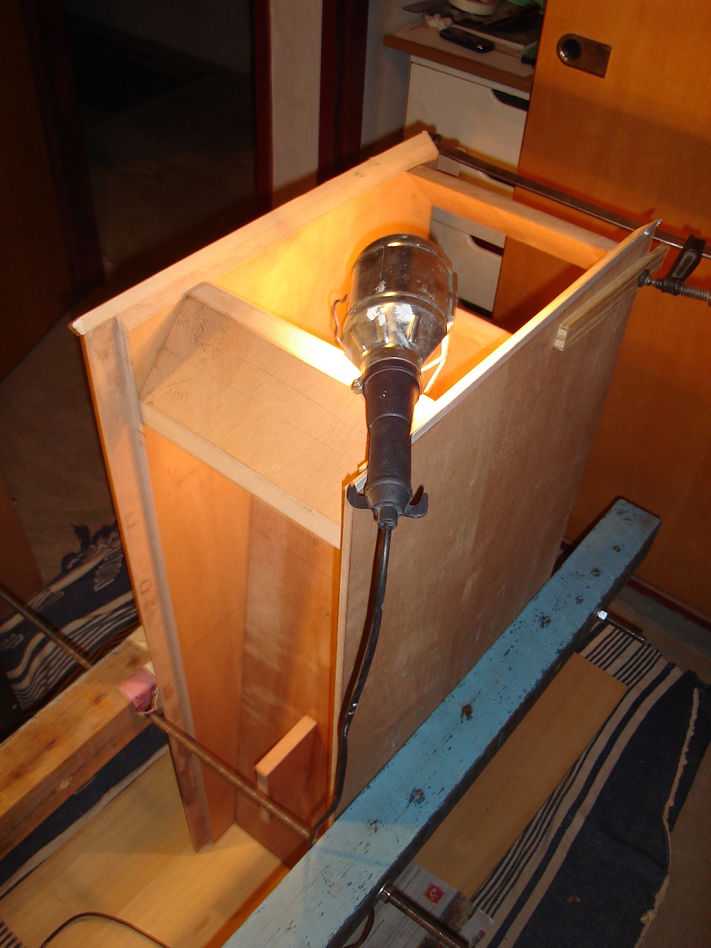

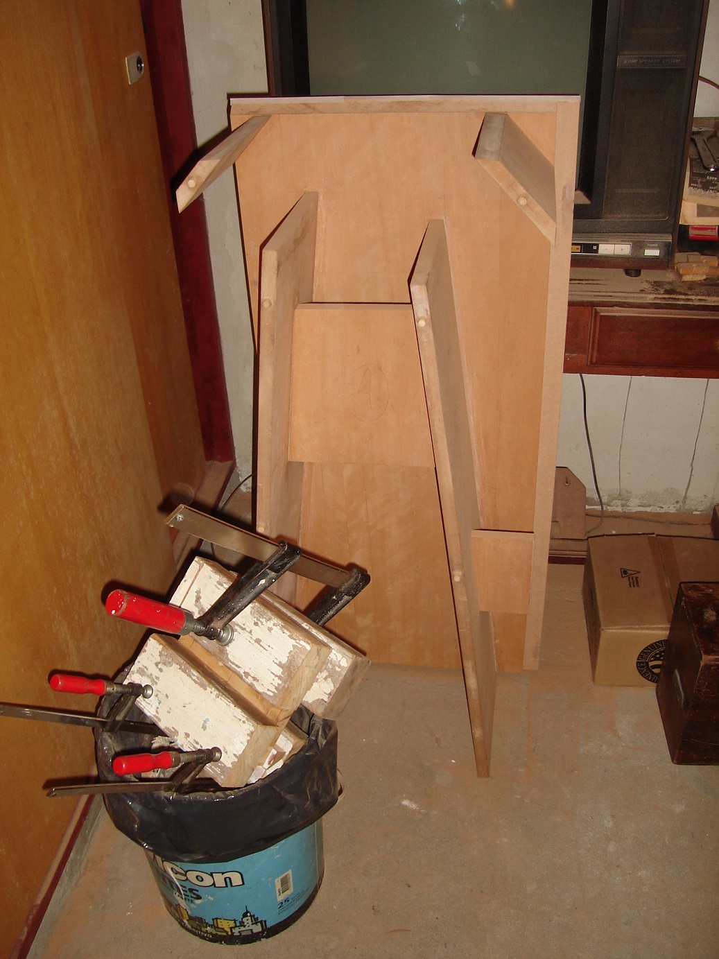

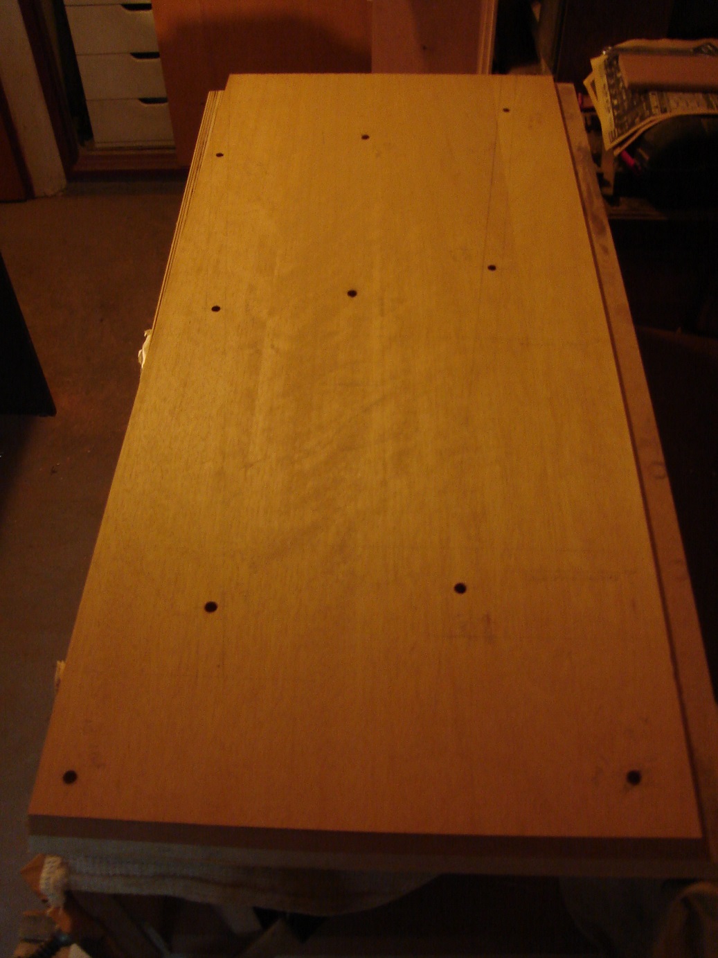

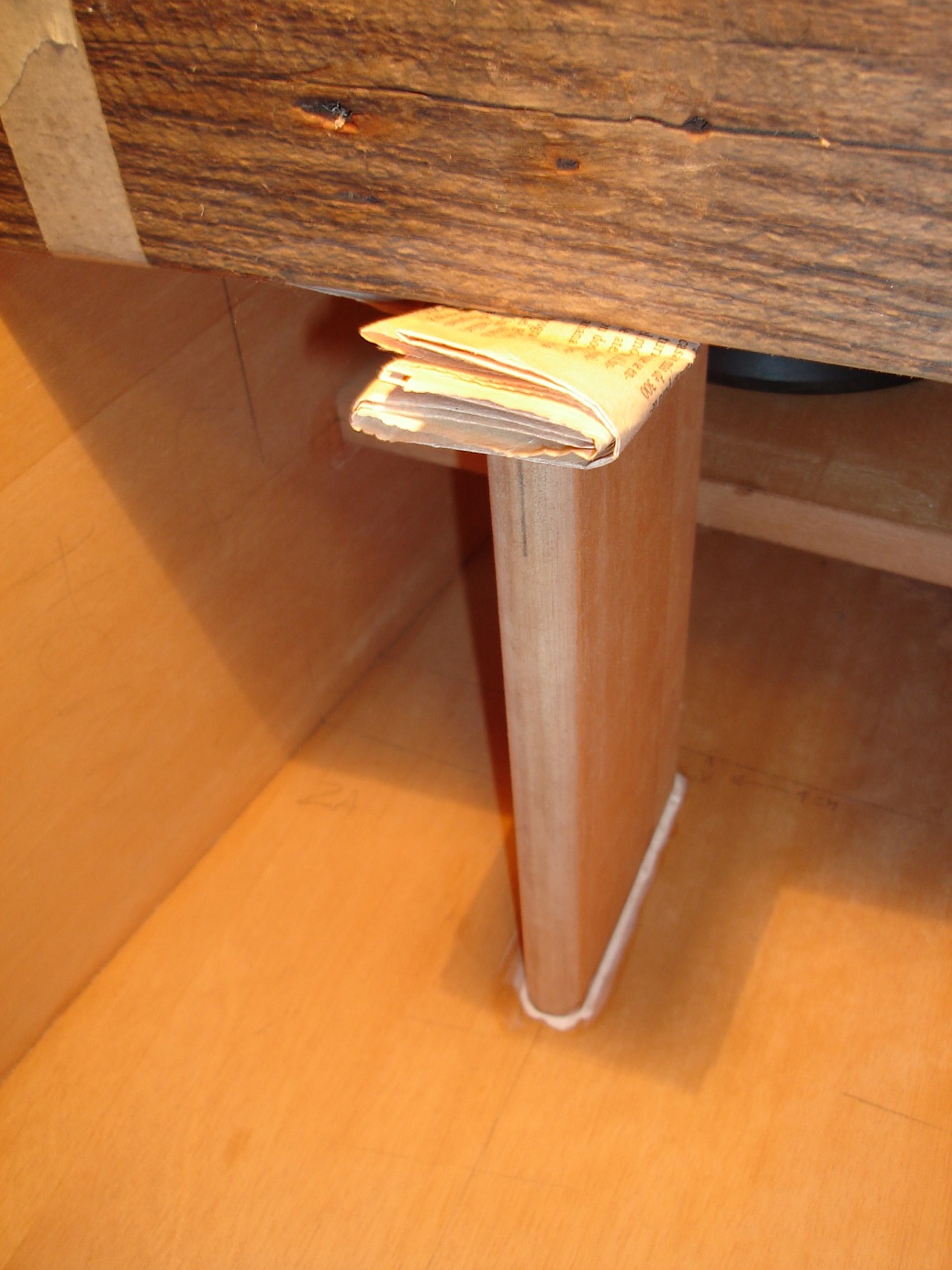

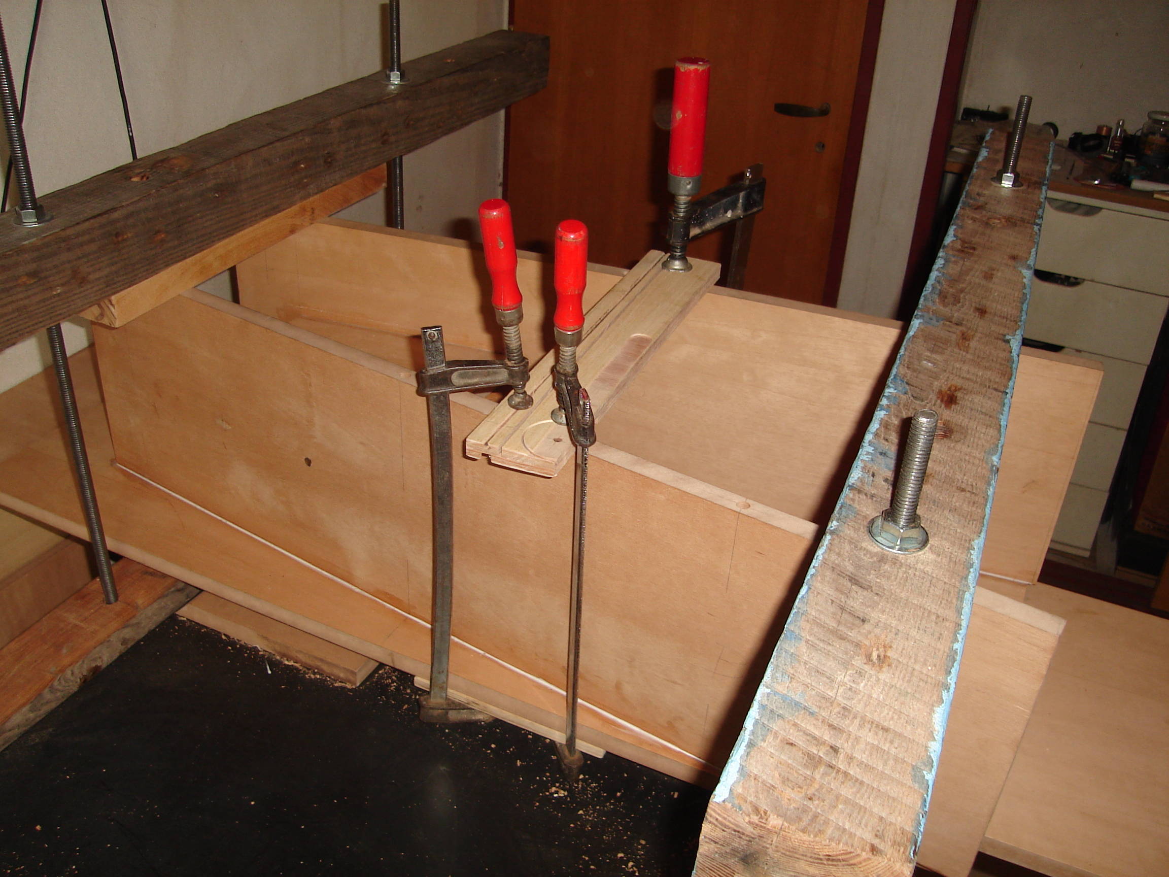

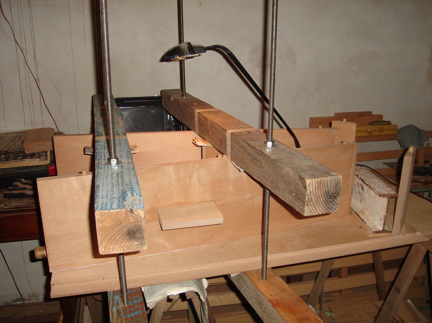

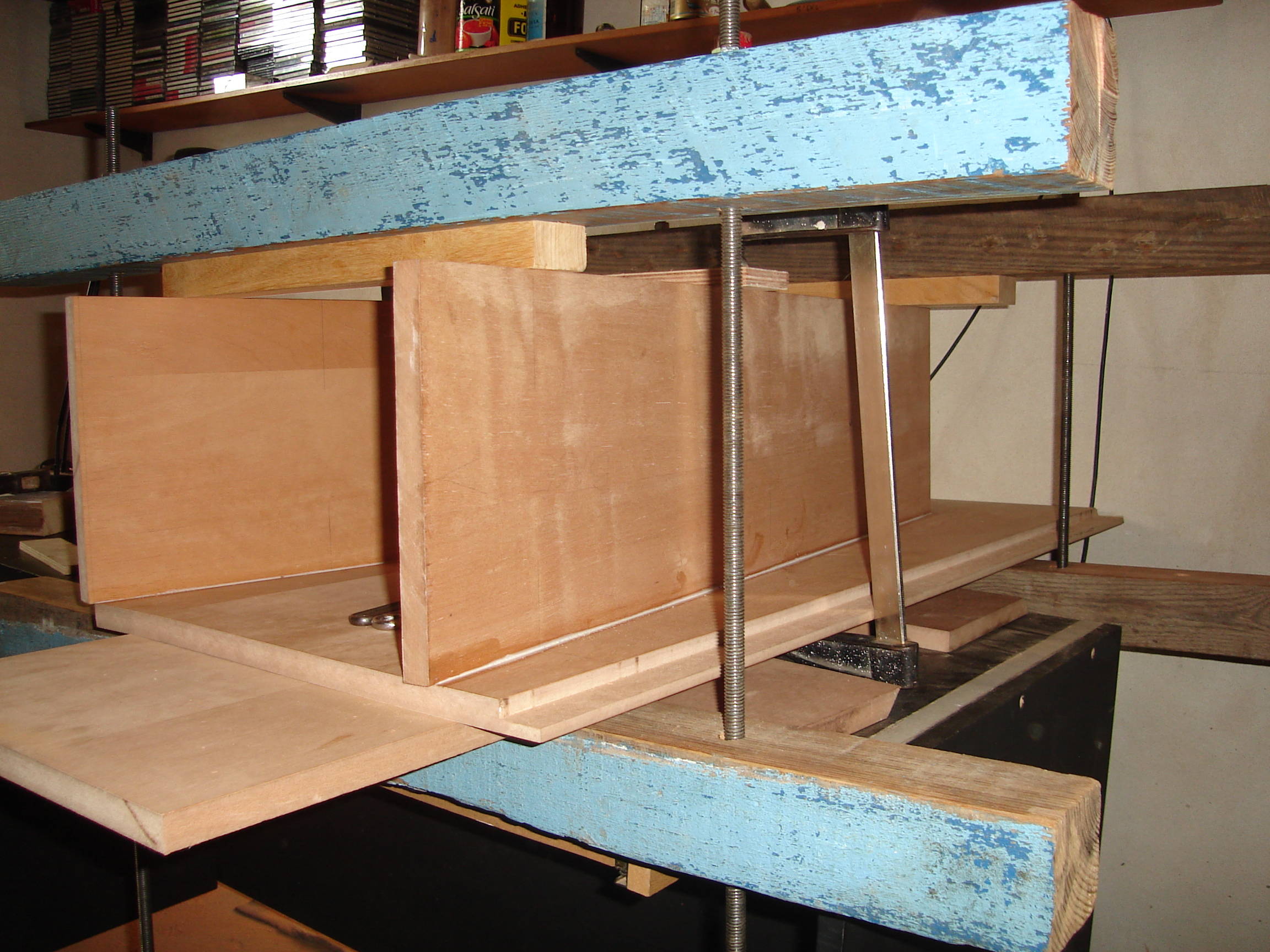

Pressing ..... 😉:yes:

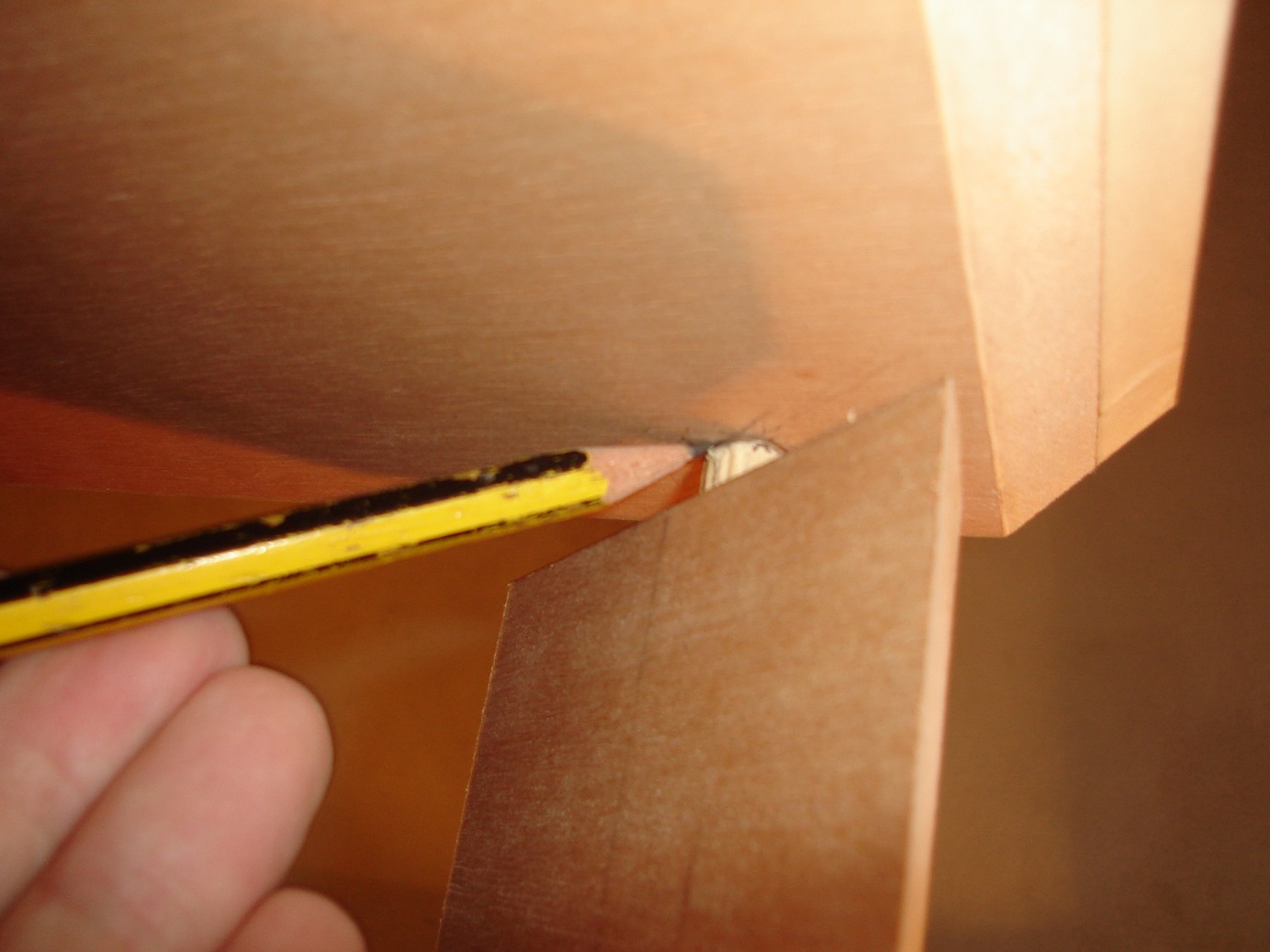

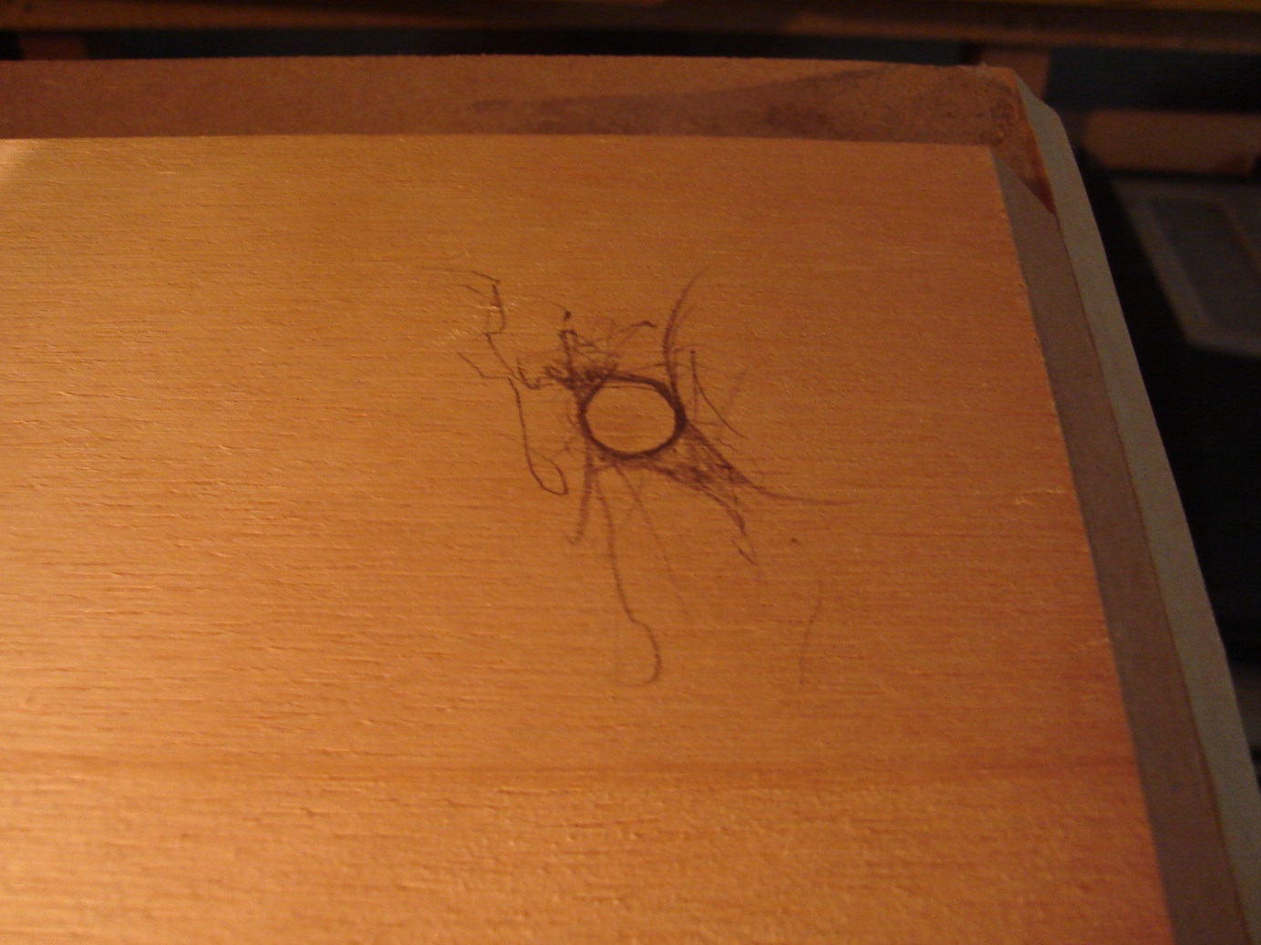

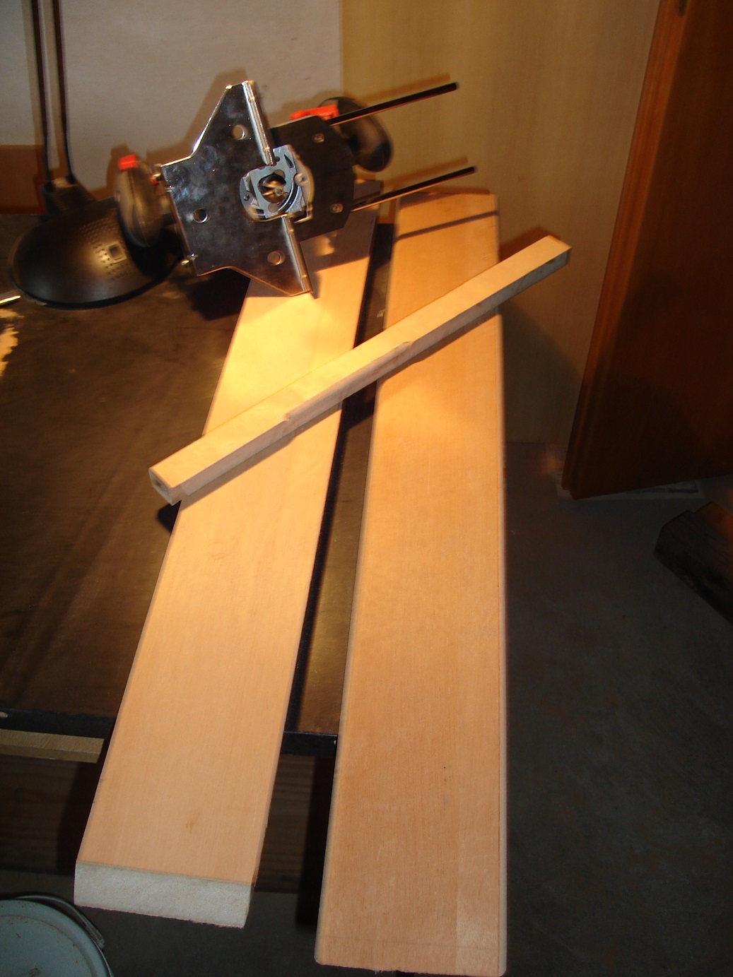

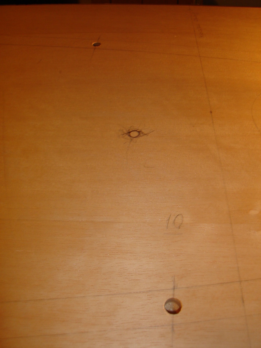

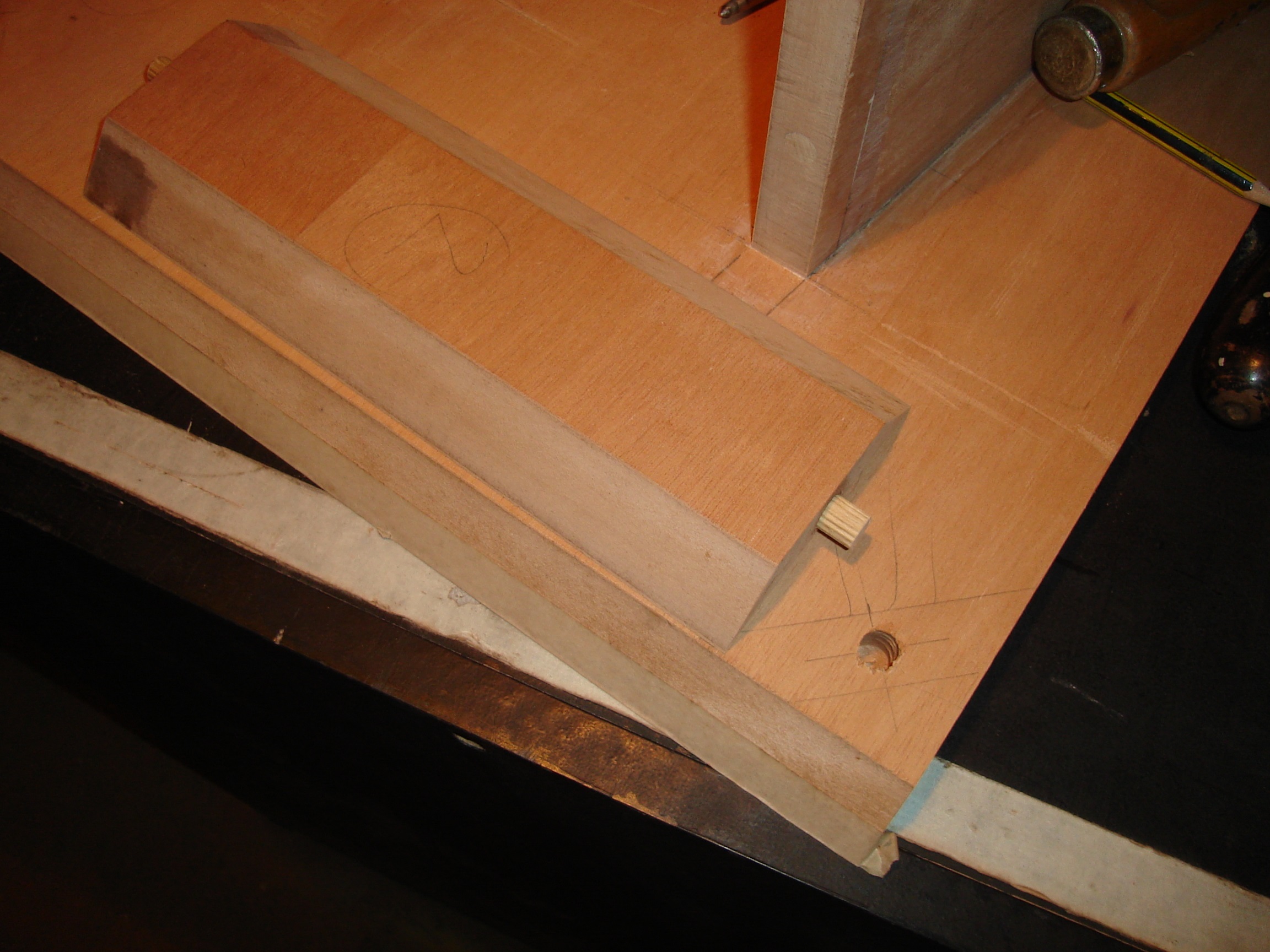

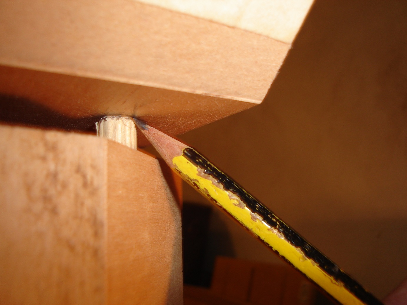

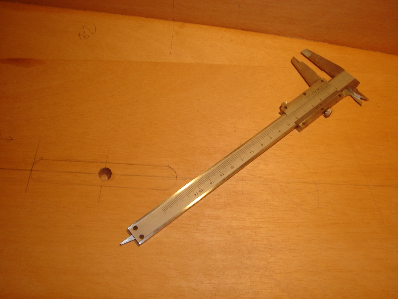

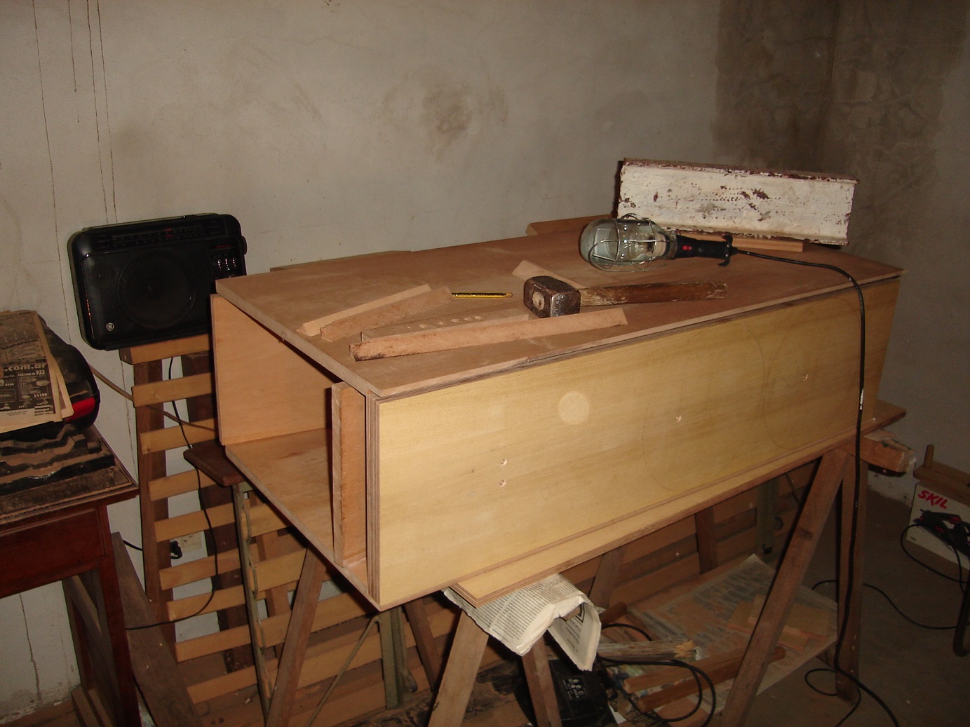

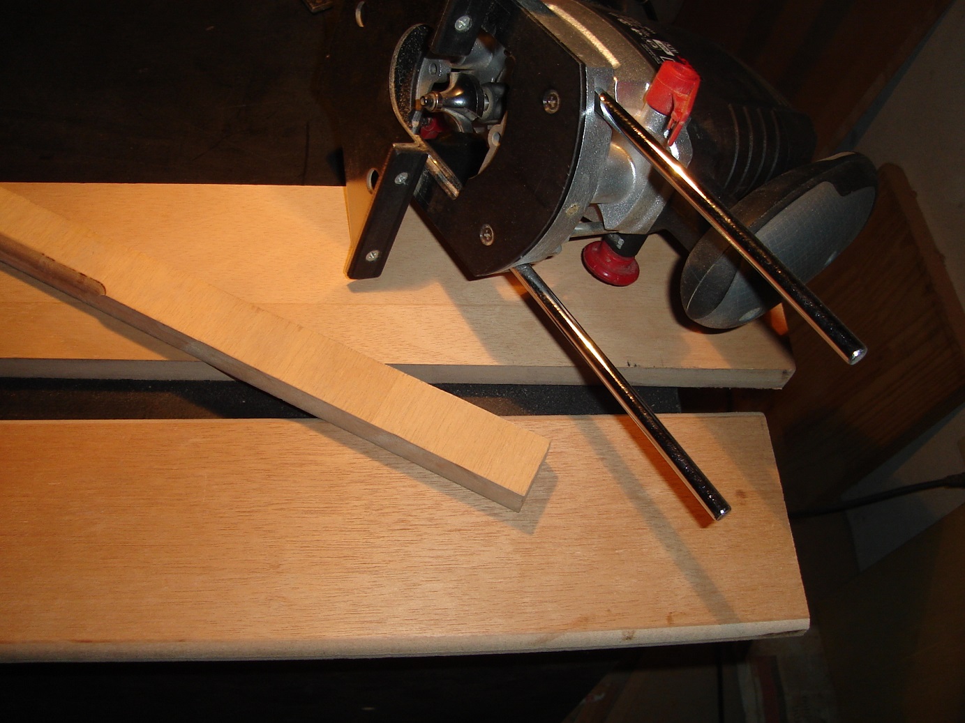

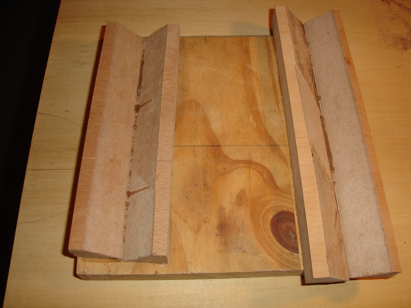

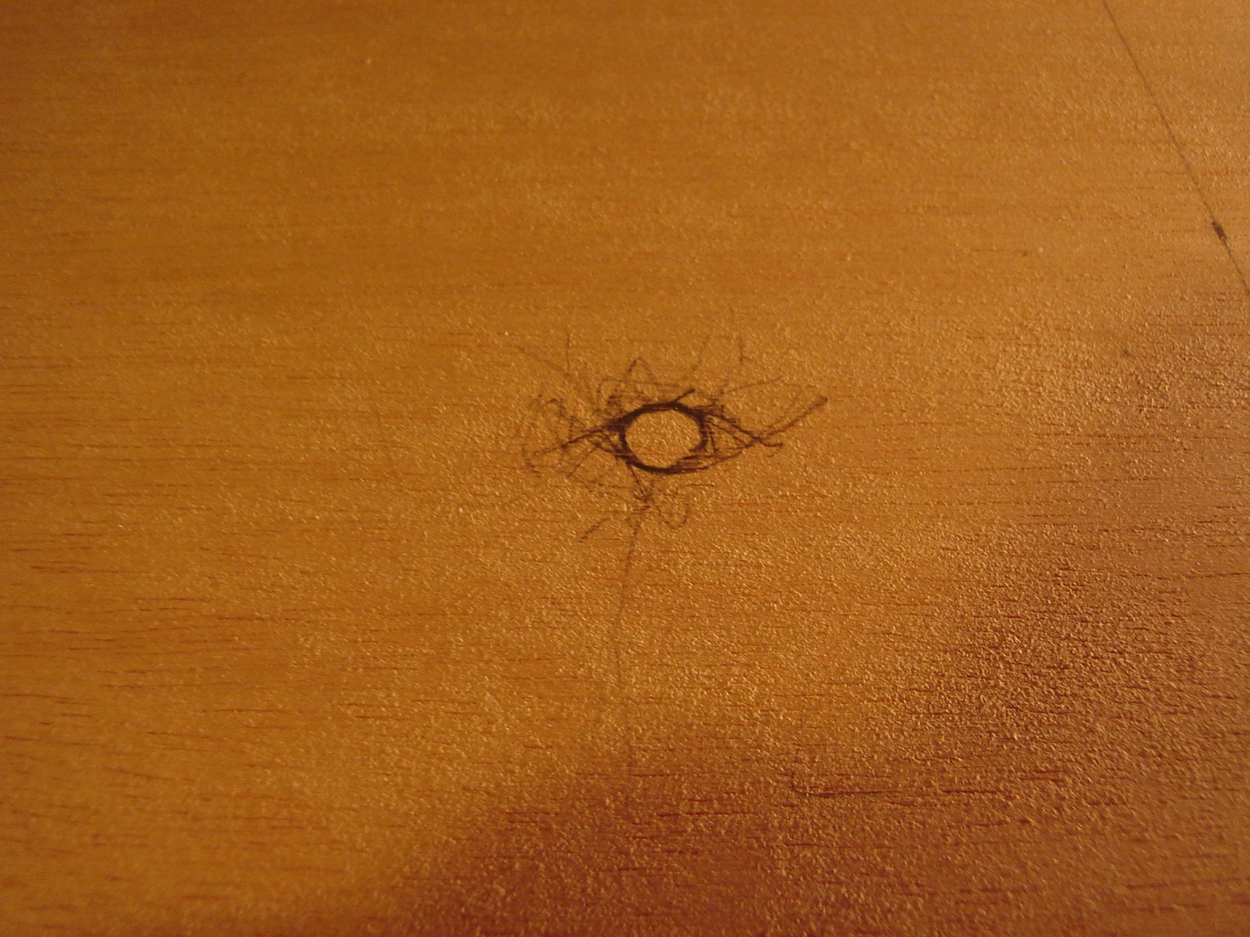

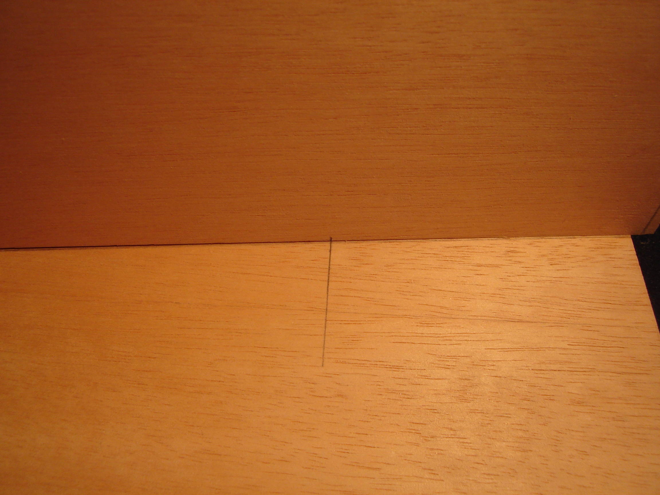

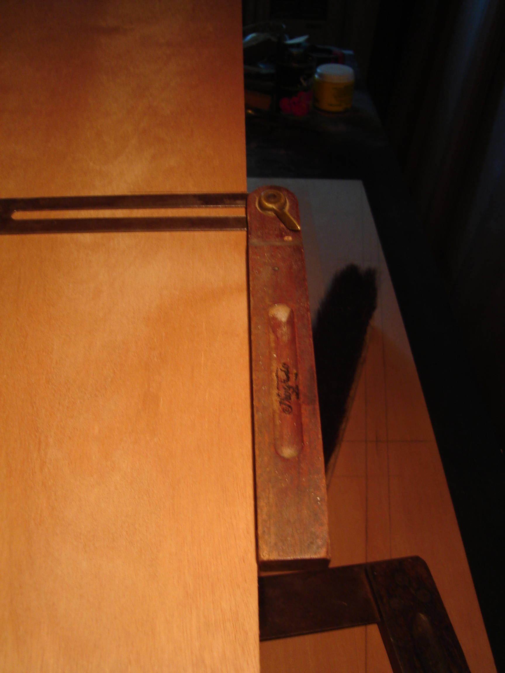

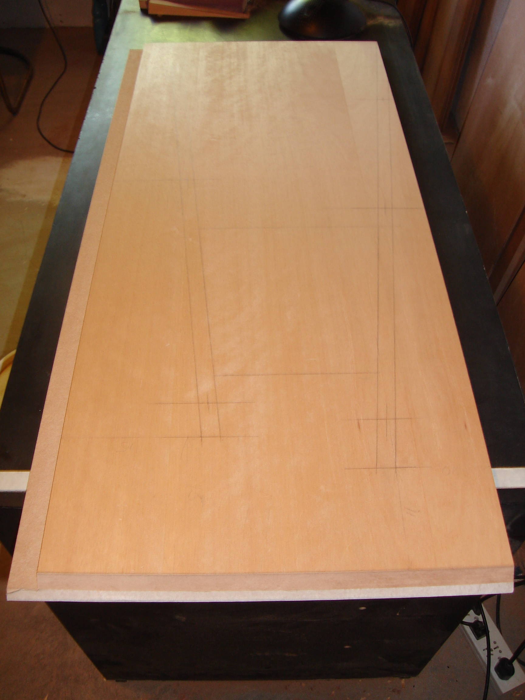

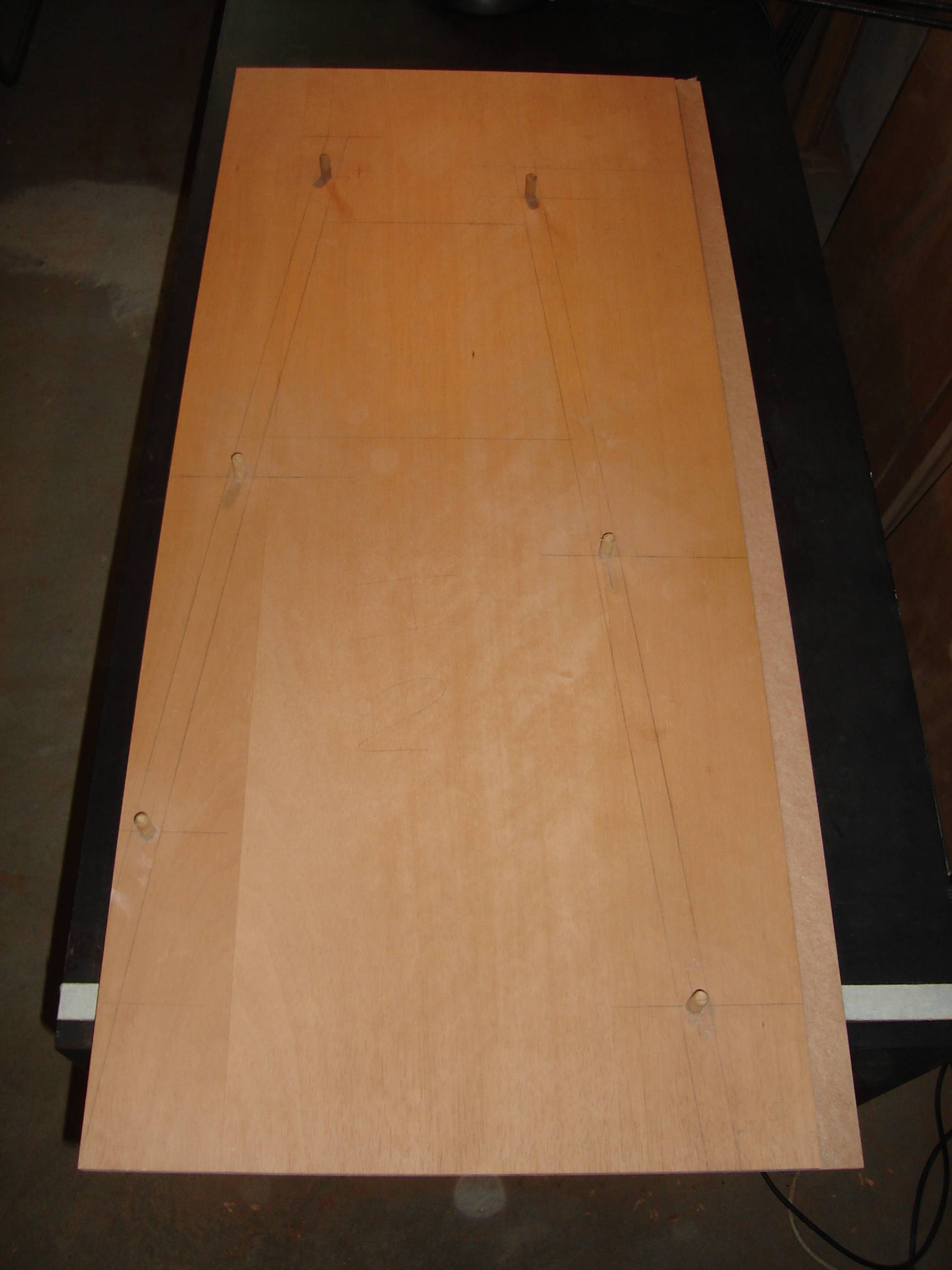

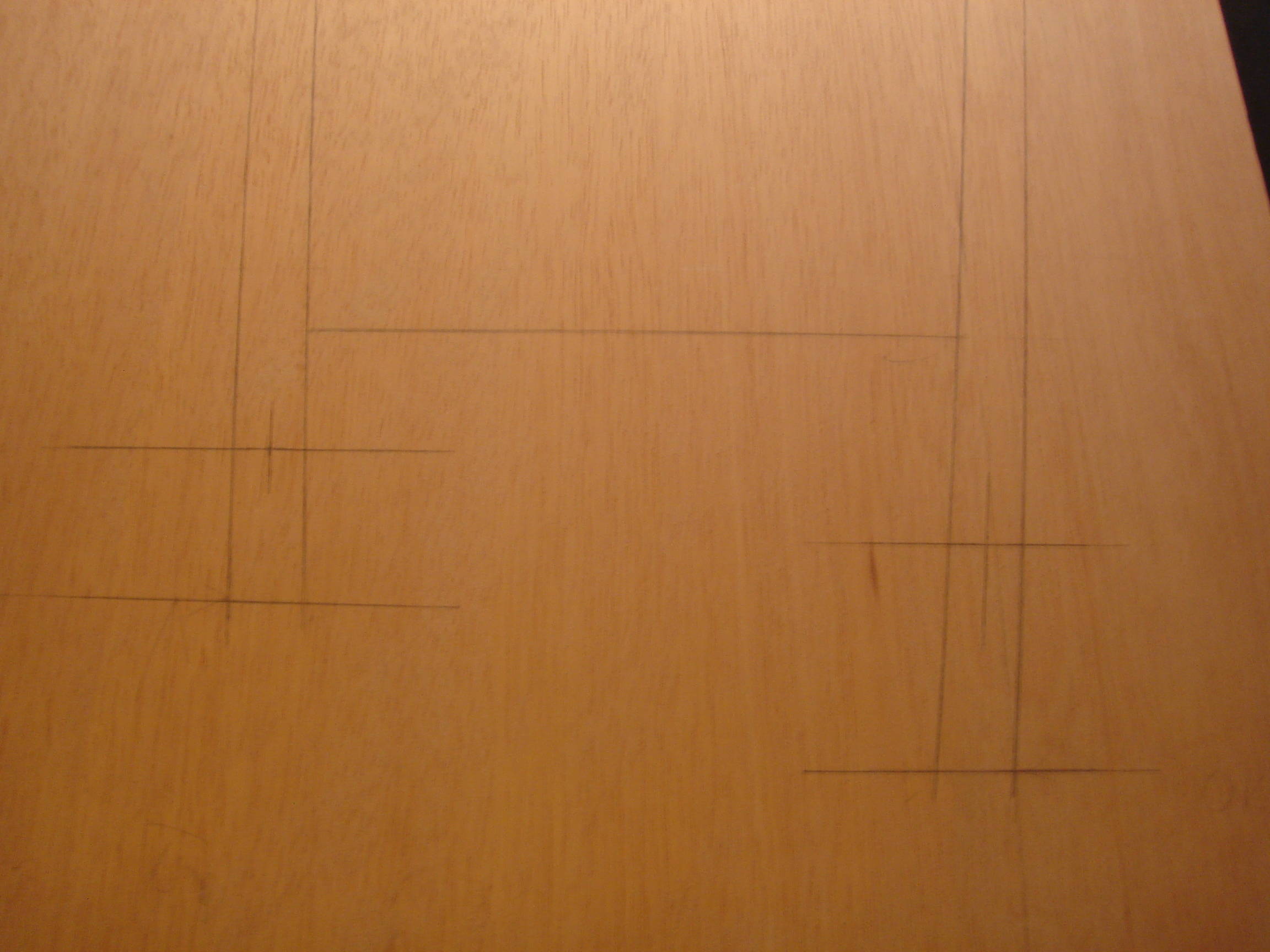

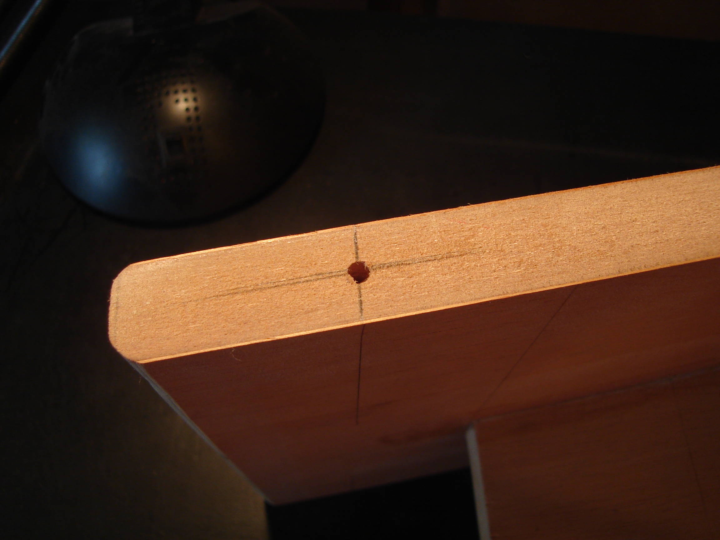

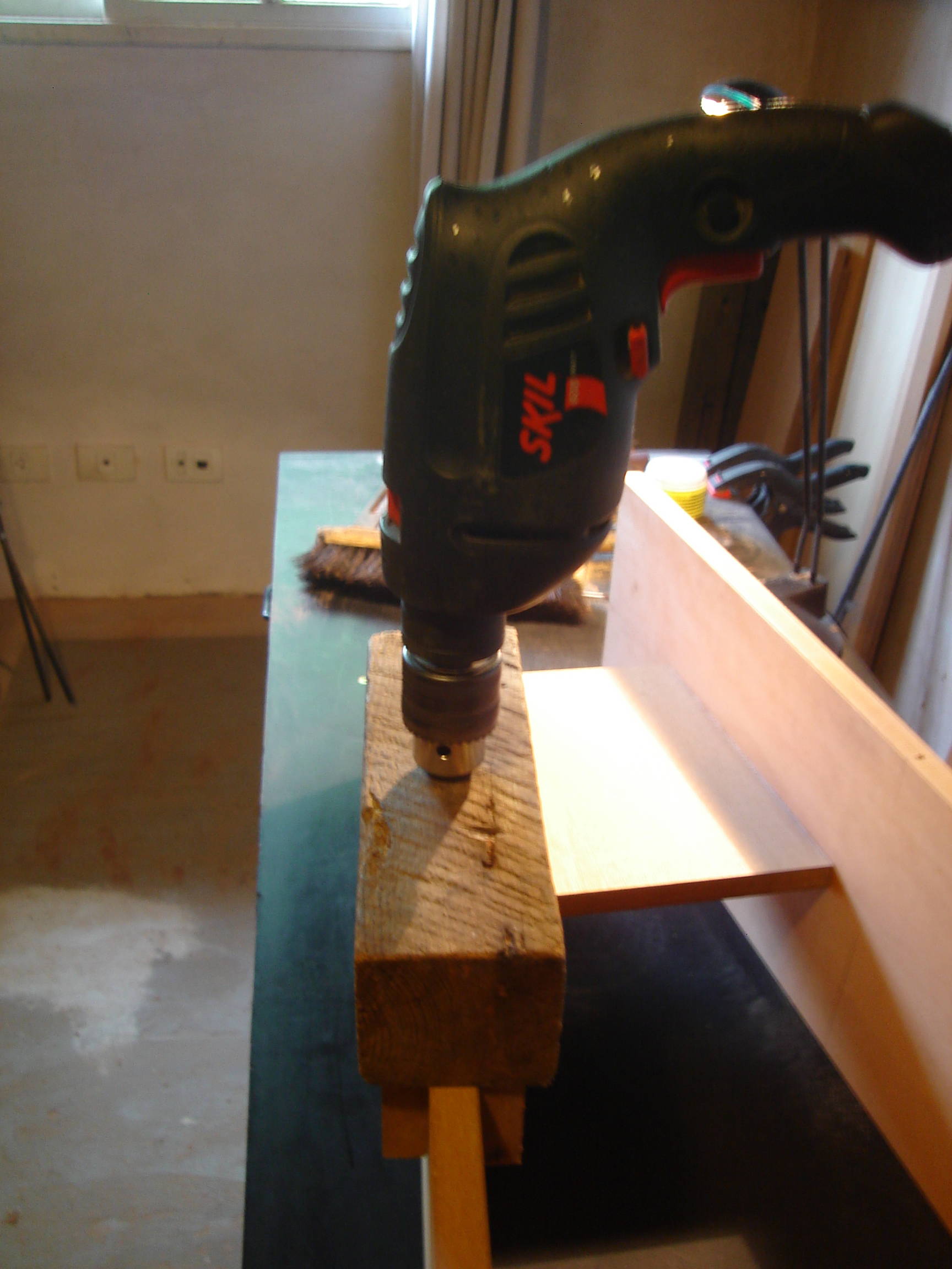

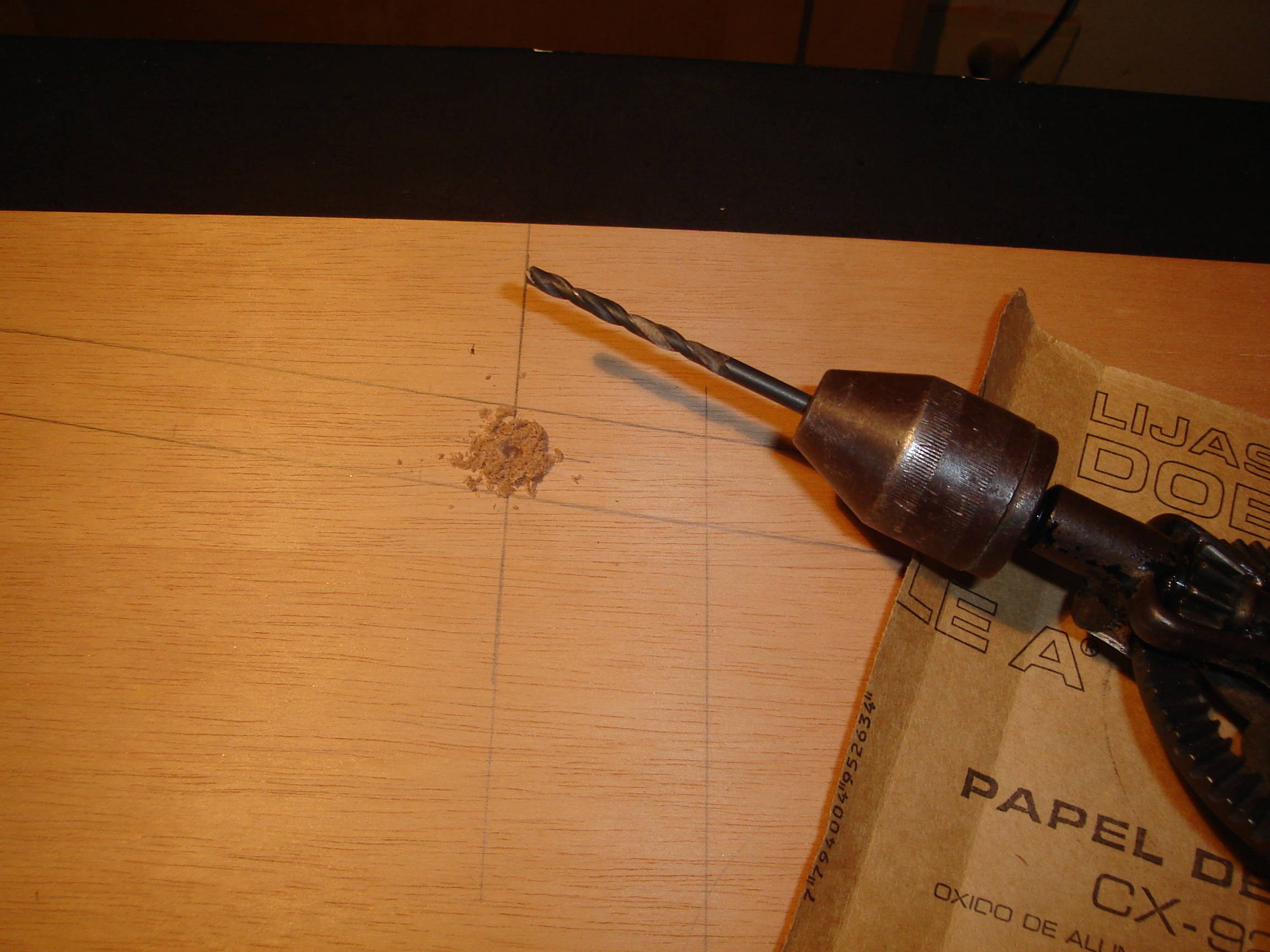

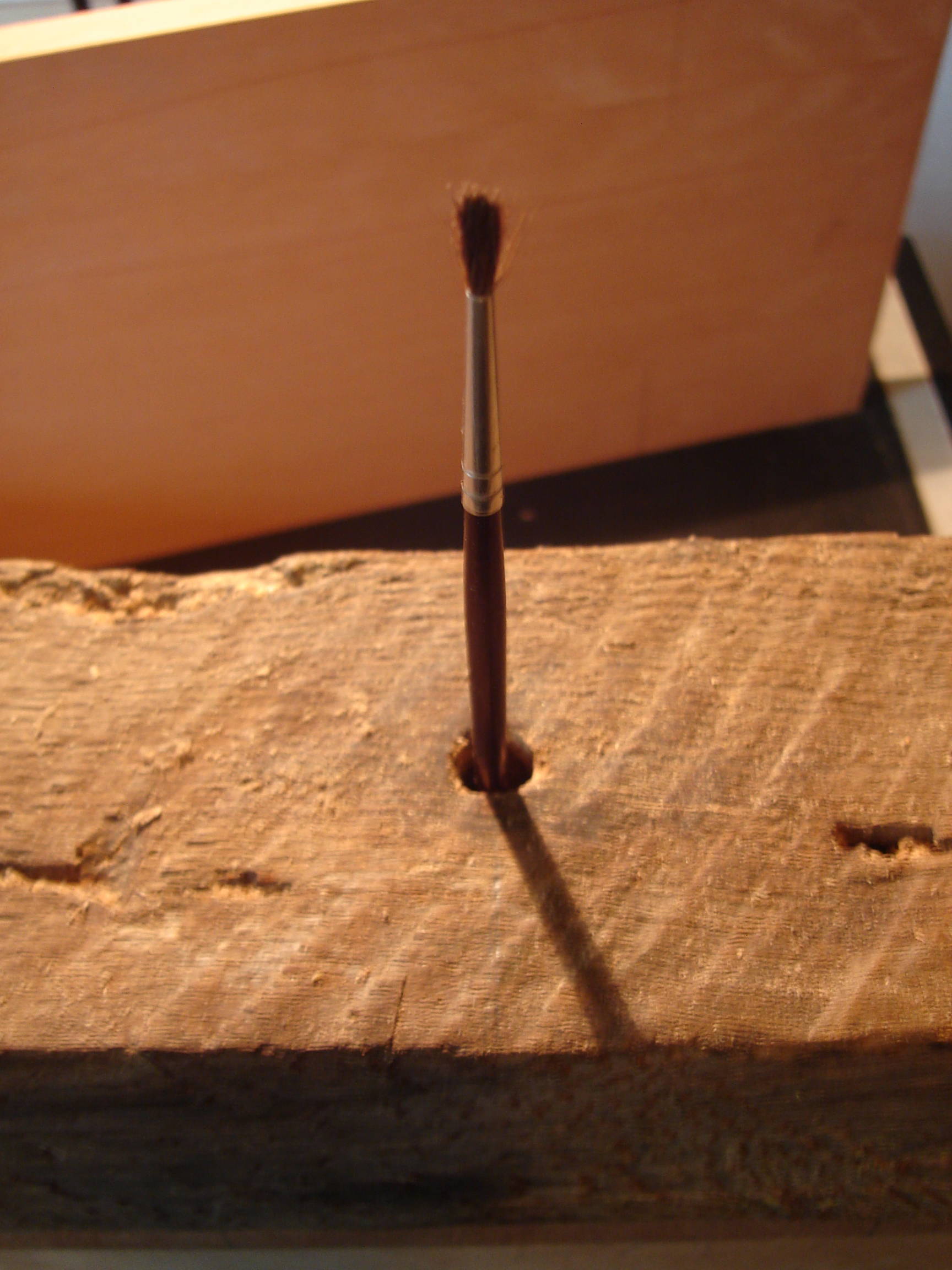

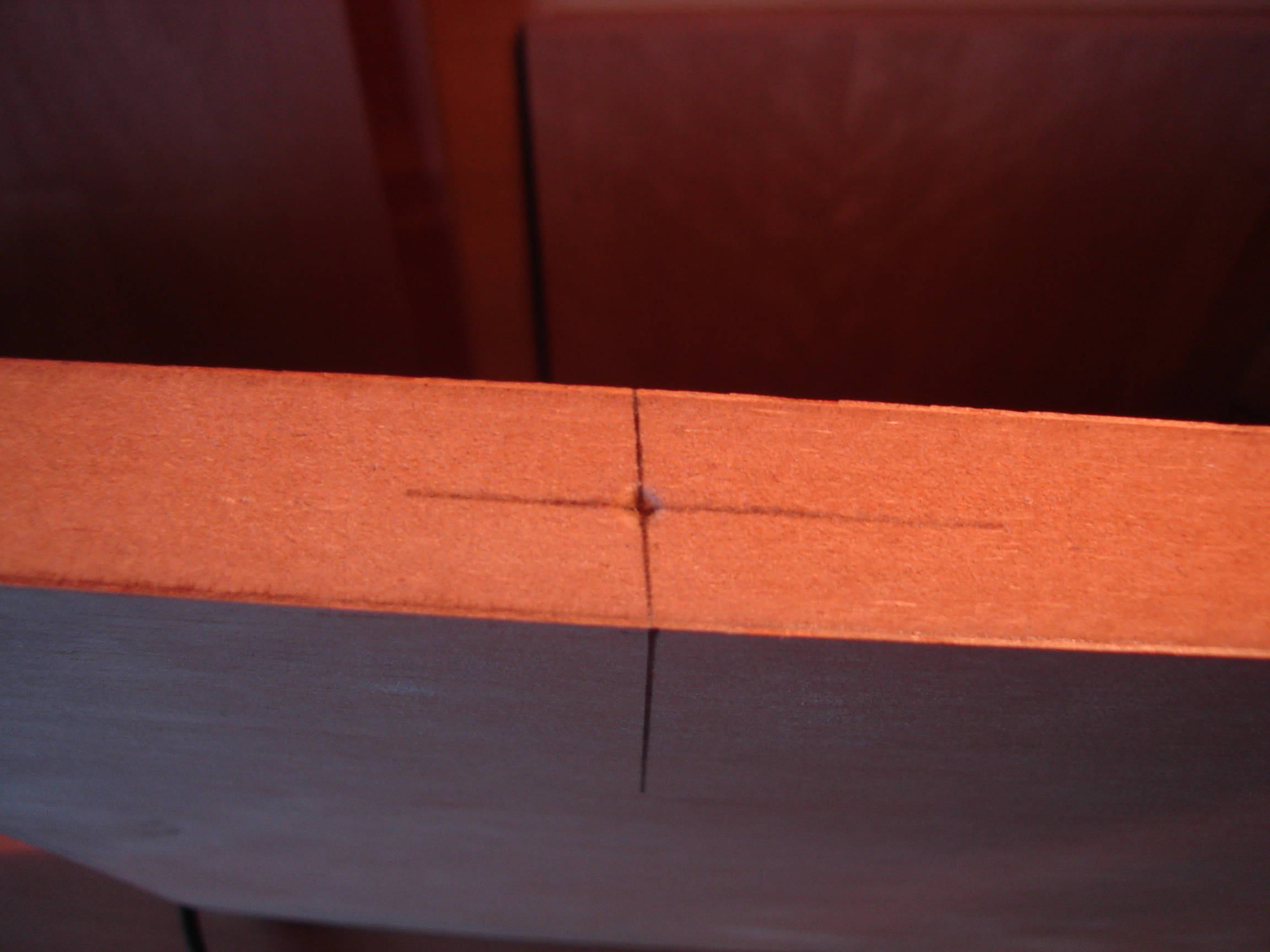

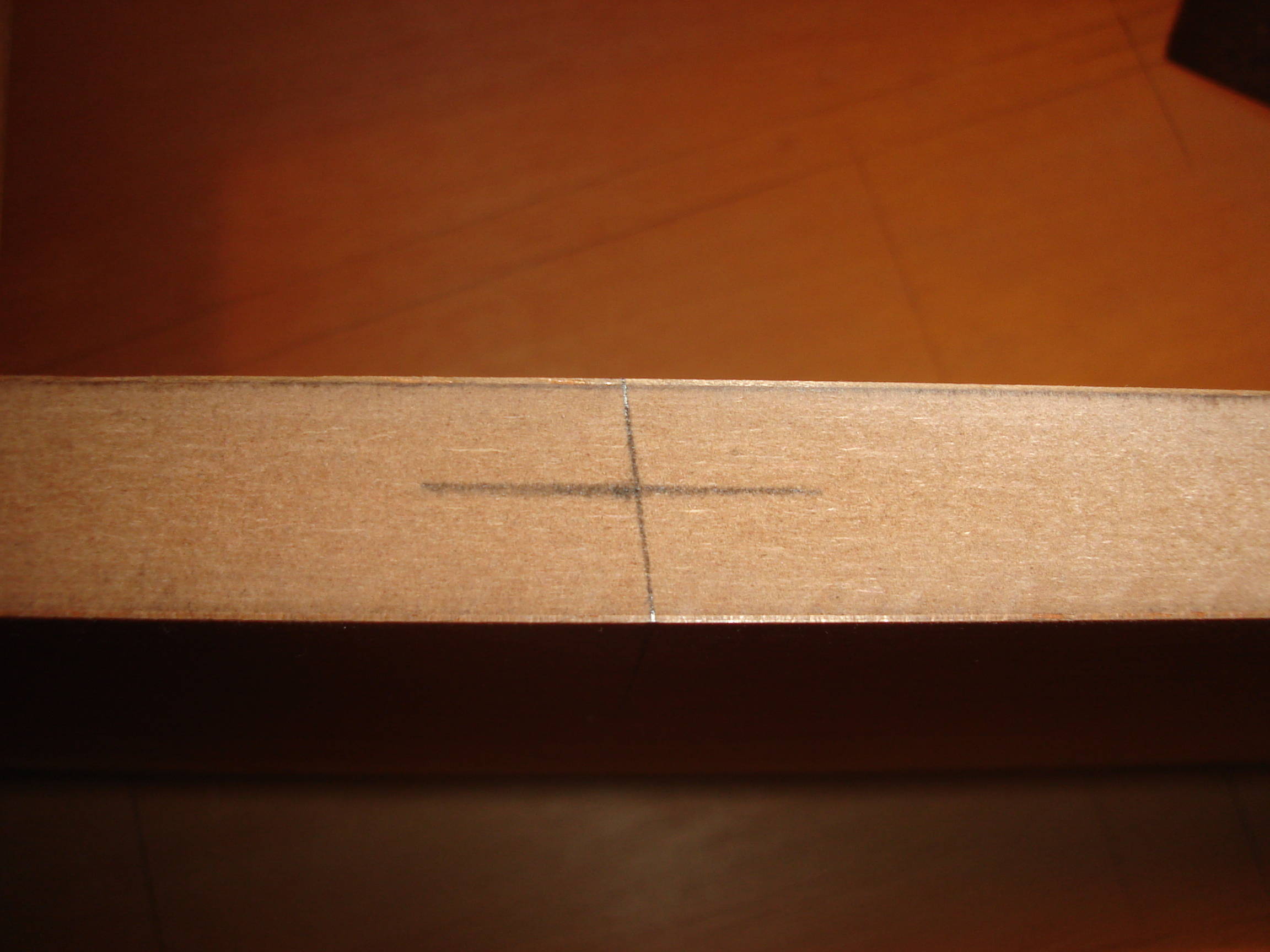

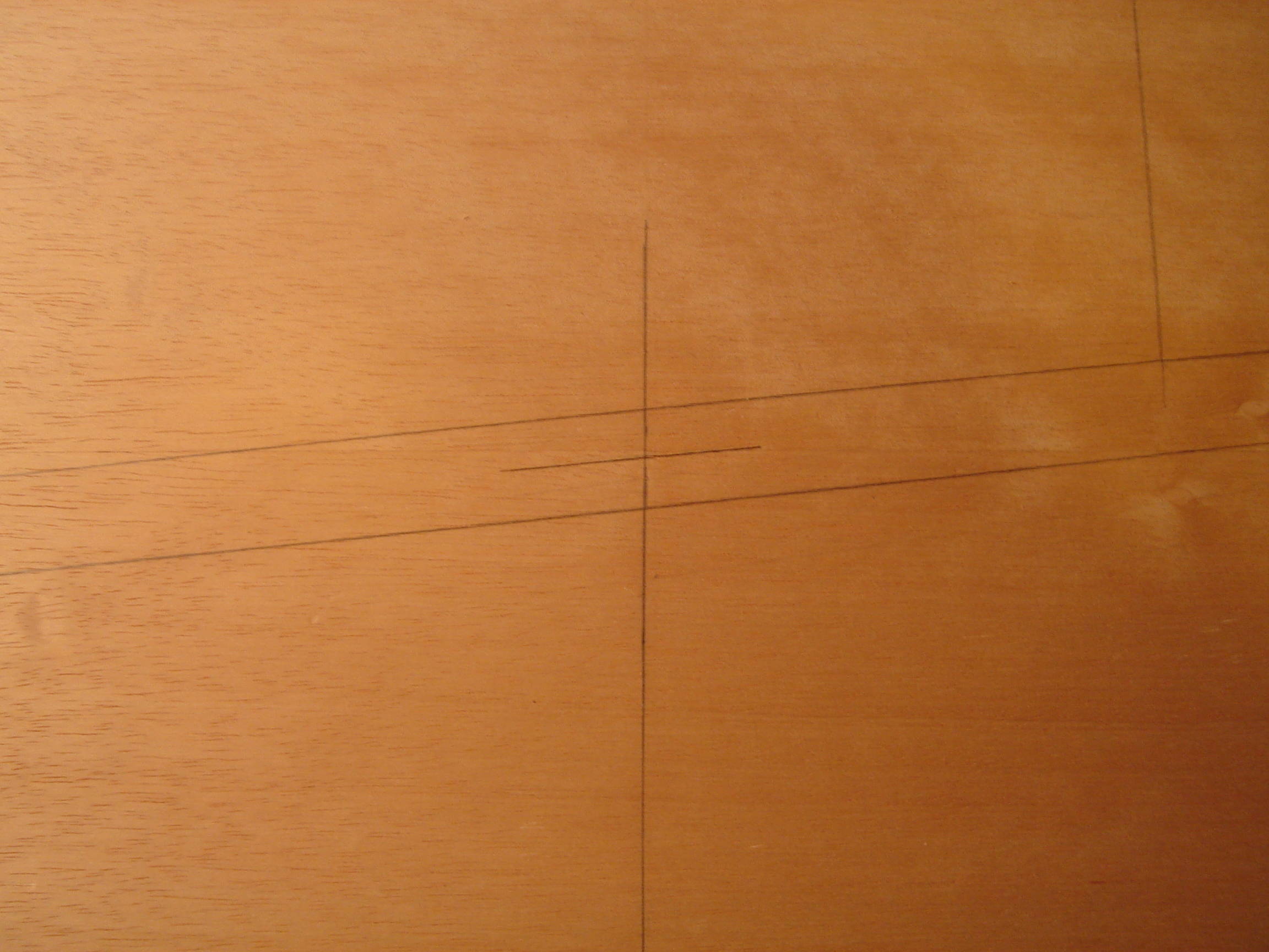

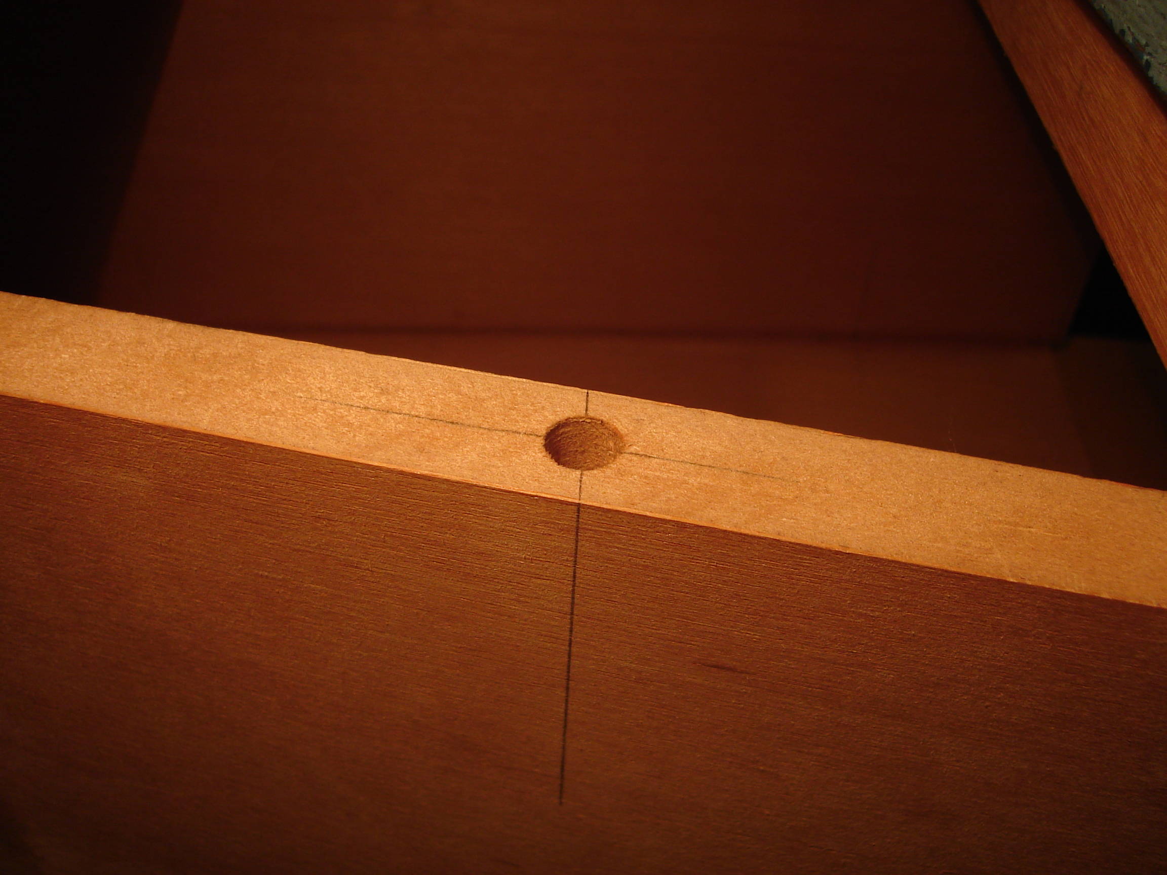

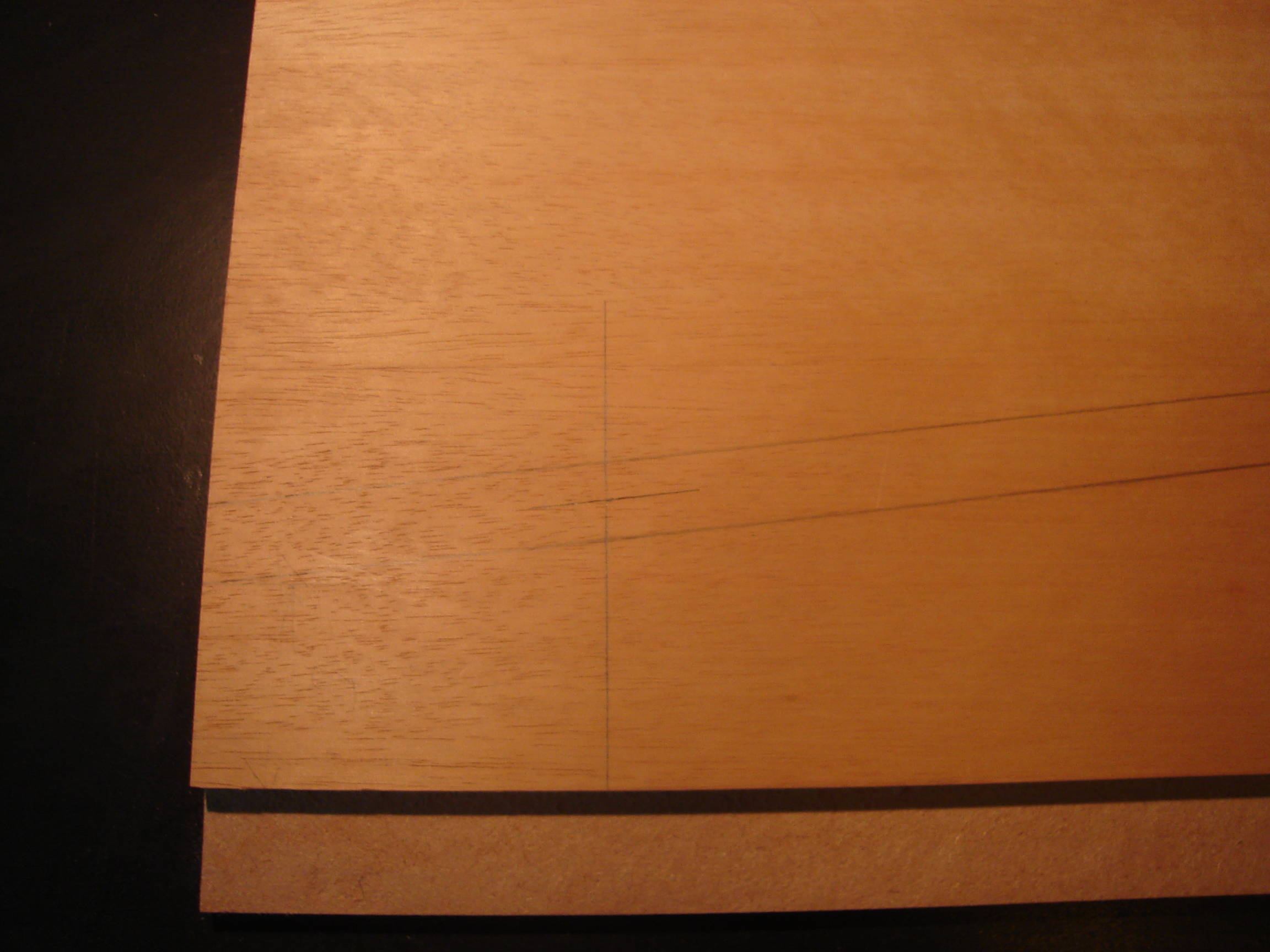

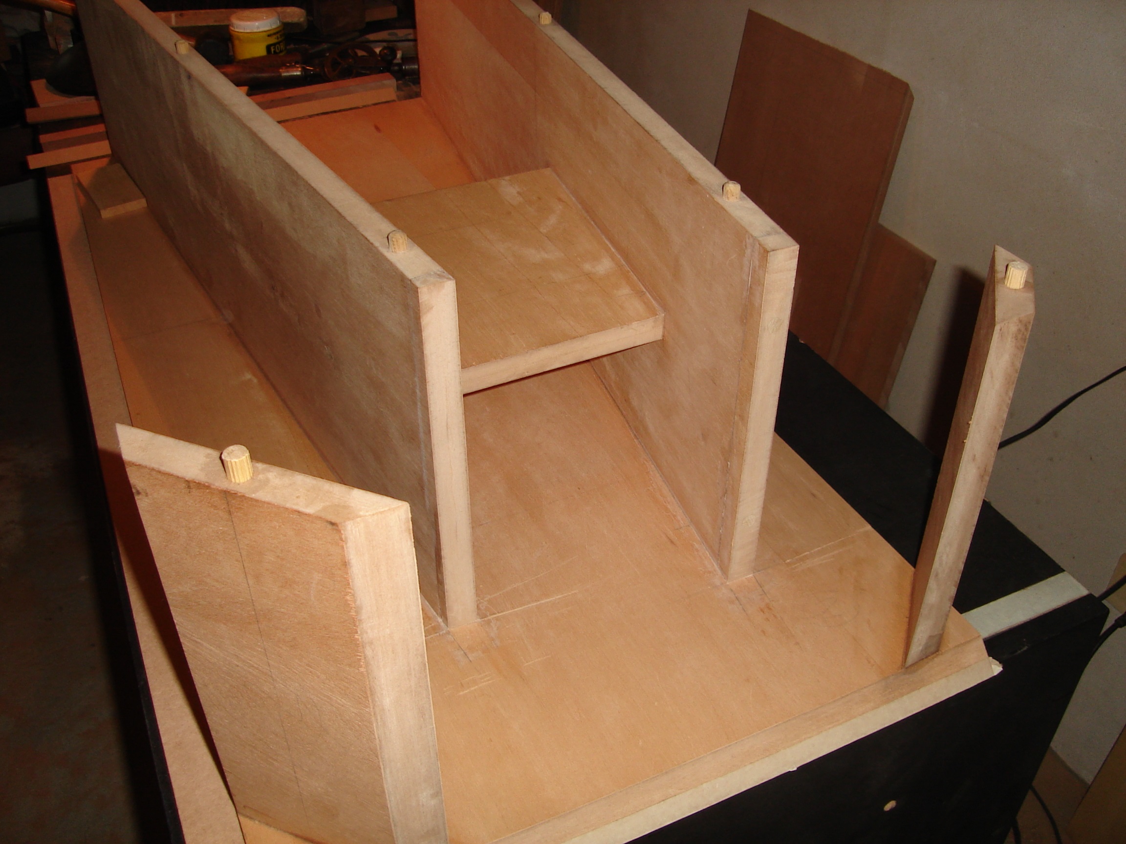

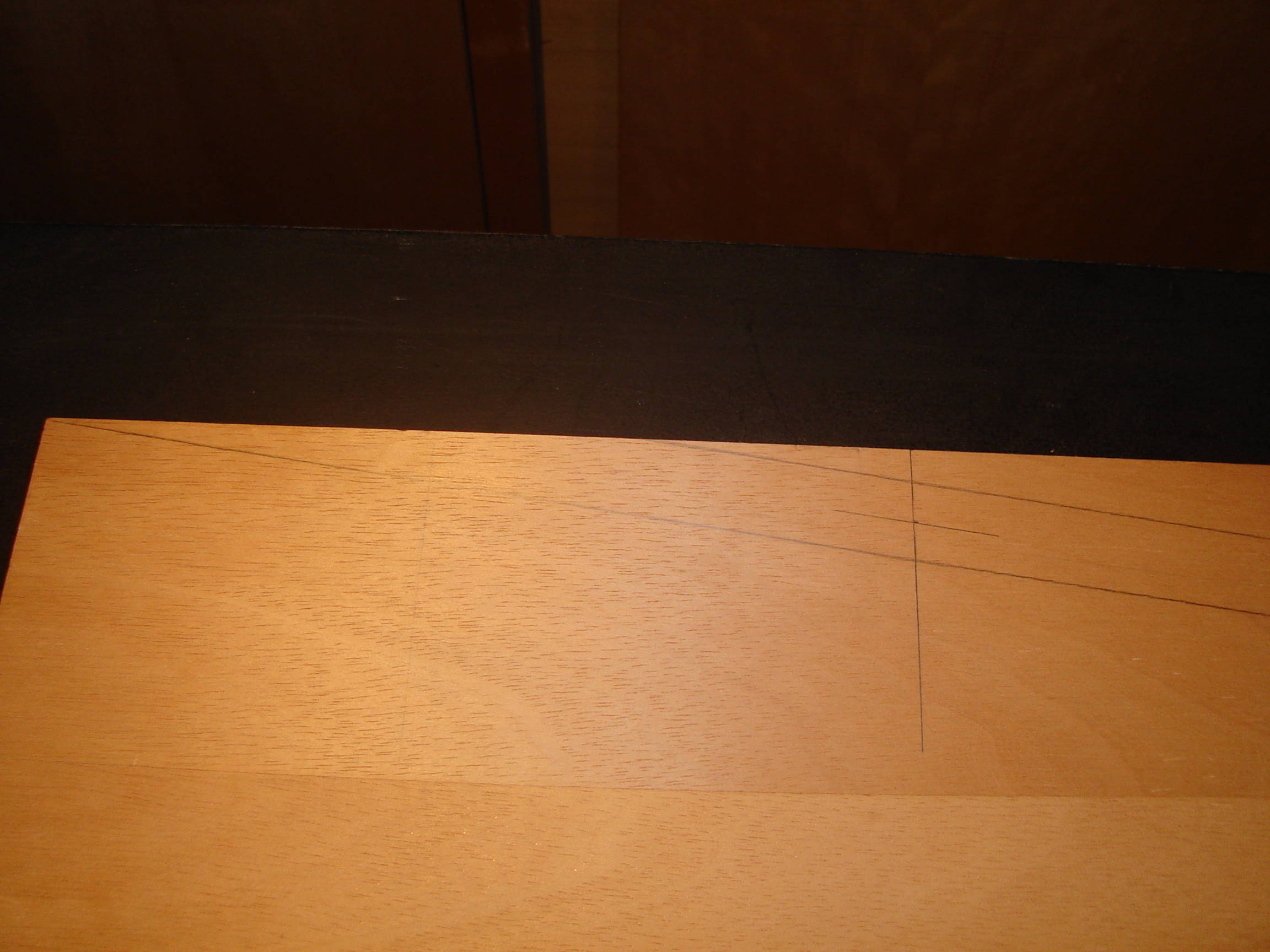

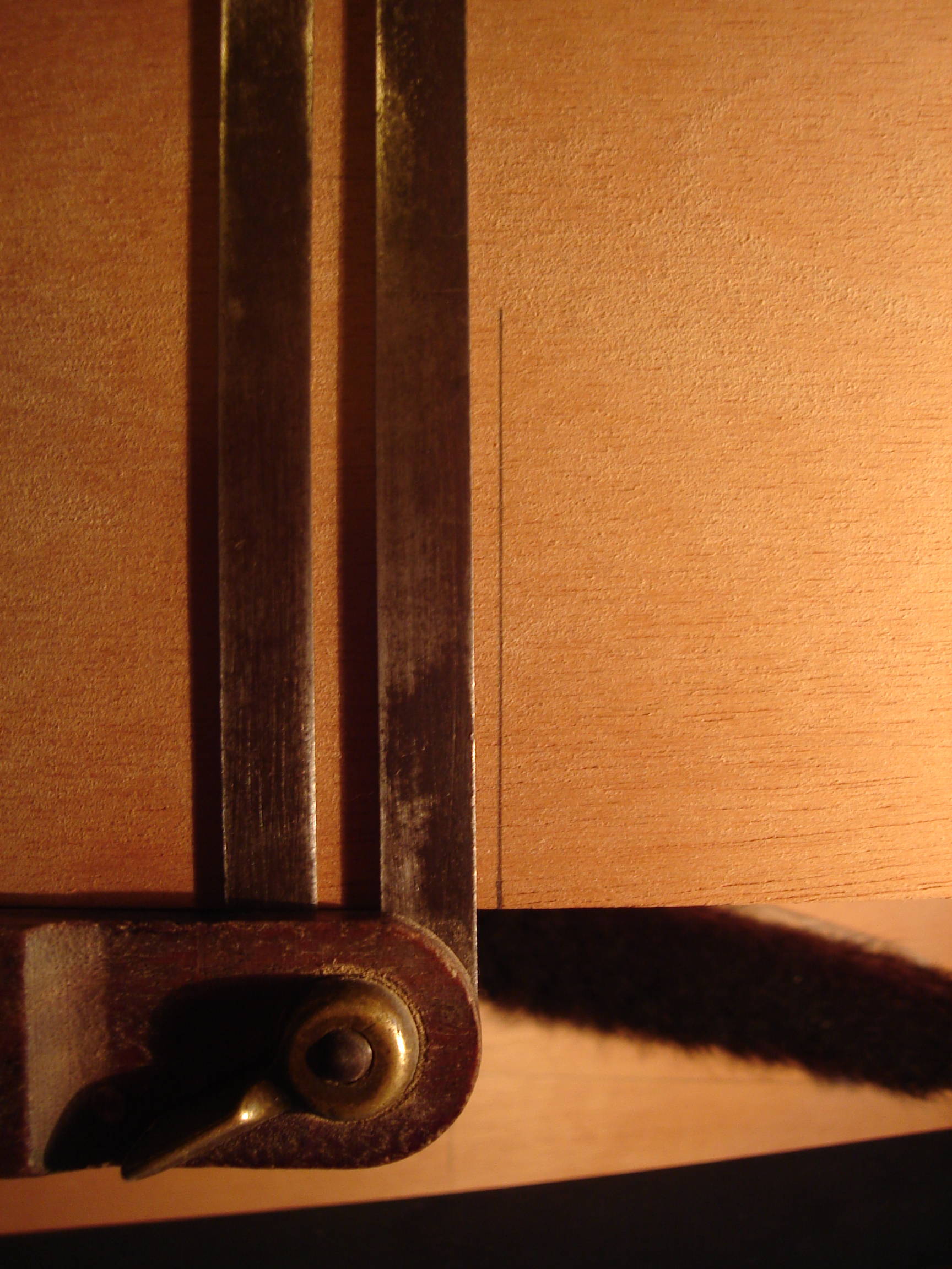

New photos, we are moving forward, slowly but surely...🙂
Here you see how I can mark the exact place for accommodation of wooden dowels.
It is very important is that cornerbacks are in place to prepare a special wood that to use the press without damaging the veneer.

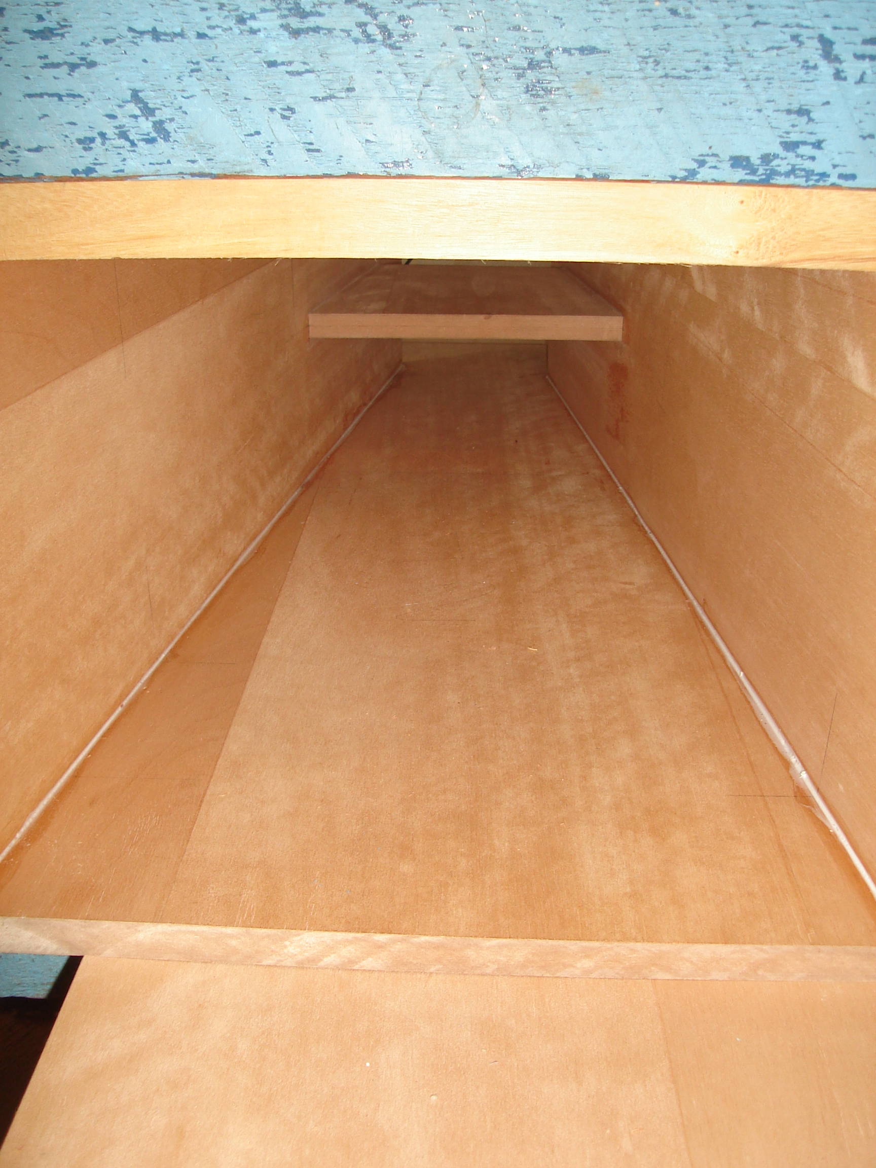

Second part, I'm almost done ...😀

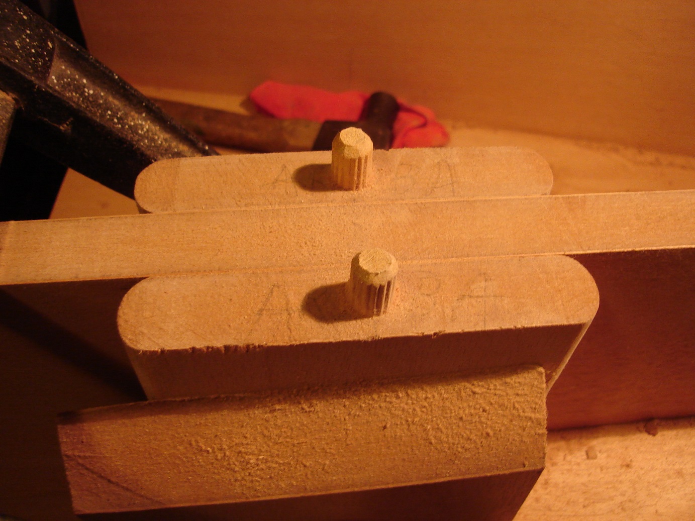

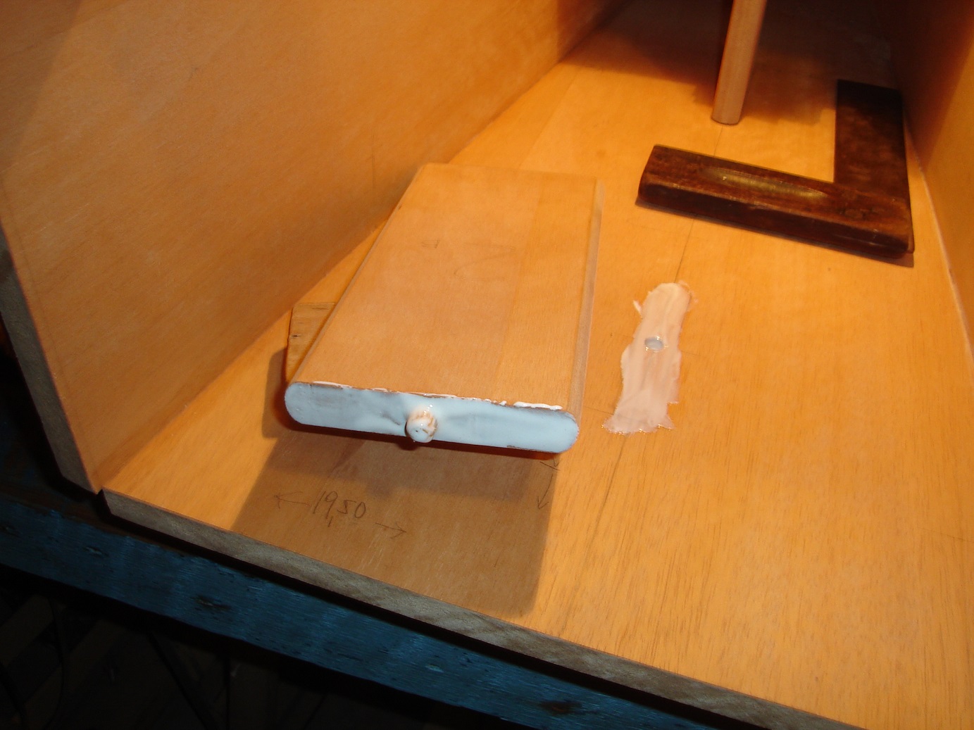

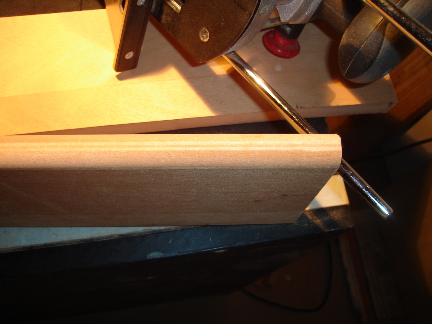

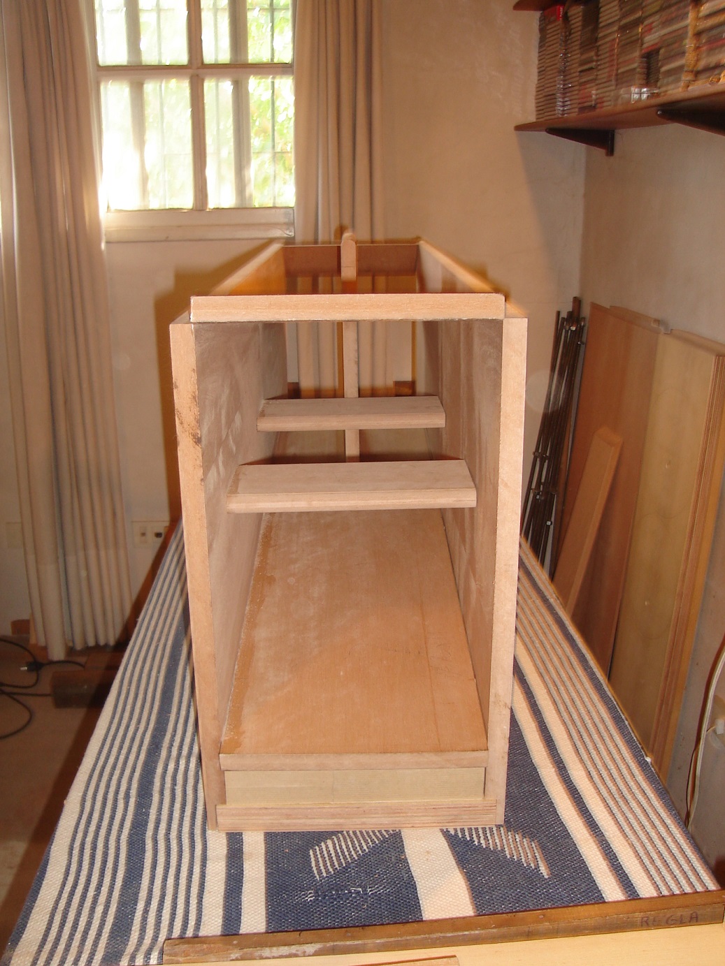

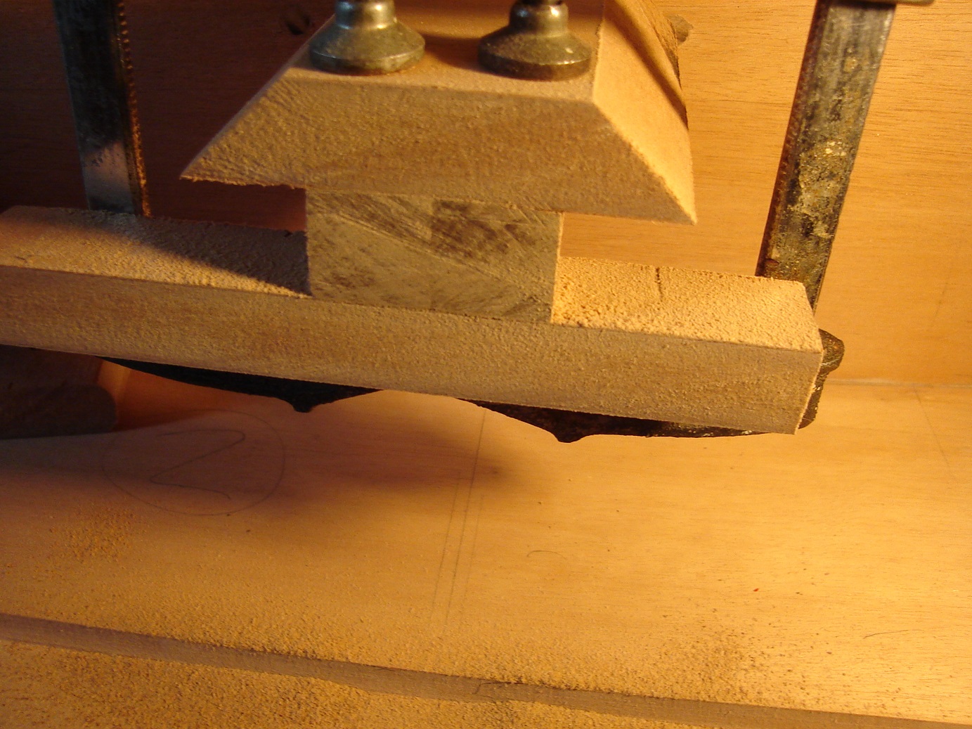

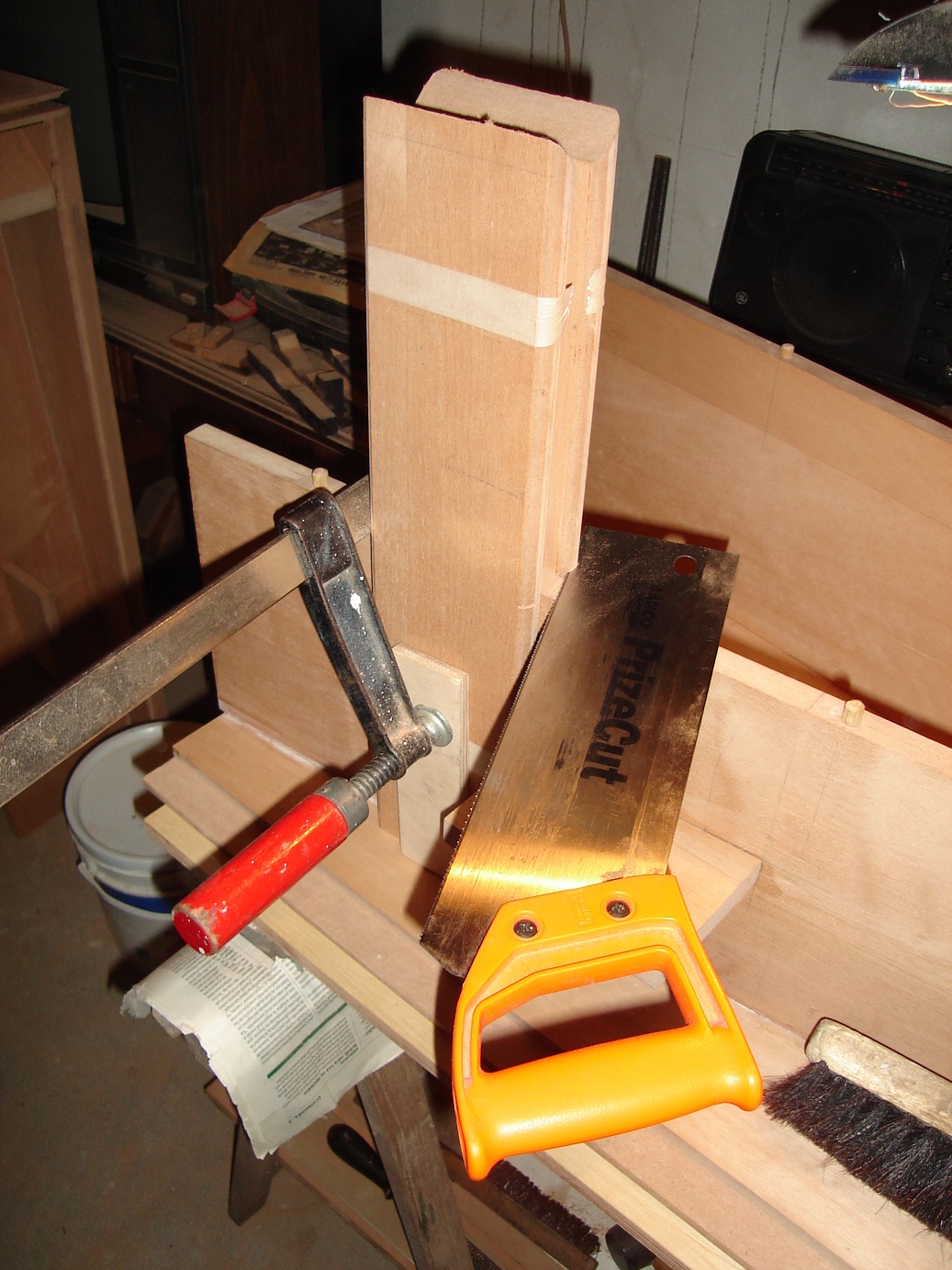

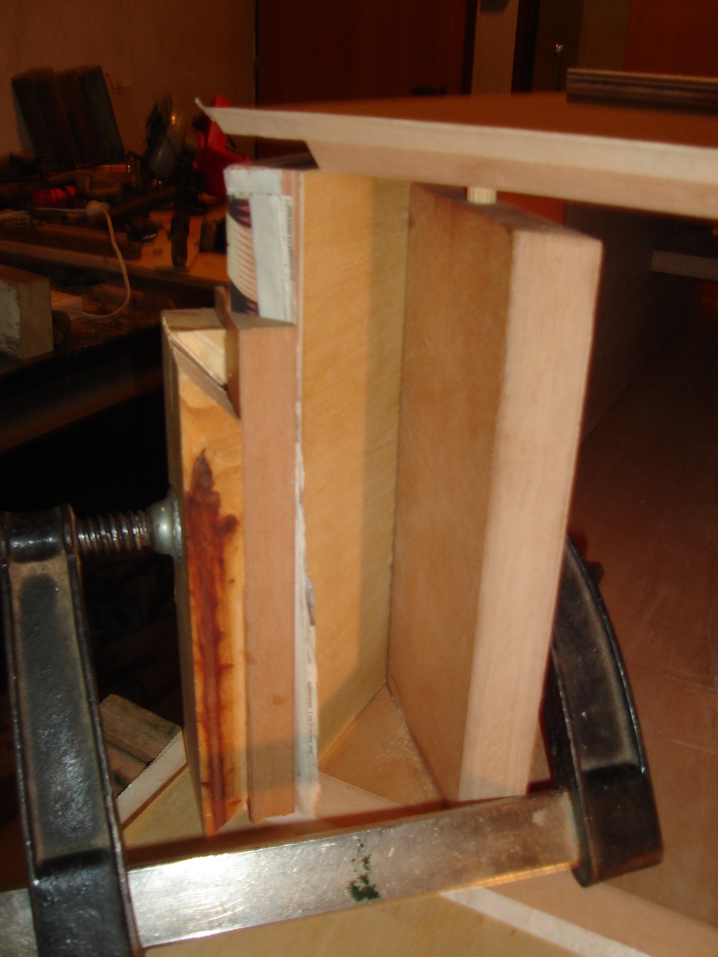

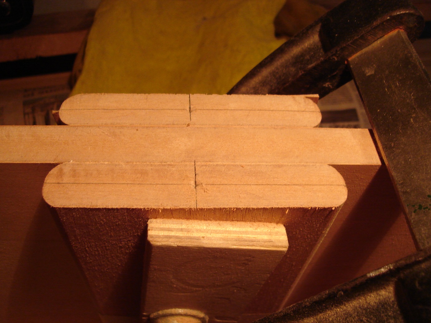

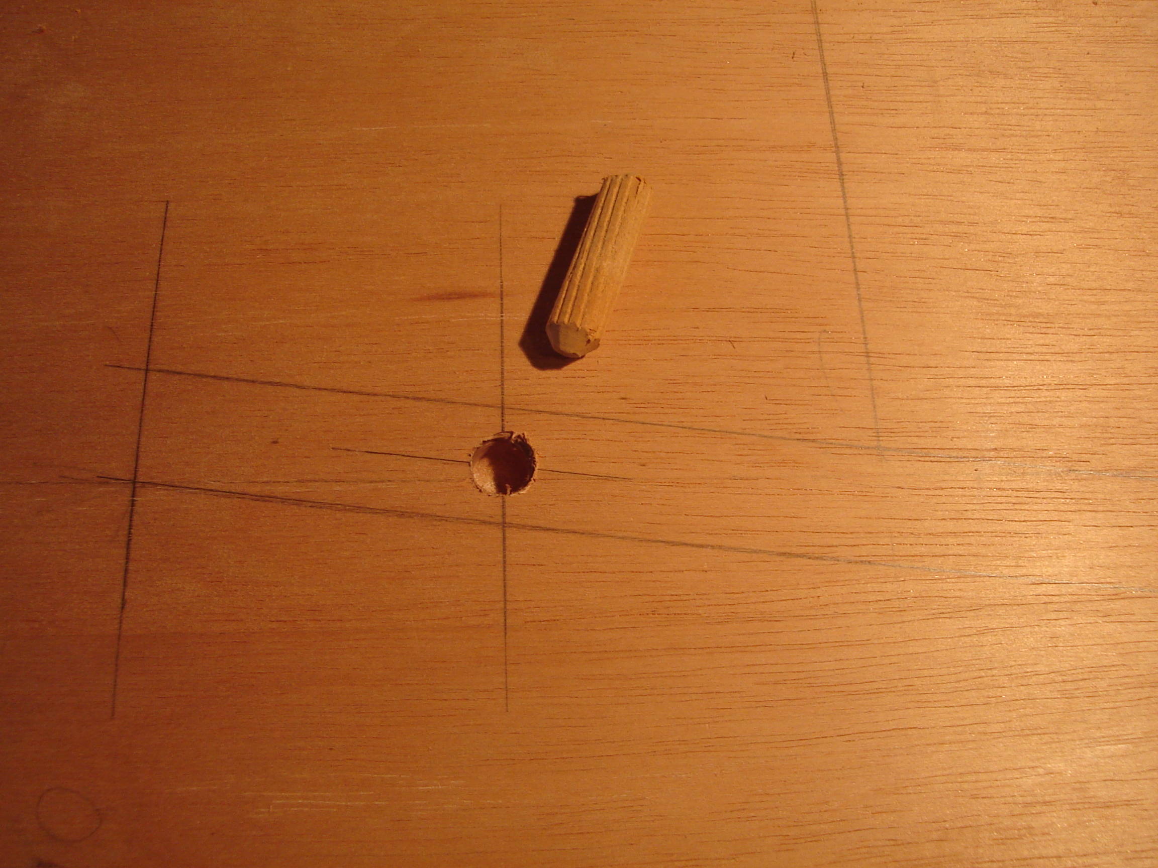

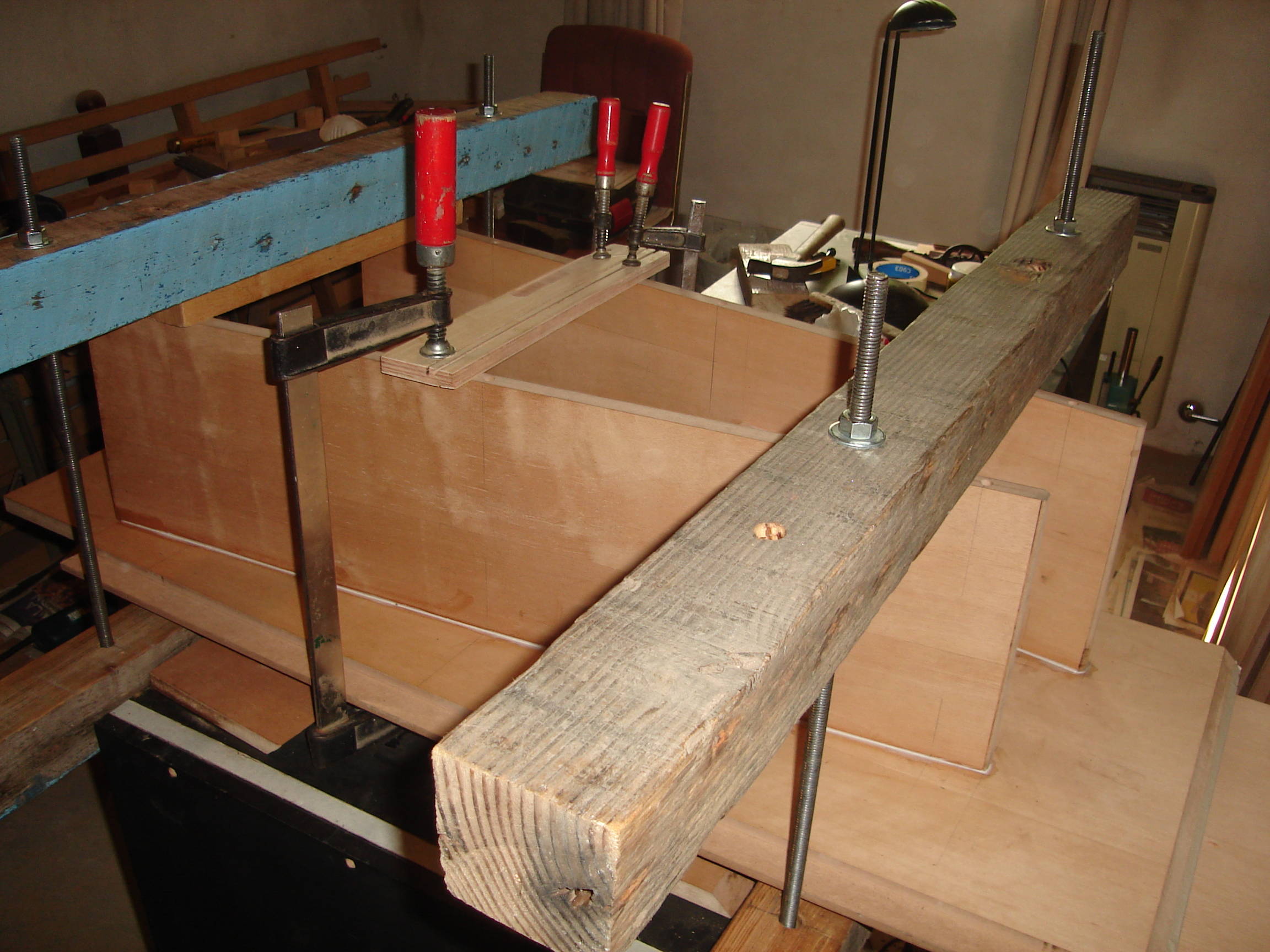

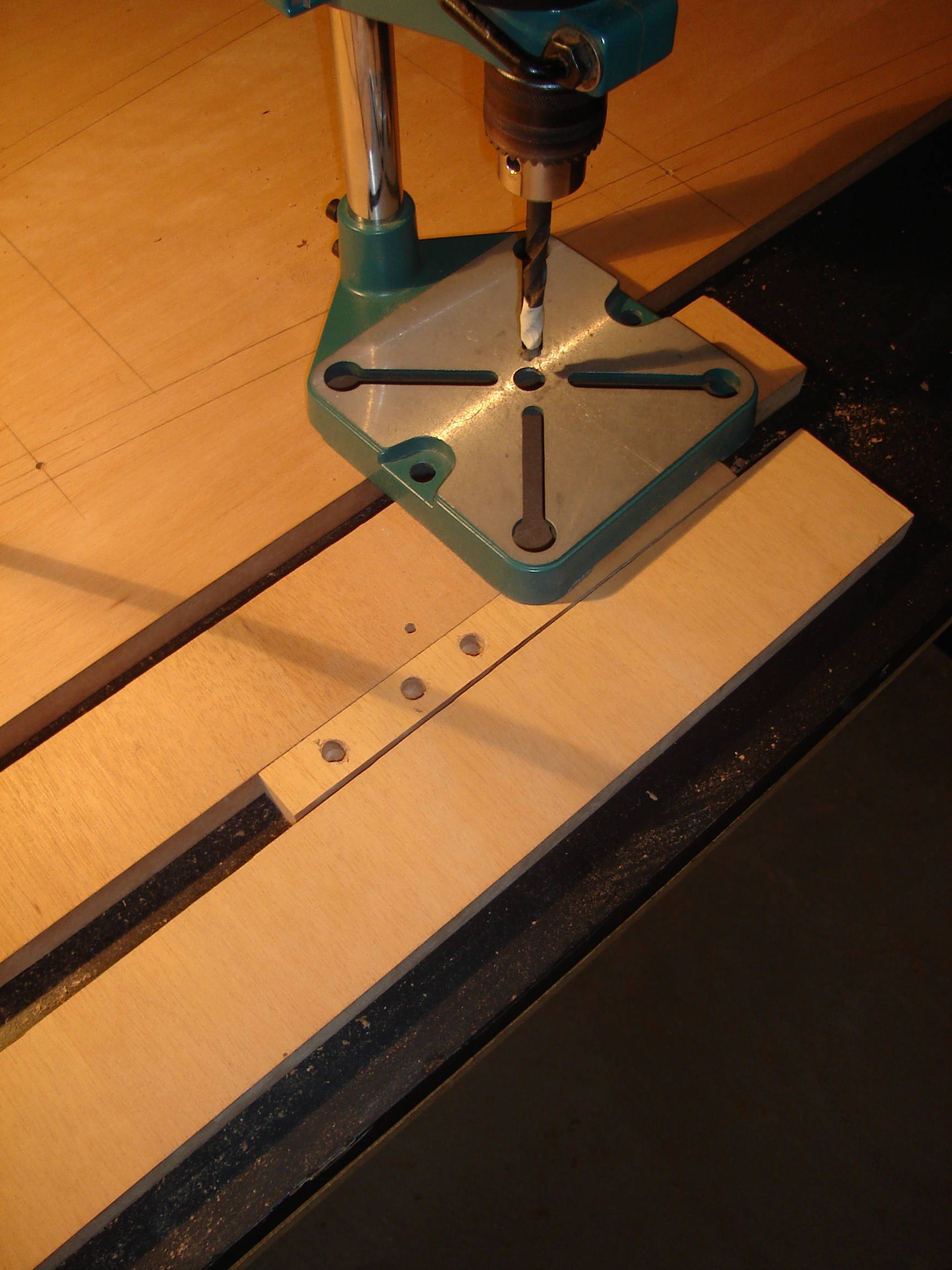

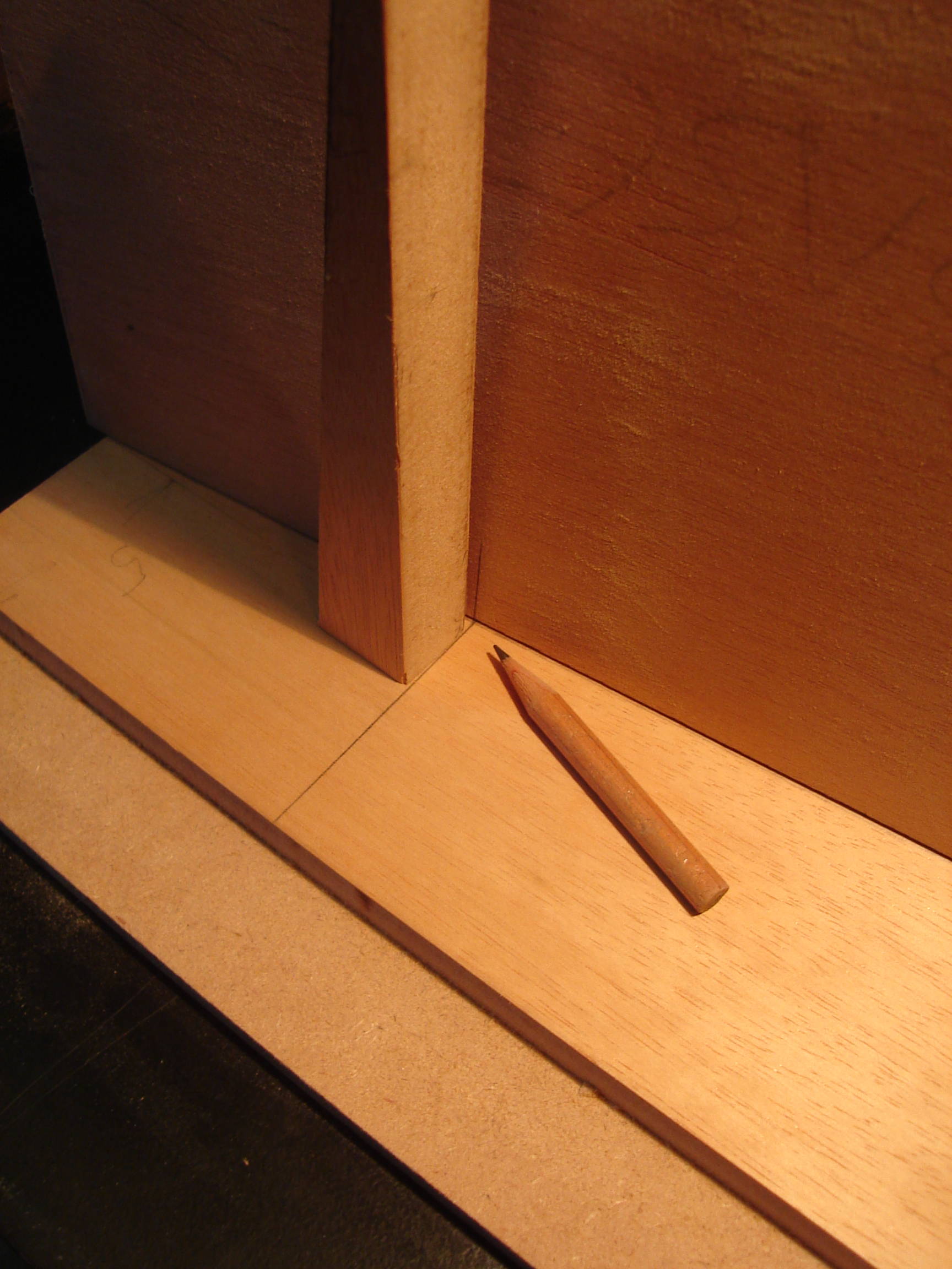

Last for today. 😉
Last for today. Remember that the advantage of using billets are several:
We do not need many presses, which would rise
overall spending too.
We do not run risks move to the woods glueing.
We can adjust some court if necessary, so getting a professional adjustment of the joints.

Add some extra photos so they can see in detail stuck with glue and dowels.....😱🙂
