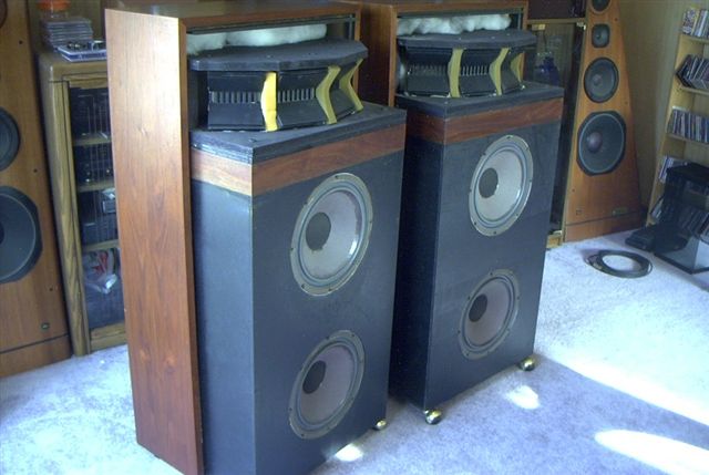

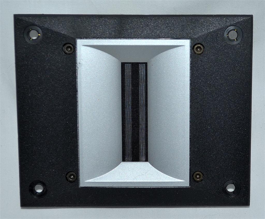

Listen long time ago tweeters of Dr.Oskar Heil, AMT, but did not finish convince me, too soft. But perhaps they have improved a lot, the Ess brand is making yet, I have understood. I remember the monster AMT6 ..... it was not for use with vacuum valves .....:no:
In tweeters tape I liked much one that produced JVC (rara avis) Excellent, but (nothing is perfect, once again) its vertical dispersion was very poor. But I am now entering the danger zone, many memories and I get nostalgic ...😱
The monster Ess AMT6 and ribbon tweeter JVC HSW1101

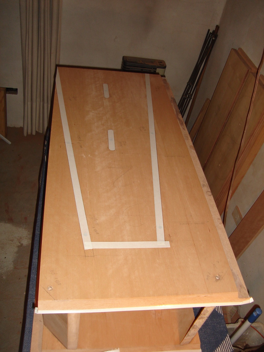

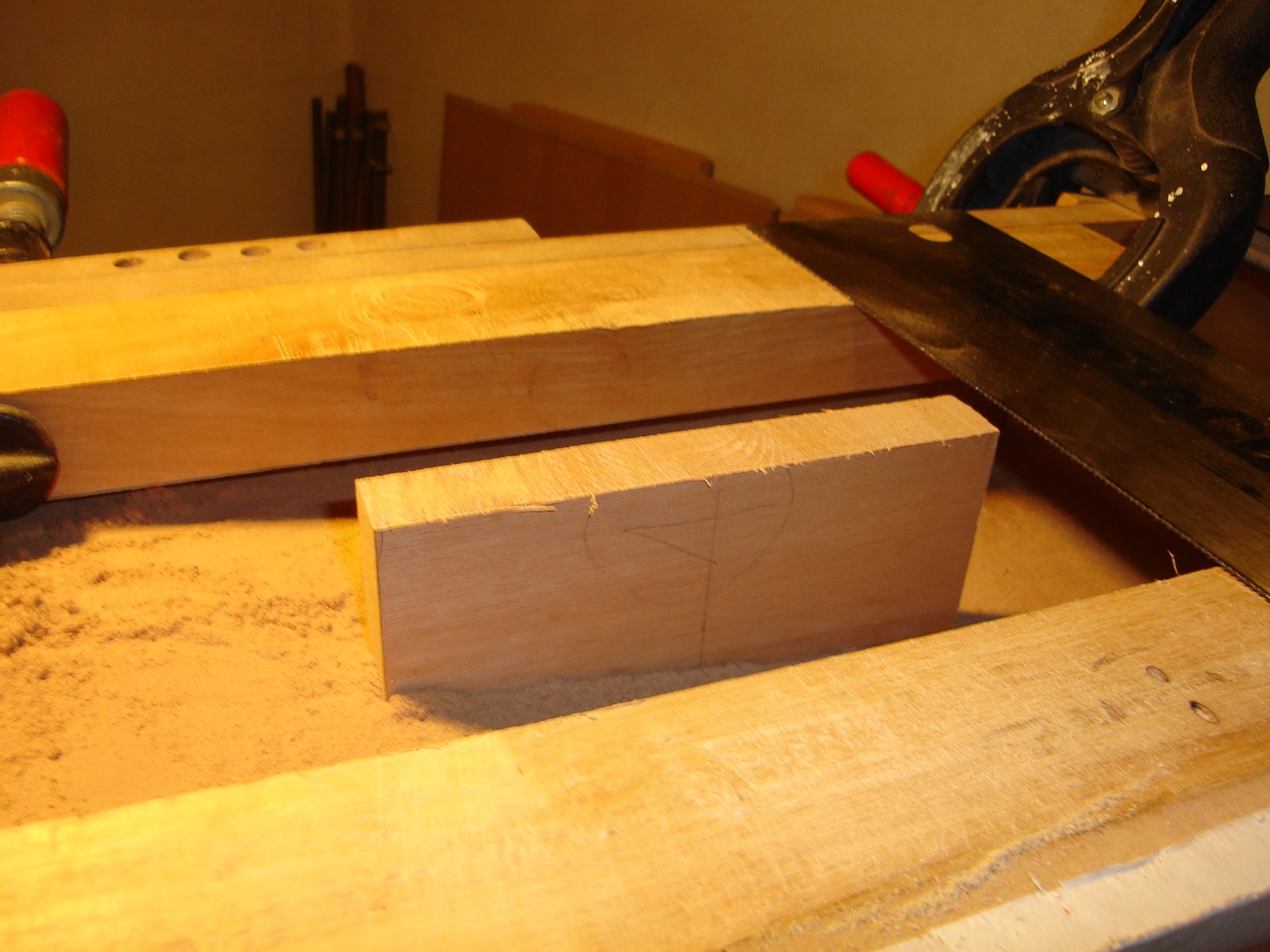

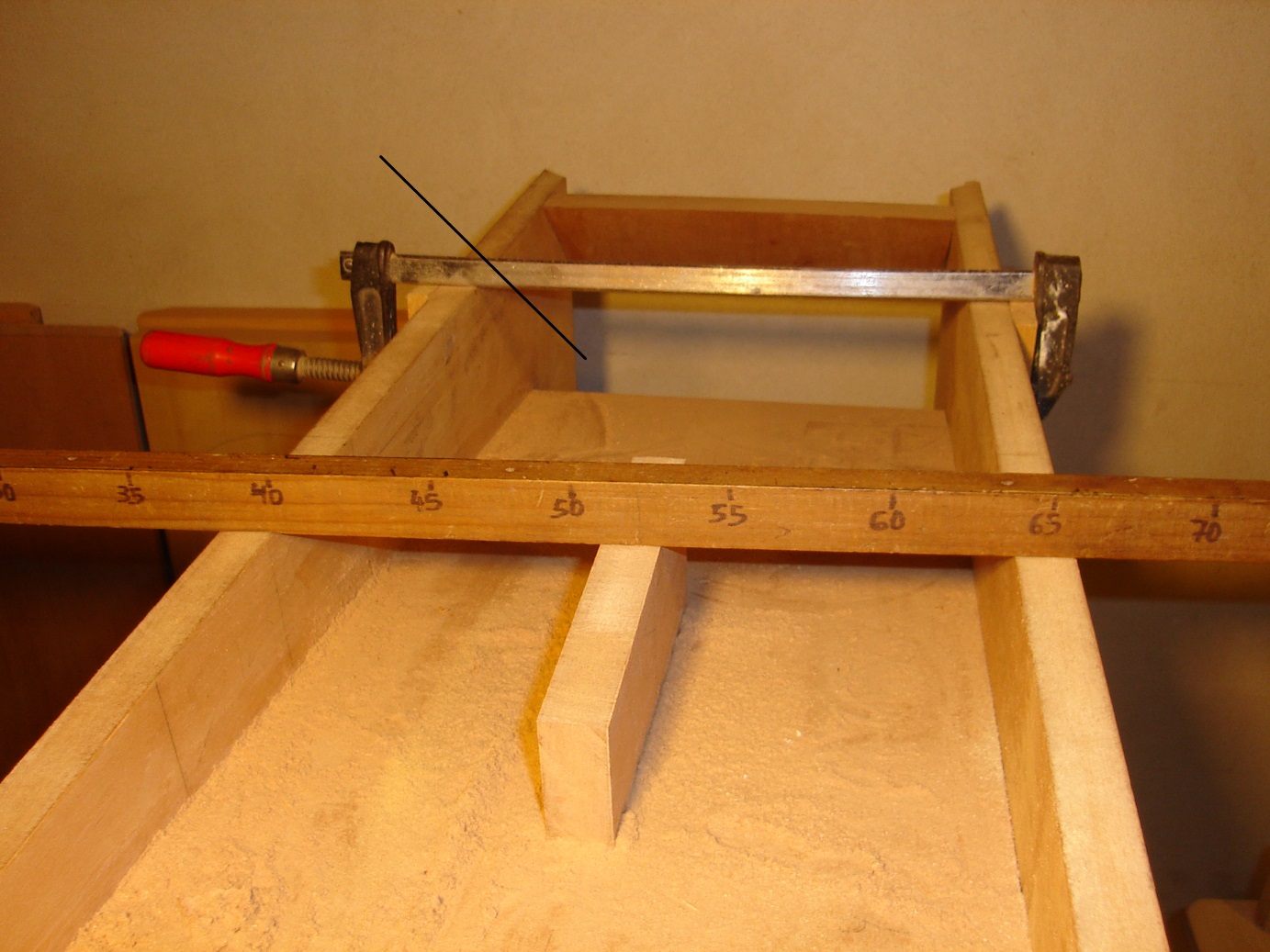

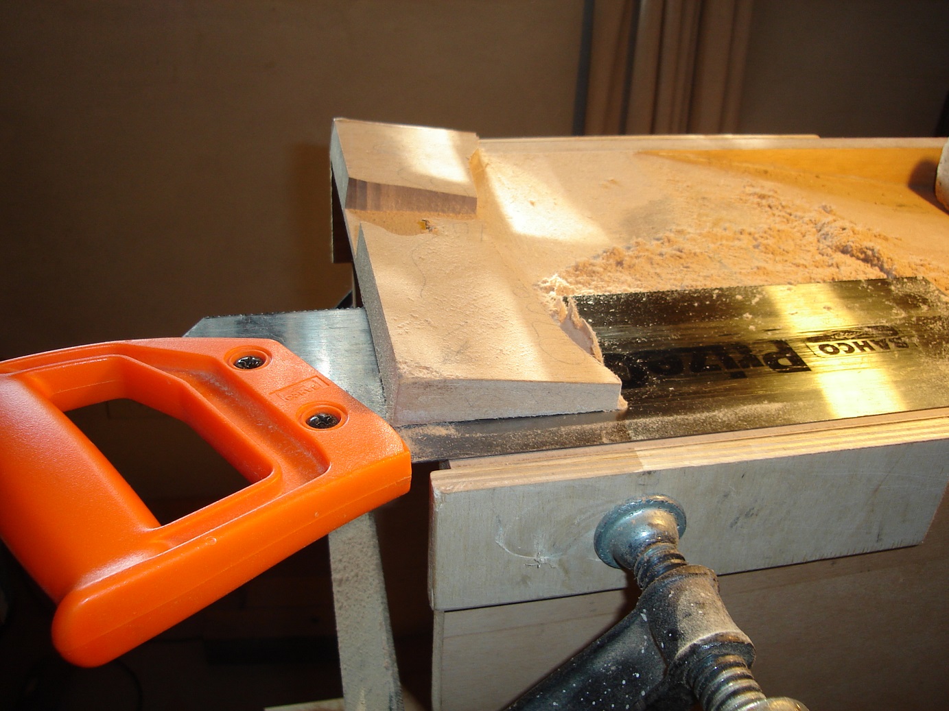

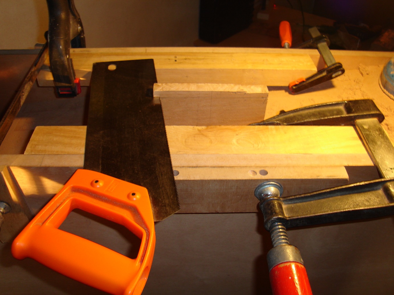

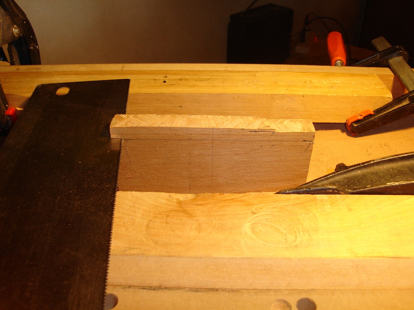

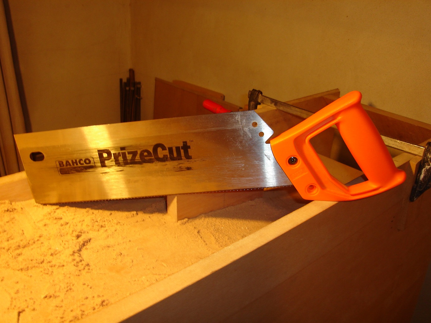

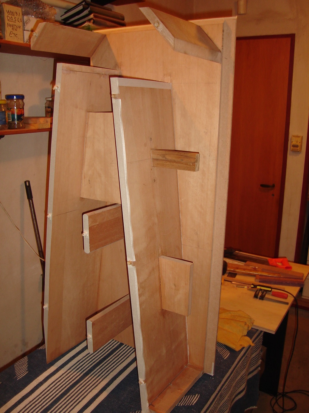

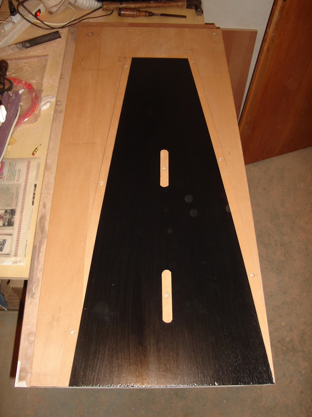

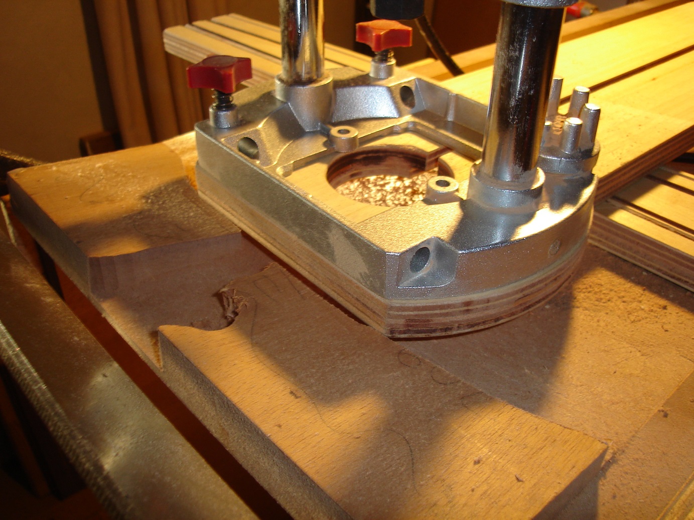

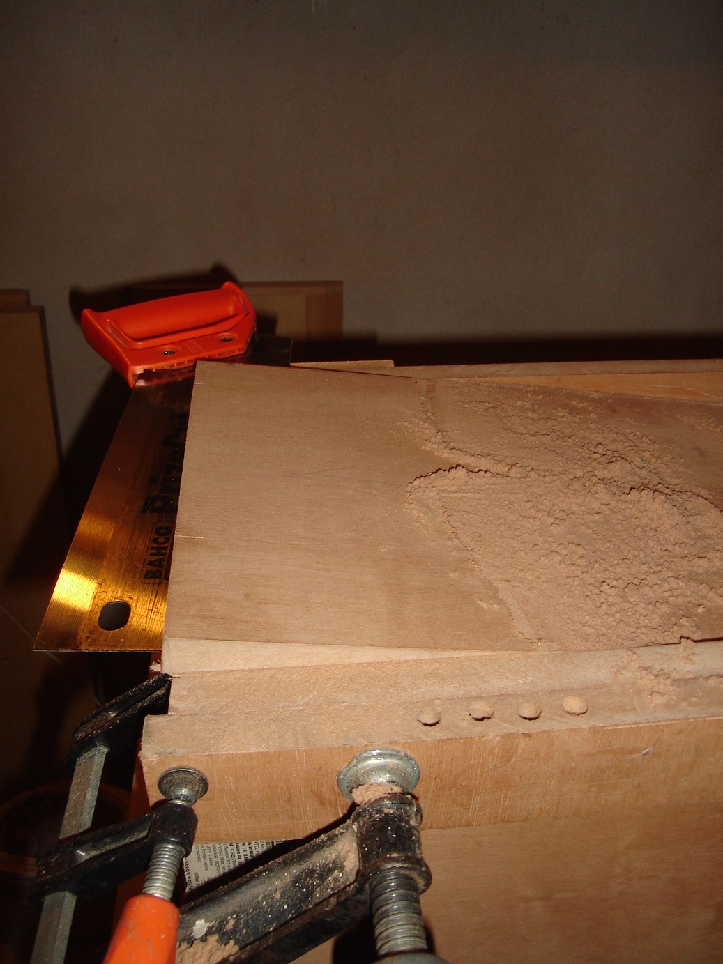

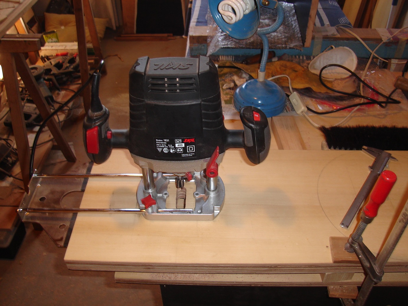

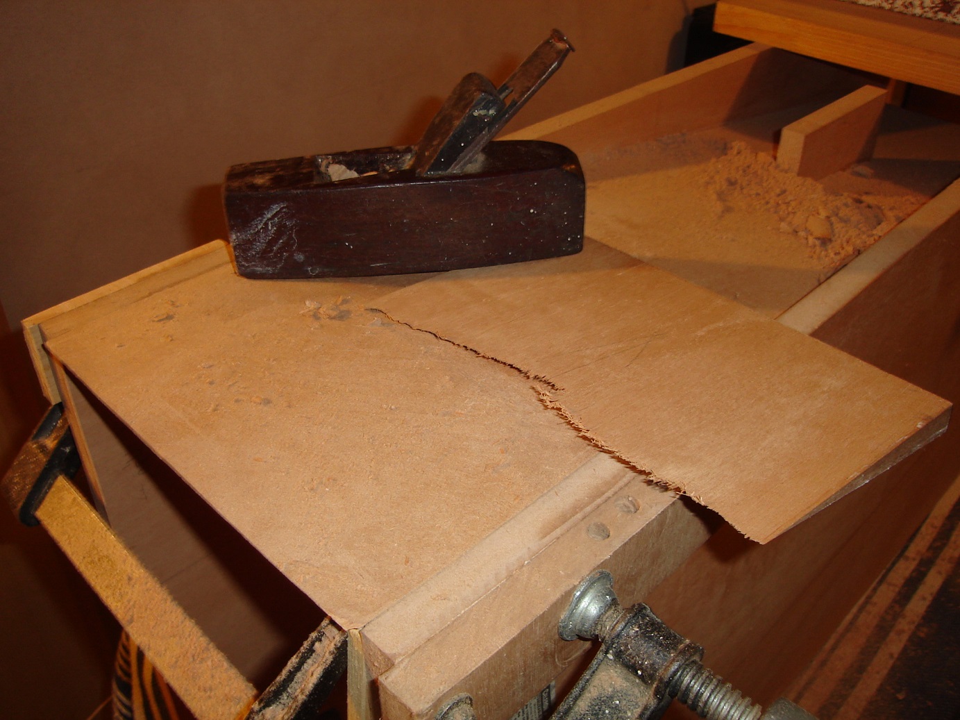

I have perfected the method for cutting the reinforcements of the front and rear panels :

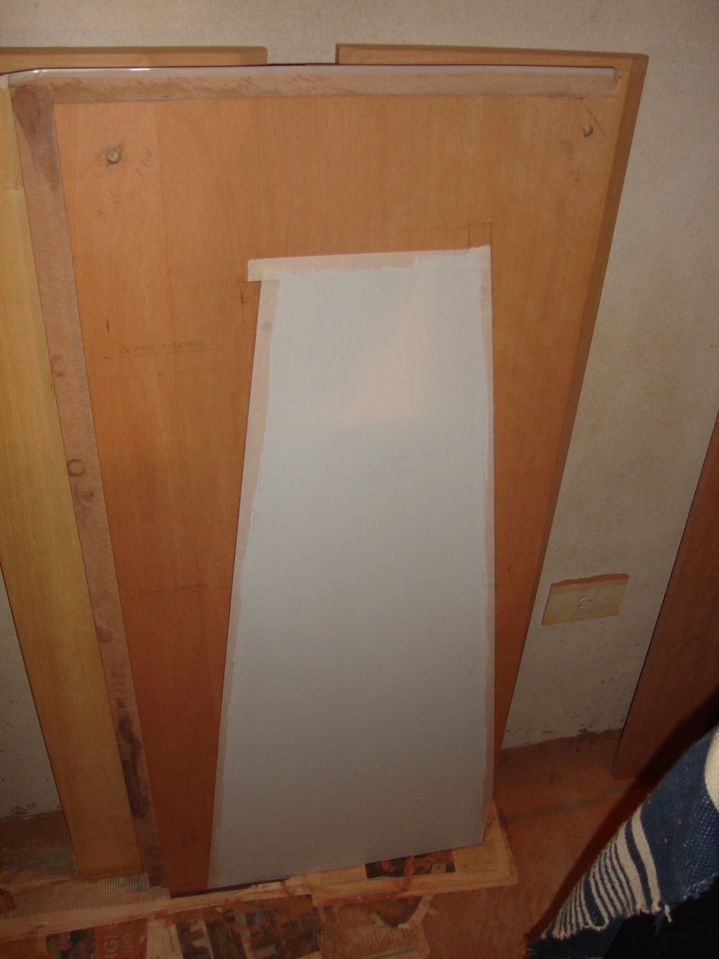

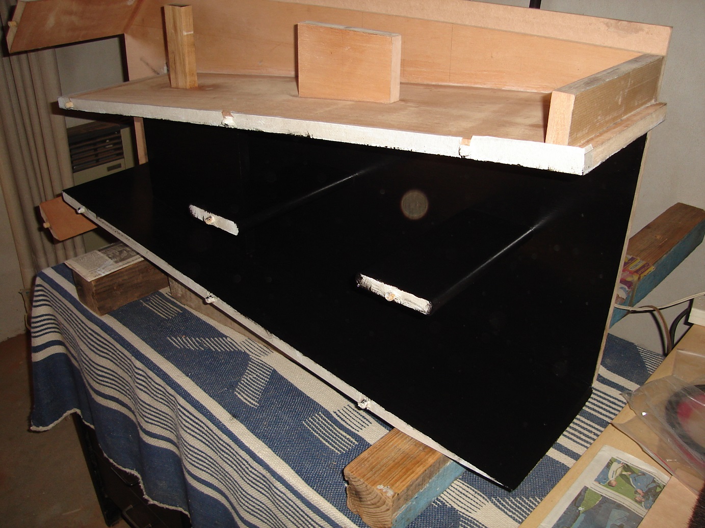

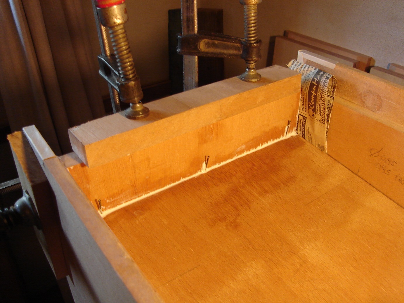

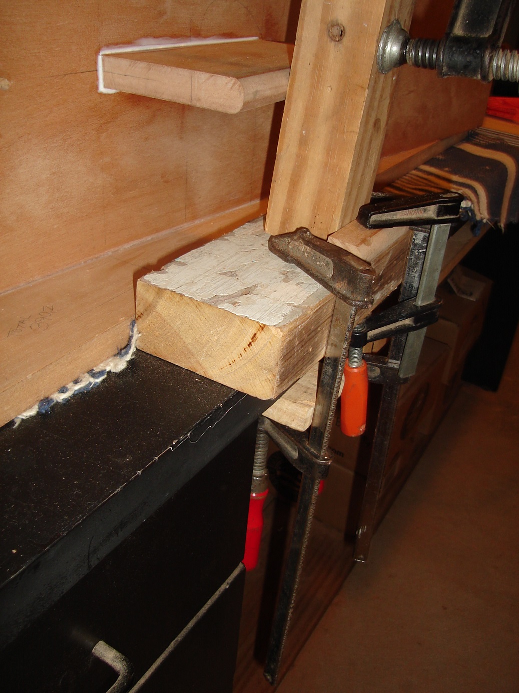

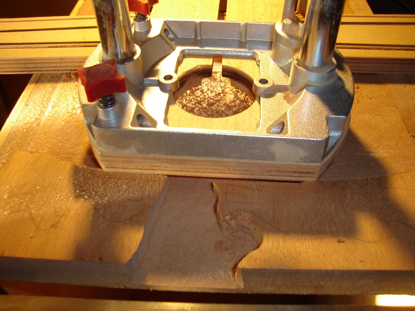

The template manufactured to use the router reduces the total vertical travel of the milling cutter ..... is not a professional tool, of 5 cm is reduced to 3 cm, so leave the method suggested by Troels, and became the old fashioned way: with hand saw, wooden brush and lots of sand. there is no major problem, just a little extra physical exercise ..😀

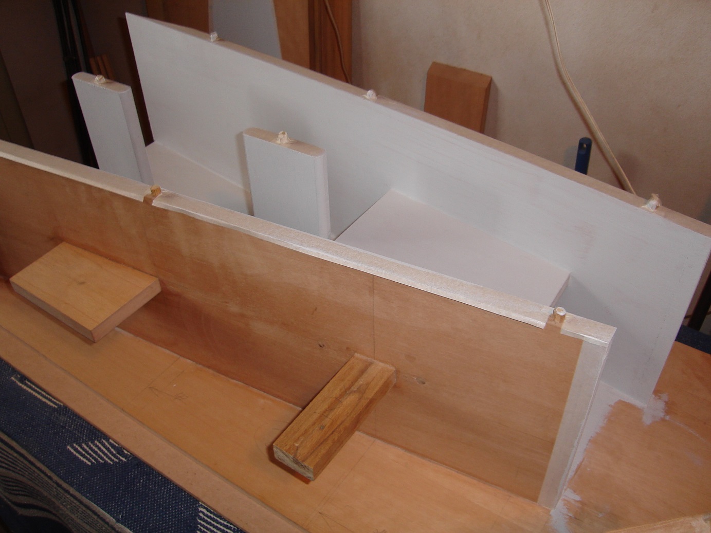

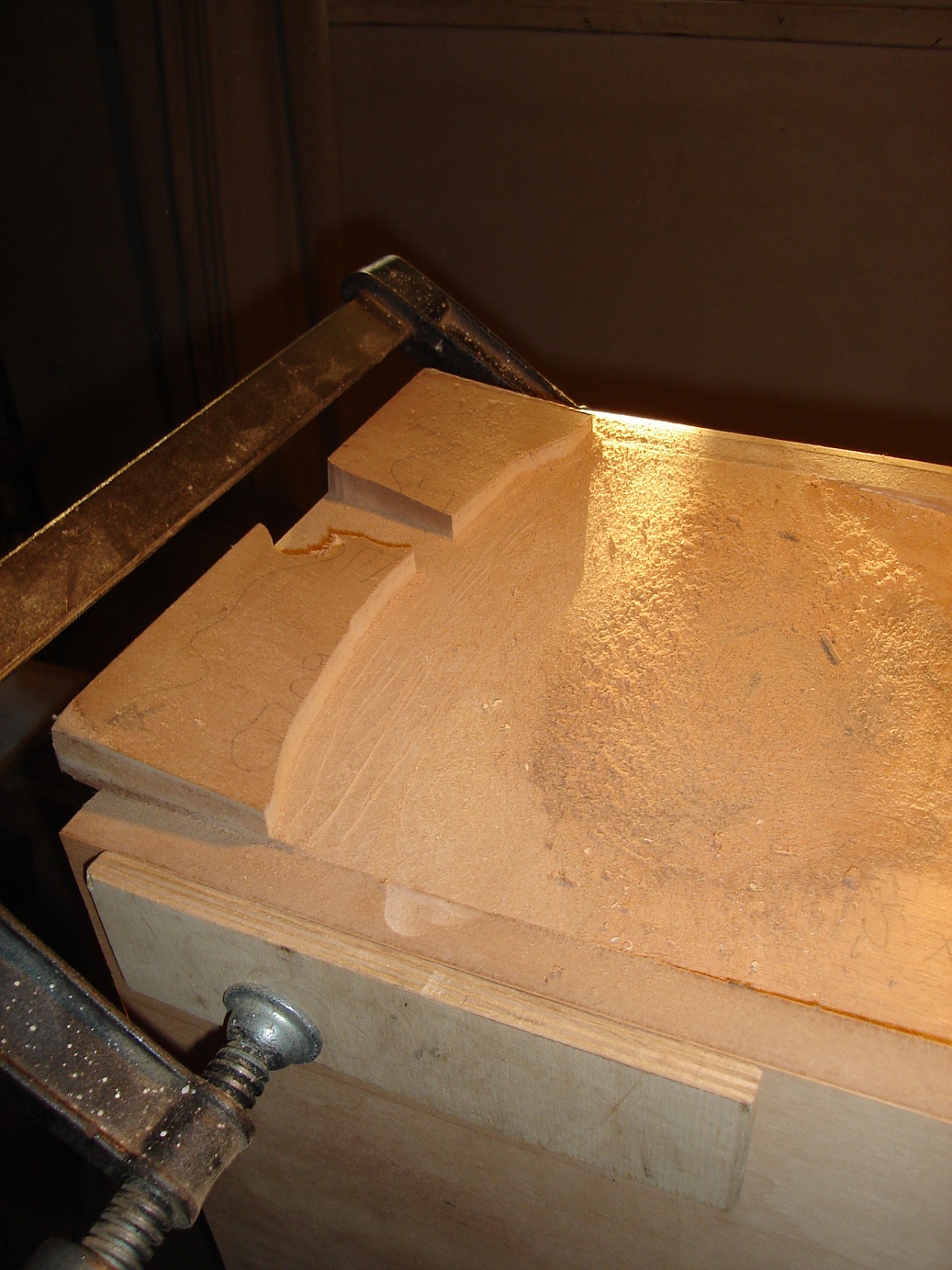

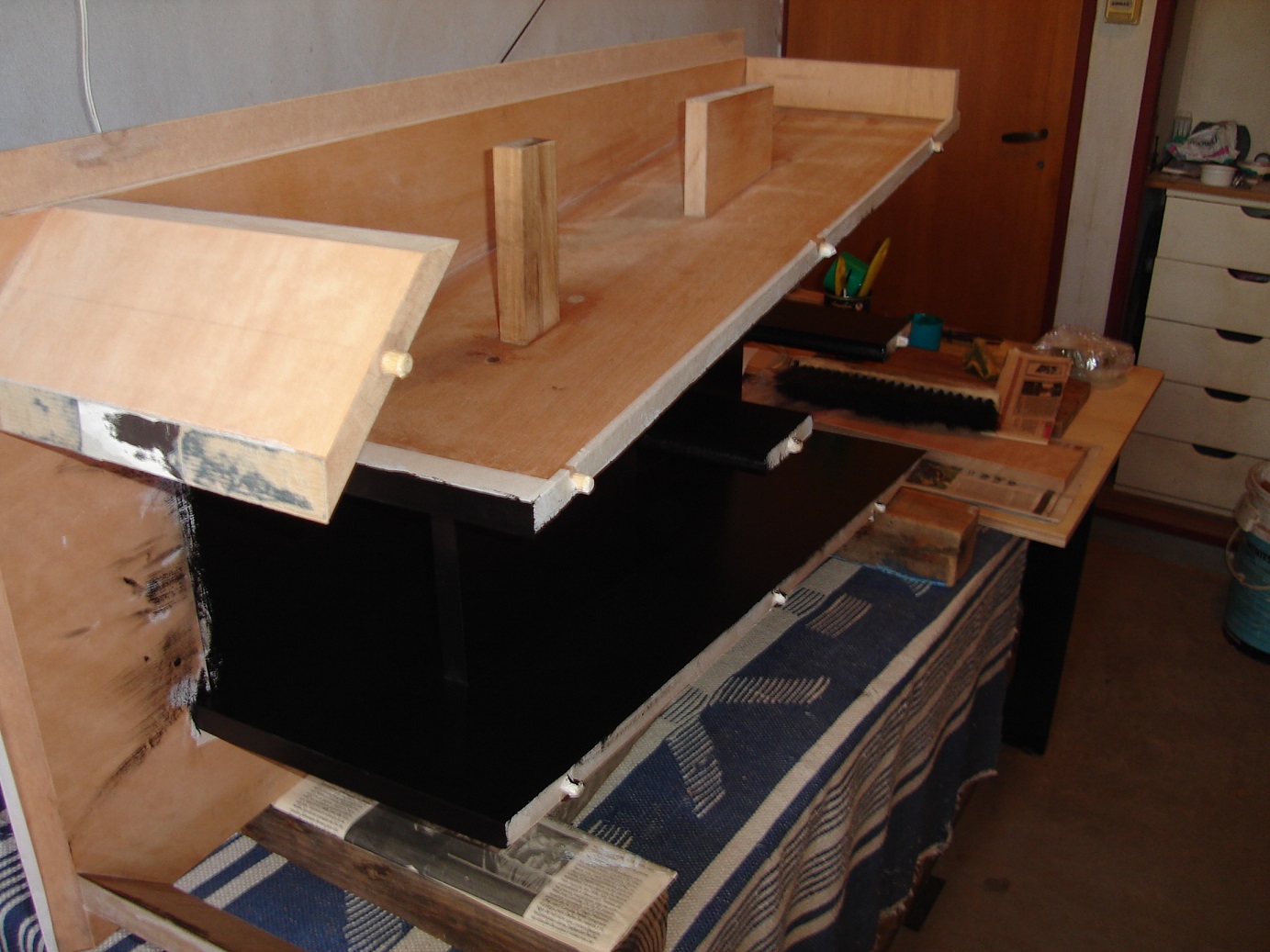

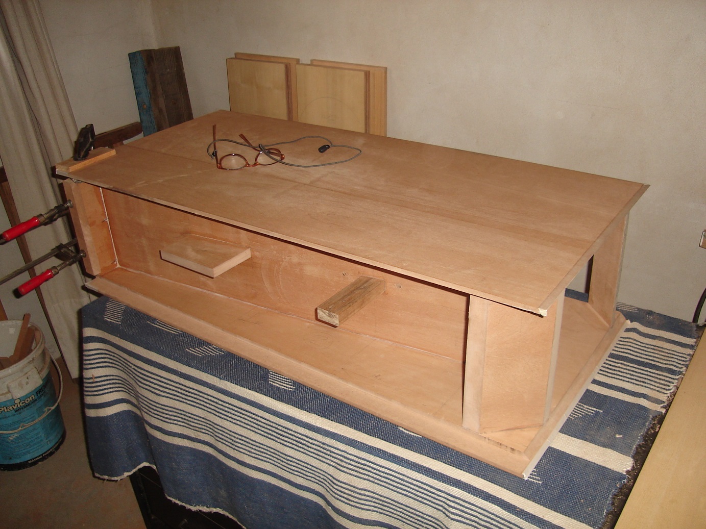

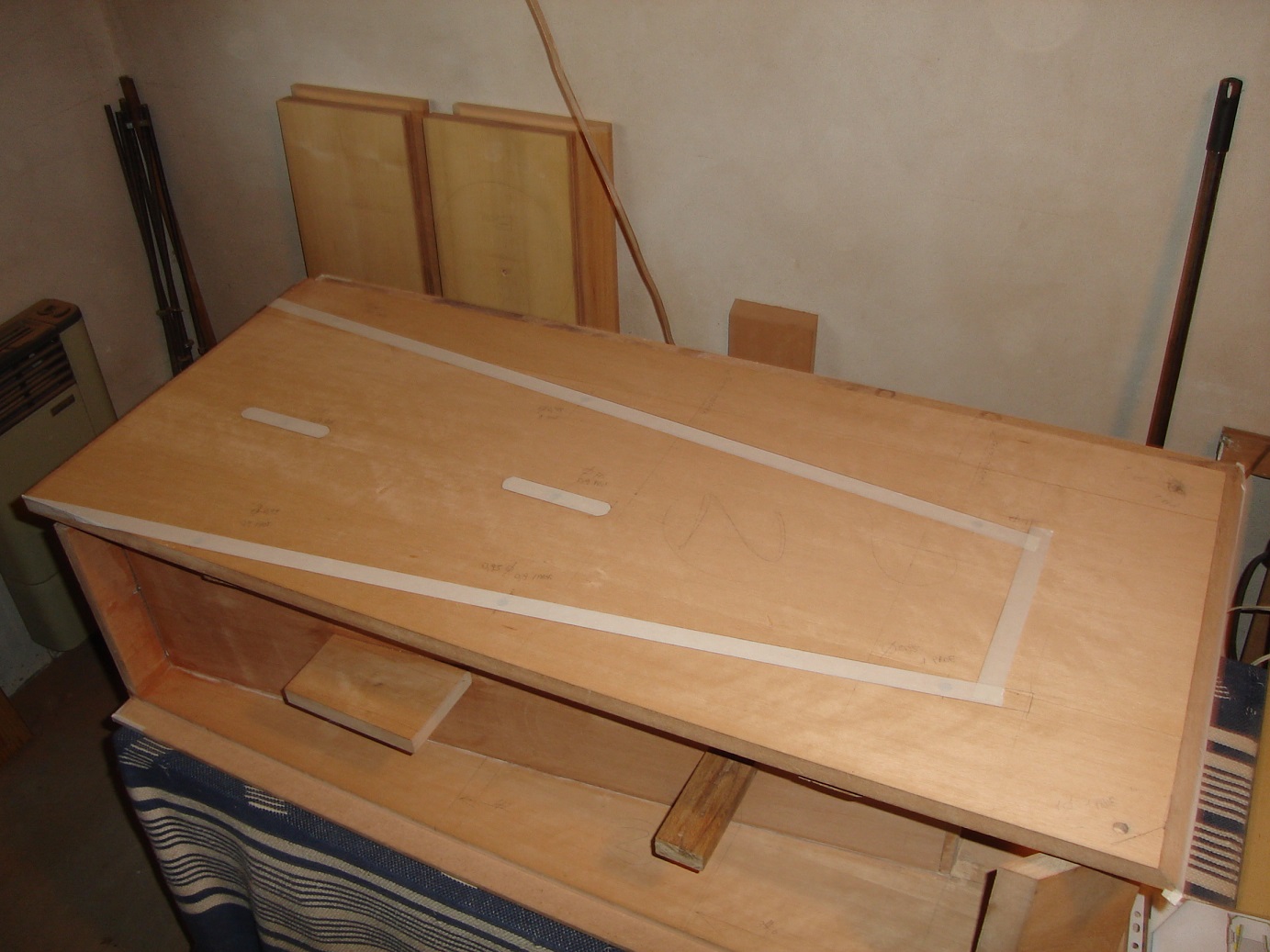

Finished cutting angled front panel ...

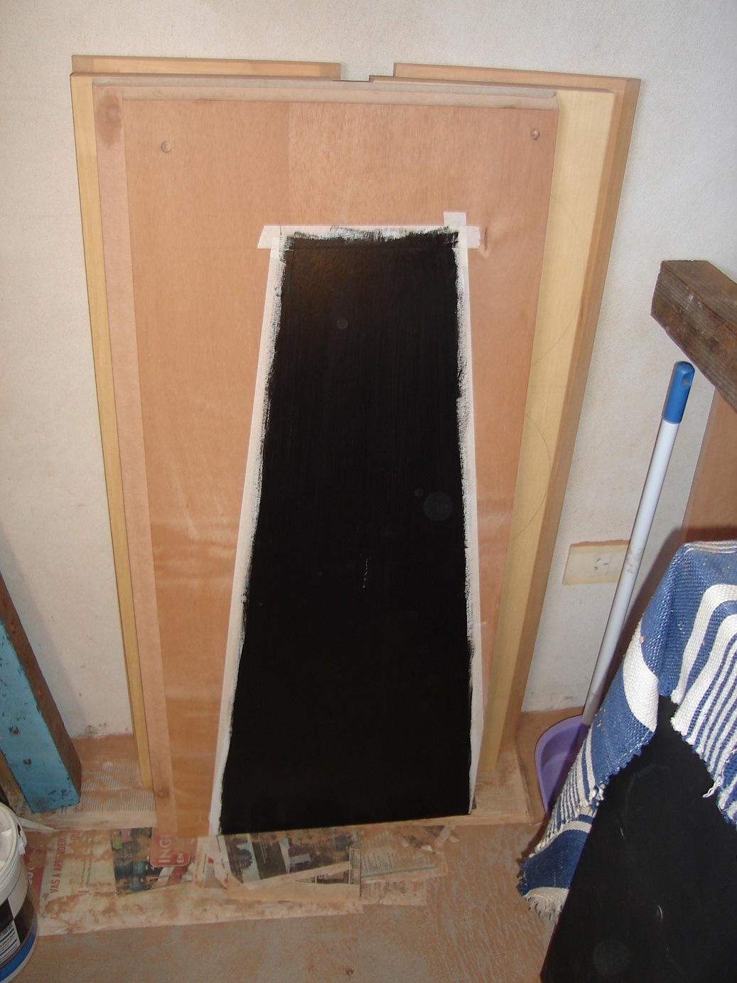

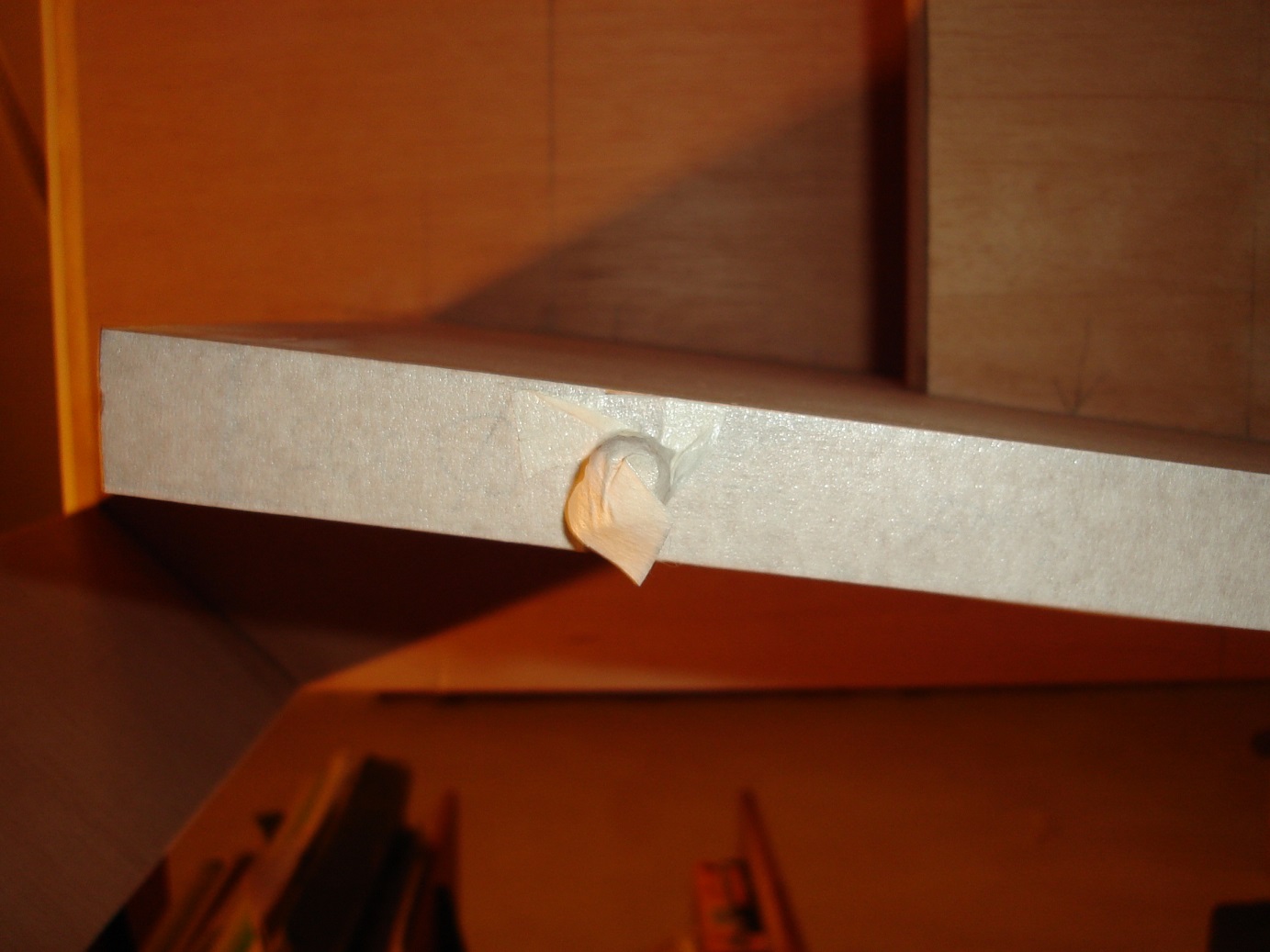

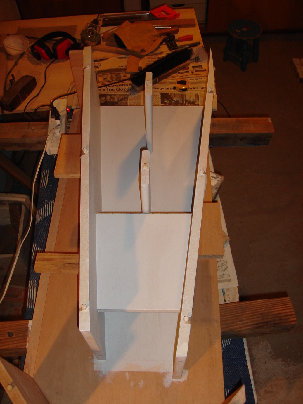

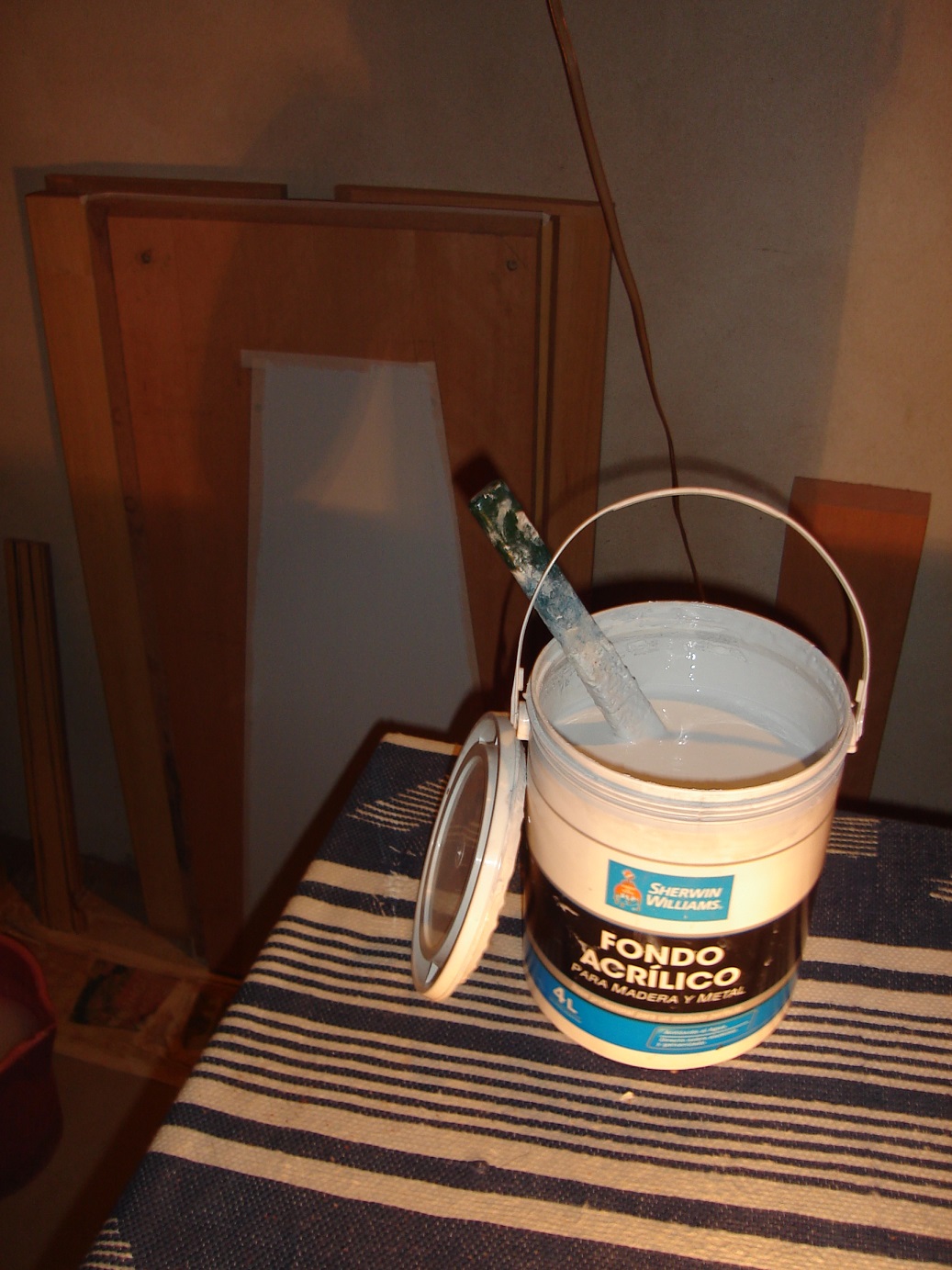

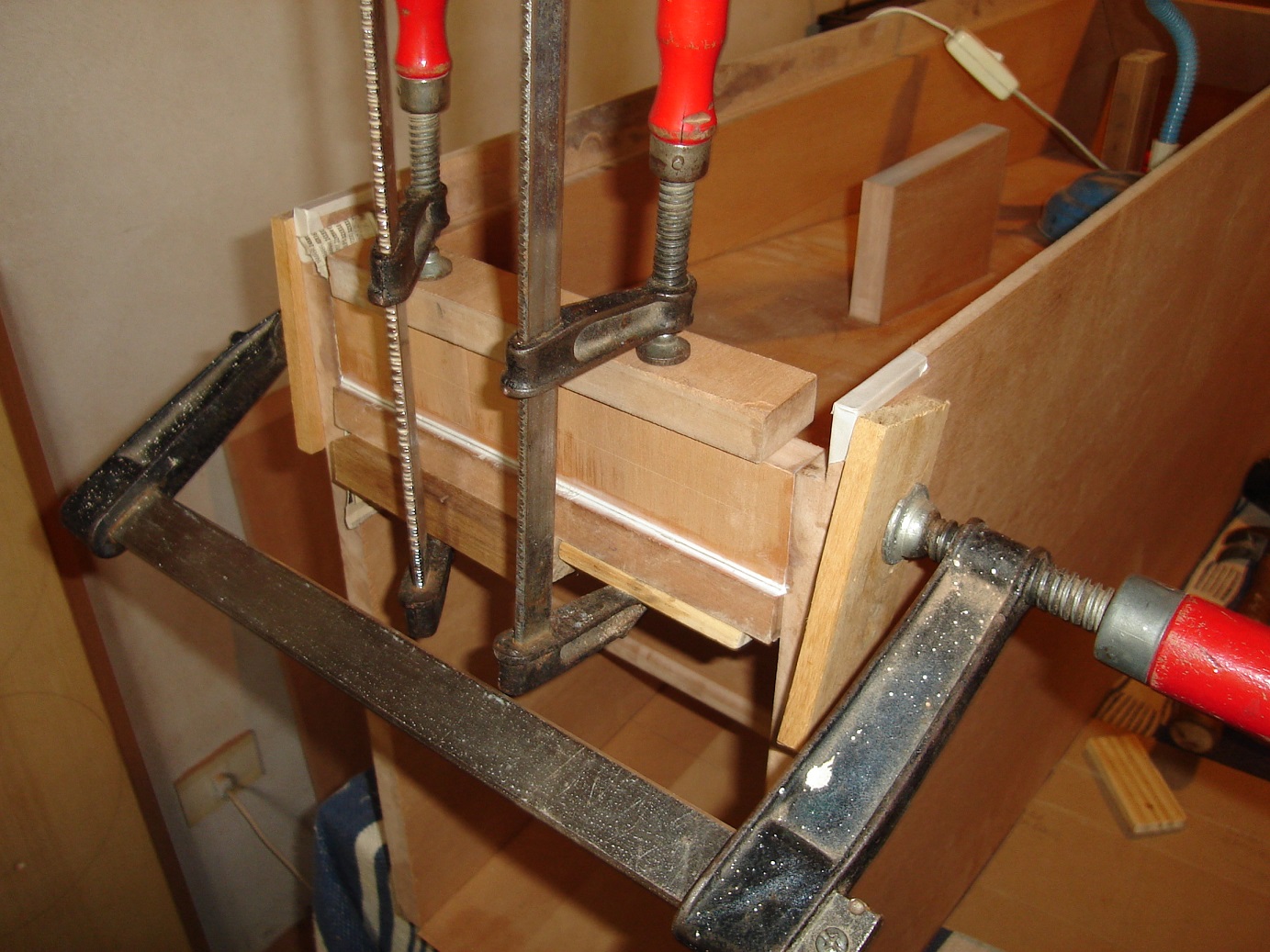

I must not forget to protect the parts to be glued with tape mask ....😉

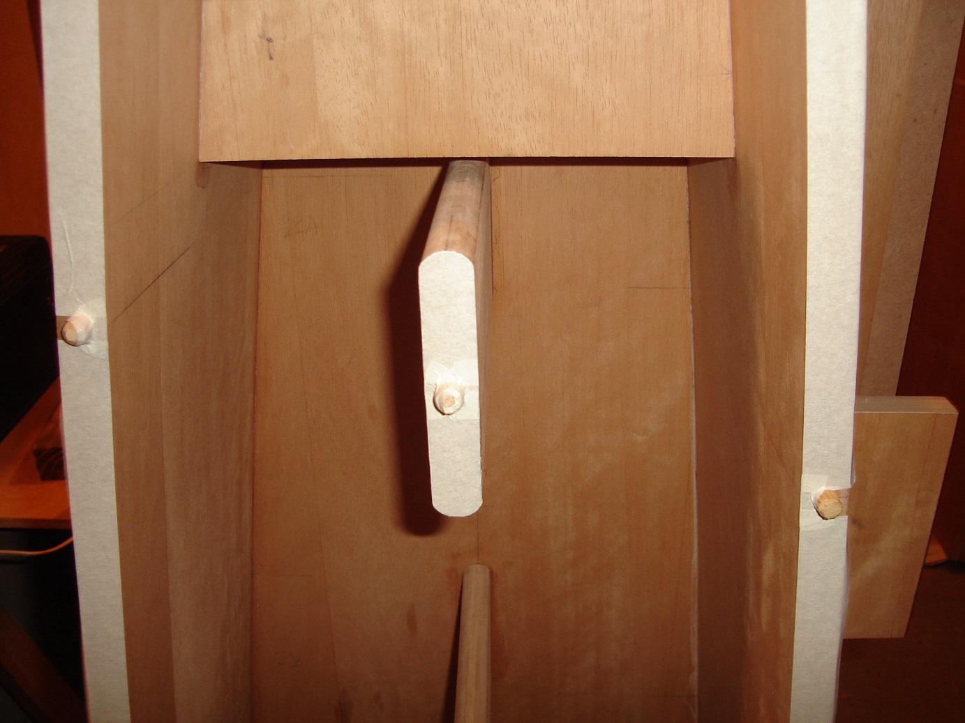

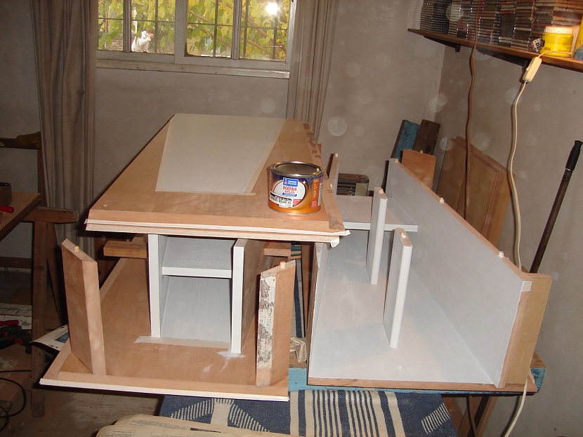

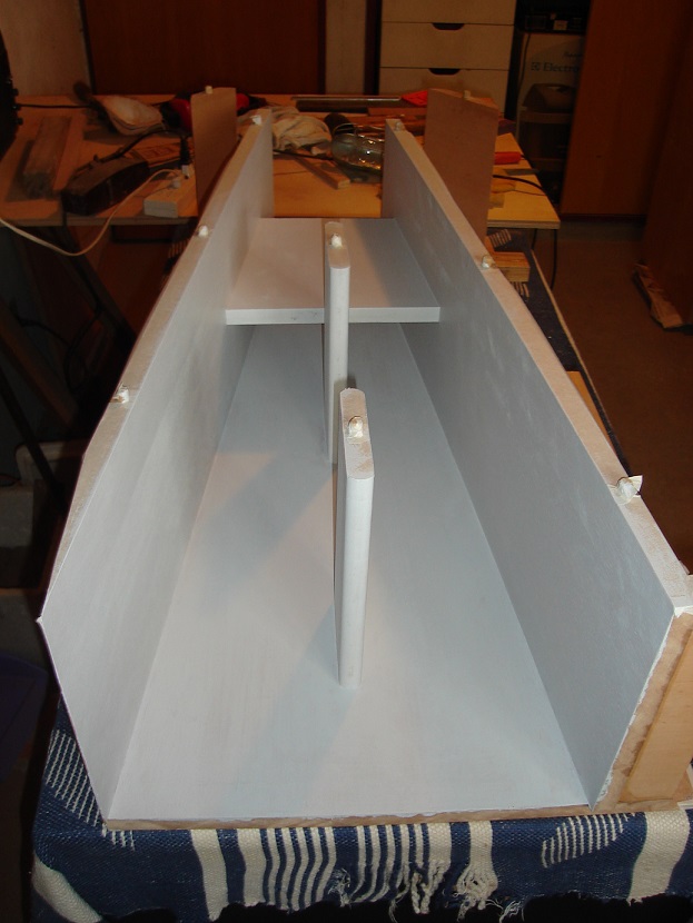

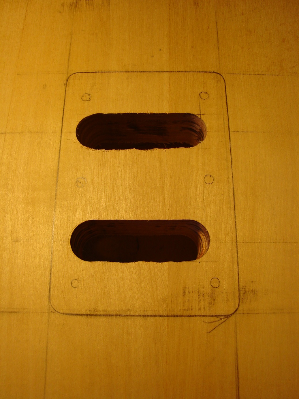

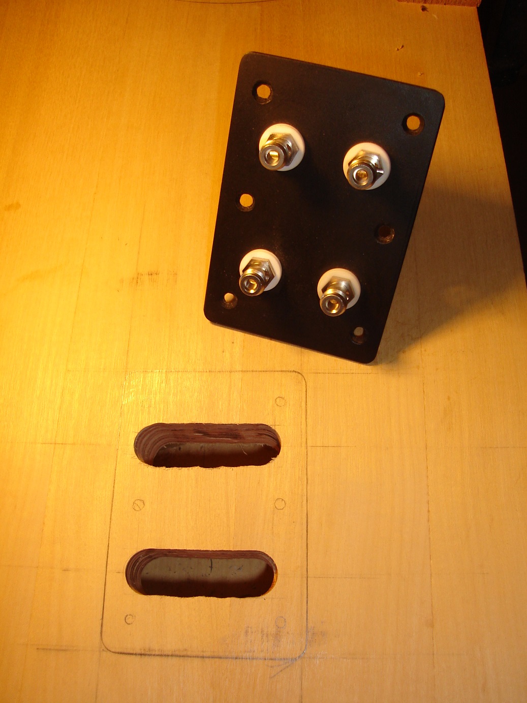

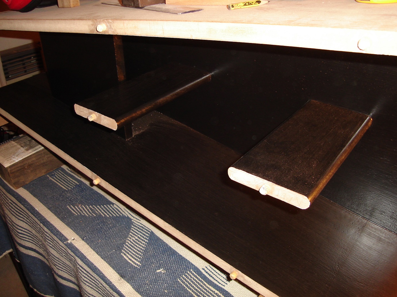

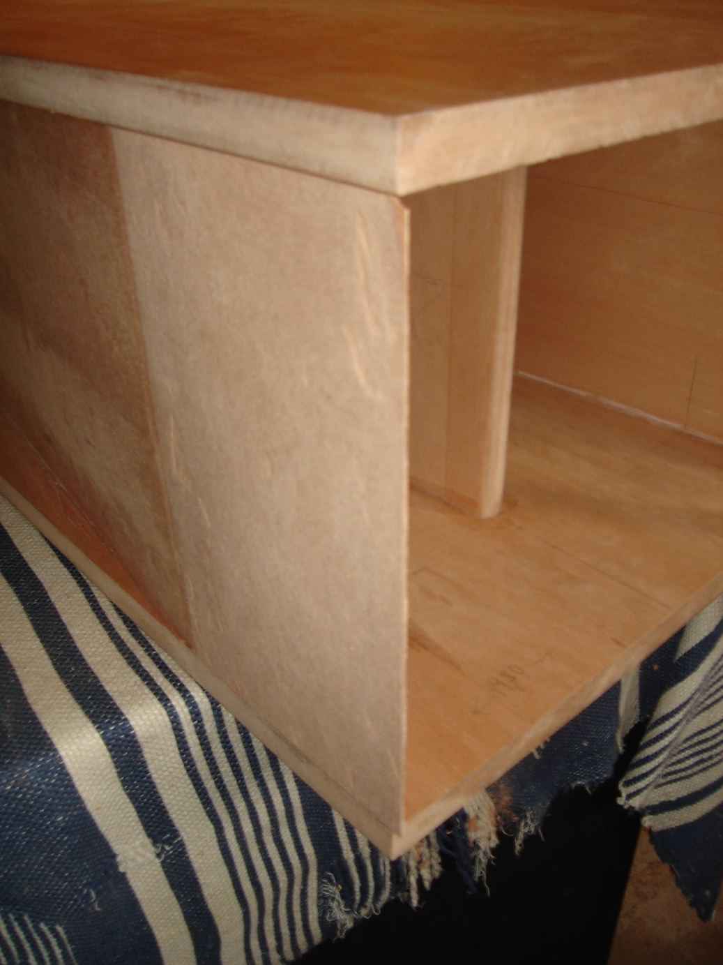

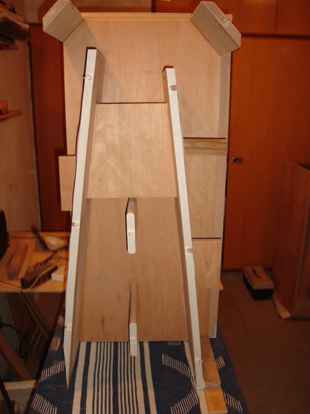

Preparation of the rear panel to screw the plate with terminal block connection. I thought a few millimeters reduce the wood to flush .... but stay well .... one less thing to do and will not change the outcome or aesthetic or sound ....🙄
Do not forget to remove the masking tape ....😀

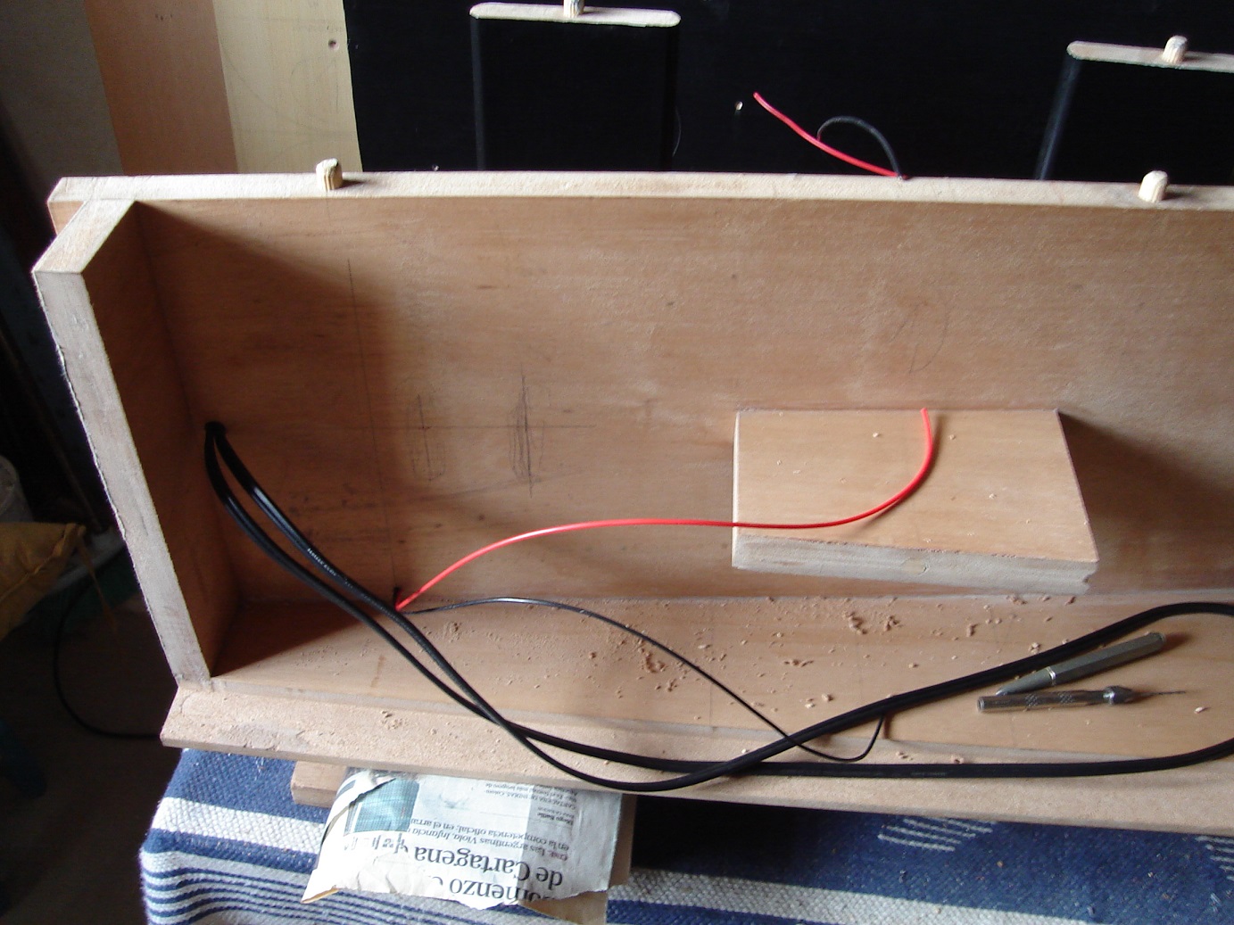

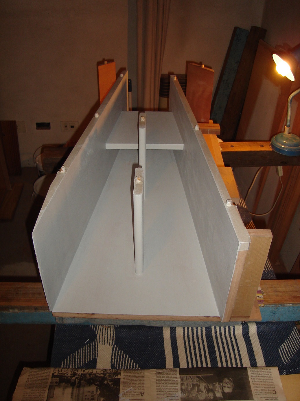

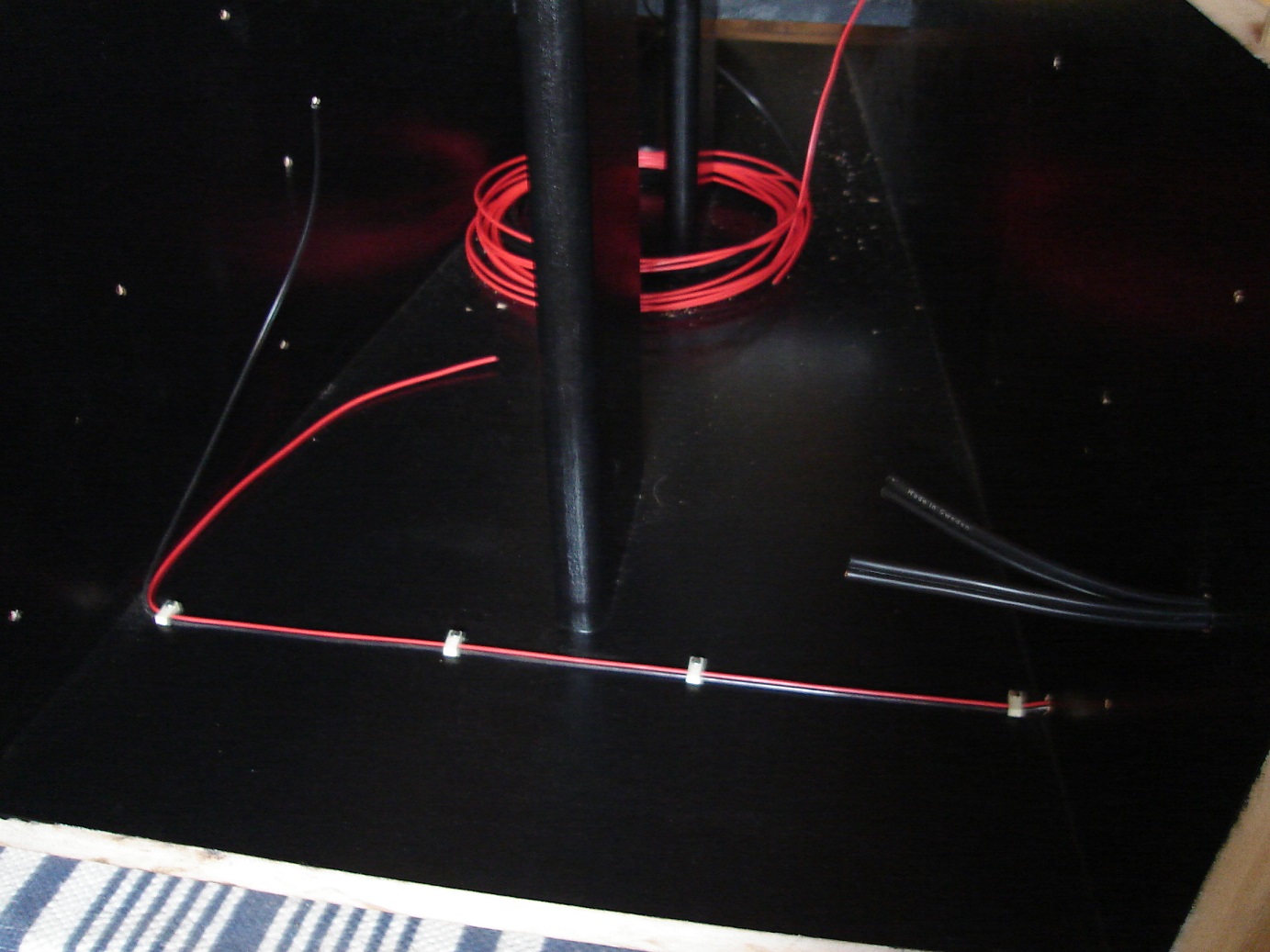

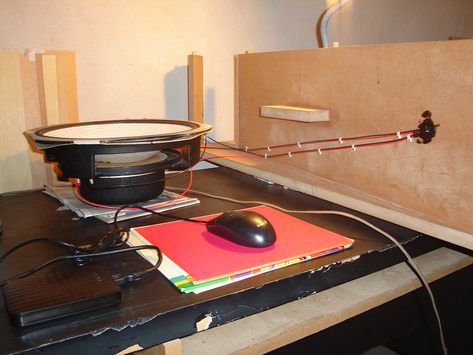

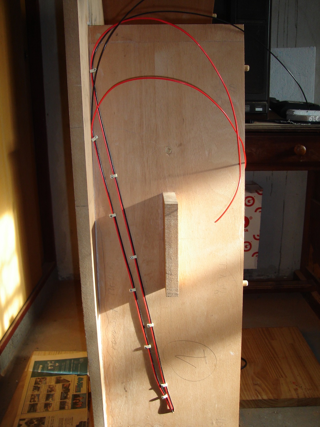

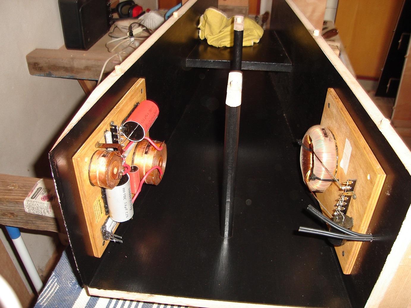

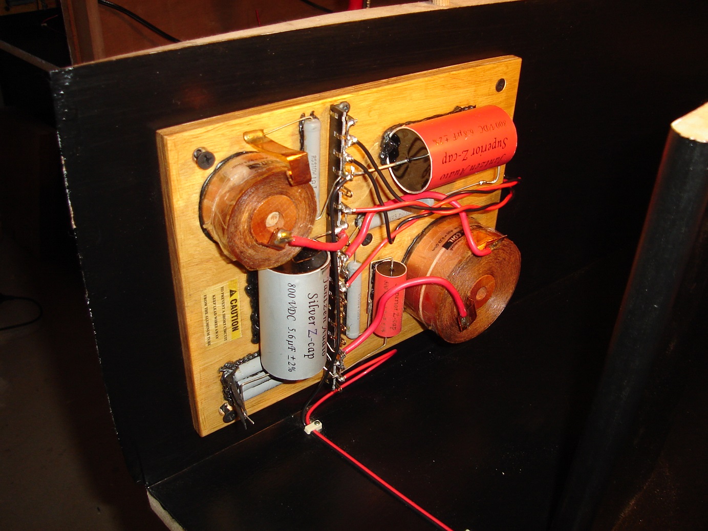

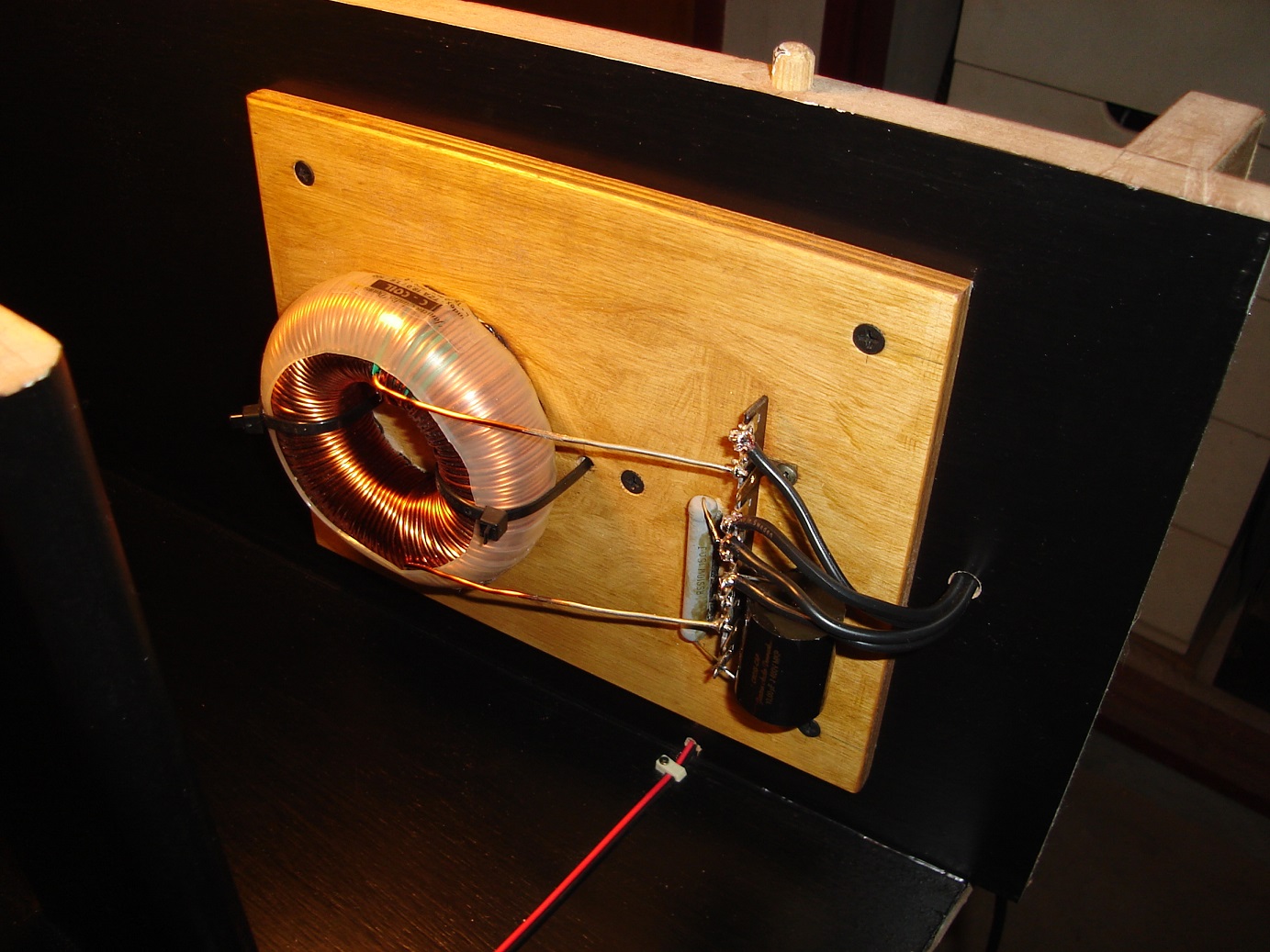

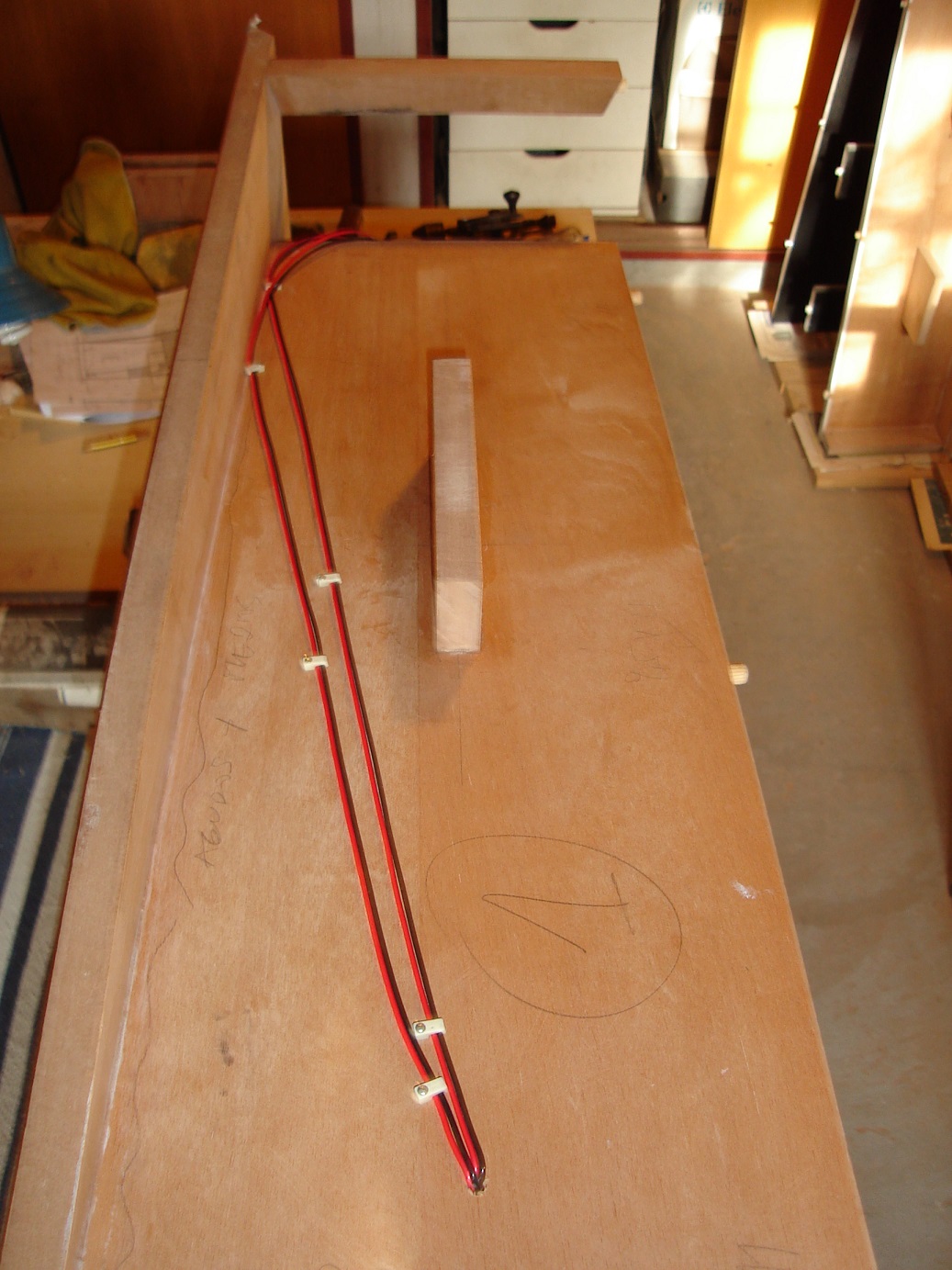

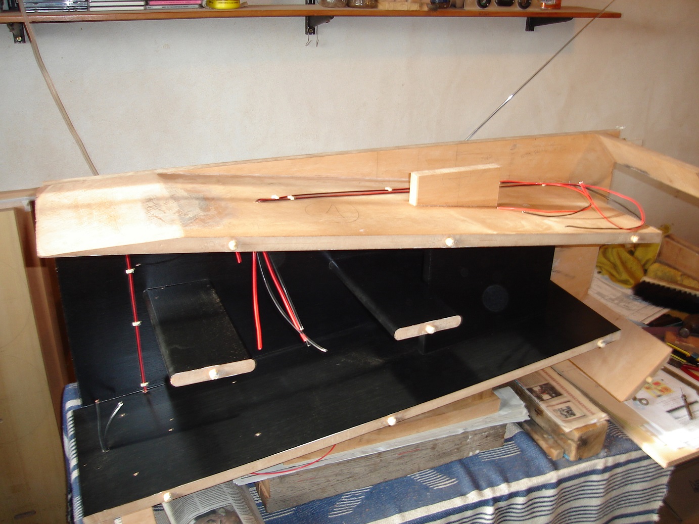

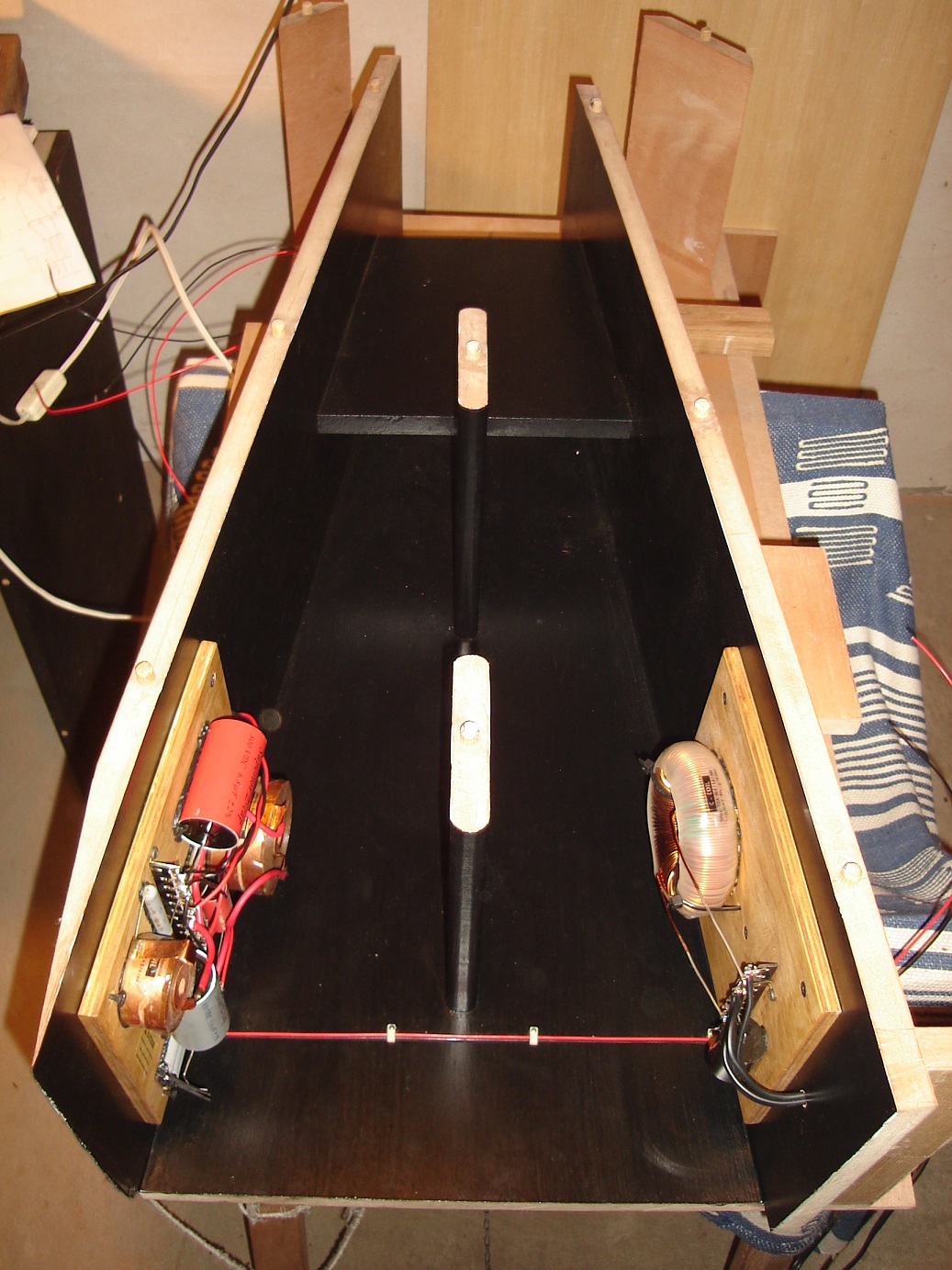

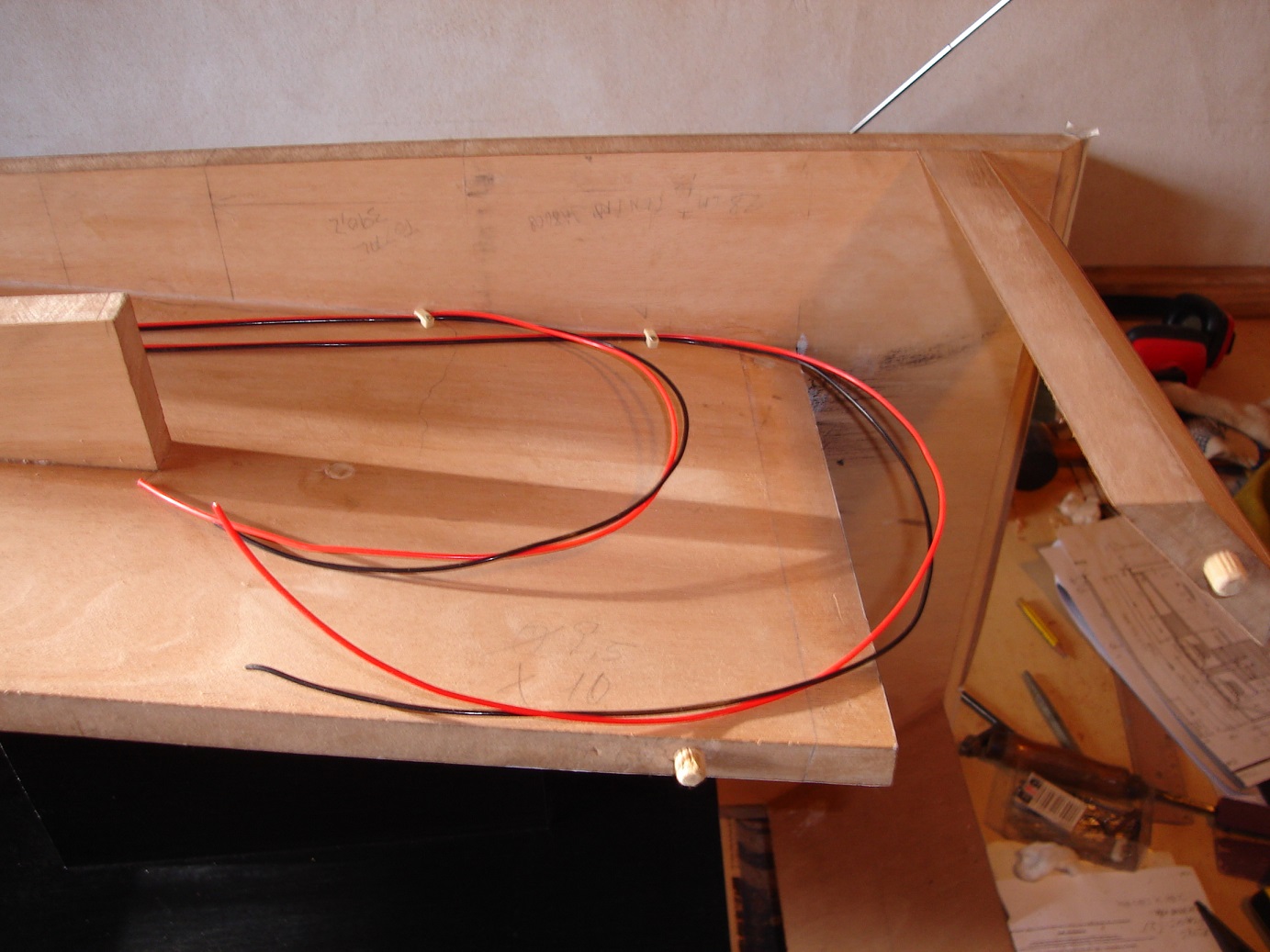

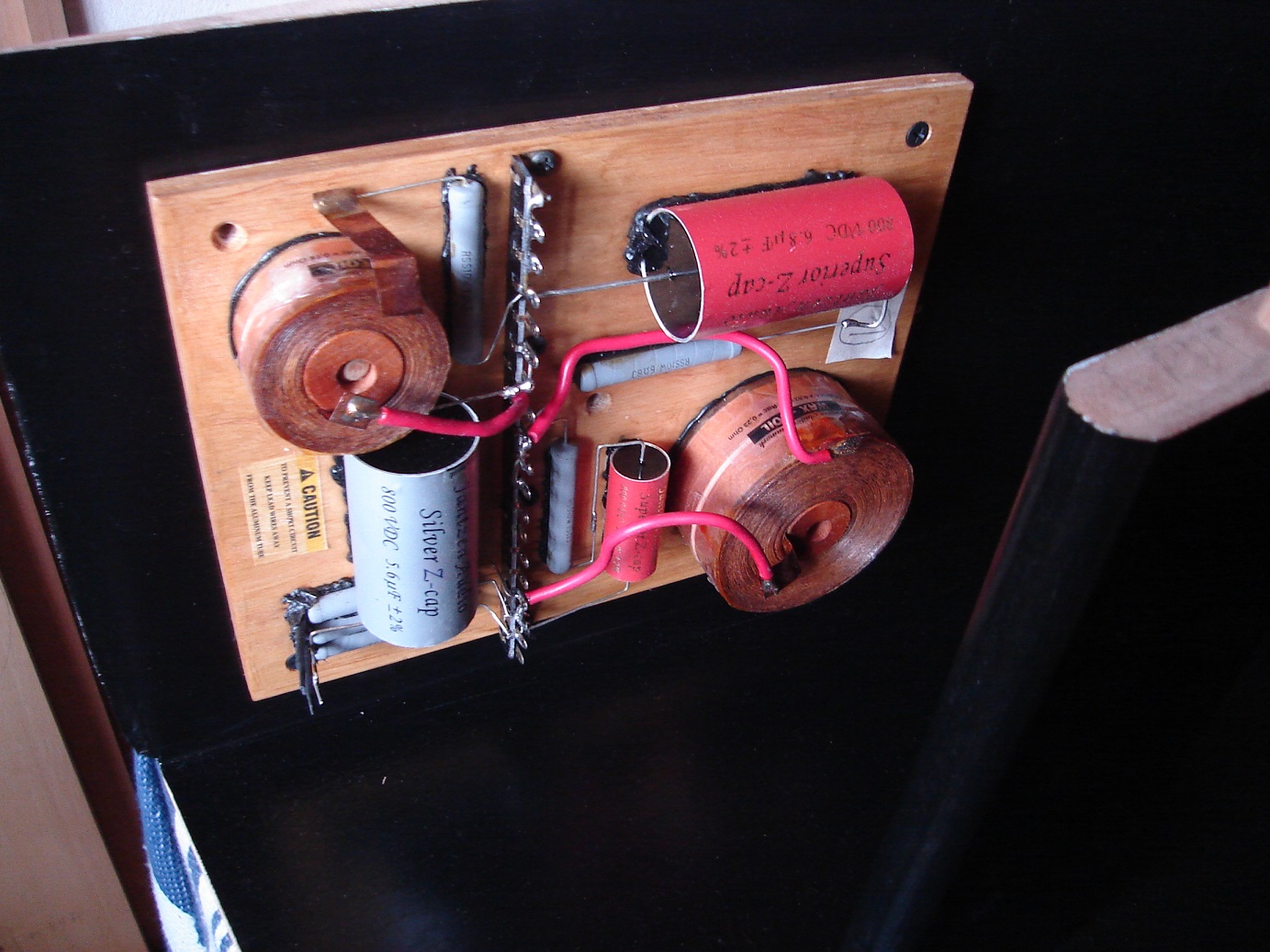

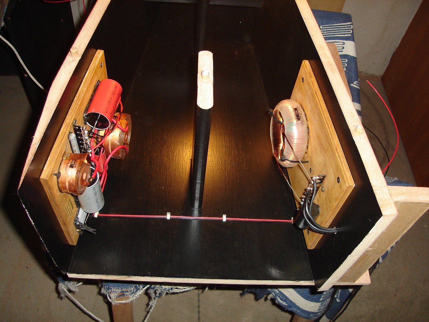

We begin with the installation of the crossovers and the connection .....🙂
The box will close at the end, this will allow us to work comfortably and correct if it were to encounter problems.
Follows .....😀

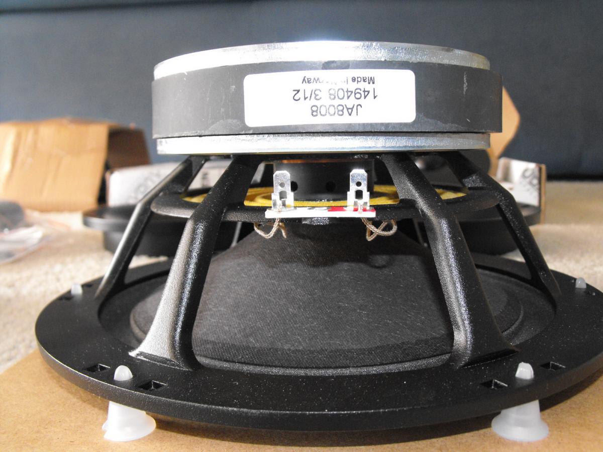

You think it's better to solder crimp? I ask because if a big brand like Sonus Faber uses these simple connectors, metal against metal under pressure .....
I work in the racing and auto industry, the standard there is crimp connections with spring contact and that is a substantially harsher and more vibration affected environment than audio.
I use crimp connections and spring spade terminals for all my speaker connections, if done properly as reliable as soldering.
Also virtually all drivers are designed for this type of standard spade connection, as some see even soldering to terminals often melts the connection to the voice coil leads and damages the driver terminals.
Javad
Javad
Thanks for the feedback.
I would like to just say that one of the main reasons for the use of connectors is that it allows mounting and dismounting plates and other components comfortably and quickly.
Not imagine a line of automotive assembly workers welding cables...😉
In the case of the speakers, it is true that much has extended its use, but also bring the housing bore welding wire. There are two possibilities, I choose welding, assembly will elect a line pressure connectors.

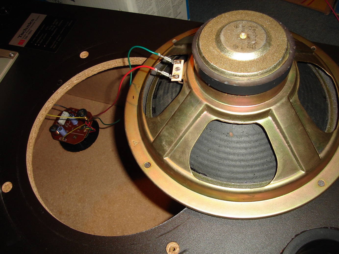

*A few months ago some cabinets Technics repair ancient the 70s, the drivers were disconnected, repaired and reassembled with the original pressure connectors and there were no problems...
There is much voodo in audio connectors are currently promoted with gold film .... because it sells more! They look good ! But gold is worse conductor of electricity than silver! Why fans demand hi end welds with silver alloys ...!

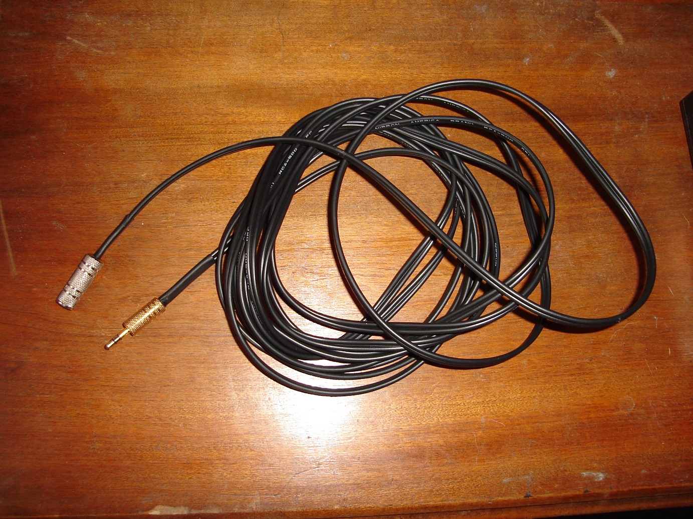

I'm using conventional welding 60/40, my budget does not allow me that luxury ....😀
I share your opinion the risk of overheating when welding in all cases, it becomes critical because costs are reduced using materials highly susceptible to heat.
Welding a simple miniplug connector to make an extension of headphones, for example, it can be a very difficult task and craft.

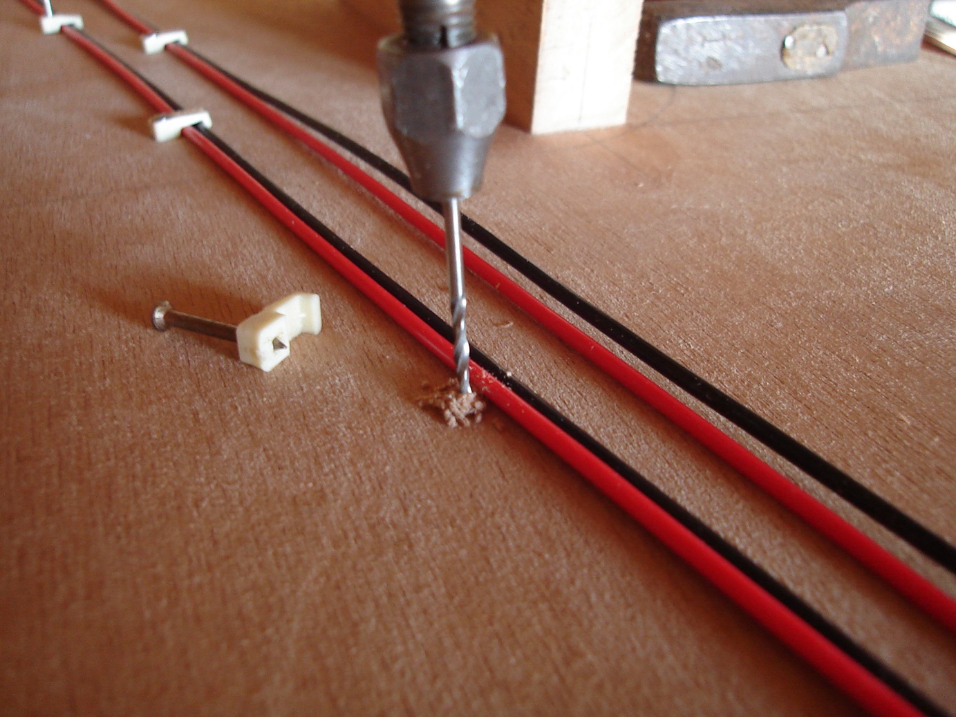

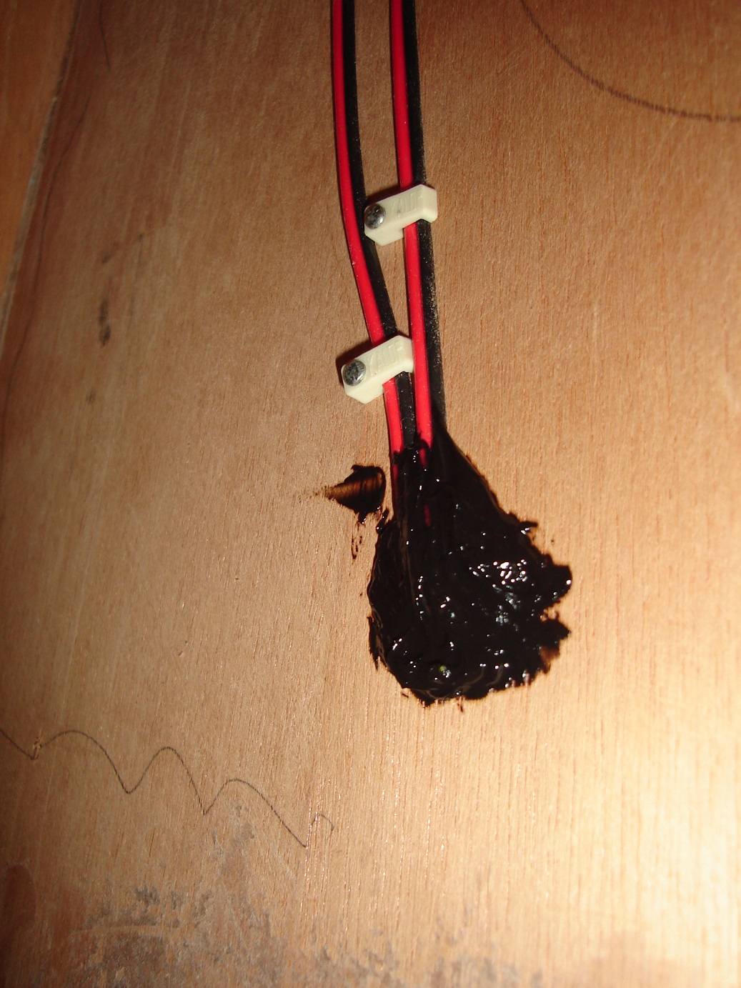

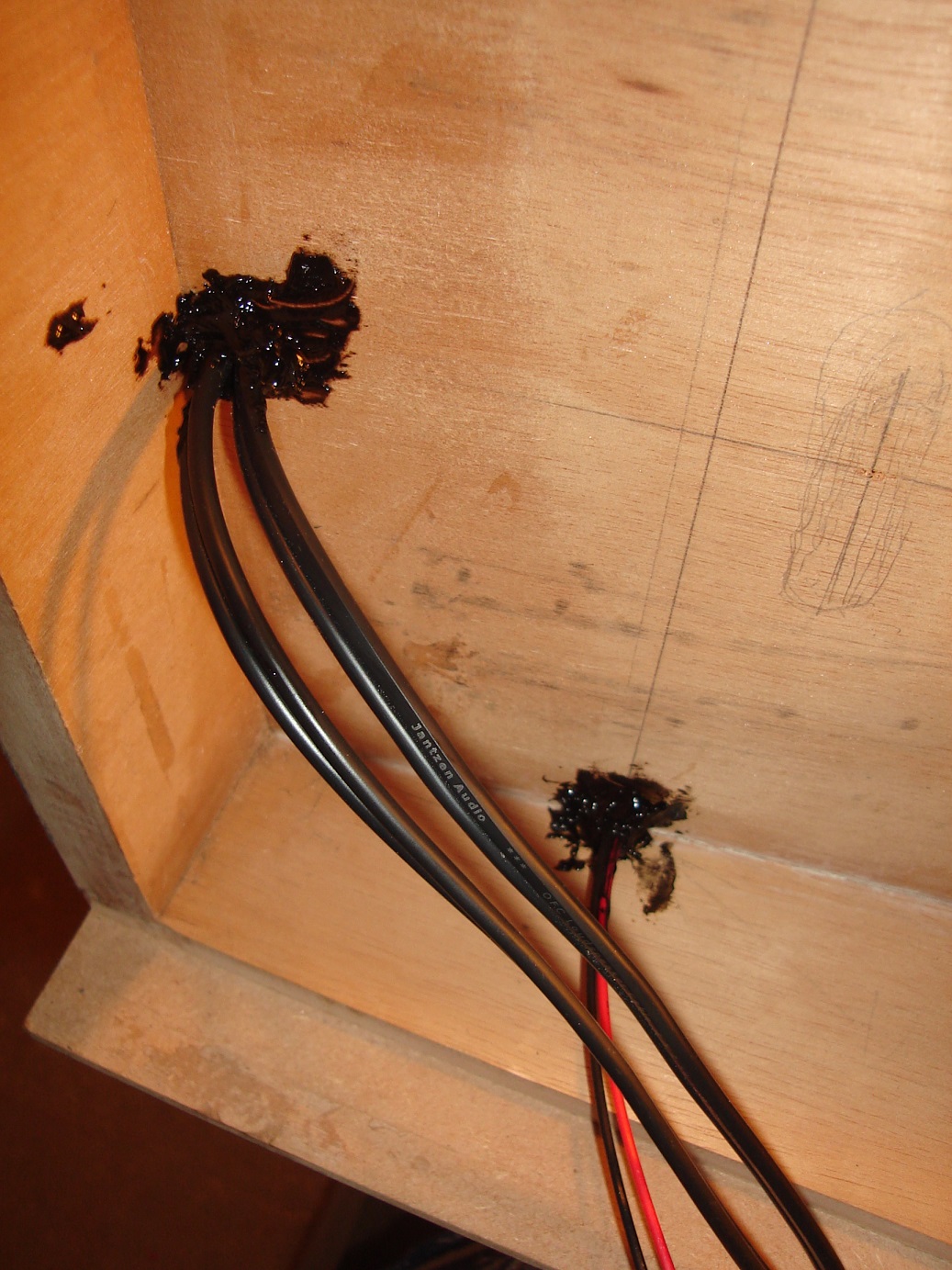

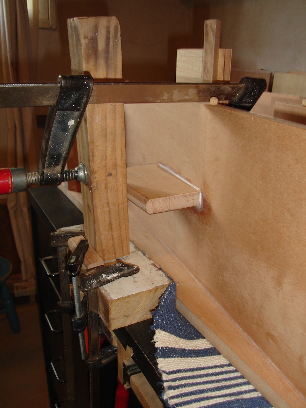

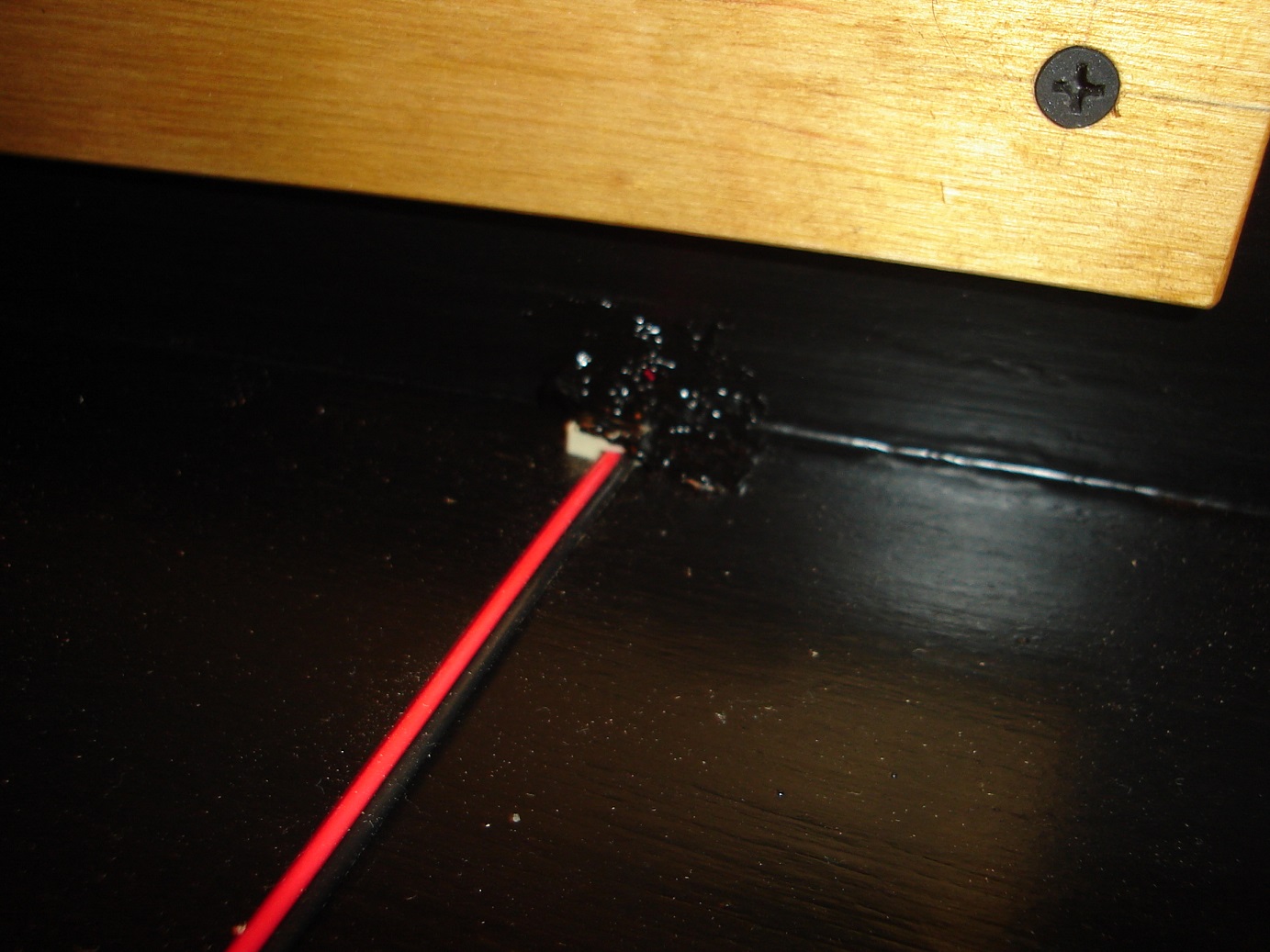

You are doing a very nice job. May I suggest running a bead of glue or silicon sealant along those cables you have clipped neatly to the wood. It would prevent any possibility of them vibrating against each other.
Thanks friend for your comments ! 🙂
The idea is good, on these wires stuck anger absorbent material, " kill two birds with one stone ". 😉
Regards !

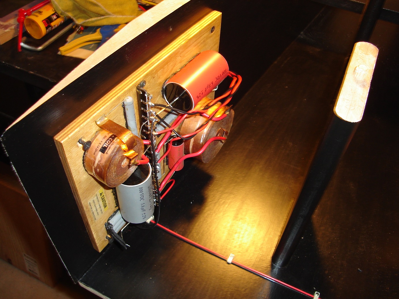

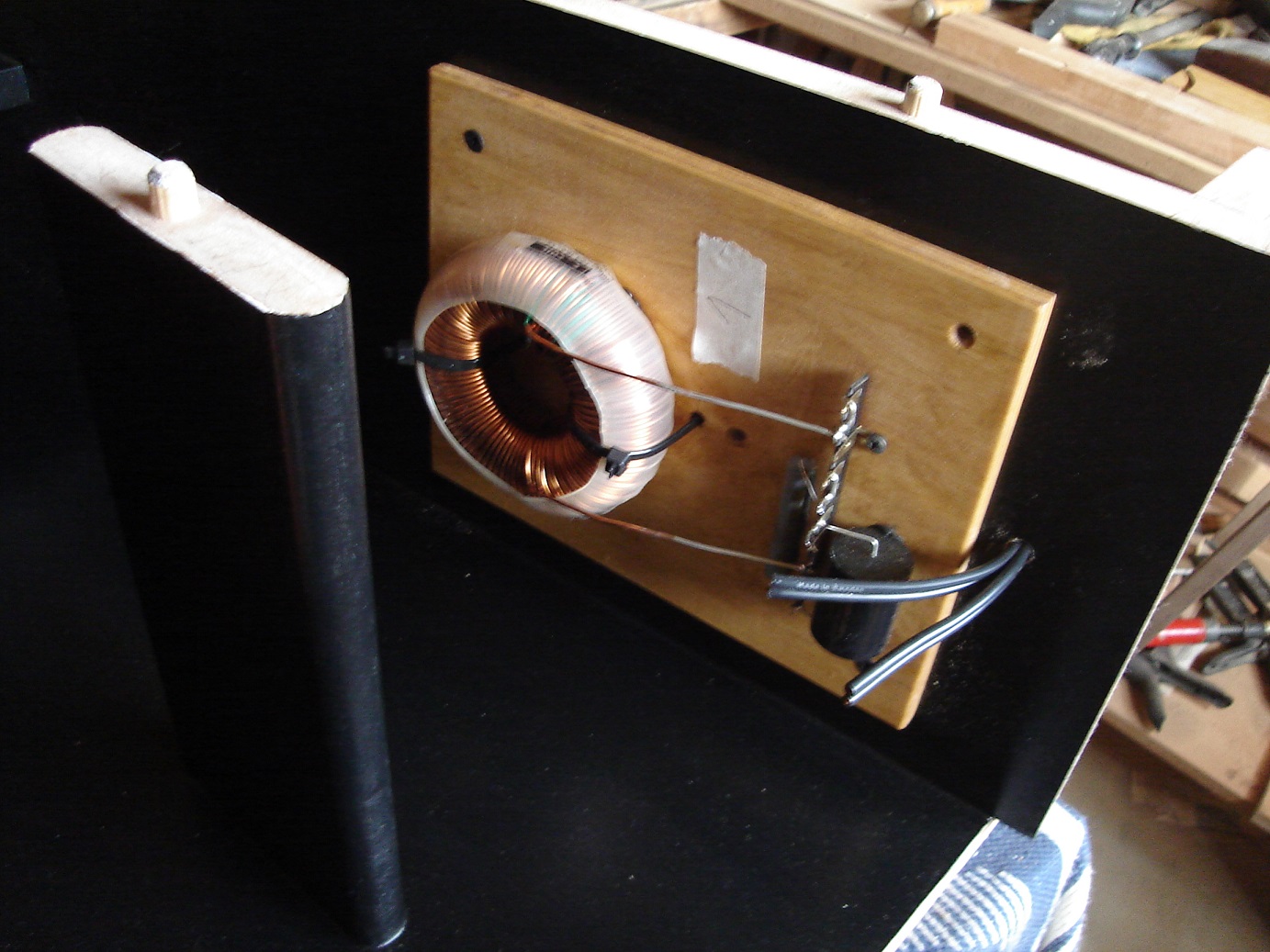

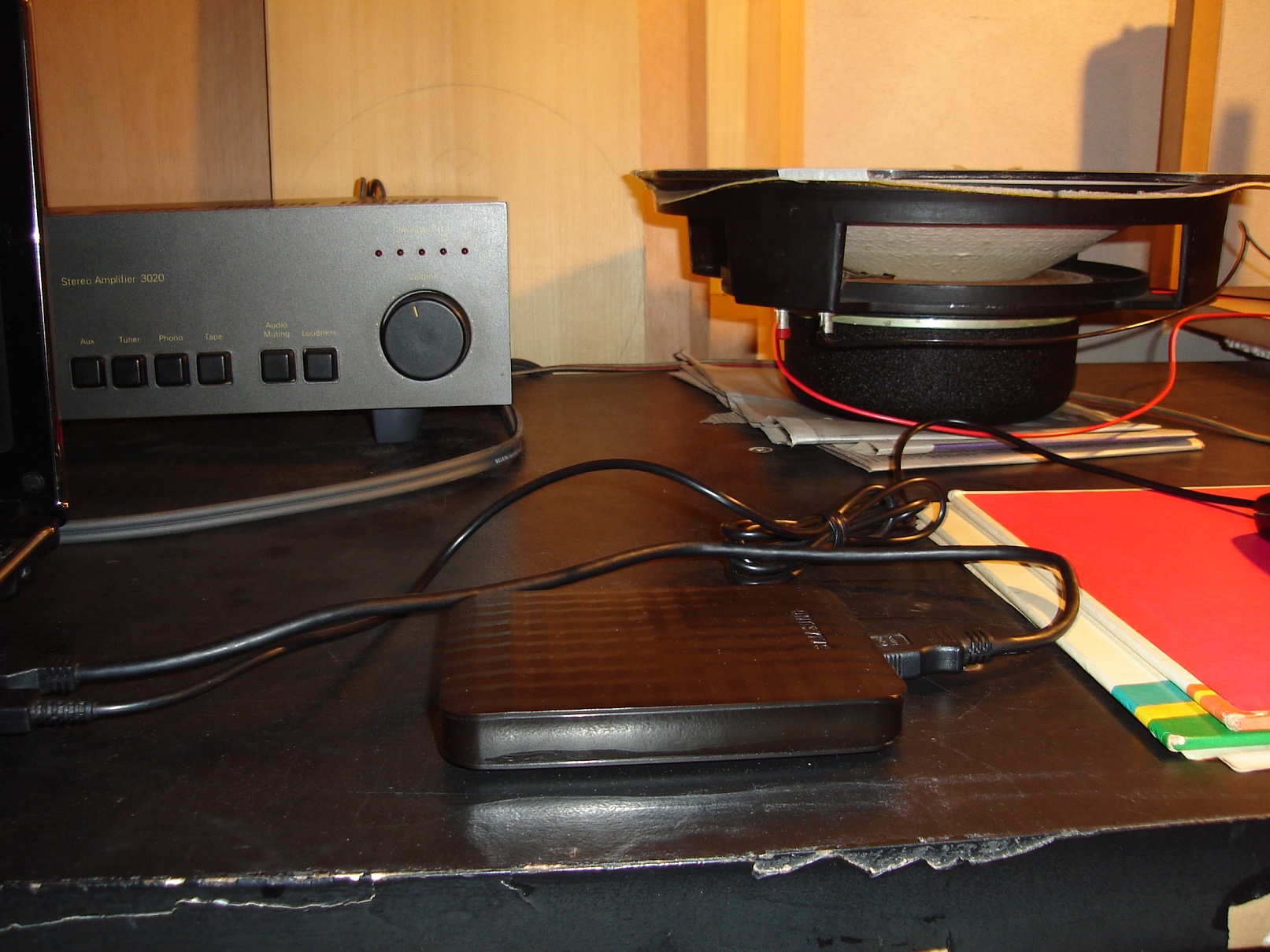

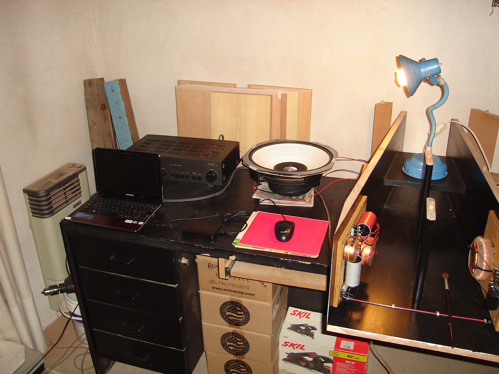

Before closing the cabinet I wanted to check the operation of the crossovers. So I dismounted from his box LE14C JBL coaxial driver and everything works perfectly.
The mids and highs are well integrated because the crossing is similar, 2000 hz. and coaxial speaker has for its constructive features very good integration (all frequencies emanate from the same axis) Of course the development of Troels also provides impedance matching topologies and specific crossing for drives and load Horn DTQWT (if read this sure think I'm a heretic by doing this) but this is only a test, but very funny. I explore many works of music well known to me and .... wow ..... voices are very clean, clear, and there is much details!
And despite the short acoustic bass very clean too ...!
I think I have some suggestion, or should I stop drinking ....🙄
These connectors JBL speakers if they were good,
(JShadzi the would approve surely 😉) drivers have been disassembled and assembled many times, in so many years of use have two refoam, plus several experiments damping boxes and tests with long pipe tuned and continue tightening the cable efficiently.
