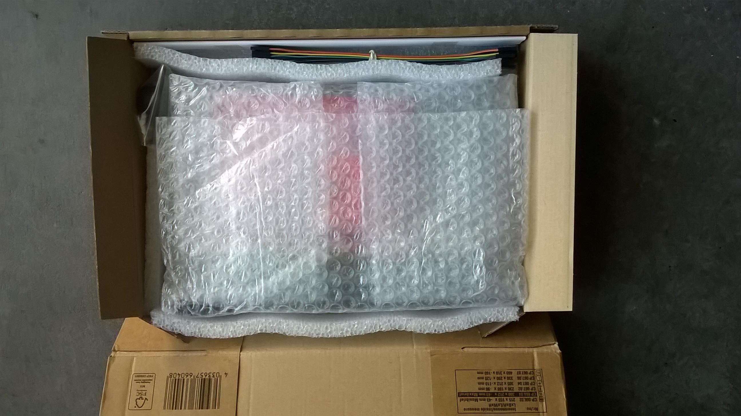

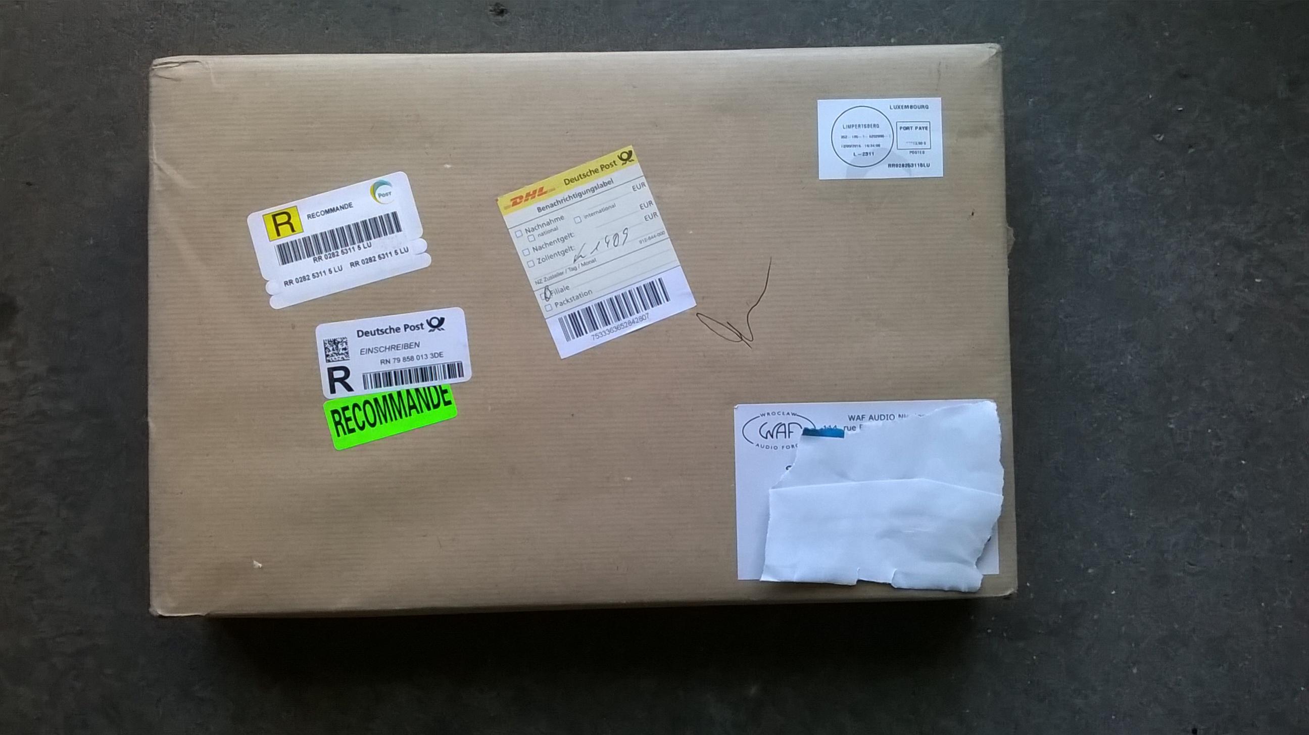

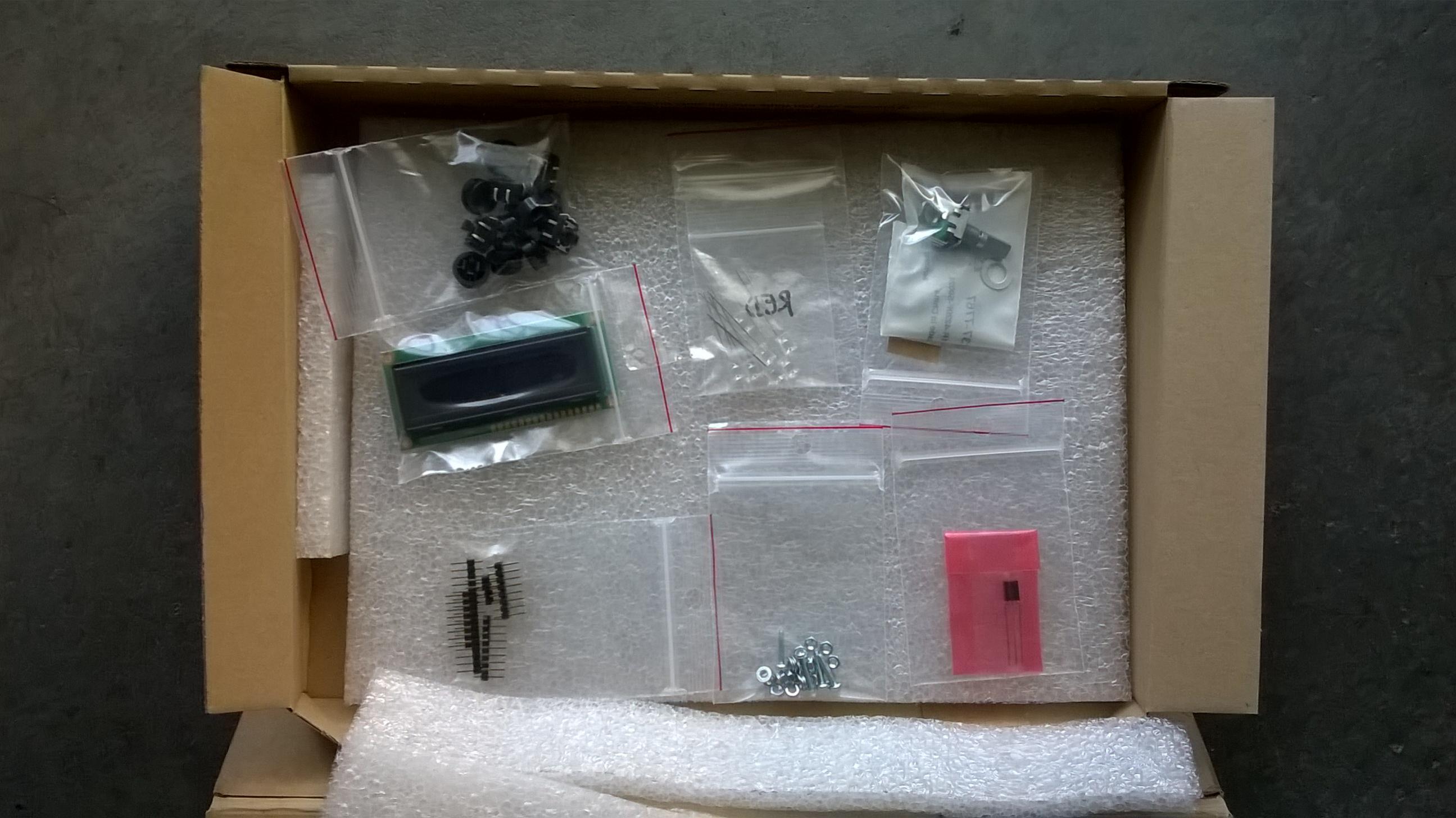

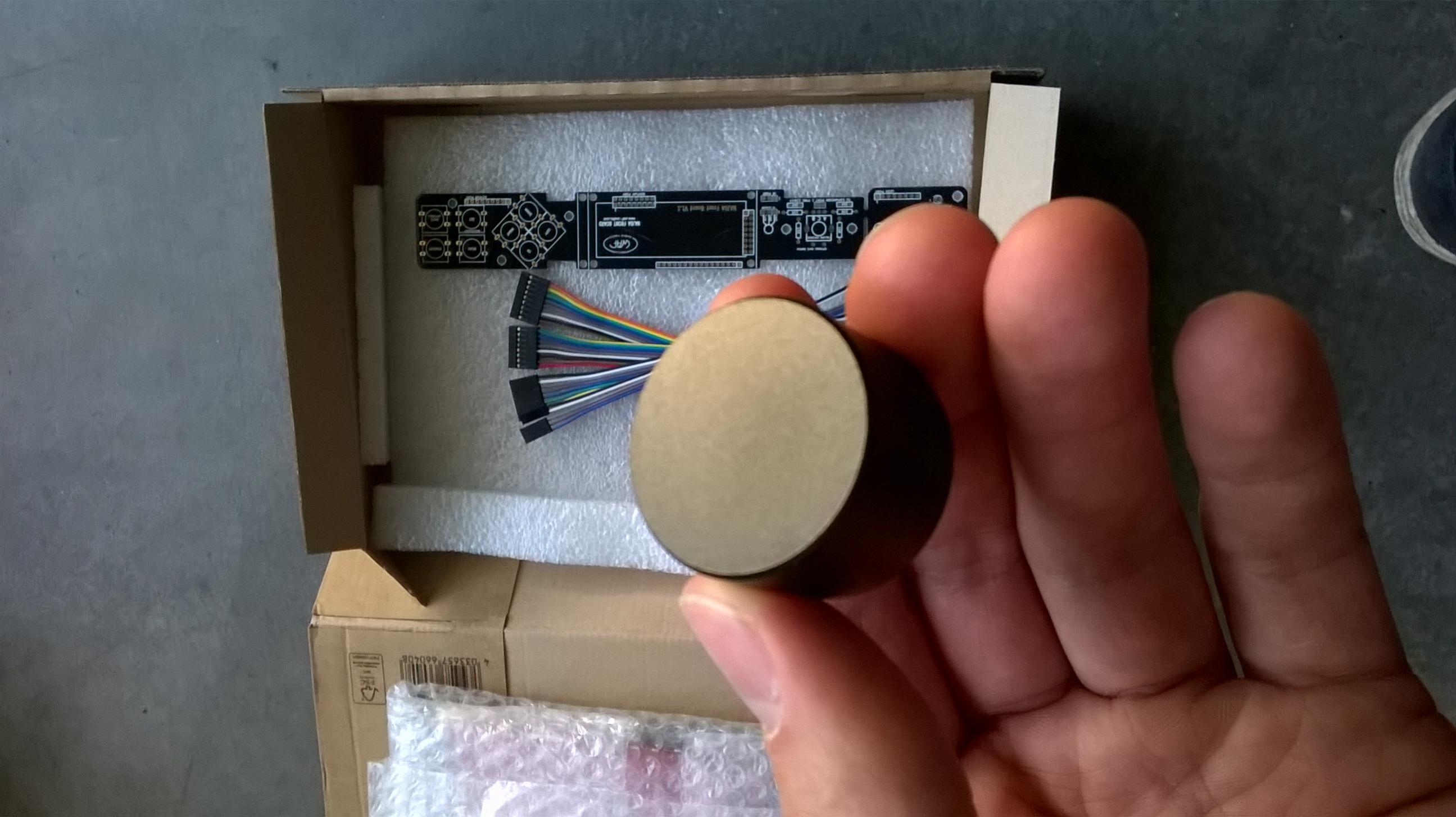

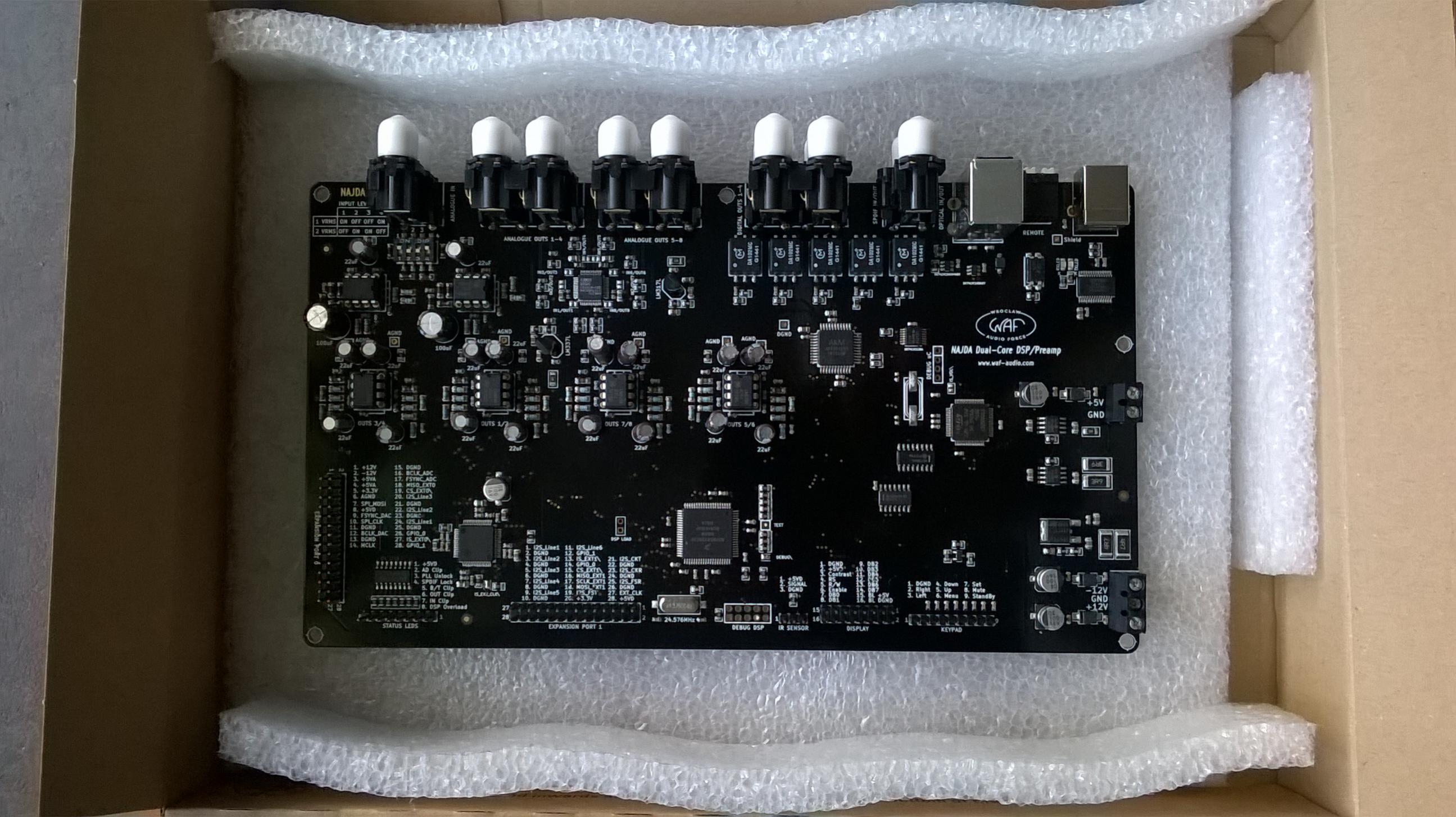

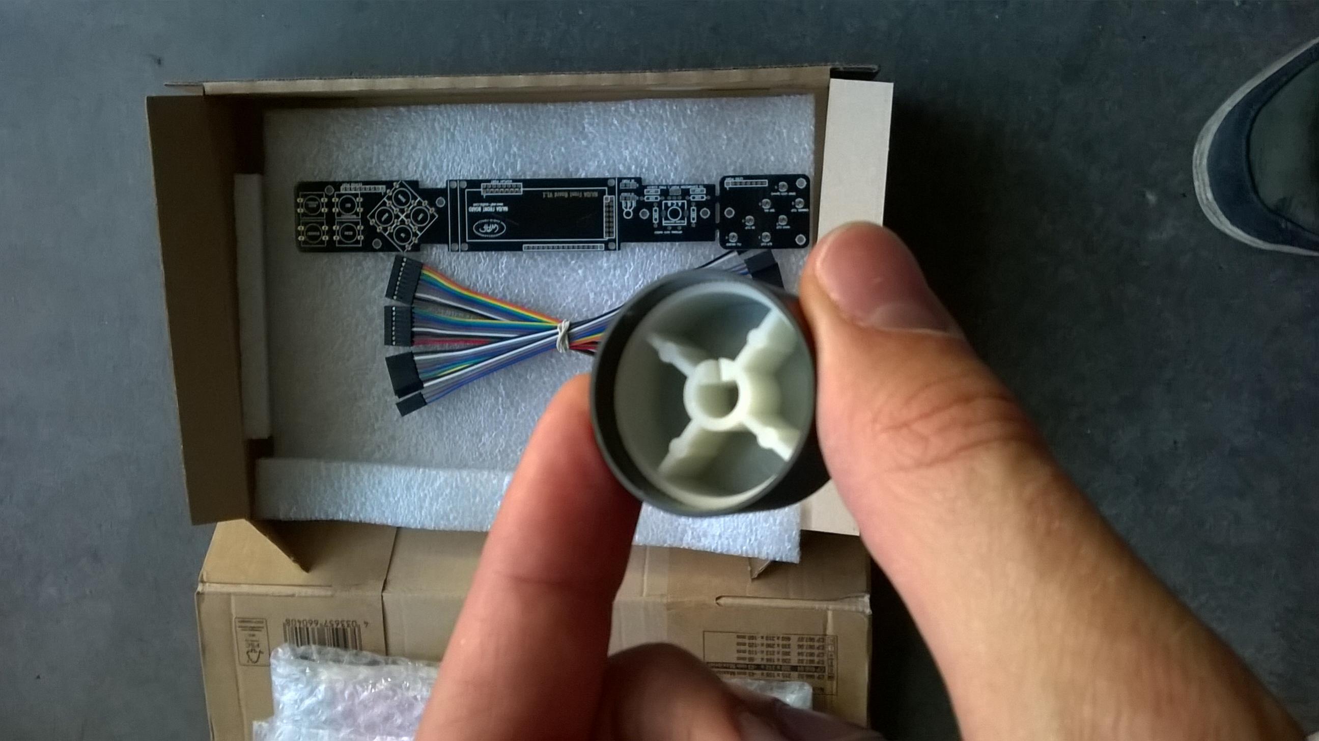

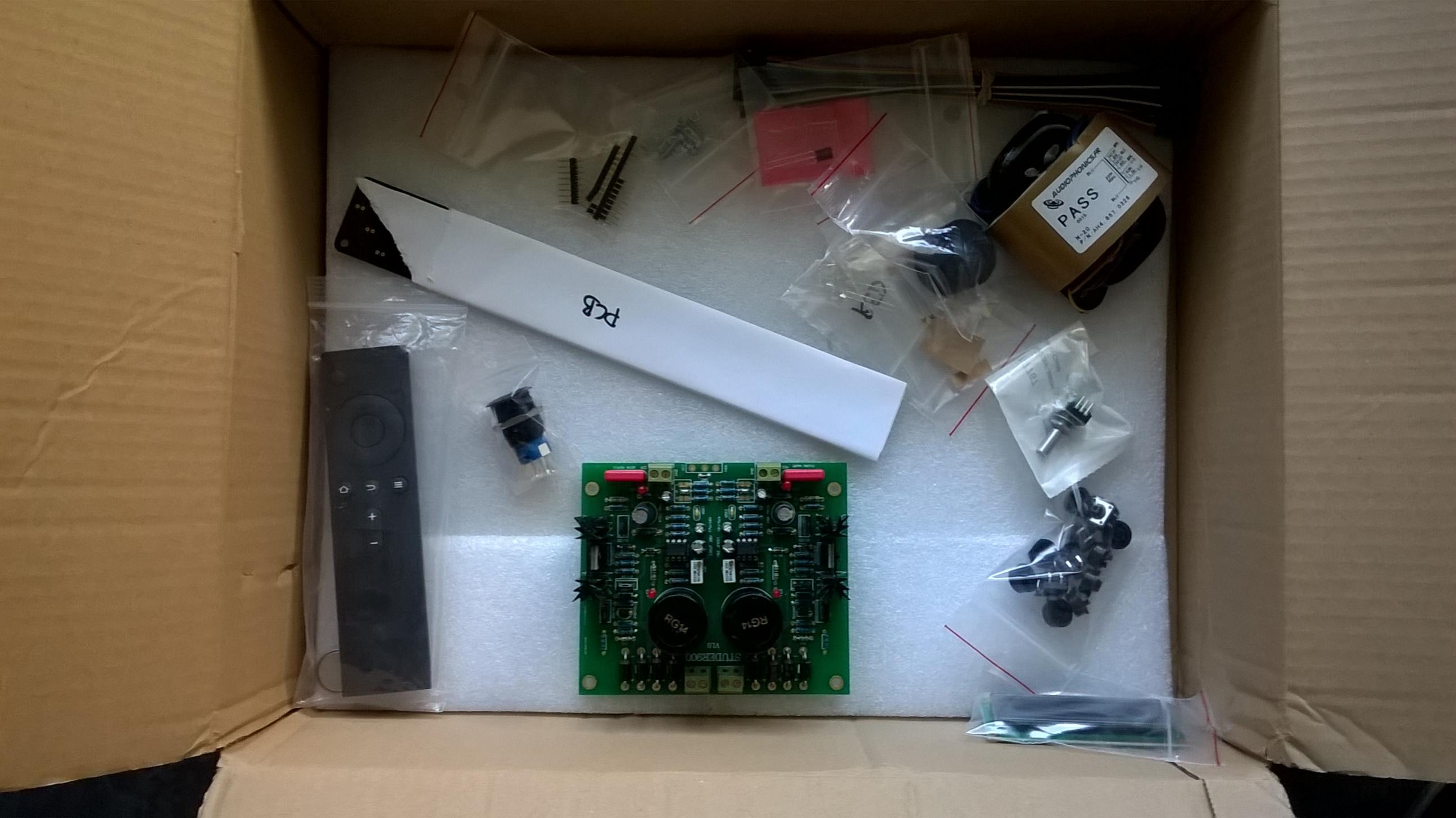

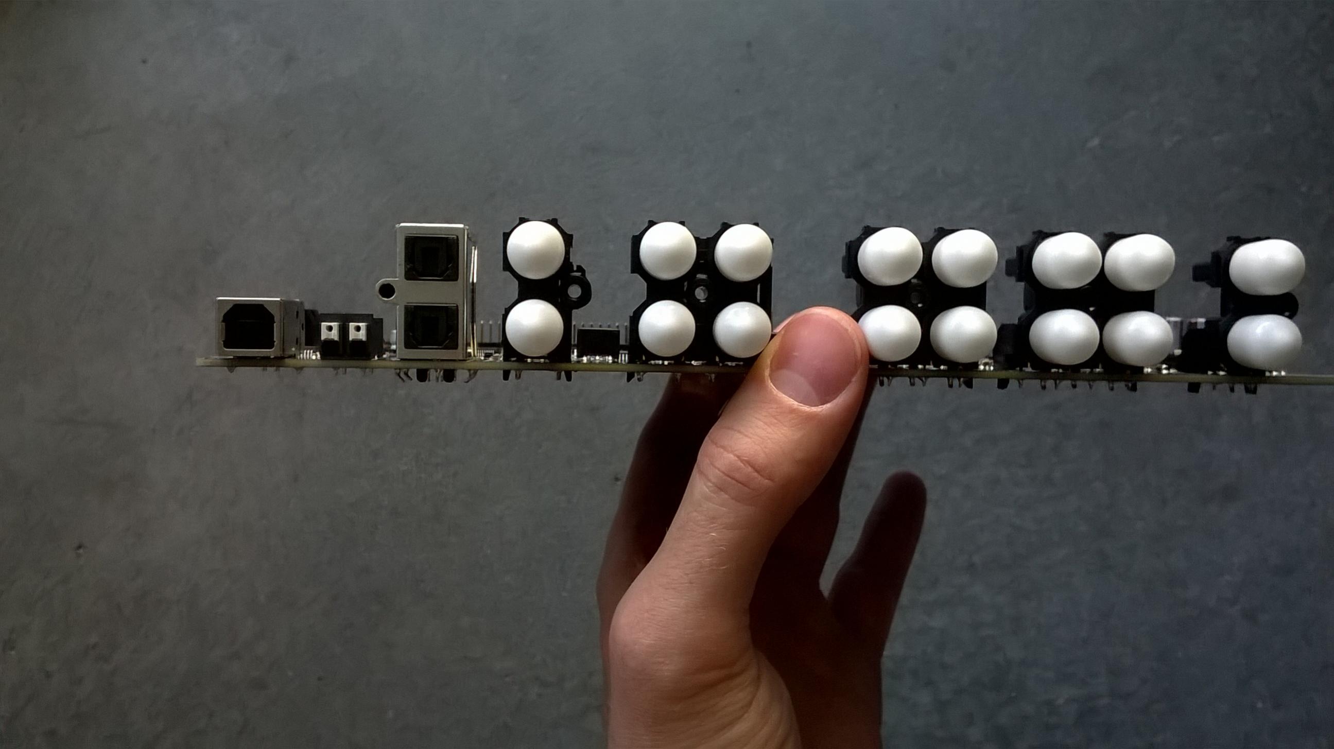

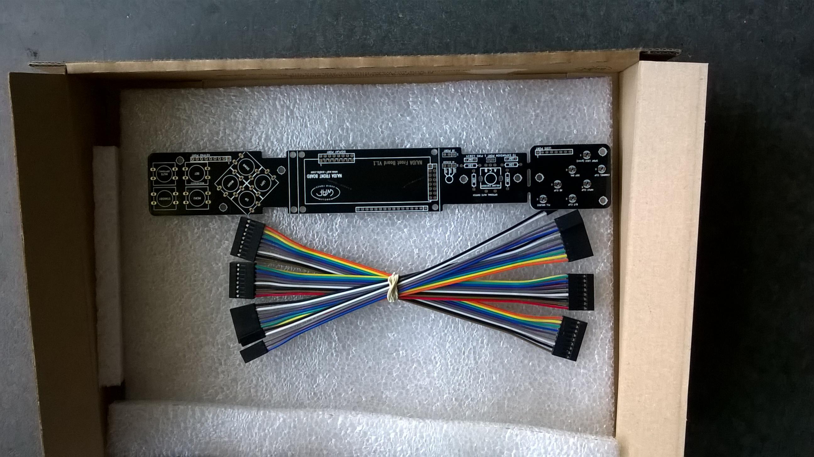

Just received my Najda and Control board kit today. Here are some unboxing photographs as reference for others interested in buying the kit. The optical SPDIF inputs are different from the photographs on the WAF-audio website (it was mentioned in this thread, that the optical input had to be changed due to parts availability); good that I have not yet started to drill any holes in the back panel. Everything was beautifully packaged, the volume knob and black OLED is nice. The last photograph shows the linear power supply, r-core transformer, remote control and standby button from audiophonics in France. I plan to cut up the control board (thanks fluid for your reply), and have only standby button, OLED, and Volume control on the front panel (with the volume push button wired to source selection, not mute ...) - will document my progress here ...

Does anyone know what position of the dip switches should be chosen for correct input sensitivity? My understanding is there are the left - right analogue inputs which can be switched from 1 Vrms to 2 Vrms sensitivity. But there are four switches (see upper left corner of picture in my post above).
Would 1Vrms sensitivity correspond to all switches up? 2Vrms to all switches down? The board came in a position with all switches 1 to 4 in the "on" state according to the markings on board, that is 1up/2down/3down/4up - what state does this correspond to?

The correct switch-positions are marked on the silk-screen of the board !

I had a look at the silkscreen writing (see also images in my post above), but I am not quite sure what it means: my guess is that I have to put all four switches in one direction either all in the 1Vrms or all in the 2Vrms row? (if not, what do the four switches 1-4 with their on and off setting mean? The on off labels in the four columns on the board silkscreen confuse me a bit)

Thanks Rainair, now I understand and my question seems silly (finally saw that putting a switch "up" corresponds to "on", and the silkscrren table position have nothing to do with the dip switch positions).

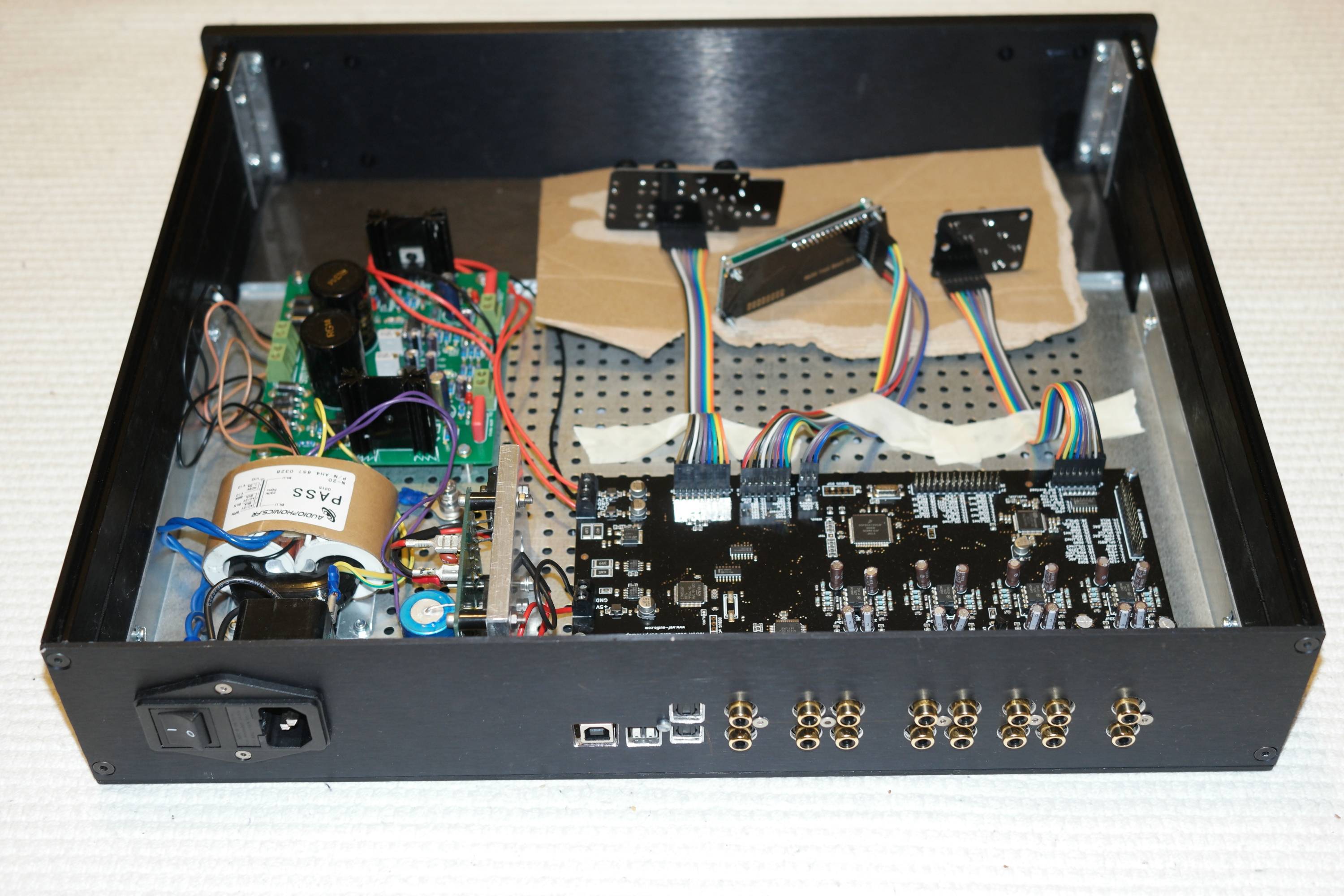

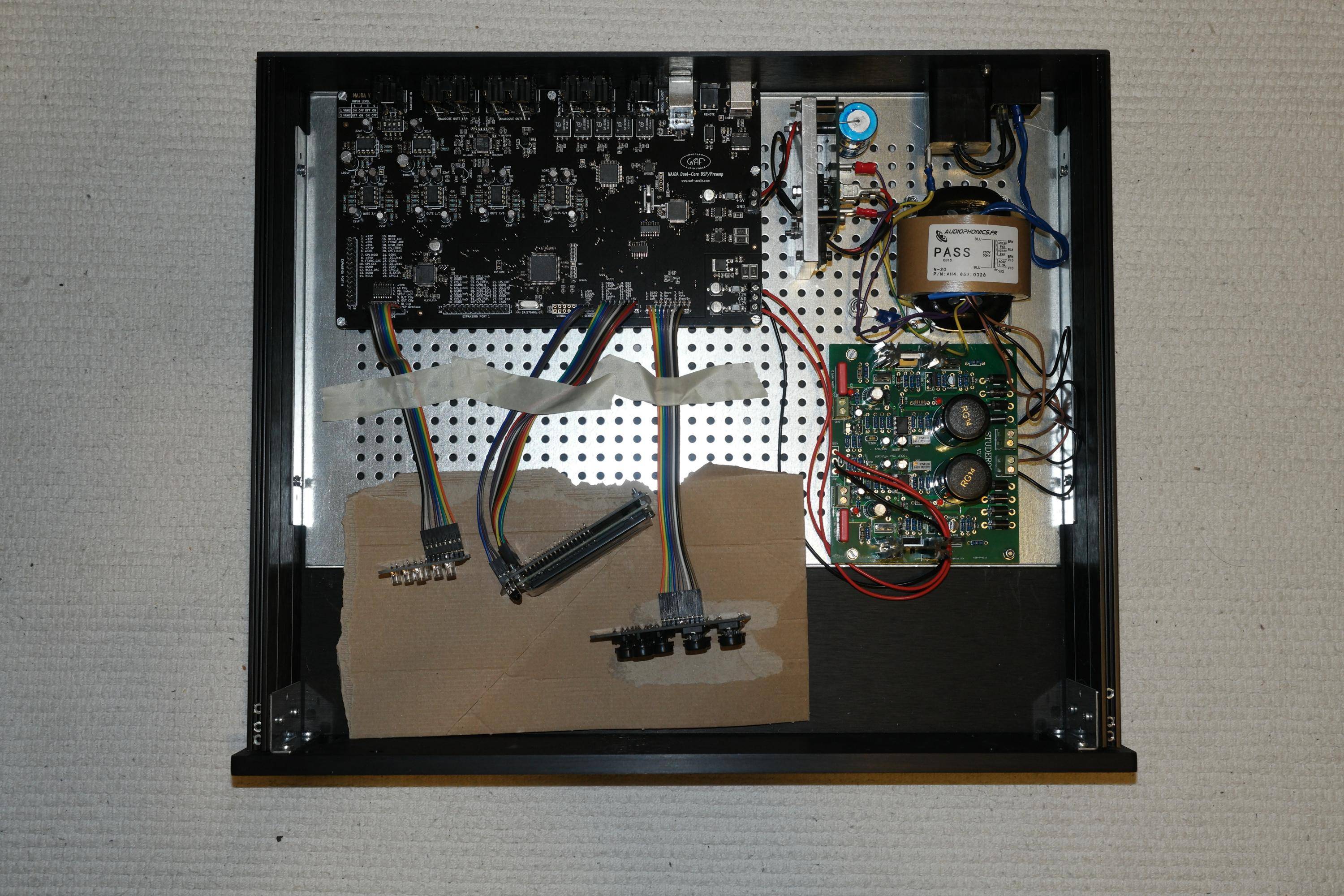

Finally assembled the kit. It sounds nice - as I have not yet made any microphone measurements and tweaked the filter settings I have to wait until I can compare it to a PC based crossover in critical listening. I have cut up the control board to make my own minimalistic looking front plate. In cutting up the board I disconnected +5V and DGND from the rotary encoder and have to solder some wires, also the remote receiver worked at first, but then I wrapped it up in bubble wrap and the static electricity killed it :-(.
The original control board setup with LEDs and buttons reminds me of a pro-audio look, I want to have a clean front with as few buttons as possible (standby button, display, volume). It would be great if the push-button function of the rotary encoder for volume could be mapped to select the next source, then I would have all the digital pre-amp functions of on/off, source selection and volume covered. I know there are quite a few other wishes for updates to the software / firmware so let's see whats possible in the future (it would also be great if left/right buttons do not show a reminder message when bass/treble is disabled but would switch source) 🙂
Still have to have the front plate machined - the back I drilled myself and with my skills it is ok but not perfect, so the front will be done on professional tools.
I have a few more questions:
-what is the ir remote receiver of the control board kit, or one that is pin compatible?
-are the outputs of Najda ac coupled? I am asking because my DIY amplifier is DC coupled and I want some protection against dc current on my speakers.
Thanks for any help, and thanks to Nick for a great kit 🙂
