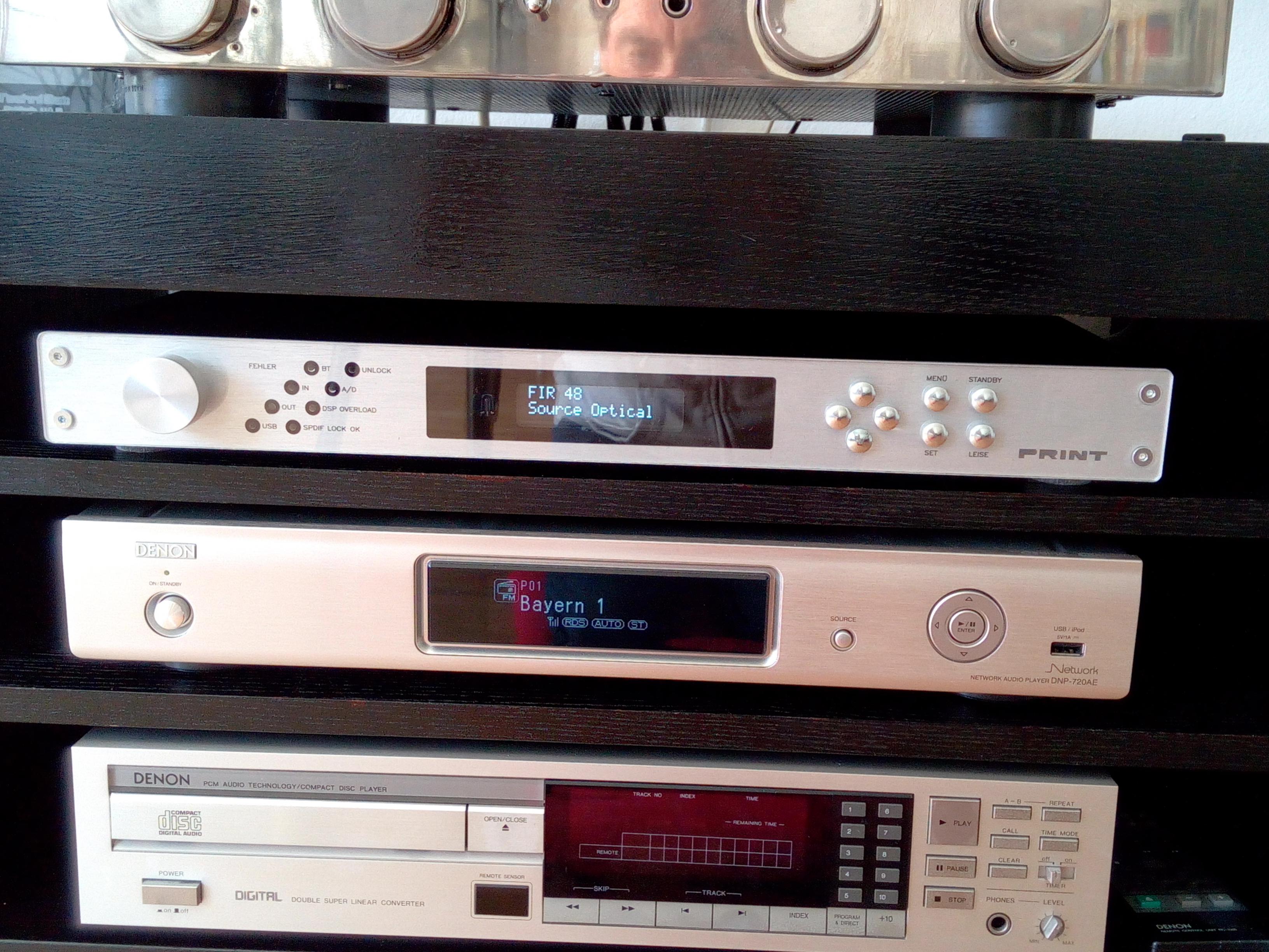

Enclosure
Hi all,
so, now i made a nice enclosure for my Najda, with a plotted layout-film and an acrylic glass. Looks fine.
But I need some help with speaker (I mean chassis) correction. Shell I use ARTA or RePhase or ??? and how ???
LG, Rainair
Hi all,
LG, Rainair
