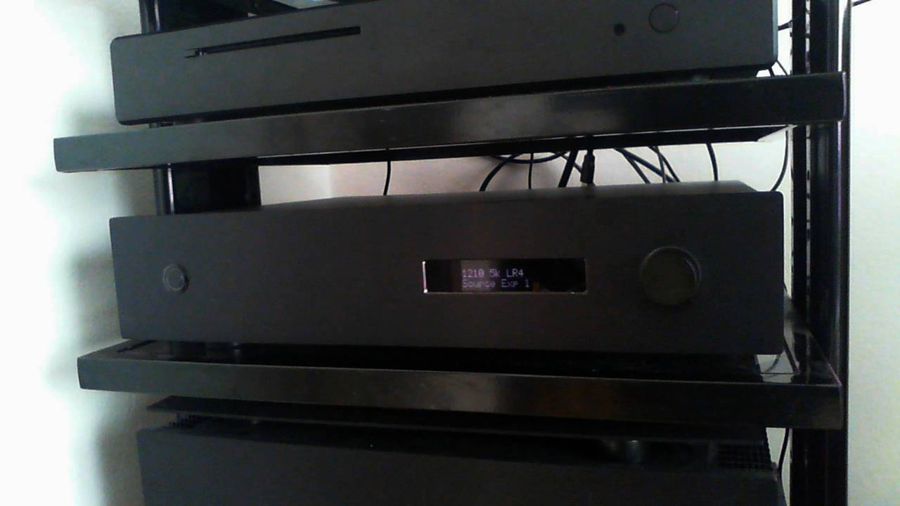

Another finished Najda
Here are some images from my Najda as a DSP pre-amp for a three way crossover:
I tried a minimal design without many buttons, so I cut up the input board from WAF. Case from Modushop in Italy 2u aluminum enclosure. While the back is hand drilled and a bit imperfect, I had the front made in a professsional workshop with milled display and volume knob recess (plus edding to paint edges black which works remarkably well). Display and IR receiver are behind a shaded plexiglass panel. On/off to switch to turn on Najda (and later also my amplifiers). As the standyby function is quick I do not currently need any mute button but use standby. Volume is controlled from the rotary encoder. There is a switch when pushing the volume wheel, which could be mute, but I plan to make it select the next source (via software update or with an inelegant built in remote control in case). This way I have all the basic functions of a pre-amp. As remarked before in the forum for the general user volume and source would be interesting on display (instead of the dsp preset).
There is a rpi3 with osmc inside via direct i2s - the rpi is supposed to be jittery, but I need to compare for a little longer with the supposedly low jitter Xonar ST soundcard on the coax input to be sure I can hear it (the asynchronous sample rate converter asrc in Najda will clean up a bit of jitter also). I found osmc and the kodi remote app to be more responsive than the web interface of volumio, moode, runeaudio, so I use it despite the video center idea behind it.
I have been playing with FIR, but 1023 taps are too little for a crossover from sub to fullrange at 100 Hz (room modes are minimal phase anyway so IIR prabably better anyway), a combined IIR FIR mode might be nice for an FIR crossover to my (super)tweeter. The IIR capabilities are very nice, once you get the hang of the NUC software. Also the possibility to change presets via remote is great to a-b test different filters. I am happy so far.🙂
Your box look fine but I'm interested how do you feel now afterword would you rather buy the ready maid Najda box.

My build got actually slightly more expensive than the boxed version, and as always in DIY I had to solve the occasional problem, such as a transformer with -0+ instead of dual secondaries needed for my supply board etc. For me it was worth it because it now fits to the enclosures of the amps. Also I now have a linear power supply - even though smps probably sounds nice too. Buying the boxed version avoids problems and gives you all the buttons the designer Nic intended it to have.
