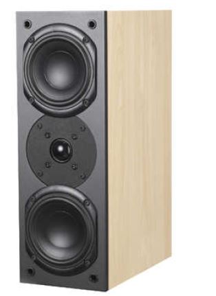

How much sensitivity do you get from the MTM configuration in comparison with a 2½-way 1-2 watts?
Why not something like this with a 2½-way with MLTL cab and a then a waveguided dome?
Speedster TMM - undefinition

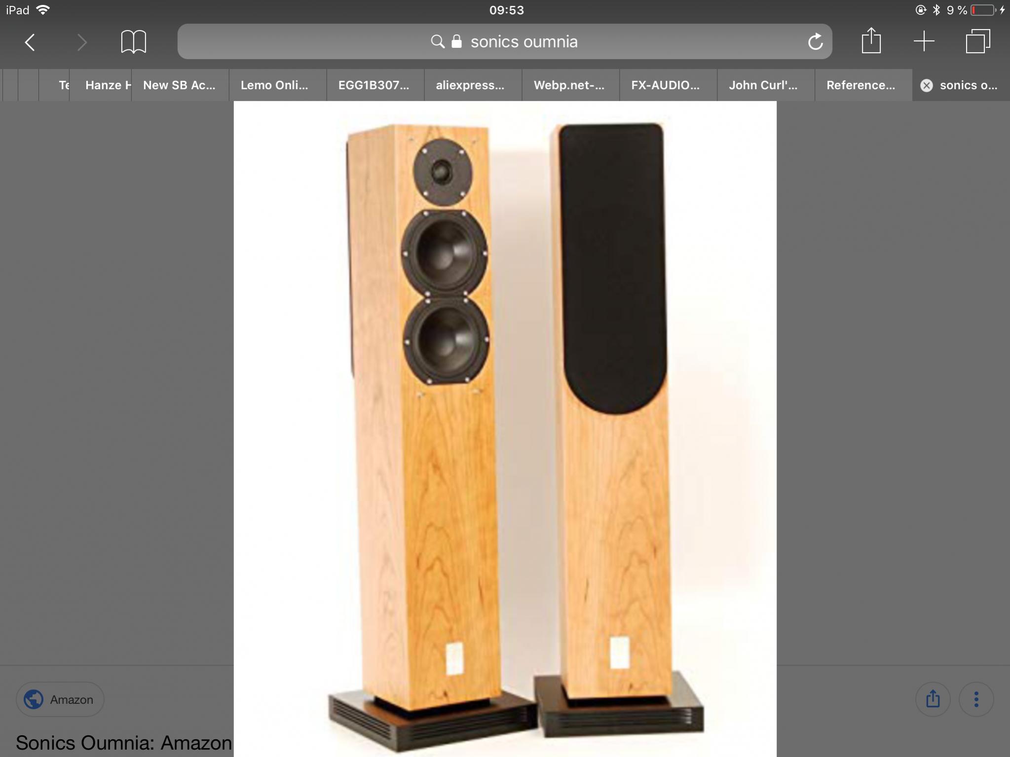

Here's a little Oumnia speaker by Joachim Gerhard.
I know a Peerless driver when I see it. Usually polycones (no nasty breakups!).
TBH, only Joachim knows if that is the TMM equivalent of an MTM. Or a 2.5 way. 5" or 6" leaves me vague too.
But for sure, a lot to like, and not a million miles away from the Ariel.
Well, the measurements on the above-linked thread appear to indicate a 2-way with a crossover frequency of about 2KHz, although Joachim also notes that for some of the boxes he was / is selling off, he'd re-jigged the filter in the light of subsequent experience, so it's possible the originals were different.

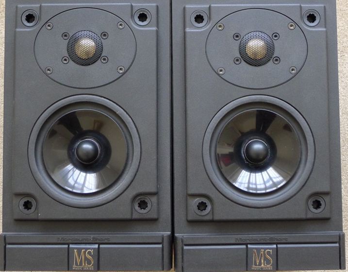

They had an illustrious predecessor in the little MS10i:
I have managed to dig up a picture of my MS10i setup in the 1980's, and a ludicrous stack of Rotel Amps, DACs, CDs and all the rest of it, including a potted plant and a rainbow ( which doesn't work well in B&W, but was done with overhead coloured spotlights... ) :
They didn't go very loud, as you would expect from a 5" bass and metal tweeter with a first order crossover, but a lot to like.
The MTM has an illustrious history, here with 4" Peerless polycones and a tweeter that looks a bit Monacor:
Why MTM is a good idea is the twin basses give out 6dB more level for the same distortion. Er, that's most of it.

I used to have a MS821C centre speaker by Mordaunt-Short along the same lines, actually series wired 4 ohm basses:
If I had had two of them I probably would have stopped there!
That picture reminded me of these — very compact (13 litres BR) and XO below 1/4 wavelength of the C-C:
They worked very well but the drivers got pinched fot Tysen V2 (same config but W14 in a Woden TL), but the cabinets seem to have vanished.
