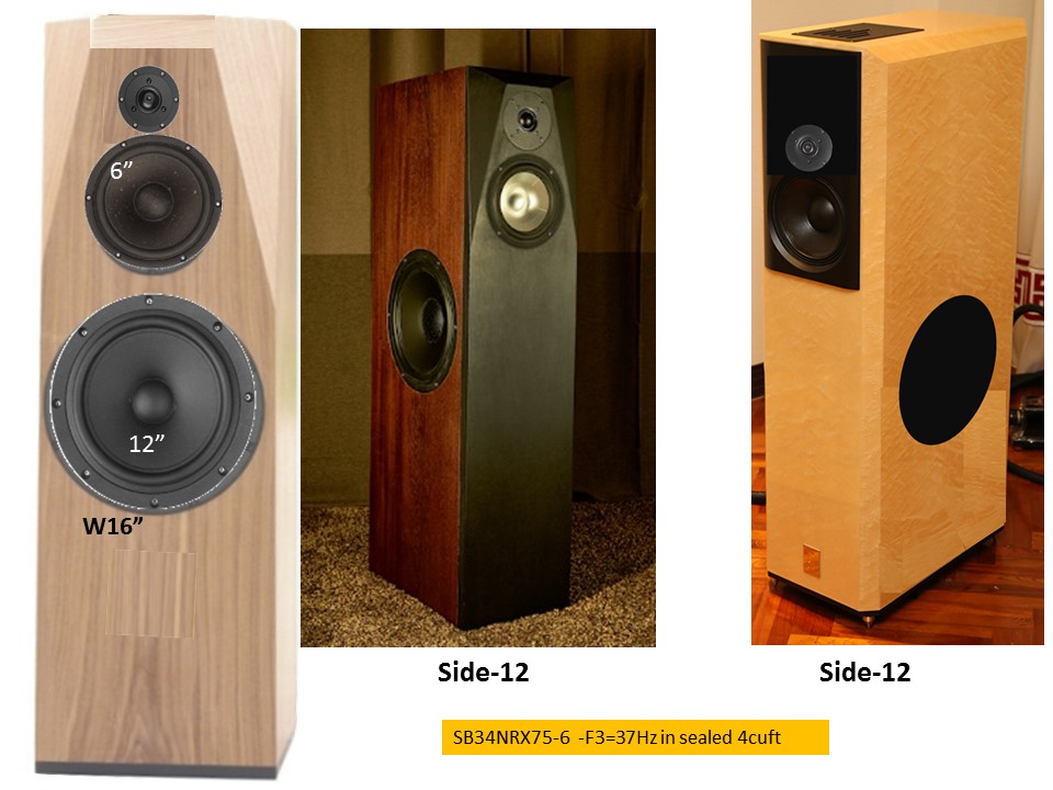

The woodshop capability often sets the design direction.

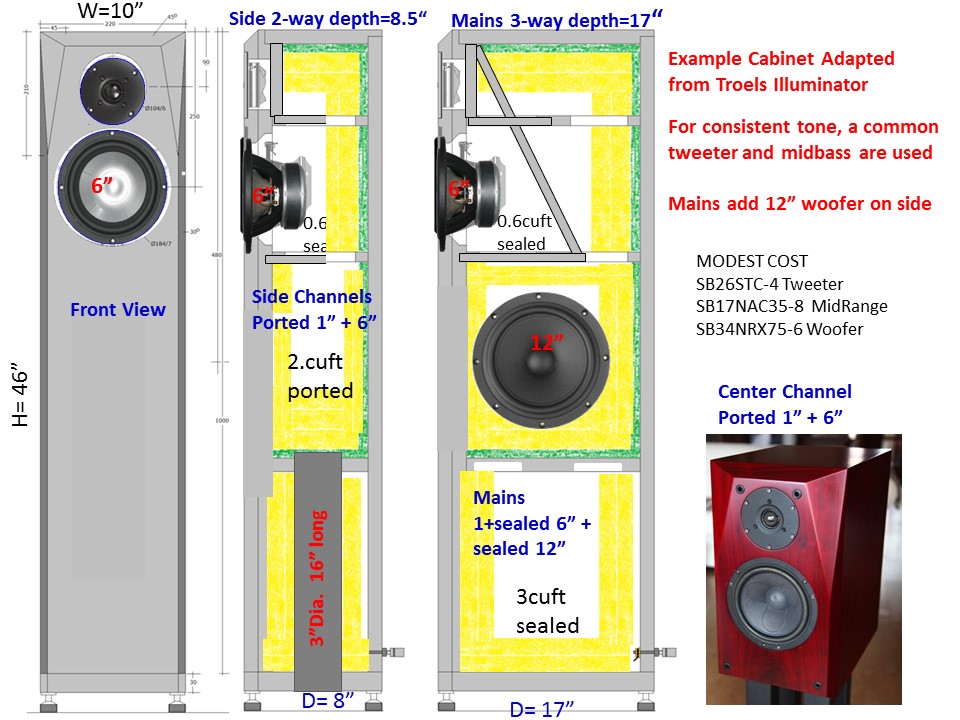

For uniform tone, consider a common 1" dome tweeter + 6" midbass covering 20kHz down to -F3 = 42Hz in a ported center channel cabinet, and -F3=38Hz for the larger volume ported side channels. The main channels would use the same 1" dome tweeter + SEALED 6" midbass with a SEALED 12" woofer for powerful fast transient bass down to -F3=37Hz.
A few cabinet pictures of sealed 12" woofer options.
A 12" in a sealed 3cuft volume can produce fast transient bass with -F3 ~35Hz.
--Front woofer: A ~15" wide front baffle is required: 1" tweeter + 6" midrange + 12" woofer.
--Side woofer: A ~10" wide front baffle for a 1" tweeter plus 6" midrange, plus a 17" deep side baffle for the 12" woofer creates the required volume.
The side speakers can use the same 1" tweeter + 6" midrange in a modest 2cuft ported volume.
The front center channel speaker uses the same 1" tweeter + 6" midrange in a ported 0.7cuft volume.

So far i only have basic woodworking tools and experience. I rececntly bought a router and was planning on installing a circular saw under the board to create a table saw. So with a little bit of patience and good hands I think I should be able to handle building a good speaker.
If I use several subwoofers around the living room, wouldn't the 12" drivers in the front speakers be kind of useless?
I also wanted to use 2 (smaller)woofers for all the front speakers so that I can use the same setup for the center channel when it is placed horizontally. For example:

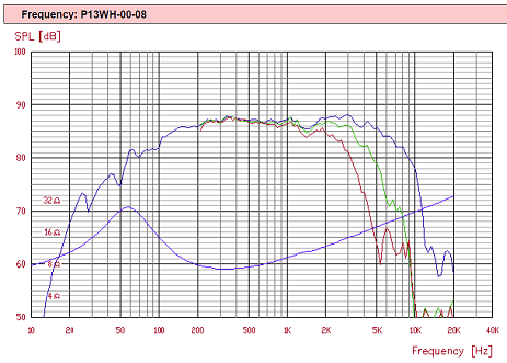

The Vifa P13WH-00-08 was a theoretically marvellous 4-5" polycone midbass:
