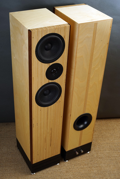

If I understand this article then when you have 2 mid drivers or tweeters in a vertical speaker that at certain frequencies, the speaker starts to create a narrow beam. This beam is dispersed horizontally and not vertically. Does this also mean that if you stand up or sit down with a vertical MTM you will get dips?
Ok some pictures should help you to understand what happen :
Google Image Result for https://www.audioholics.com/bookshelf-speaker-reviews/rbh-r-5/conclusion/R515polarmaphorizontal.jpg/image
Google Image Result for https://www.audioholics.com/bookshelf-speaker-reviews/rbh-r-5/conclusion/R515polarmapvertical.jpg/image
This representation is called a polar map. In the vertical axis you have the coverage angle, 0 being on axis, in the horizontal axis you have the frequency, the colour define the level of the related freq.
In the first pic you can see that from 500 to 1khz you have a progressive beaming with a covering angle of 40* approx at 1k. This is the main 'lobe'. Some 'wings' appear around 1k till 2,5k: these are secondary 'lobe'.
Between 500 and 1k if you are located between 100 and 40 degree off axis there is a 'hole',with level attenuation up to 30db for these frequency.
Overall this is not very even coverage.
Once correctly oriented ( second picture) coverage is much more even in the horizontal plan. In the vertical plan what happen is what we seen in the first picture: you've got a optimal listening angle of +/-20* around tweeter axis.
Given you will probably not jump around when listening music or watching a movie this is not really an issue and it help to reduce reflection from floor and ceiling.
If you don't want to have this restricted vertical coverage you'll need something else than a mtm.
I hope this is clear and help.

I think I get it.😀 Like was said before: for center speaker use 1 midrange and tweeter or use coax/full range.
Does this also mean that the distance between tweeter and midrange shouldn't be the same length as the wavelength of crossover frequency? Could be a stupid question...
Great.
Not a stupid question AT ALL.
This is what the Biro article is all about in the special case of d'appolito/mtm.
There is a rule of thumb ( which is nice to keep in mind): if you want 2 driver to have acoustic coupling ( that they behave as one and only source) you have to keep the center to center ( of drivers) distance below 1/4 wavelength.
EG: 1Khz crossover, speed of sound 344m/s: 1 wavelength= 34,4cm, ctc distance: 8,6cm.
In the case of mtm d'apolito 1/3 wavelength is commonly used ( and is almost equal to 1/4 distance in practice).
This is a good practice if you want close to a 'point source' behavior. That said this is only a variable on many in a design. Other way to do it may yield great results too ( line source for example...).
