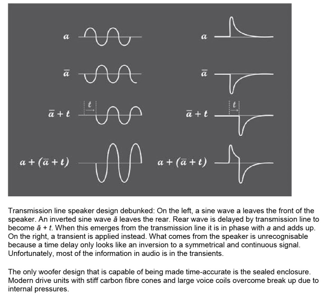

A transmission line takes the out-of-phase rear pressure wave off the speaker cone, bounces it around a few twists and turns, and pushes this delayed distorted sound through a small bottom hole into your room to mix with the earlier perfect-launch perfect-polar directivity front pressure wave perfectly-aimed at your ears.
The 2-way Ariel has a 3.8kHz T-M crossover, high enough to affect transients on solo instruments.

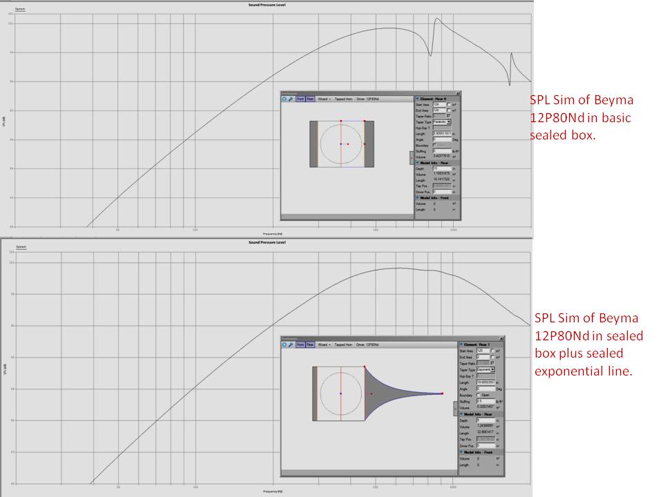

For the sealed midrange, a maximally damped Qtc=0.58 total open volume allows the front 70% to be constructed with just on-side absorption material for fast transient pressure launch, followed by a 30% tapered rear volume filled with fiberglass absorption material to remove resonances. A simple slanted rear side board can create the taper.

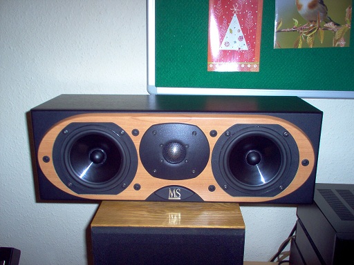

Not really.
MTM's have a narrow radiation pattern making them a poor choice for centre speakers because people sitting off-axis on the couch will experience cancellation dips. Good quality centre speakers are 3 ways with the tweeter above the midrange or coaxial and woofers to the side. The much longer wavelength at the top of the woofer passband avoids the cancellation dips.
