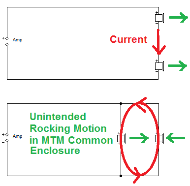

What happens at a simplistic level with two basses in a common enclosure? Push one in, the other pops out. Agreed? A simple question of air pressure...
There are electrical questions to do with damping that might reduce or increase the effect.
Where I got to with a thought experiment was that series wired might ensure the midbasses actually work together in a common enclosure:
I could be wrong on this, but have seen nothing to contradict the notion. Seems to me that no matter how good the control from the amp is, it can do nothing to stop the rocking motion on the parallel basses in a common enclosure. As long as the basses are mechanically identical, everything ought to be symmetric, but is that the real World?

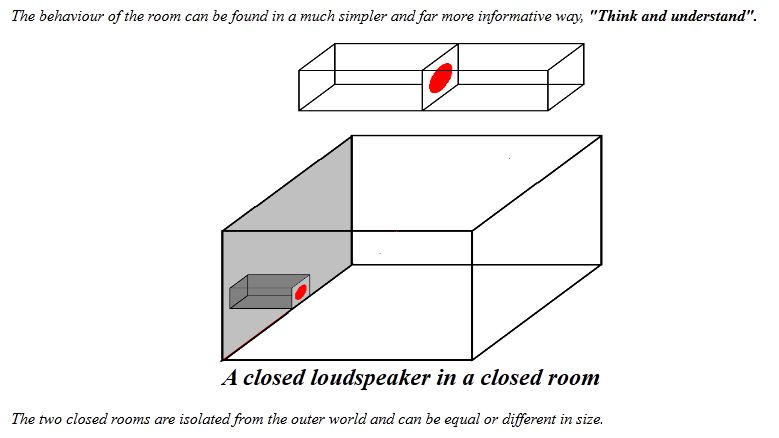

The room, by Steen Duelund:
I don't mind a thought experiment at all. Steen doesn't explicitly mention reflections from nearby boundaries, he doesn't take the box into the room which might need bafflestep to work. He doesn't go into the difference between a wooden Scandinavian house and a stone-walled or brick-walled British one.
But I got it.

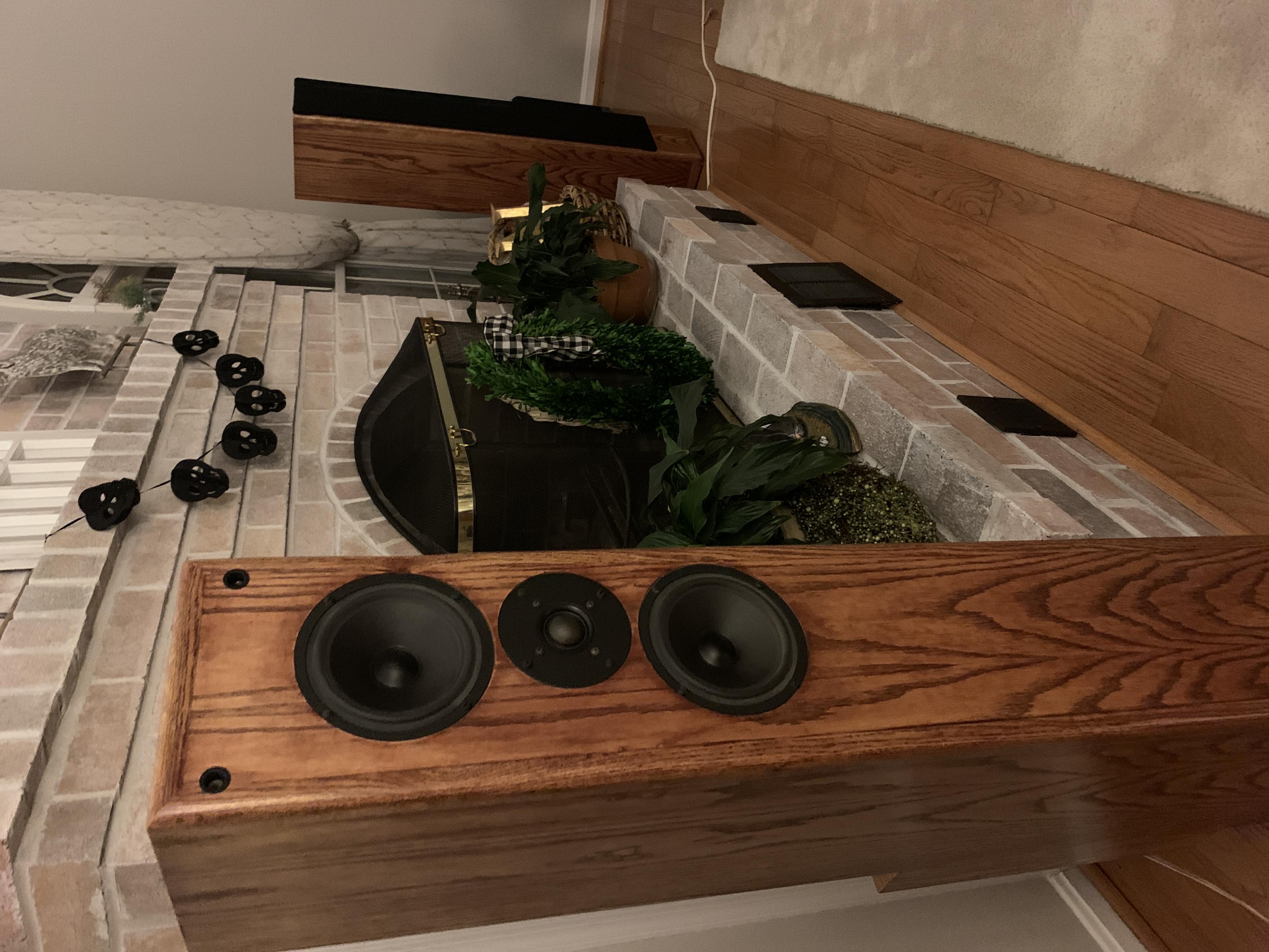

Here one of my favorite FF85wKeN boxes — a set of µFonkenSET built by Bernie for CHris in solid walnut (there is a dedicated helper woofer for these that acts as a stand and turns the small standmount into a small, tallish, floor-stander with no apologies.:
Listening in the big room, with the big hifi, both the standmount MTM pictured and the floorstander Tysen V2 with the same drivers, biamped, they play reasonably loud with good dynamics. Once the bass is relieved the FR can soar.

Thanks for the explanation Steve, though TBH I'm thinking re:"Push one in, the other pops out" - sure, but usually it's the amp that's pushing both in the same direction, series or parallel...(maybe those old fashioned valve thingys do something different, with their higher output impedance).
Like I said, I could be wrong on this:
But that is my current thinking.

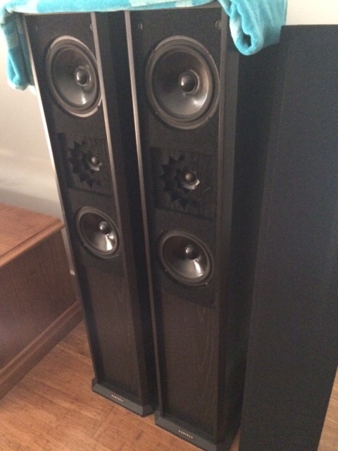

Reason I focus on series wired these days, is the conversion of an MT to a series wired MTM is particularly easy.

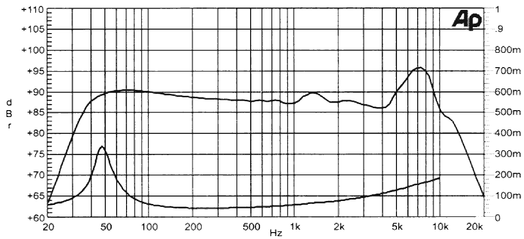

Vifa PL14WJ-
Double coil and resistor values, halve capacitors in the MT bass circuit, and the tweeter filter is unaffected. Oh, and double volume and ports.
I'm not sure I want to take on a paper 5" though. Maybe a Peerless 830860 polycone is a better way to do things, and like the P13WH in this thread:

This is where wiring drivers in series can really bite you. If the drivers were perfectly matched (hah!), no problem. But in the world where we live in, they are all over the place, especially the compliance factor, which might never settle down to a final value, depending on humidity, abuse, etc. etc. By contrast, the mass is going to stay the same until complete destruction, and BL is only going to change if the magnet gets weaker over time (which doesn't really happen with ceramic magnets).
You can see the obvious problem if they are wired in series, especially if the enclosure has a common volume. The Fs will NOT match, so you get two impedance peaks, not one. This isn't good, since the drivers are now transferring energy between each other, at least in the Fs region. Worse, the Fs of each driver is not a stable value, since compliance shifts with drive level ... it's not even very linear, unless you go to exotic double spiders with one reversed, or the really old-school "spider" assemblies made of copper or whatever.
This is why it's a good idea to step away from idealized models and take a good look at the real-world driver, and not just one, but a whole bunch of them in a production lot. It's important to know where the source of variation is coming from, and what can be done to alleviate it, or at least make the production loudspeaker not as sensitive to it. The design should never depend on idealized drivers.
