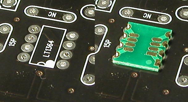

You could make or buy an adapter for SOIC to DIP conversion.
You could buy them at http://www.audioworkshop.com.hk/index_en.htm

anyone had any luck with a hot plate and solder paste with smd components. as i get older these parts get smaller and the two do not go together well. since the opa1632 can not be had in dip 8 soldering will be tedious.
