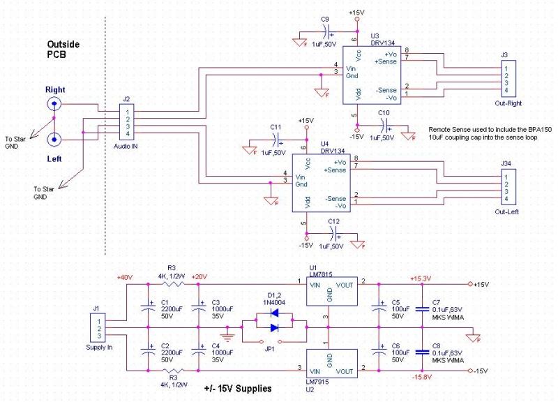

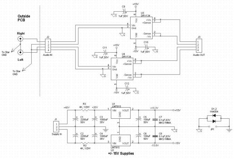

I'm about to design a small DRV134 PCB for my BPA300 amp. This is the schematic, nothing fancy. I included the +/-15V supplies on it. I also included a small CRC filter to drop the amp supply voltage to a lower 20V and goes away with any heatsink on the regulator IC's.
Please comment on this schematic and how can I improve it, or correct my mistakes, before I design the pcb.
Thanks...
Thanks...
Have you checked you can buy the DRV134 chip now? Not many shops stock them. This is one of the reasons alexcd used OPA1632 instead.
Yes, I got them already so... Digikey has almost 540 in stock for the moment.
Here a possible improvement. Reading the DRV134 specs sheet, it is mentionned that a 10uF coupling cap can be connected as part of the DRV134 loop using the remote sense pins. This way the cap effect is mostly removed from the line. I included the sense pins on the output socket so they can be connected directly to the DRV150 pcb coupling cap. If not needed, they could be jumped using some jumper pads on the PCB.
The loop length would then be quite long...
