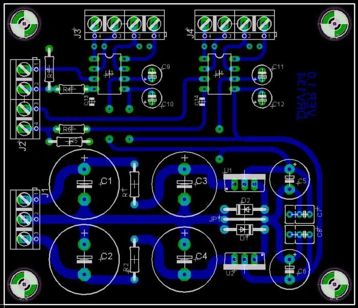

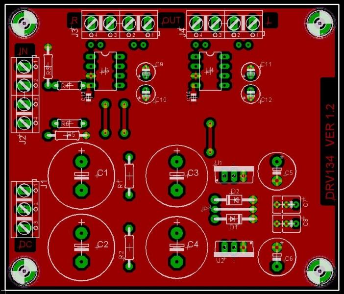

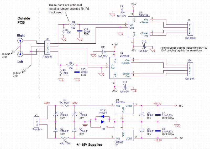

Hi, the regulator may drop out due to lack of voltage on it's input pin.Algar_emi said:Please comment on this schematic and how can I improve it, or correct my mistakes, before I design the pcb.
The 4k (CRC) drops 20V on just 5mApk.
What is the quiescent in a pair of DRVs?
What is the peak current at your maximum signal into minimum impedance?
Maybe you should pre-regulate the 40V down to 30V, then you have protected the second from excess voltage and the first only has a 10V drop.
The pre-reg could float on the output voltage of the final reg. It might need a bypass Zener from input to output to cope with start-up conditions.
Thanks AndrewT for your comments. Yes, the 4K resistor was estimated using the quiescent current of the pair of DRV. However the exact value will be determine once it is all connected and working. I just want to reserve the space on the PCB for the resistor. Pre-reg is a good alternative, but maybe not needed in such a simple circuit. The CRC filtering has also they added benifit of reducing the ripple even further, as would do a pre-reg with its CMRR also, I know, but again more complex and a few dollards more.

I did not know Digikey had DRV134's in stock. I'll order some today! BTW, Algar, will you be selling these boards? I'm very interested.
digi01 has a real nice little drv134 board he sells with the regulators on the pcb. nice little compact unit and pretty cheap.
Thanks for the info. I'll probably do my own since I want both channels on the same PCB. Thanks anyway.
I'm making 4 mono channels (I have my work cut out for me.) Two would be a good idea to save on parts.
