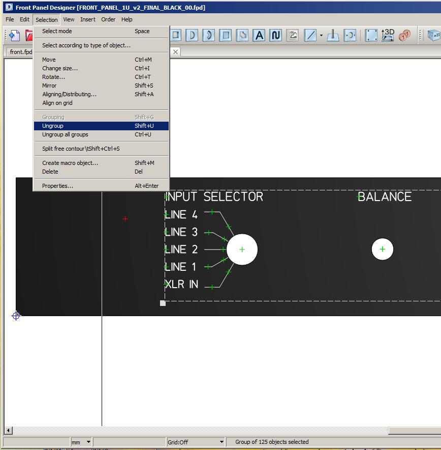

Noticing that on the Front panel from Carl it is showing XLR In then 4 lines in after. Anyone understand that. Was there a version with only 1 XLR?
The markings on the front panel that you have machined must be edited to the IO arrangement of your build. I have built several variations. What I sent you is just one of those variations. Changing the markings is very easy using the FREE Front Panel Express software that is downloadable from their site.

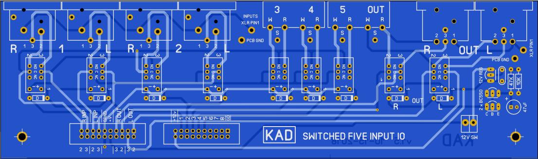

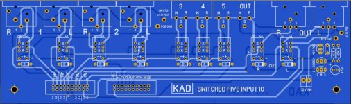

The standard IO PCB that I ship has two XLR balanced channels and 3 unbalanced channels in and looks like this ...

Yes I agree Carl and I am using the I/O board you have pictured. I have been trying to mod the fpd.file but whenever I click on anything on the front panel it highlights the whole panel detail as if it was dropped in as a pic or something. Trying to figure out how to modify individual labeling. If you know anything about this please let me know.
... I have been trying to mod the fpd.file but whenever I click on anything on the front panel it highlights the whole panel detail as if it was dropped in as a pic or something. Trying to figure out how to modify individual labeling. If you know anything about this please let me know.
You need to 'ungroup' the items that you are clicking on as shown in the attached PIC ...

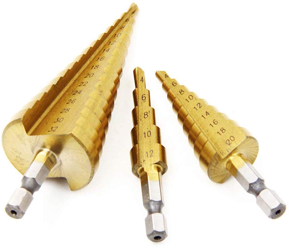

The price certainly is right! How about the build quality and durability of the product?
The material is hard MS. Fixtures are countersunk type. Front is brushed aluminum. I found easy to cut hole using this...all sides are removeable. Feels quite strong when assembled. No flex. Also rubber feet. I have ordered two so far. Parts were well packed when shipped. No damage.
Best regards
Farooq
