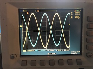

Connecting up the balanced output to balanced input amp. Ran into an issue with the L-/ L+ as seen in attached scope shot. They are 180 phasing but not equal amplitude. One is 1.25vac and the other 1.09. This causes one channel in the bridged amp to clip before the other. Just assuming will have to go through gain stage of pre and see where the imbalance occurs. I'm assuming U8a/b.
