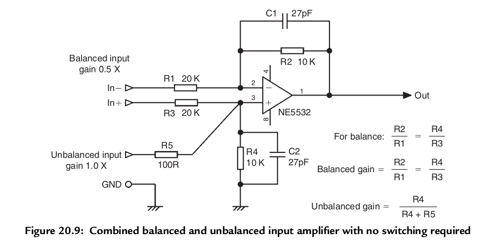

This was what I had heard in another thread. But if you see the schematic of this preamp as it appears in the Linear Audio article, it seems Doug Self has drawn the two types of inputs as simply wired up as I had described.I believe if you use a balanced input with an unbalanced source you must short to ground the -ve. Maybe better to just use a RCA to XLR adapter.
Is he able to do this because his balanced-to-single-ended input circuit is in any way unusual?

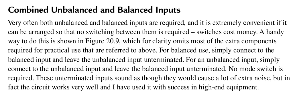

I finally managed to find Doug Self's comment about this in his Audio Power Amplifier Design Handbook:I believe if you use a balanced input with an unbalanced source you must short to ground the -ve. Maybe better to just use a RCA to XLR adapter.

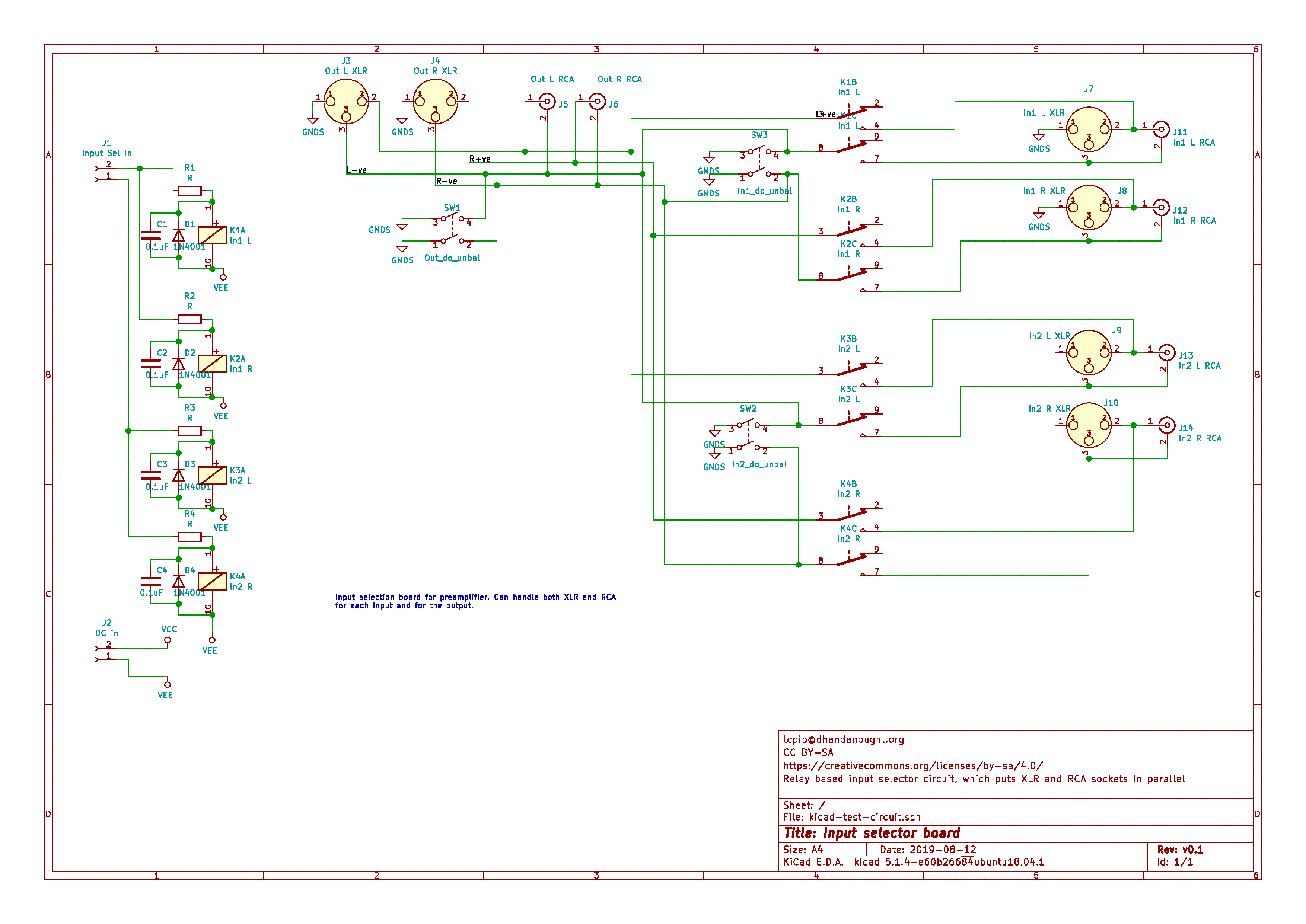

And this is the circuit:
Looking at all this, will this schematic work?
Doug Self talks about putting resistors of appropriate value in the input signal paths. If I have to put identical series resistors, they will have to be on the input selector board, before the unbalanced and balanced wires join into a common set of wires.
My schematic is just a small part of the final board -- it just shows two inputs, and XLR+RCA for each. The rotary switch which will drive the relays is not shown here.
Against each input "way", I've put a switch, to draw the -ve signal line to ground, in case you are choosing unbalanced input and dislike the idea of leaving the -ve signal input hanging. (Doug Self says it's ok, but I wanted to put the switch here to show that it can be done.) SW1 does something similar with the output -- if you want balanced output, leave the switch off. If you want unbalanced out, you can choose to turn the switch on, and the -ve signal pin will be joined to signal ground.

This is a good idea however you should check the original schematic as it deals with your design through placing the unbalanced input across pins one and two of the xlr and leaving pin 3 open.

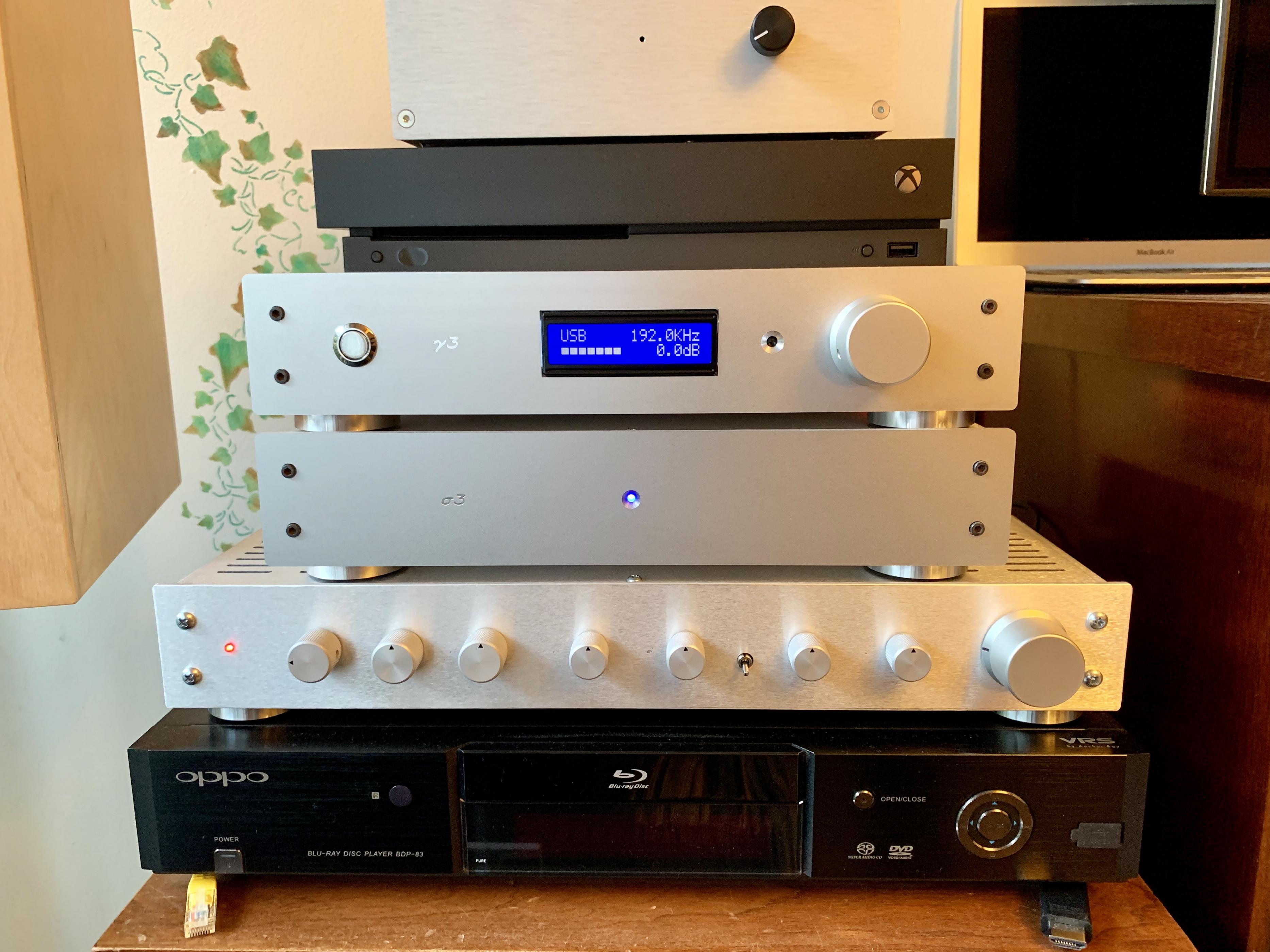

Hello Hicoco,This is the Front panel..
I really like your design 😱
Would it be ok for you to provide front and rear panel fpd files?
