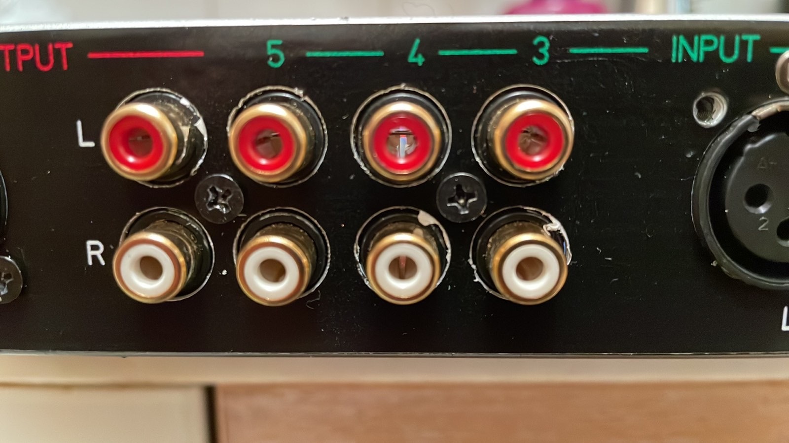

Just want to report that after two years of scrapping together parts, making various mistakes, getting help from the forum, screwing up the front panel order with Modushop and redoing it in laser cut baltic birch...the preamp was finally installed upstairs feeding my F6 and some A26 speakers. Fantastic pre-amp. At least until the bomb cyclone hit the west coast and my power went out. Turns out it doesn't work when there is no power. Oh well.

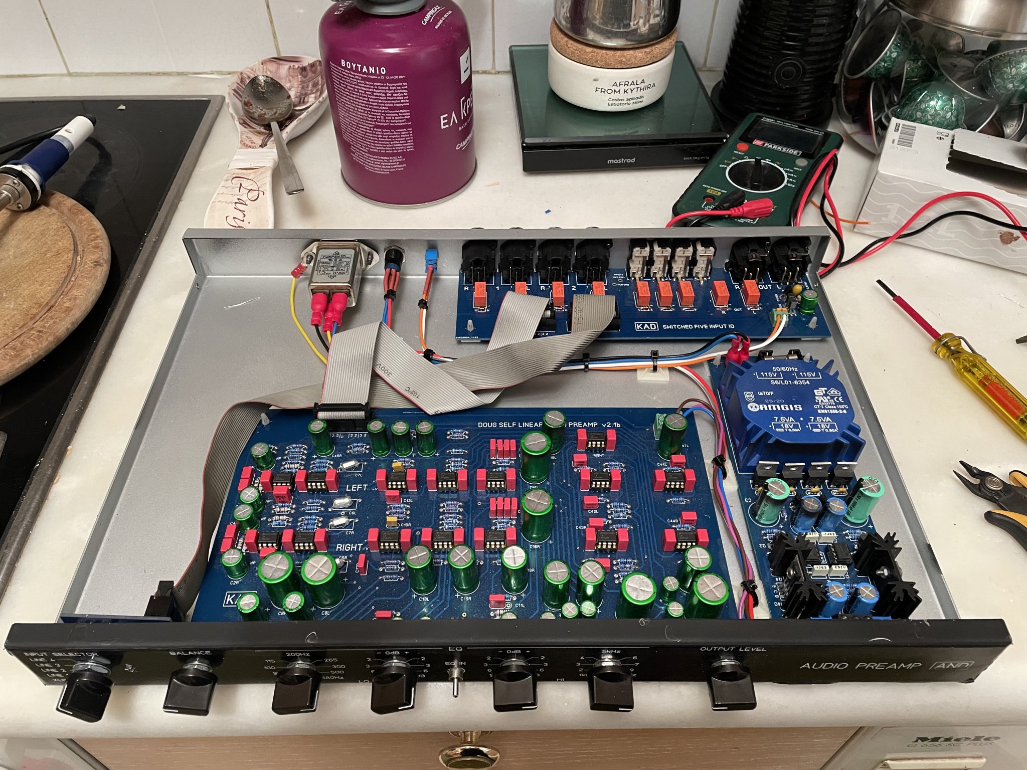

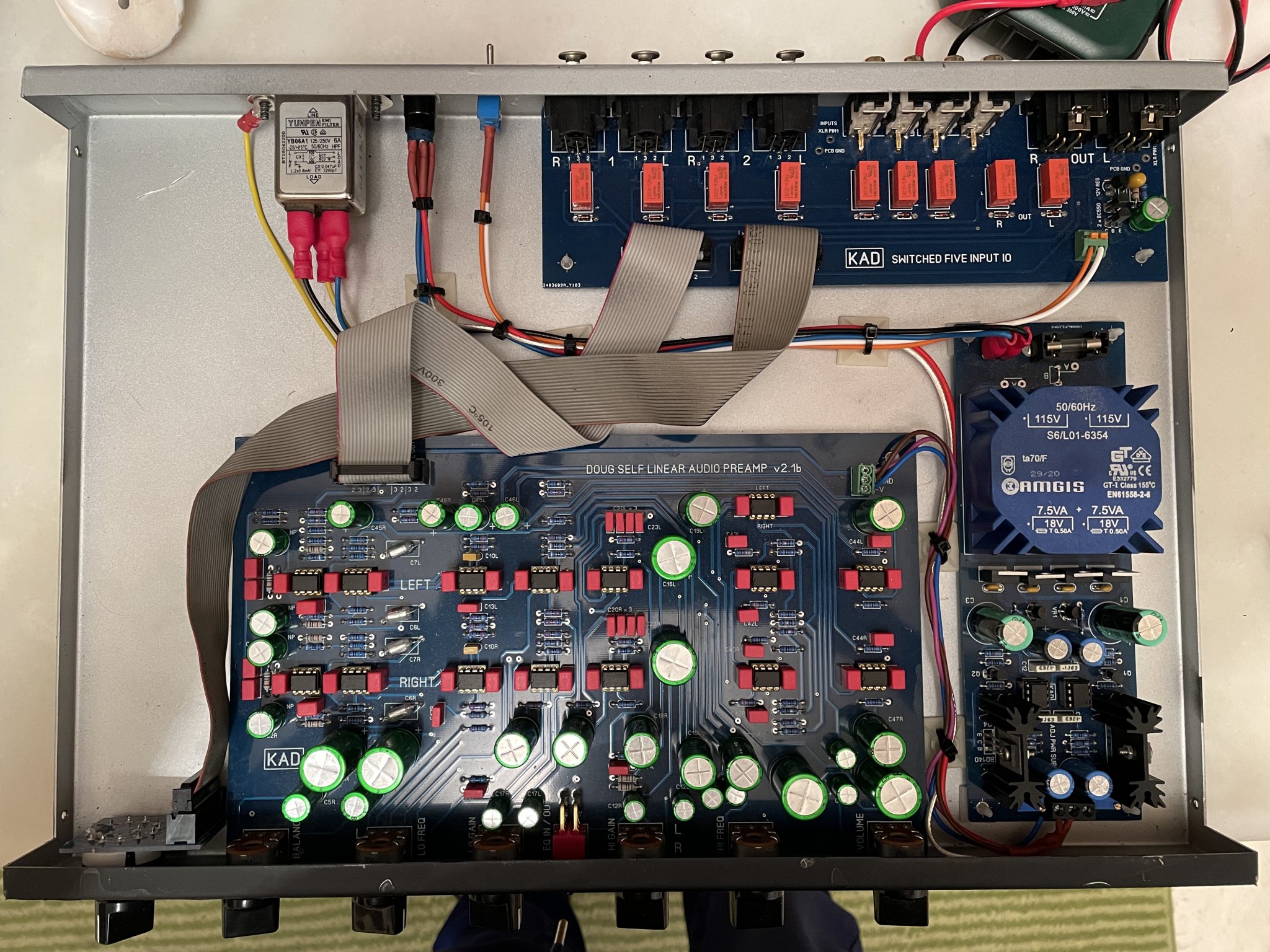

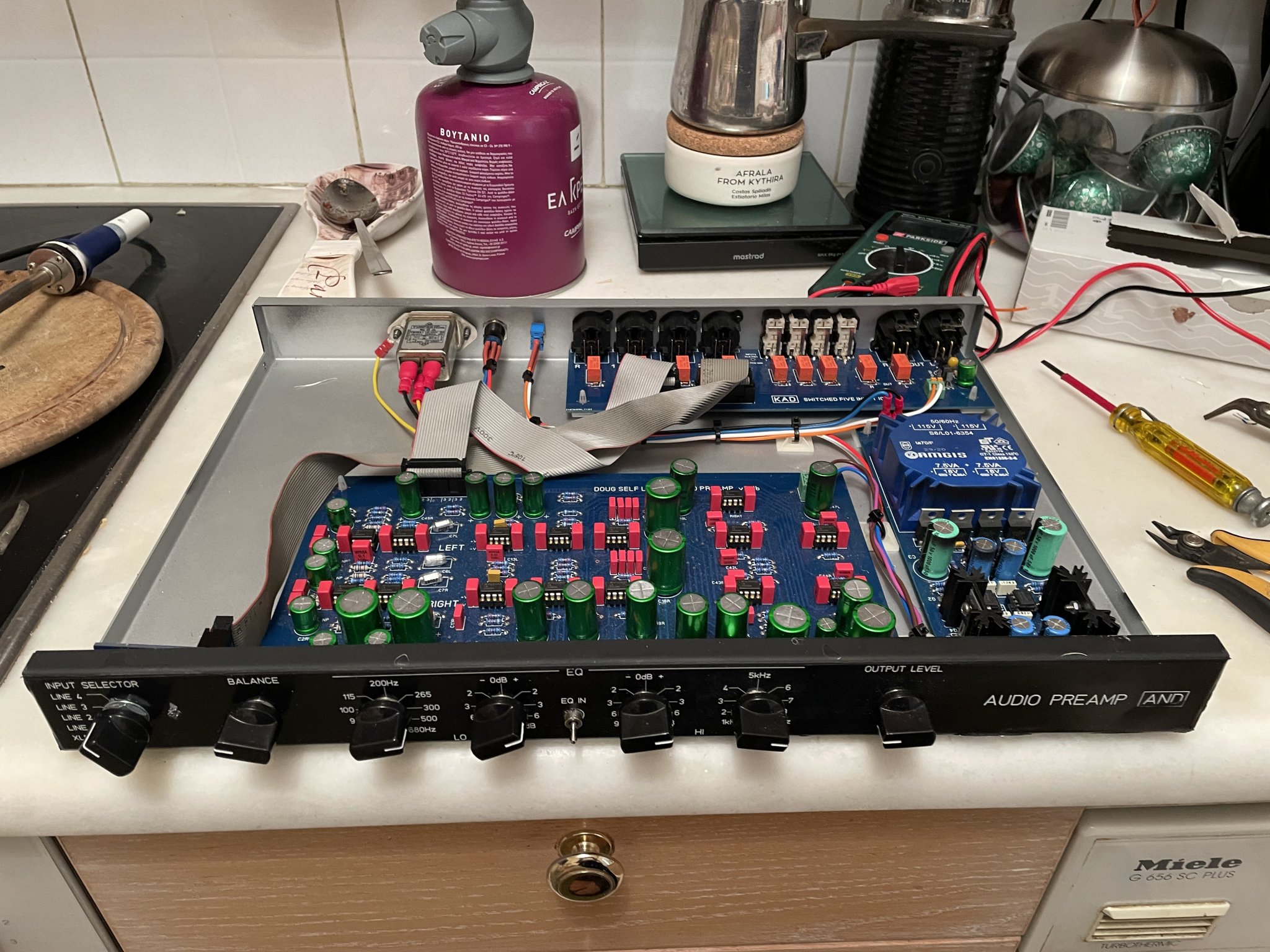

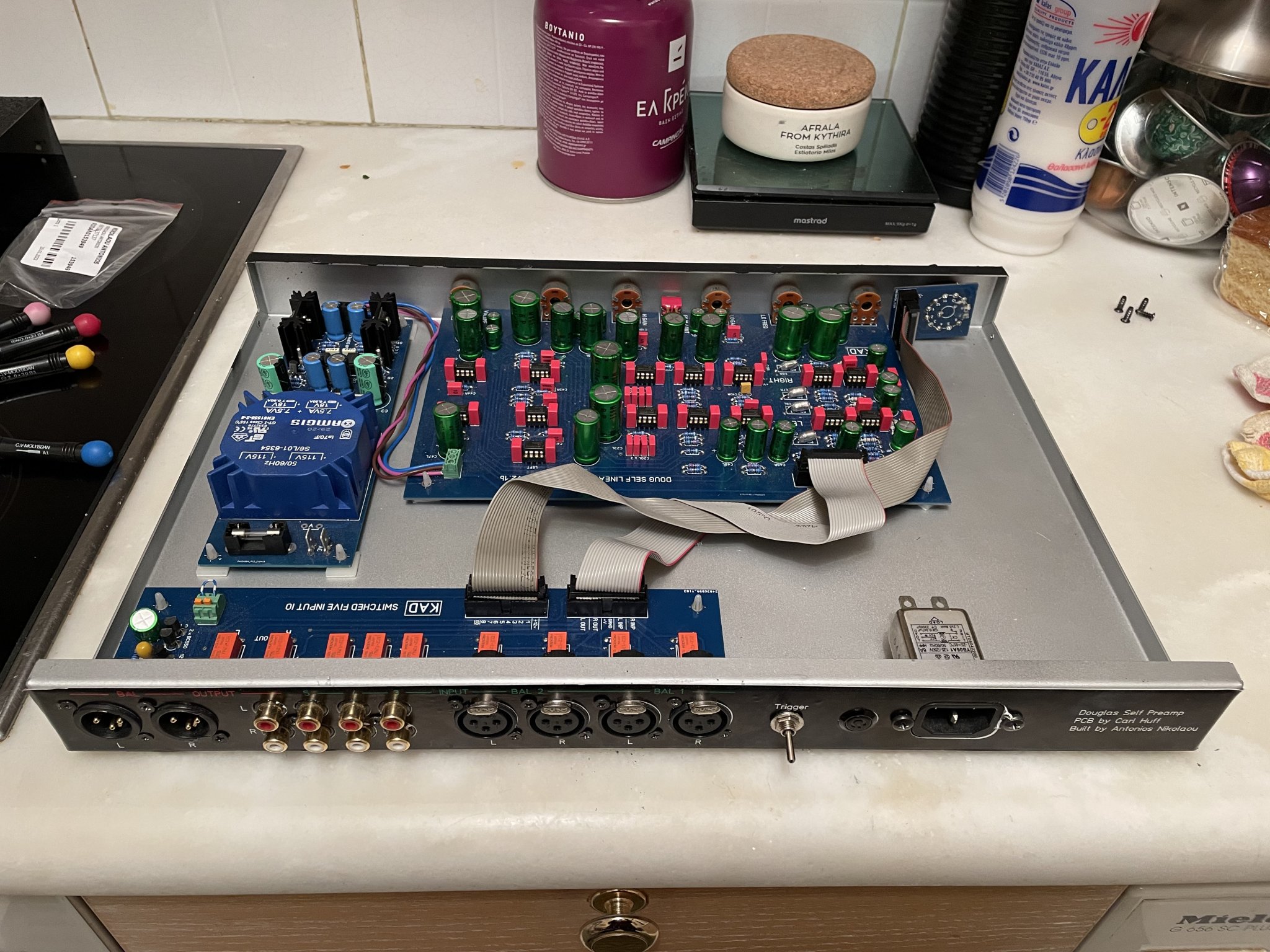

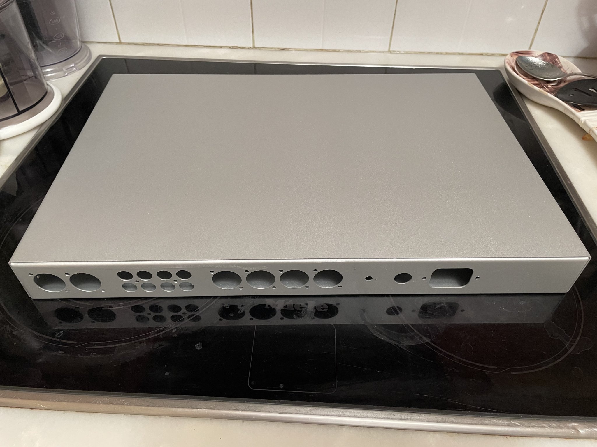

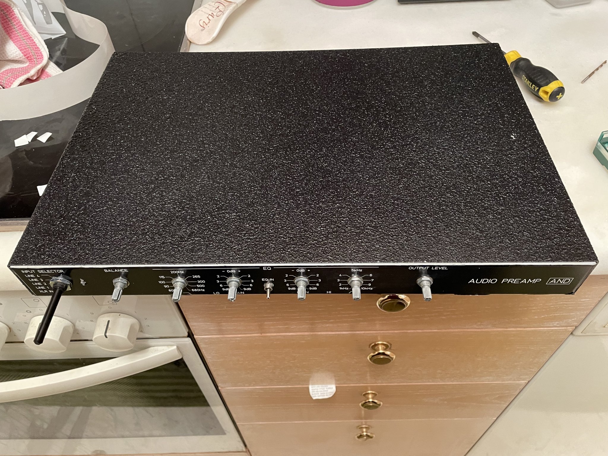

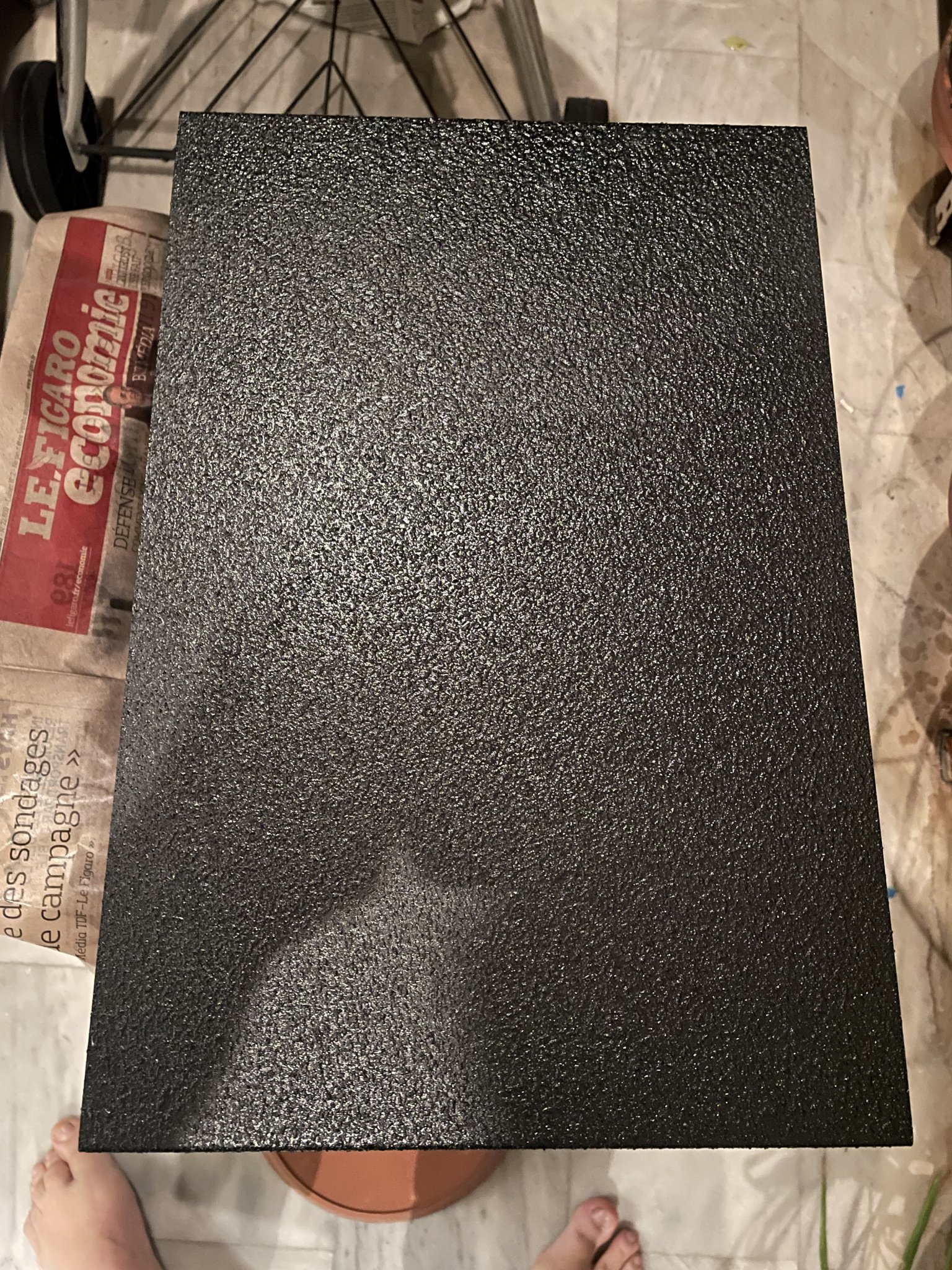

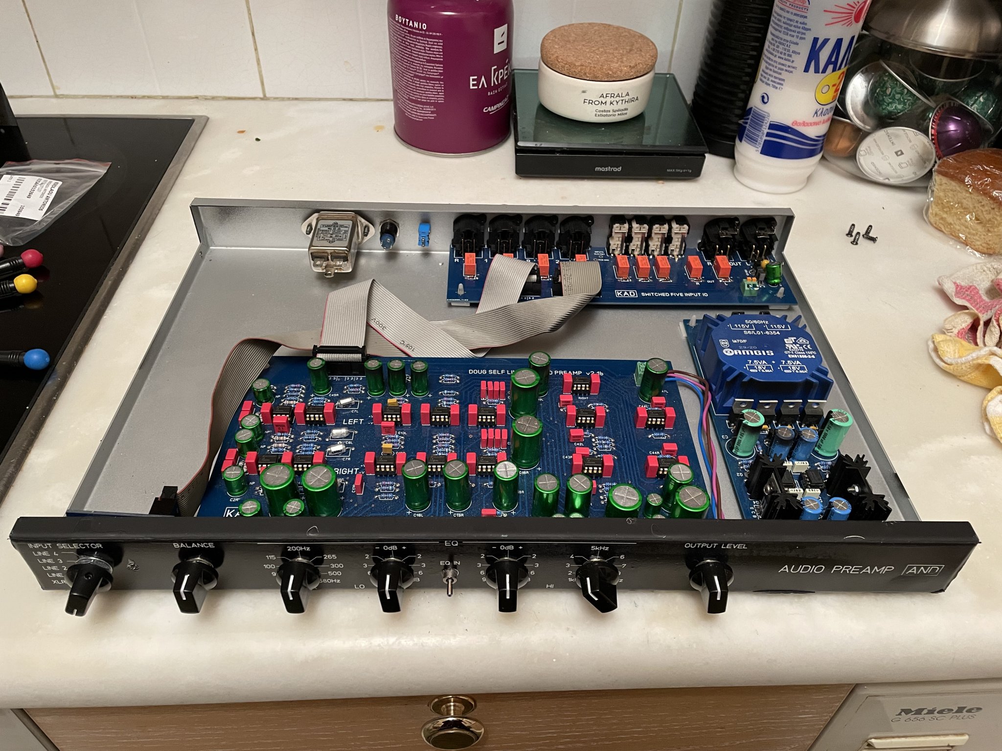

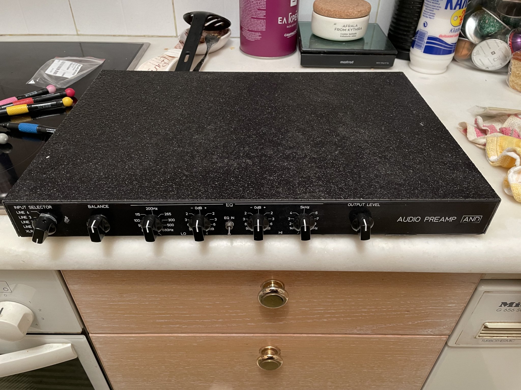

Here is the finished preamp. With the various stages to the end.

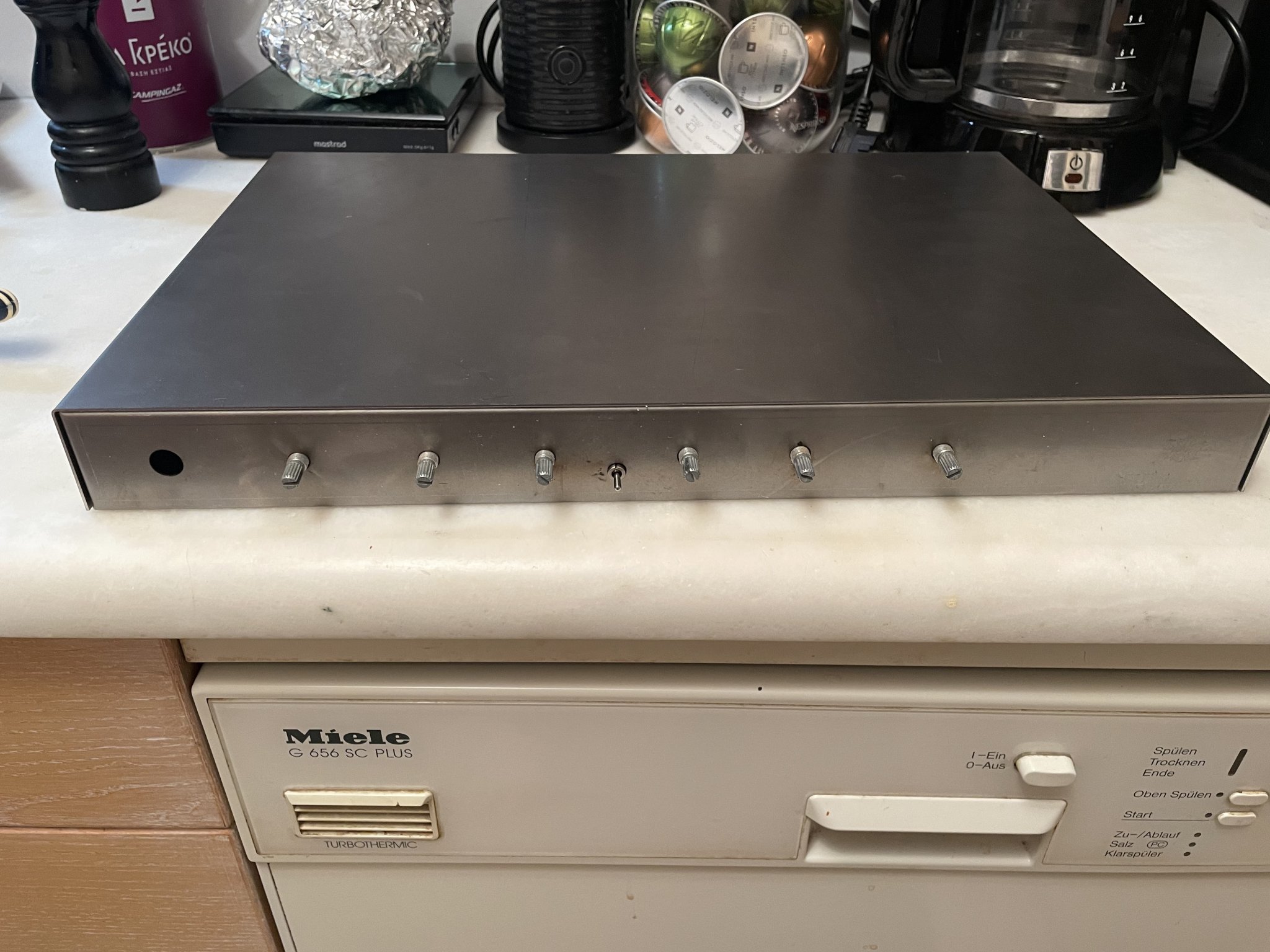

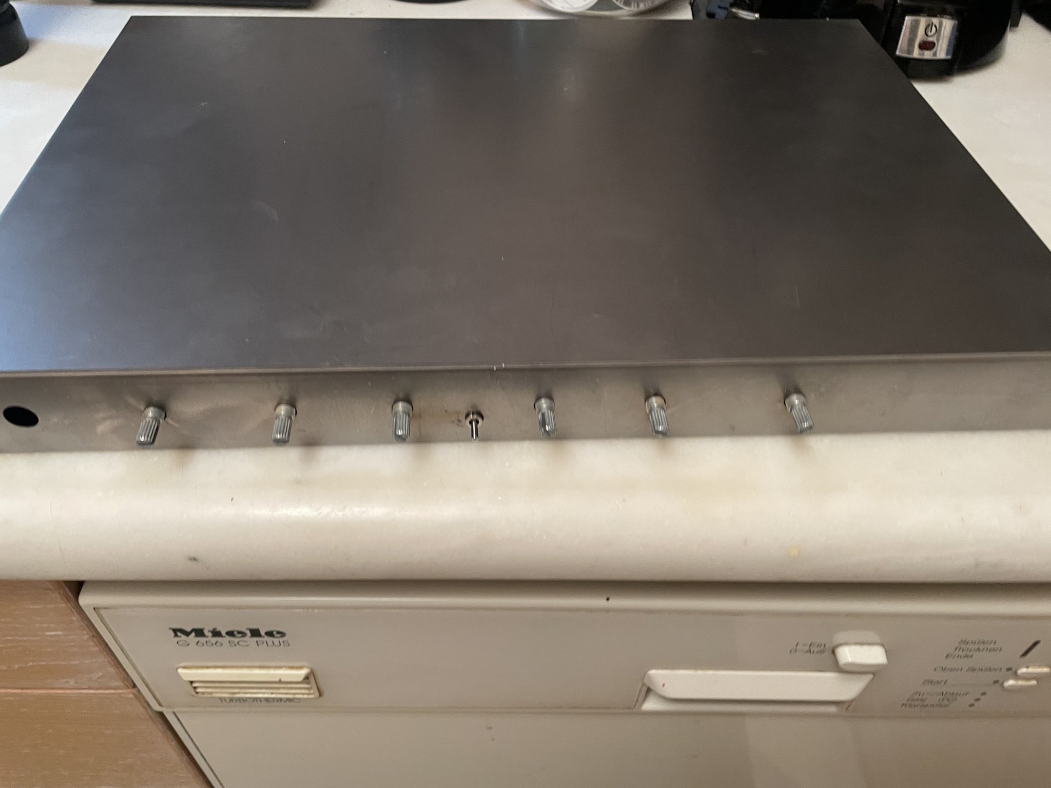

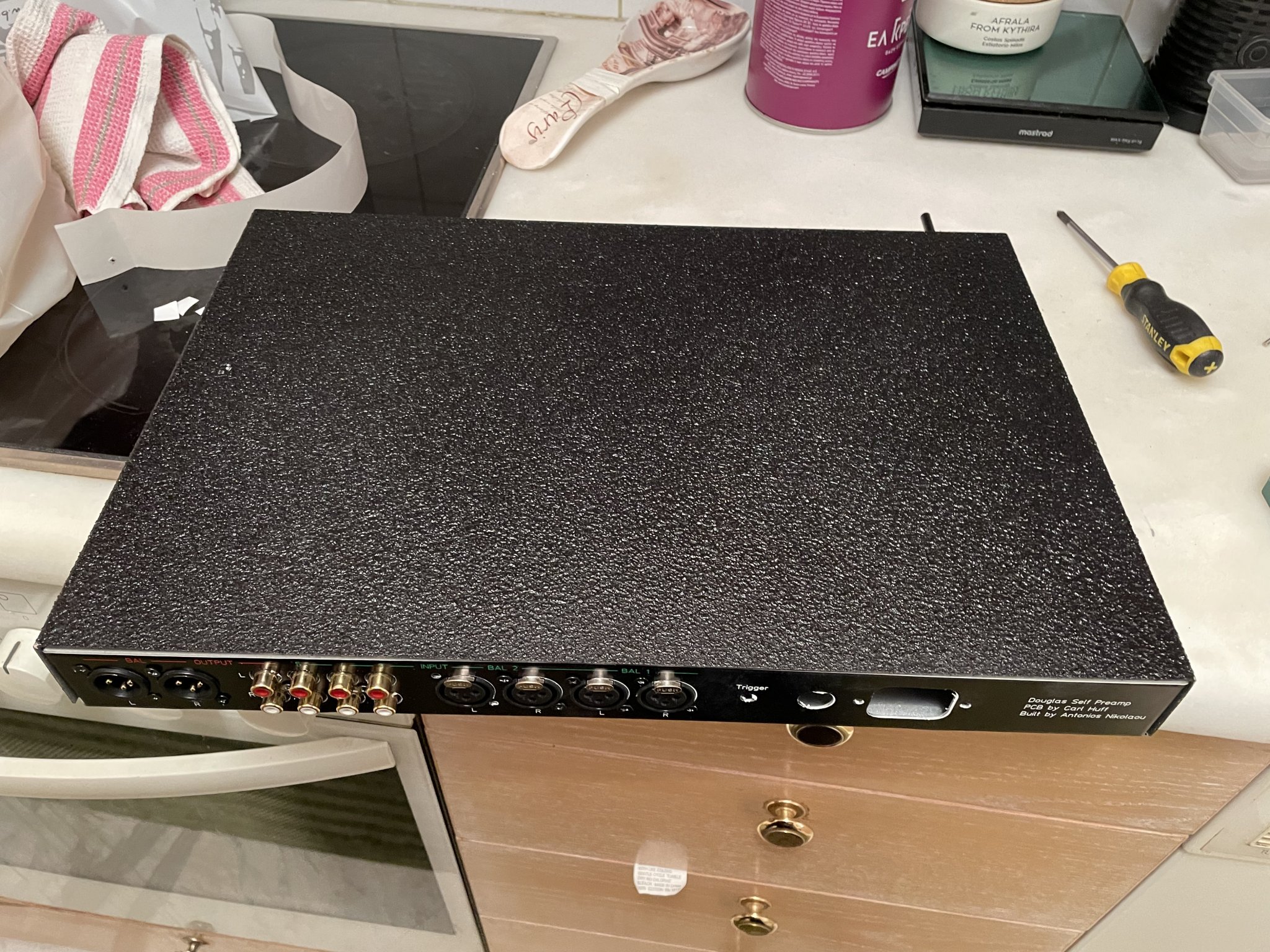

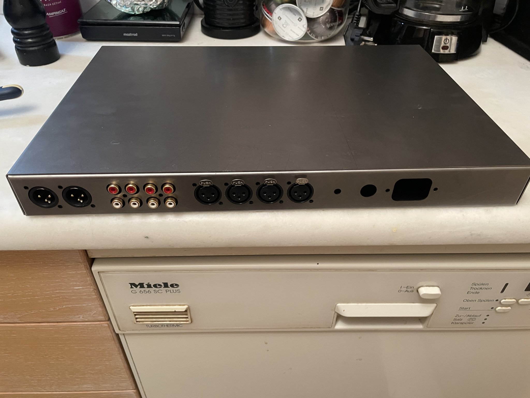

Awesome metal work 😍
What tools did you use for cutting etc.?
I'd recommend to place the mains inlet on the other side so that there's no need to cross the mains and audio lines...

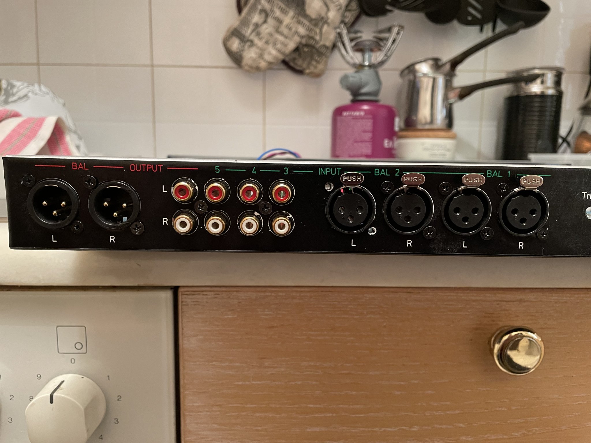

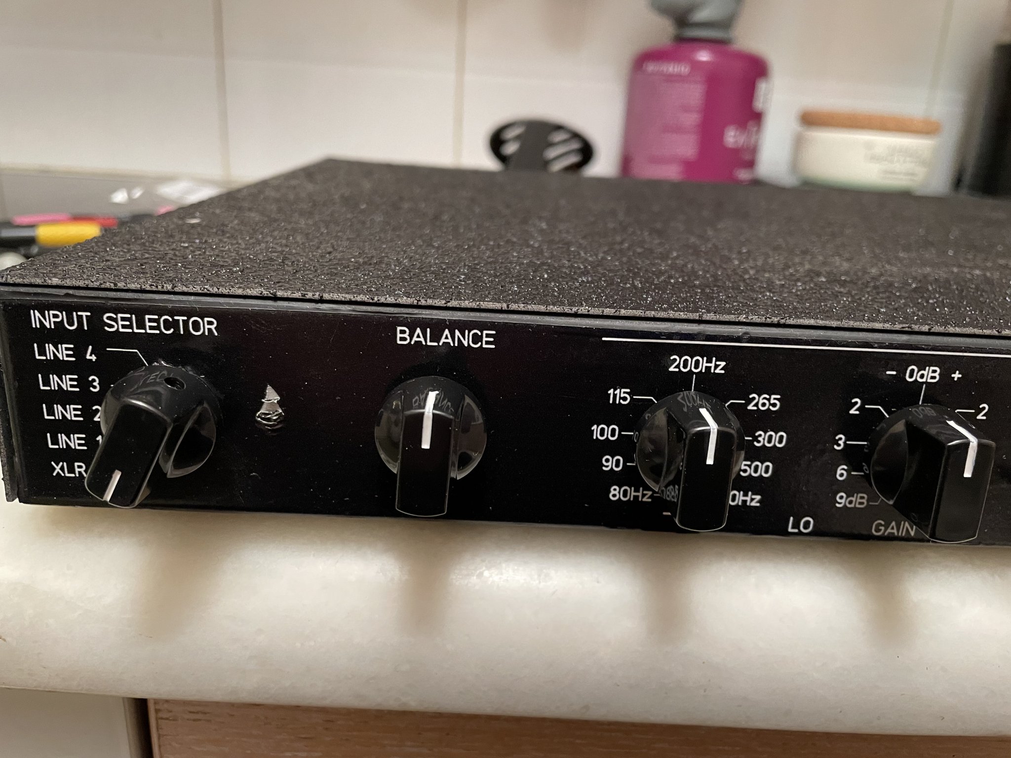

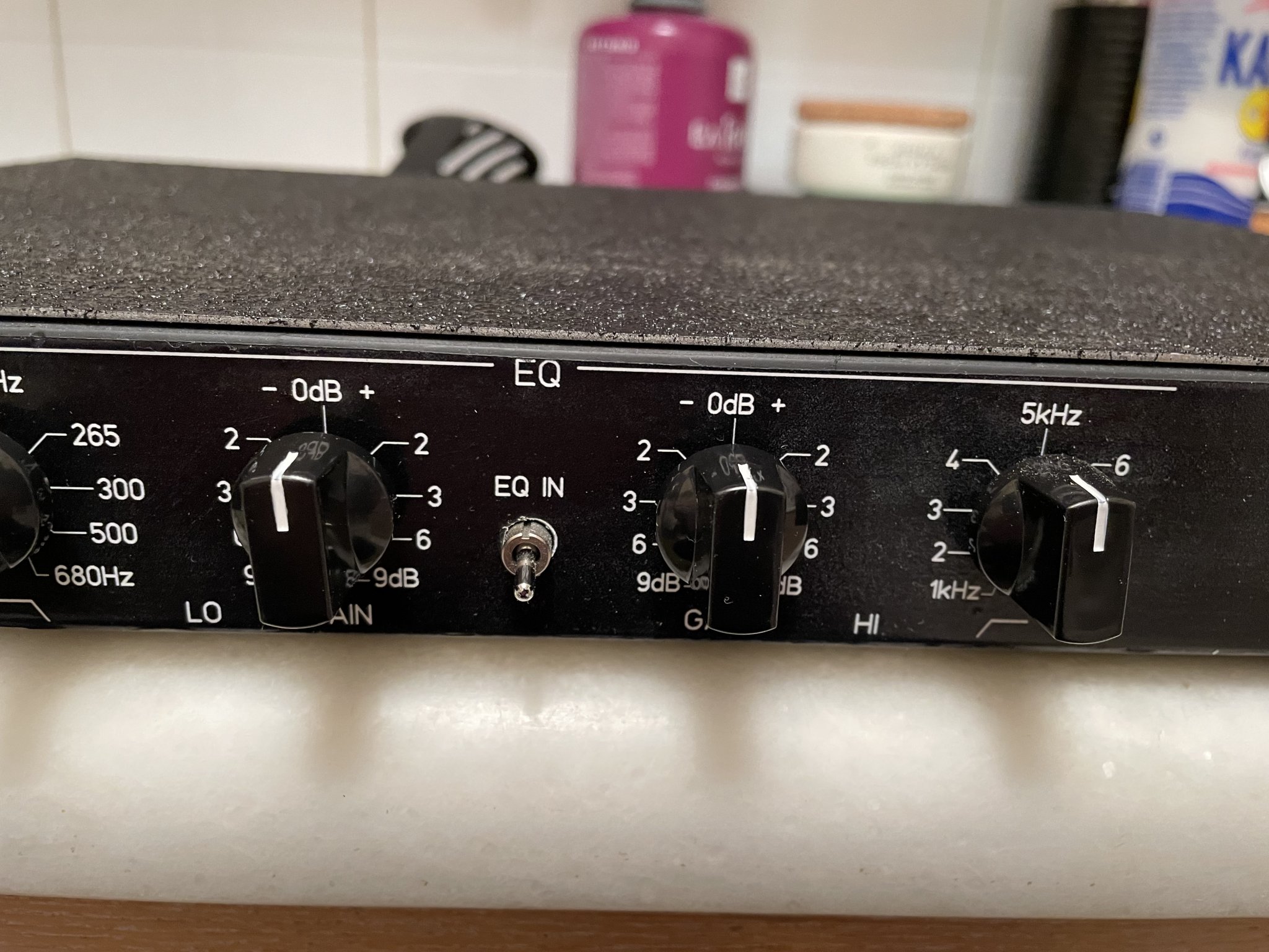

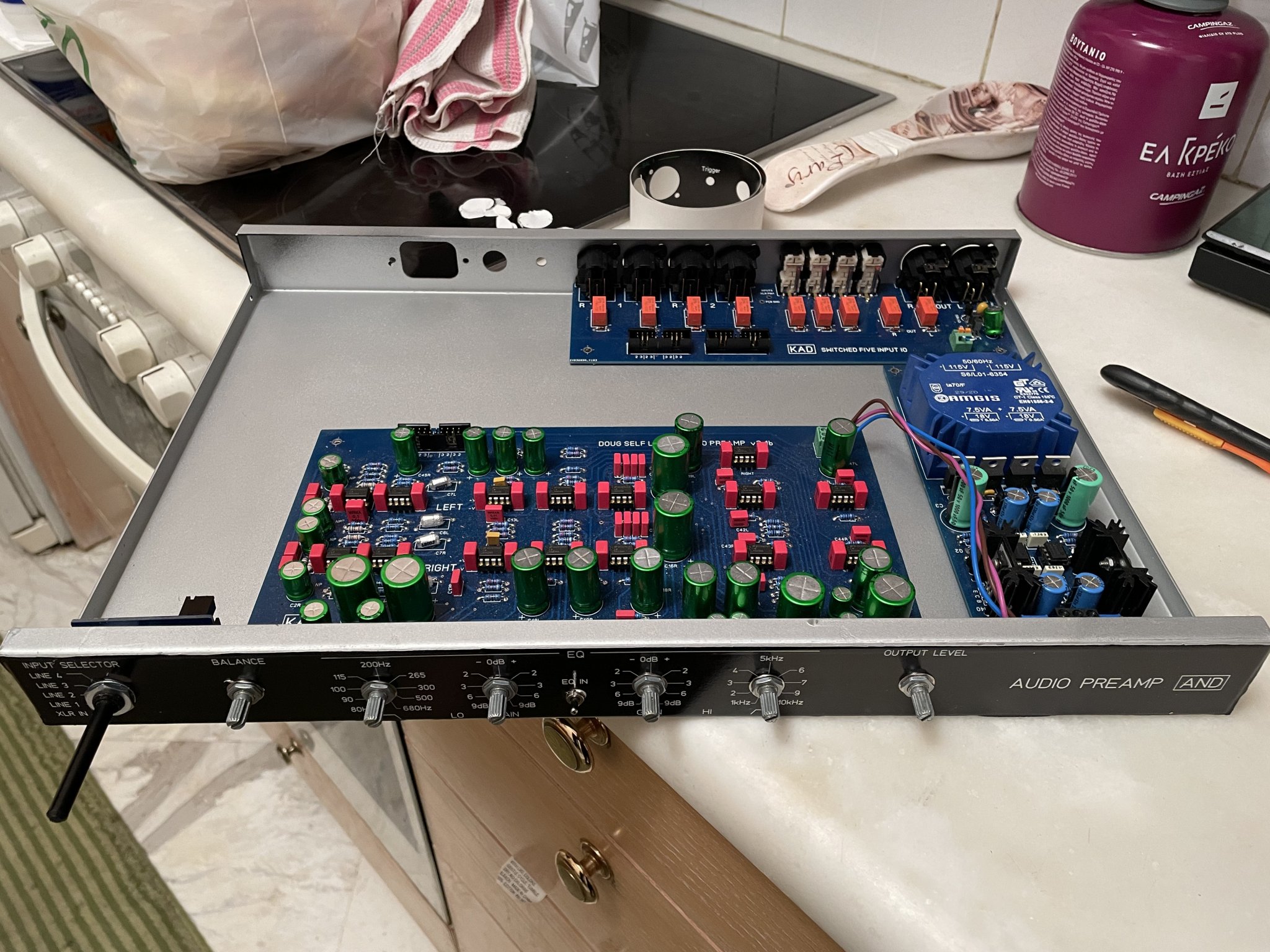

And then some more.

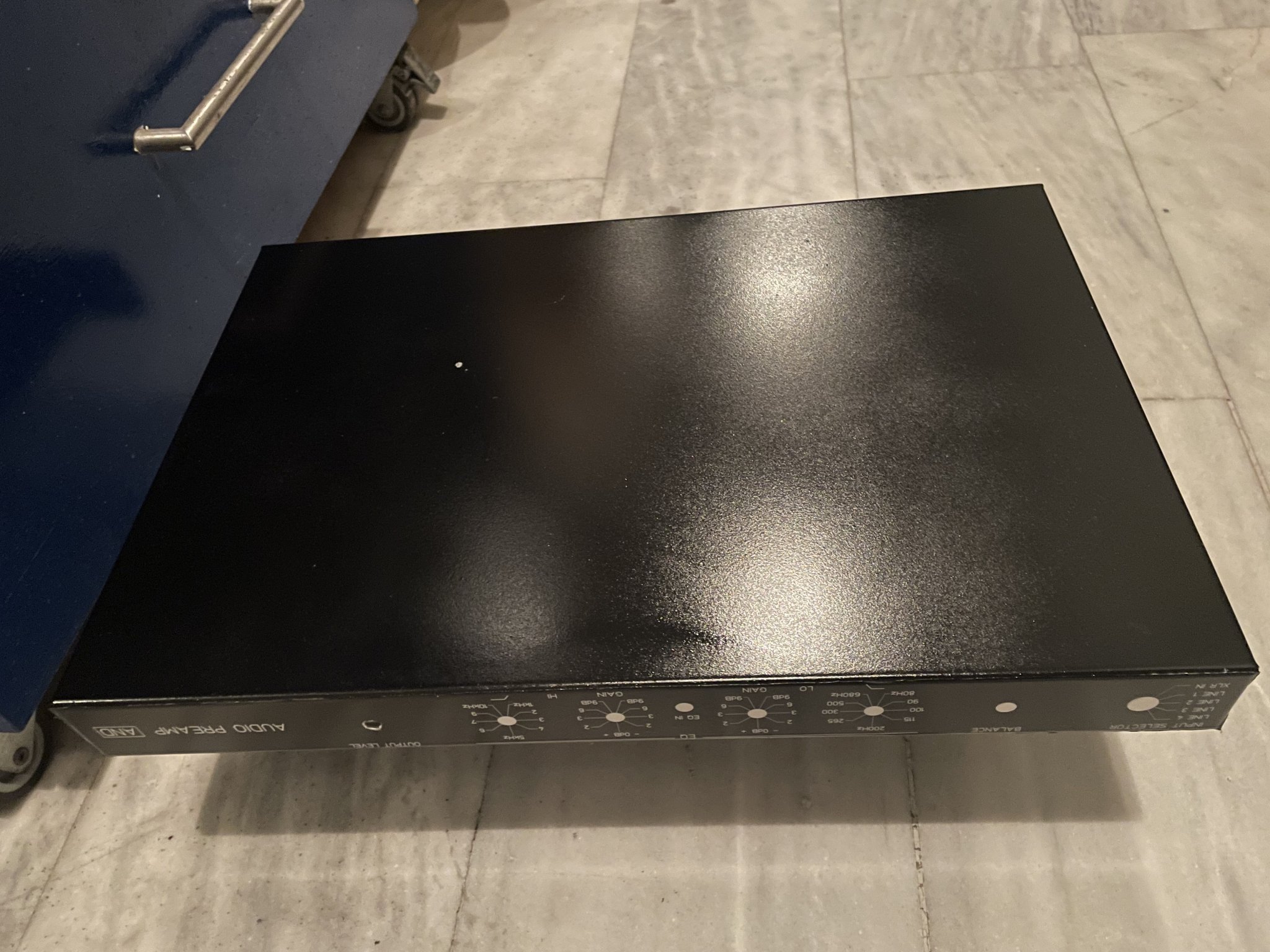

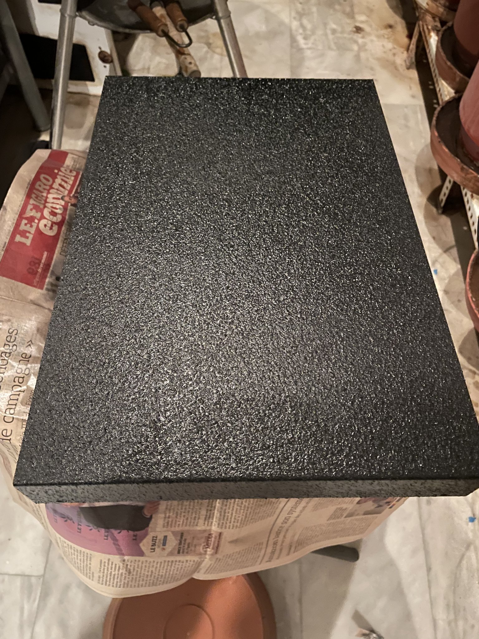

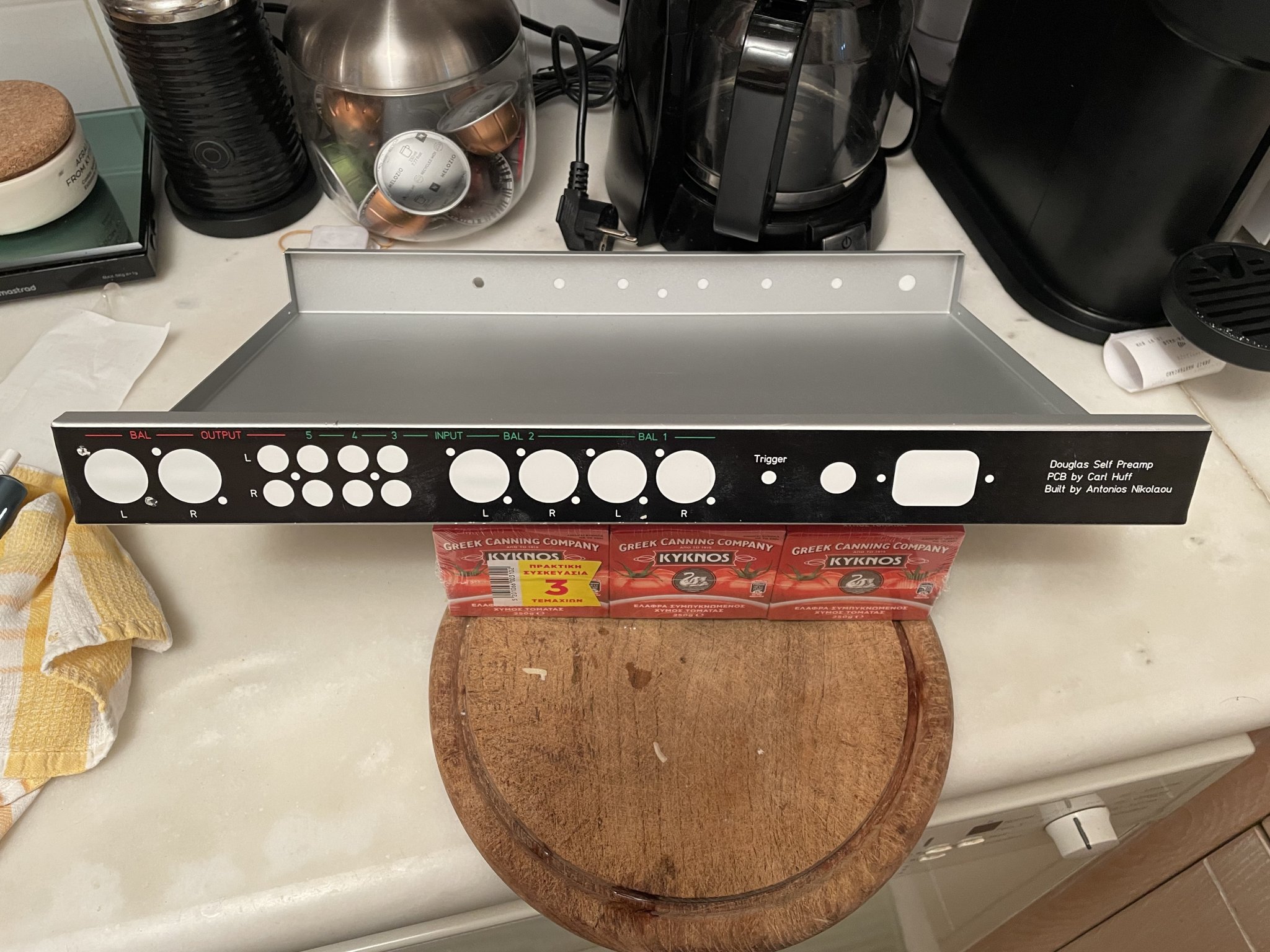

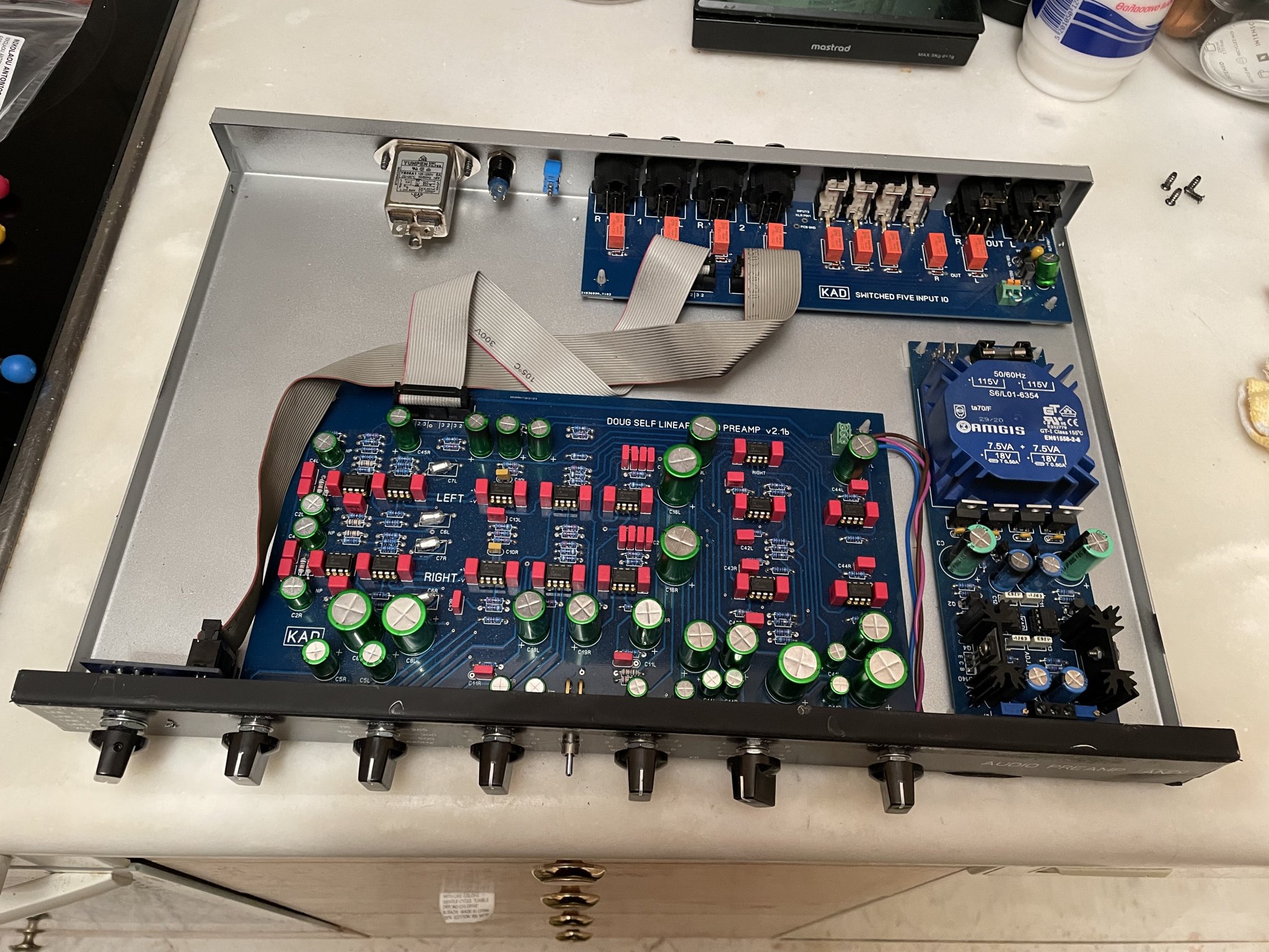

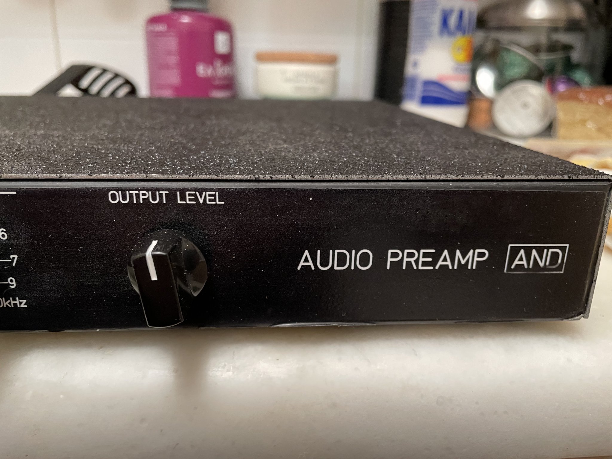

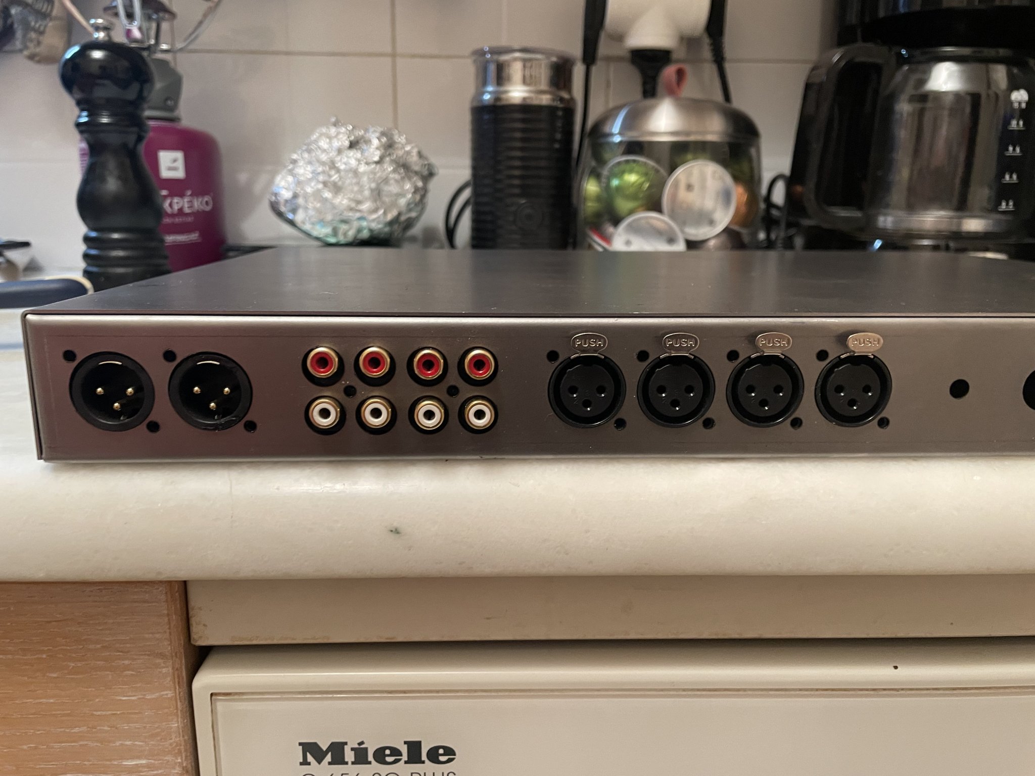

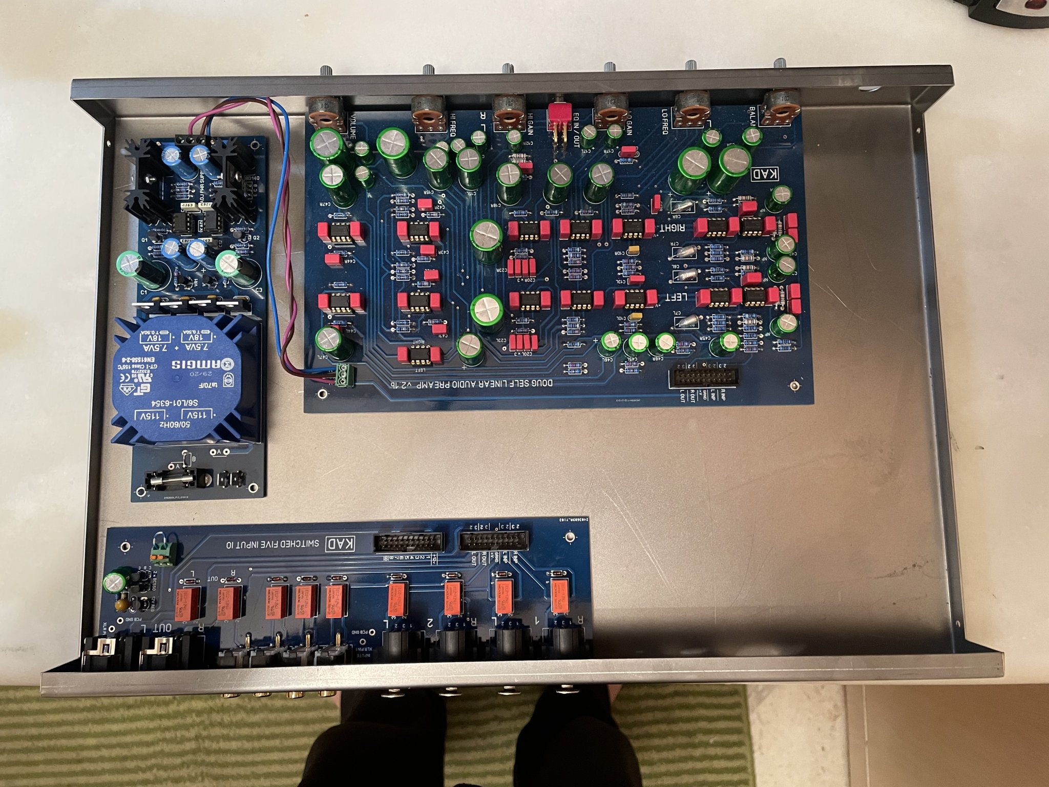

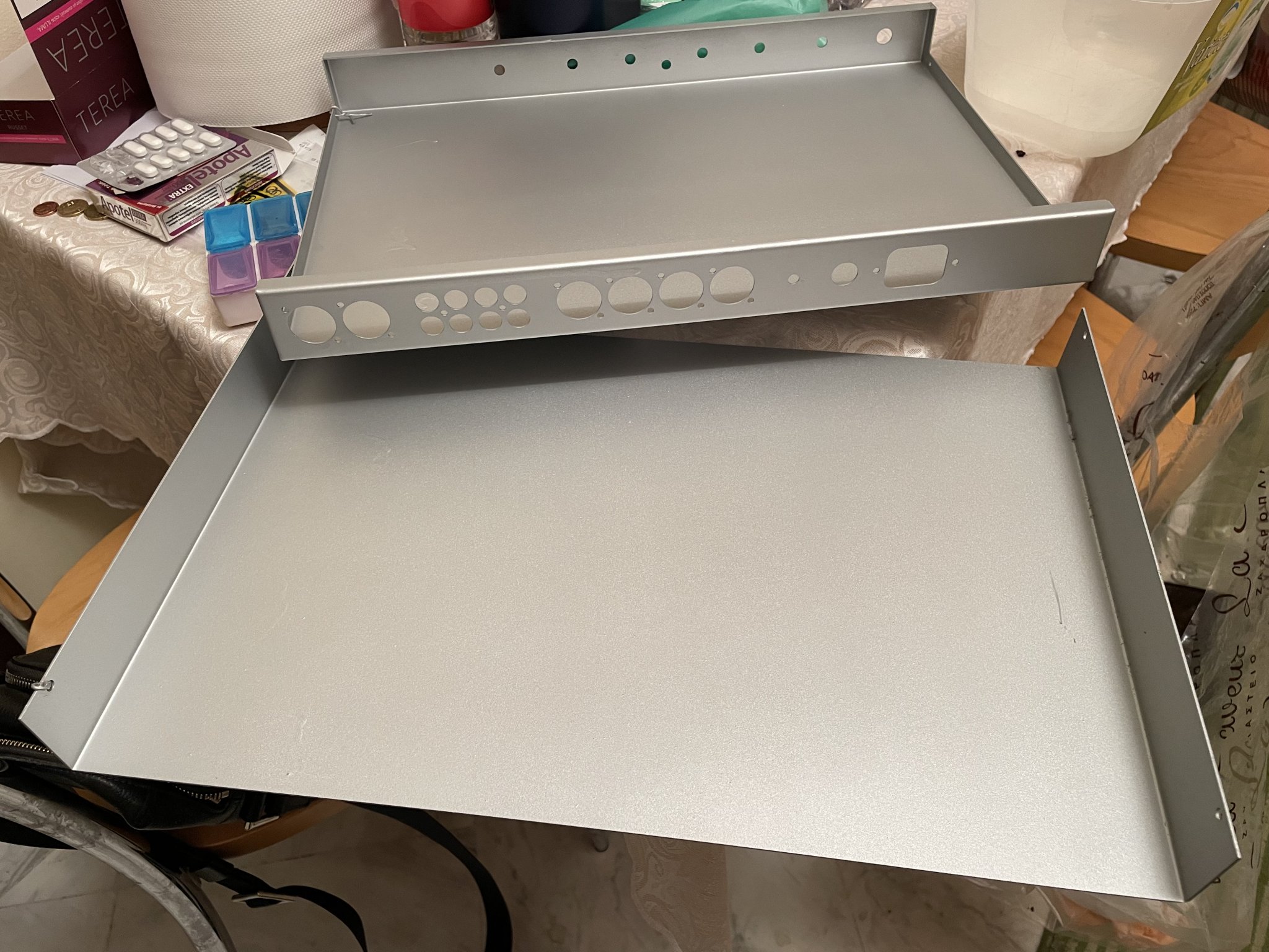

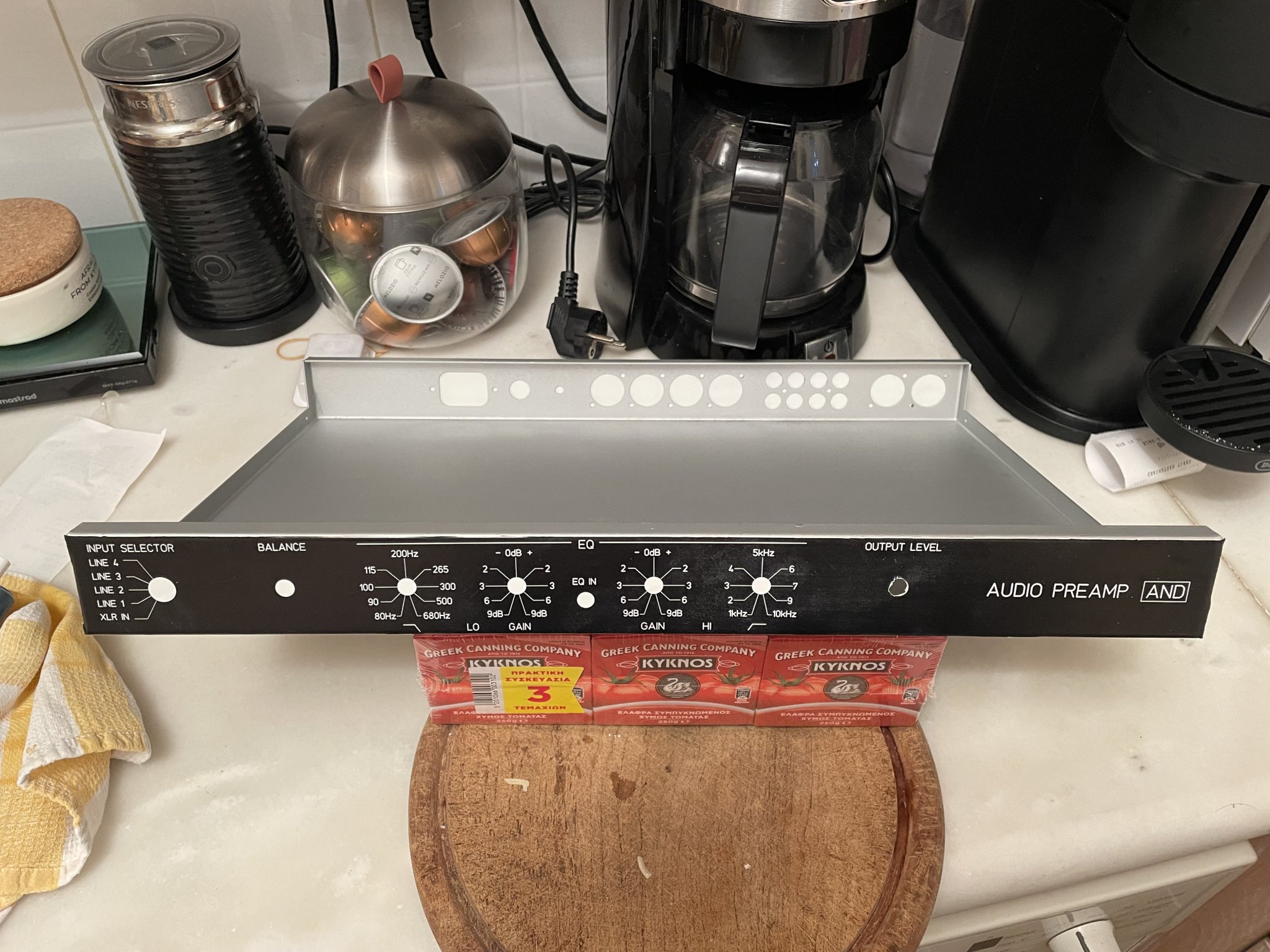

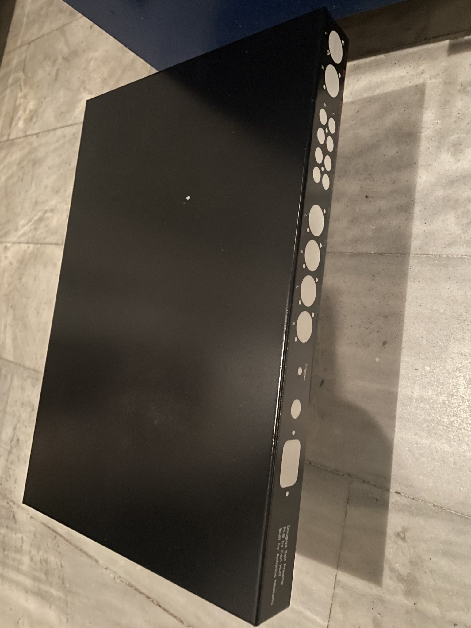

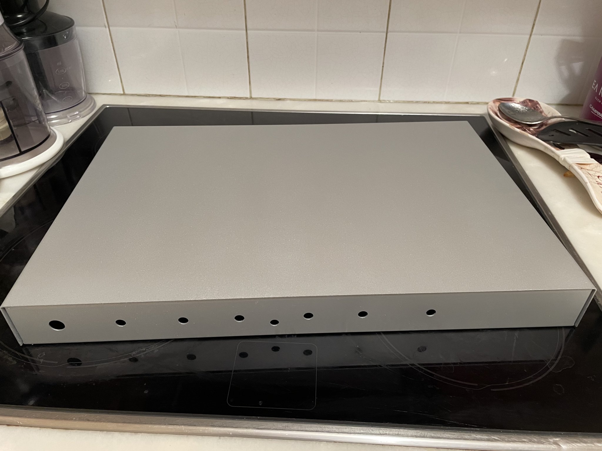

I made a template on AutoCAD with the files found in this thread and I designed an open box. Then I gave the plans to a friend that owns a laser cutting machine and another that bends the metal and he made it on two pieces. And here is the result.Awesome metal work 😍

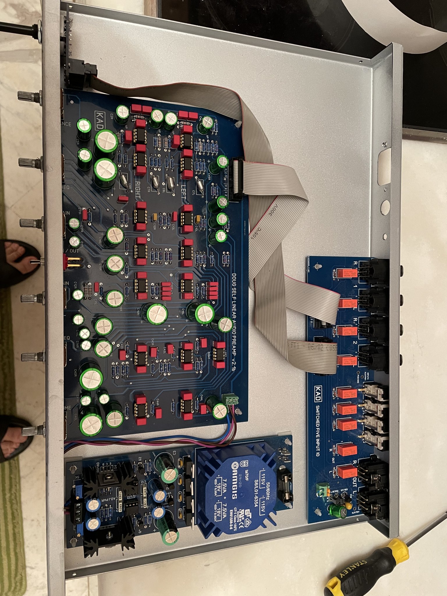

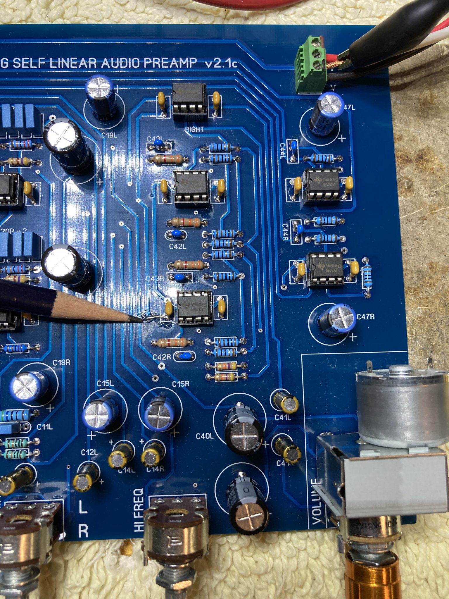

I finally got around to testing. I don't get any relay to work whilst rotating the selector switch. I certainly could have made some error(s) so I started to measure voltages.
While checking ICs for (+) (-) power this one has no negative (-) voltage supply. It seems I found a missing trace and so installed a jumper, shown. Now I have (-) volts to that IC.
However, I still have issues to troubleshoot (such as relays not switching) but before I go any further:
1. This board is a newer one to accept a remote volume control footprint. Has anyone built and tested their preamp with this particular board yet?
2. If in fact this board has not been built or tested, could there be other errors on it?
TomLang said,"If in fact this board has not been built or tested, could there be other errors on it?"
Tom it appears that you mistakenly got a 1st generation prototype board. I remember a trace missing, but no other mistakes. Sorry about that, as a rule we do not ship prototype boards to customers.
As to your relay problem, I suggest you check your front panel switch build. If you need anything please let me know.
