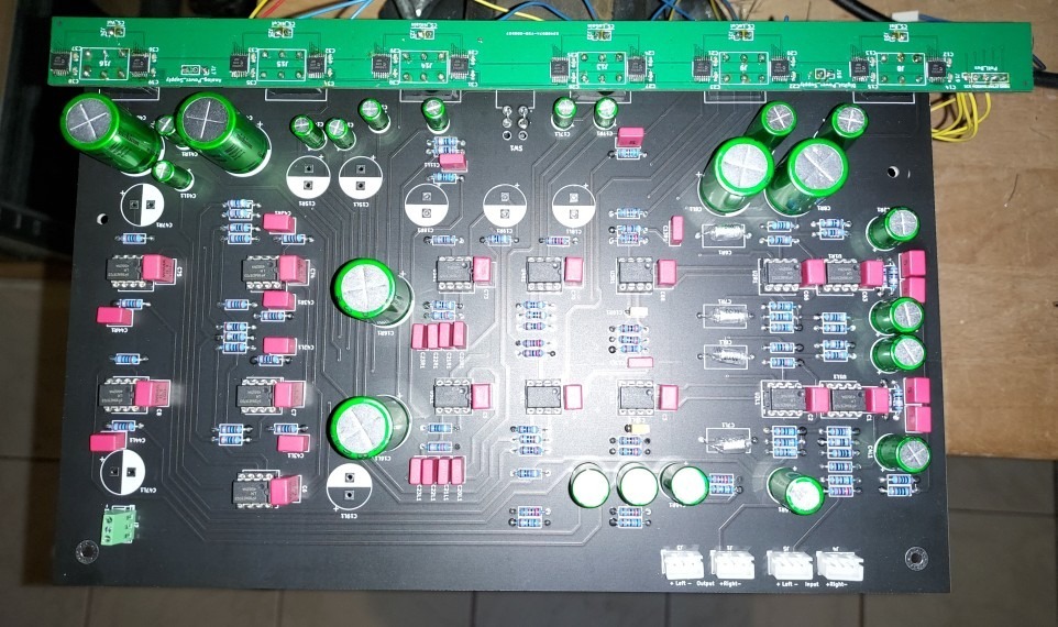

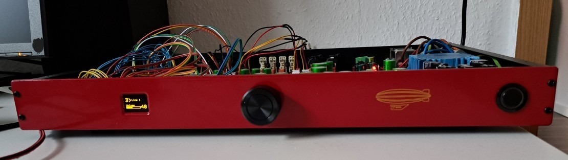

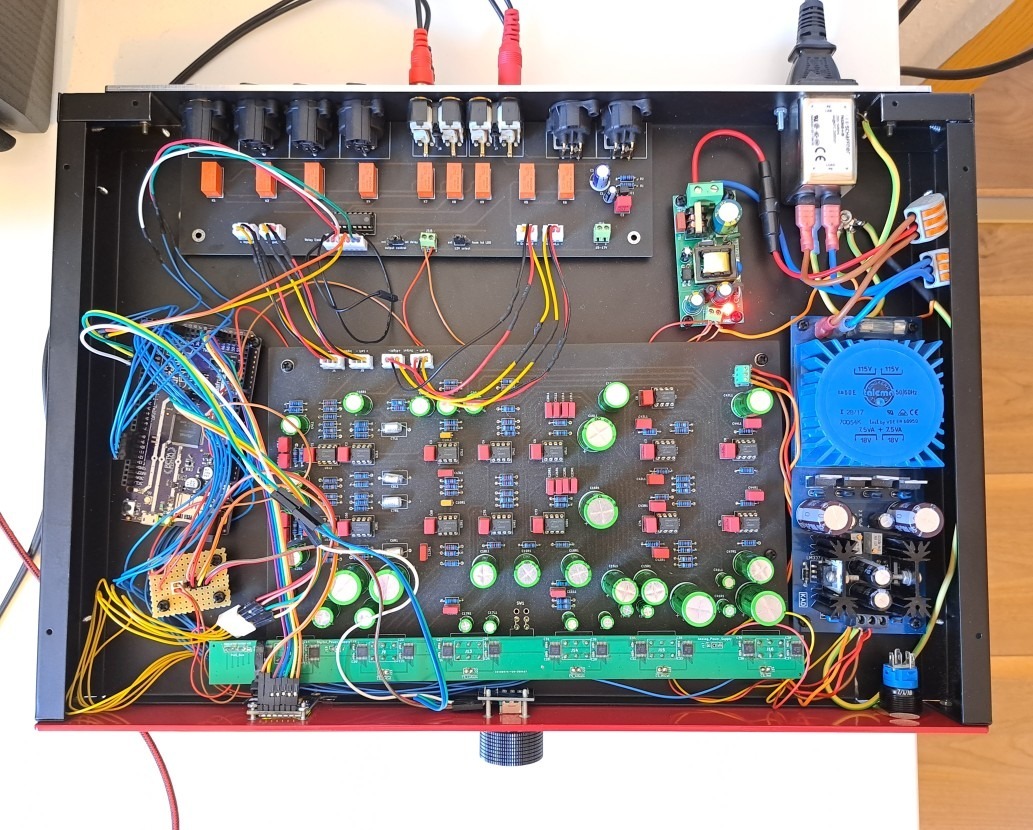

I like this design and looks like a nice upgrade to the preamp. Do you have design files and software available? I would like to add something like this to my preamp. Looks great!Inspired by the discussion here about an IR controllable version of this preamp, I have started again to think of possible solutions. I have had many ideas which I often discussed with @Carl_Huff (thank you, Carl, for your time - I wouldn't have come this far without your help). Most of the ideas were quickly discarded, and some made it to a design/routing phase. Finally, I implemented a concept which allowed me to re-use the preamp PCB and the +-15V supply PCB:
- I designed a PCB to hold MCP41HV51 digipots which fits exactly on the original preamp PCB as a replacement of the mechanical pots. Luckily, I had one of these PCBs already at hand from an earlier try

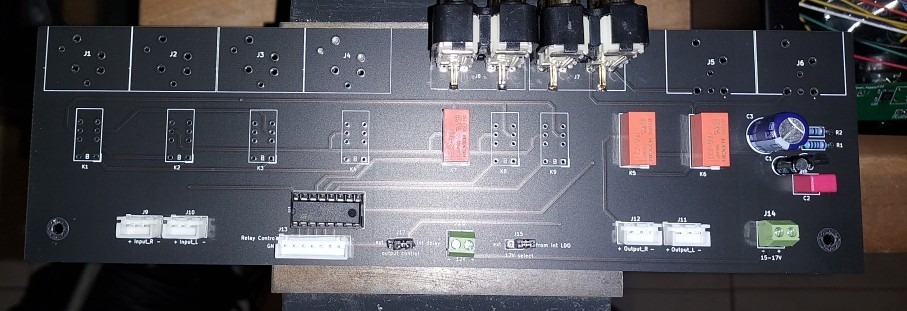

- The IO PCB needed a few modifications:
- separate grounds for audio/relays
- low side relay switching with an ULN2003
- updated 12V supply
- for my convenience: selectable relay supply (onboard/external) and selectable output delay control (onboard/external)
- As microcontroller I am finally using an Adafruit Grand Central M4 Express which can be programmed using the Arduino IDE and many of the Arduino libraries can be used, too. Originally, I had used an Arduino Mega 2560 which caused a lot of headache to me as it turned out to be the source of hizz in my setup.
- I added a small RGB OLED (small enough to fit into a 1U case) and a rotary encoder + switch.
- The digital stuff is powered by a small 5V SMPS.
Some impressions:
Front:
Digipots:
Modified IO board:
Everything combined:

So far, I haven't done measurements yet but the preamp sounds good to me (=without audible noise/distortions) which is my primary goal. Nevertheless, there are things left to be done which I will follow up step by step:
I have a readily designed zero crossing detection circuit and all the parts for it at hand. But after listening tests, I am no longer planning to implement measures against zipper noise as there just isn't any that I could hear.
- Implement the IR control which I had honestly forgotten when designing the front panel
- Implement using the big standby switch
- Cable cleanup
- Implement NVM storage of settings
Any hints/suggestions/questions are always welcome!
