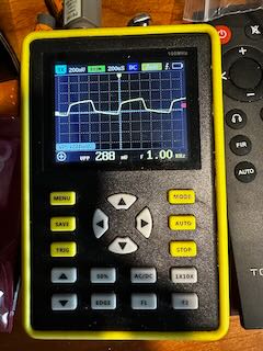

This is what my scope shows at the output of A2.

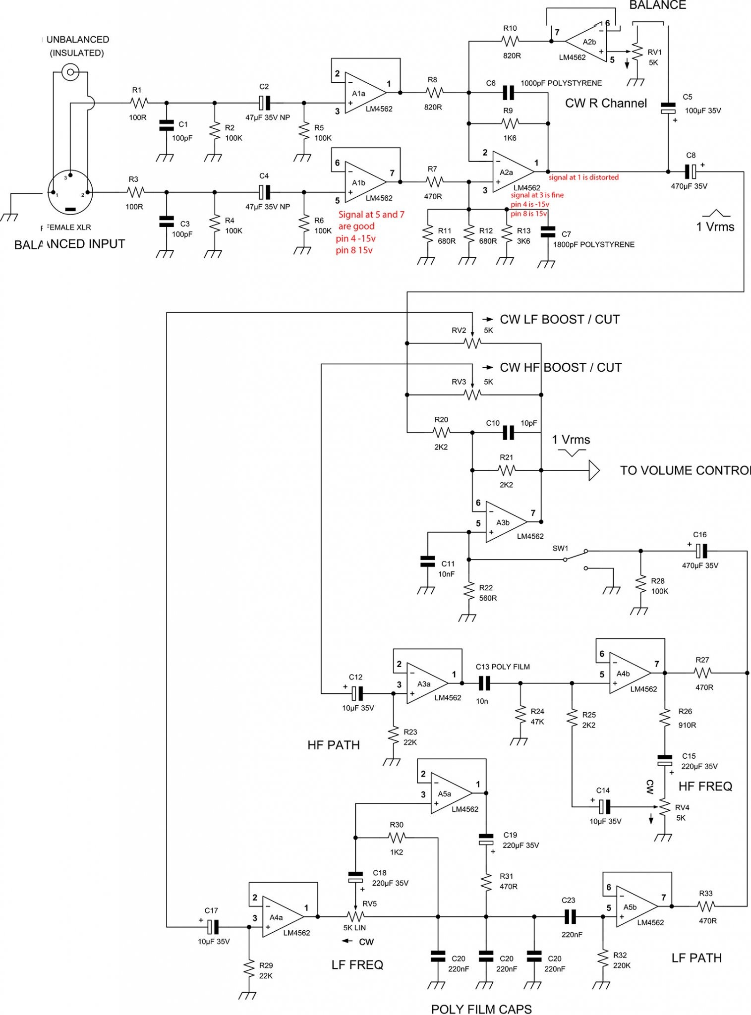

Everything seems to be -15 on pin 4 and +15 on pin 8. I don't think it is a scope issue though I am no expert. If I use the auto feature it still shows a waveform that is clipped. While I don't really understand this circuit I assuming the op amp A2 is connected to the balance pot as the wave form changes when turning the pot. But no matter what comes out distorted.

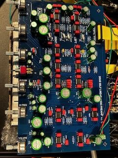

For what it is worth I have attached an image of the pre-amp board.

Yes, in particular the DC at A2a pin 1 is an important clue. Measure it with no signal (input shorted).
Can you post a close up of the scope screen, so we can see the scale settings.
It is important to see whether the signal is clipped (close to the 15V limit), or whether the signal is low and distorted.

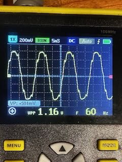

Thanks for everyone's help. The dc voltage is correct on 4 and 8 getting 15v- and 15v+. On the other pins with no signal there is anywhere from .3 to .6 mv. I will attach an image of the scope on A2a pin1 with no signal. By input shorted do you mean short the inputs at the op amp itself? I did not do that.

You really have to learn to read a scope. I can't see the hor scale, does it say 5mS or 5uS?
If 5mS, it looks like mains hum, also there's a legend '60Hz' below. Are you in a 60Hz mains country?
So then this is hum, 600mV peak. This is a different issue than the distorted signal you showed before (I think, again, hard to read the scope).
I would disregard this, and focus on the main issue of the distortion.

In the top of the last picture it says: 200mV - that's the vertical scale, voltage per division, and 5mS - the hor scale, 5mS per division.
The reciprocal of the hor scale is frequency.

Look at your circuit you attached. You say the signal at pin 3 of A2 is fine. Let's go back to that (recheck it) and also confirm again that pin 1 of A2 is distorted. @jan.didden makes a good point on scope use. Use a decent input level of say 1 volt peak to peak at 1kHz.
Are you using the unbalanced RCA input? If you are then you should have no signal on opamp A1 pins 1, 2 and 3. Check.
With RV1 (balance) turned so the wiper is grounded you should see no signal on pins 6 and 7 of A2b. Check.

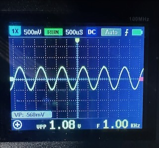

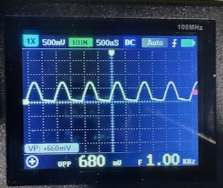

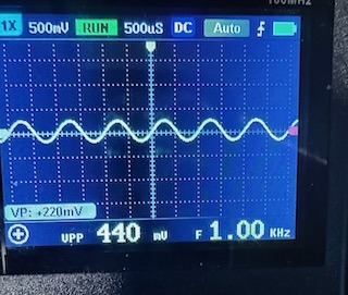

Here are some updated pictures hopefully more clear with descriptions
1v 1khz signal going into pin 5 of a1b---this remains the same at the output, pin 7 of a1b
signal at pin3 of A2

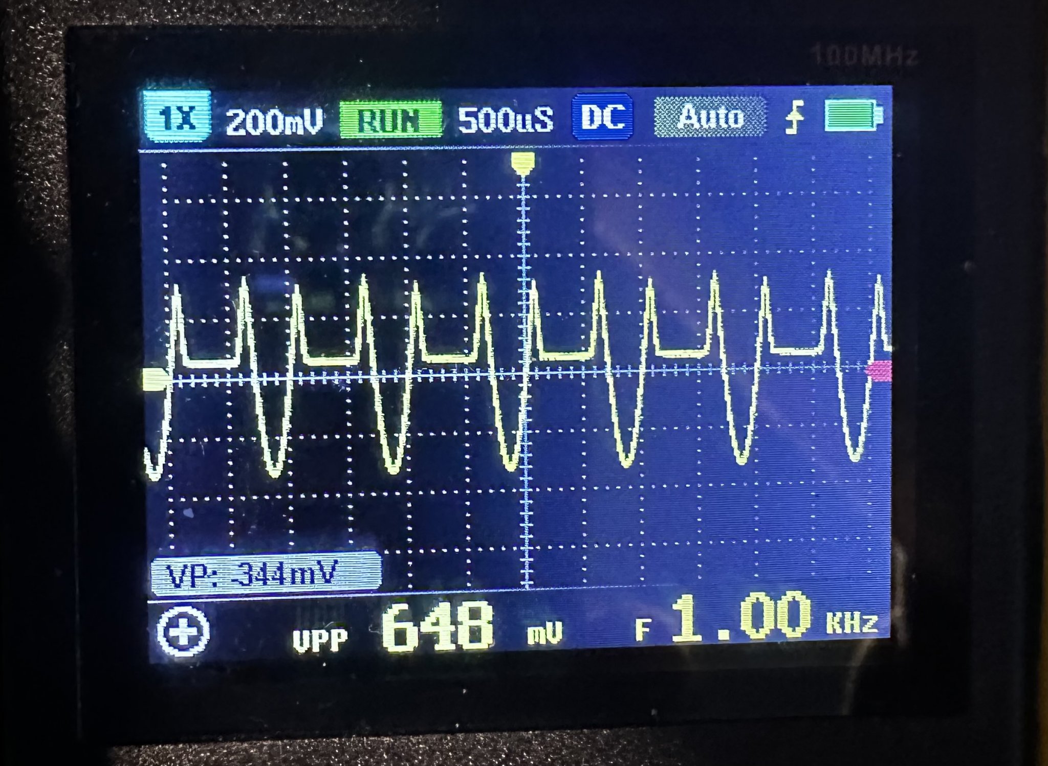

signal at pin1 of a2-----is it supposed to do this?
Last is signaificant. Is there DC at that pin? Measure DC with input set to zero.
To try to isolate the cause, can you remove opamps A3, A4 and A5 (assuming they are on a socket?), how does the signal look then?
Also, the -15 at pin 4 of A2 - did you measure that at the actual pin on the opamp body? Absence of that would explain this too.

At this point I would go with Jan's suspicion of a missing rail causing that severe negative clipping. Measure on the pin itself.
If that turns out to be OK then we are looking for something really odd. Could there be a short to 'something' on the output side of caps C5 and C8? Something that behaves like a diode. You could try lifting one end of C8 and then C5 and seeing if the signal is then normal on pin1
