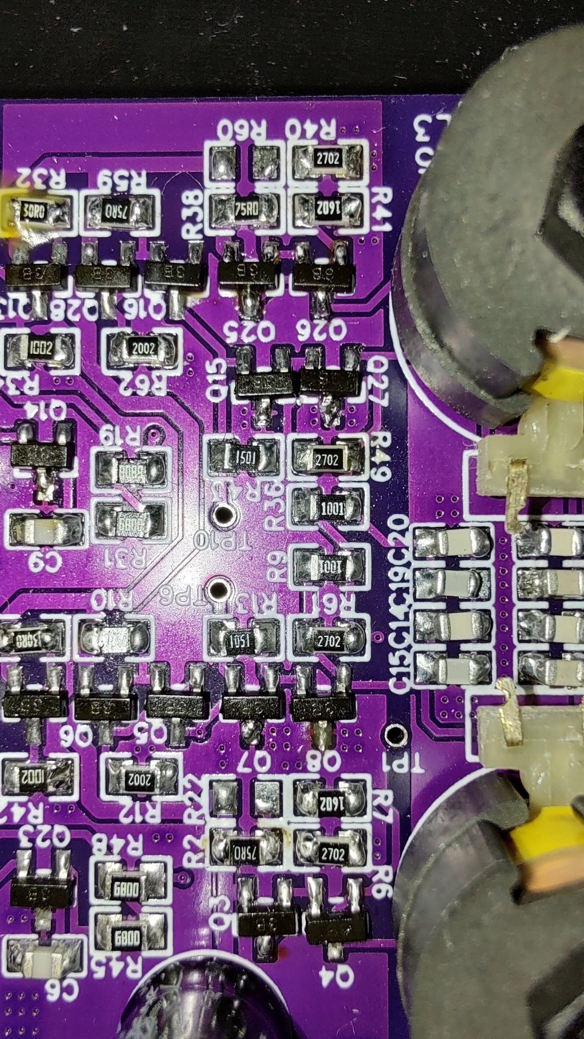

It looks to me like you did have a problem with TP10 - hence with Q27 and Q15 and closely related components. But now you've fitted the inductors whatever issue that was is masked. But its possible that issue is the reason TP7 is now so low. Would you be able to take a picture of your board to include those transistors Q27, Q15 and the I/V resistors R49 & R36?
Hi,It looks to me like you did have a problem with TP10 - hence with Q27 and Q15 and closely related components. But now you've fitted the inductors whatever issue that was is masked. But its possible that issue is the reason TP7 is now so low. Would you be able to take a picture of your board to include those transistors Q27, Q15 and the I/V resistors R49 & R36?
Pls. see attached photos.
Thanks - there looks to be something a bit strange about the soldering on Q27 collector (the bottom most pin of Q27). Maybe give it another visit with the iron?
Unrelated to your TP measurements, C19 right contact might not be making good connection to the pad. Looks like the pad didn't get wetted?
Will give those joints a quick once over and see if that fixes it. Will let u know how it goes. Many thx for looking into it.Thanks - there looks to be something a bit strange about the soldering on Q27 collector (the bottom most pin of Q27). Maybe give it another visit with the iron?

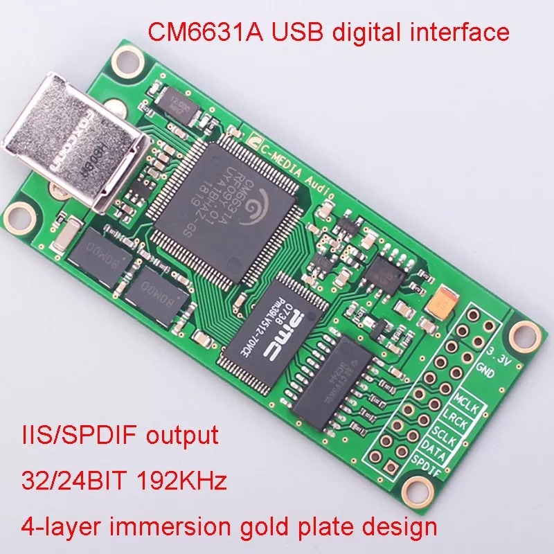

I want to ask you if anyone has compared the sound of Dorati and PhiDAC hex 2020, 7th order filter. I have it working for a long time. It worked without problems. The photo shows a usb digital interface. At that time I bought a used Sony WM1Z. I did a mod replacing capacitors, wires and removed the output relay. Changed the software. I use it with headphones and also with Hugh R. Dean's Saksa85 power amplifier. PhiDAC is in a drawer. I plan to make a non-portable dac version for the Saksa85. I will either use PhiDAC hex or order Dorati. Thanks everyone for your help.
Hi Peter - while I haven't listened to Phi hex side by side with Dorati, I might be able to give you some indication of the difference. The 'hex' was designed before I realized how important low noise was in an I/V stage so it doesn't have the acoustic 'bloom' that my later DAC designs have. However the 7th order filter (compared to Dorati's 3rd order) means that on close-miked piano for example the instrumental timbre is more true to life.
Incidentally, 'hex' could be upgraded to give lower noise through some component changes in the output stages. If you're interested in how to do that, shout. For a start the AD829 can be swapped to LT1028. This isn't a direct substitution though, it needs a small change to the circuitry. AD744 can be swapped for a lower noise JFET such as OPA1641 along with some component value changes to take advantage of the 1641's lower noise.

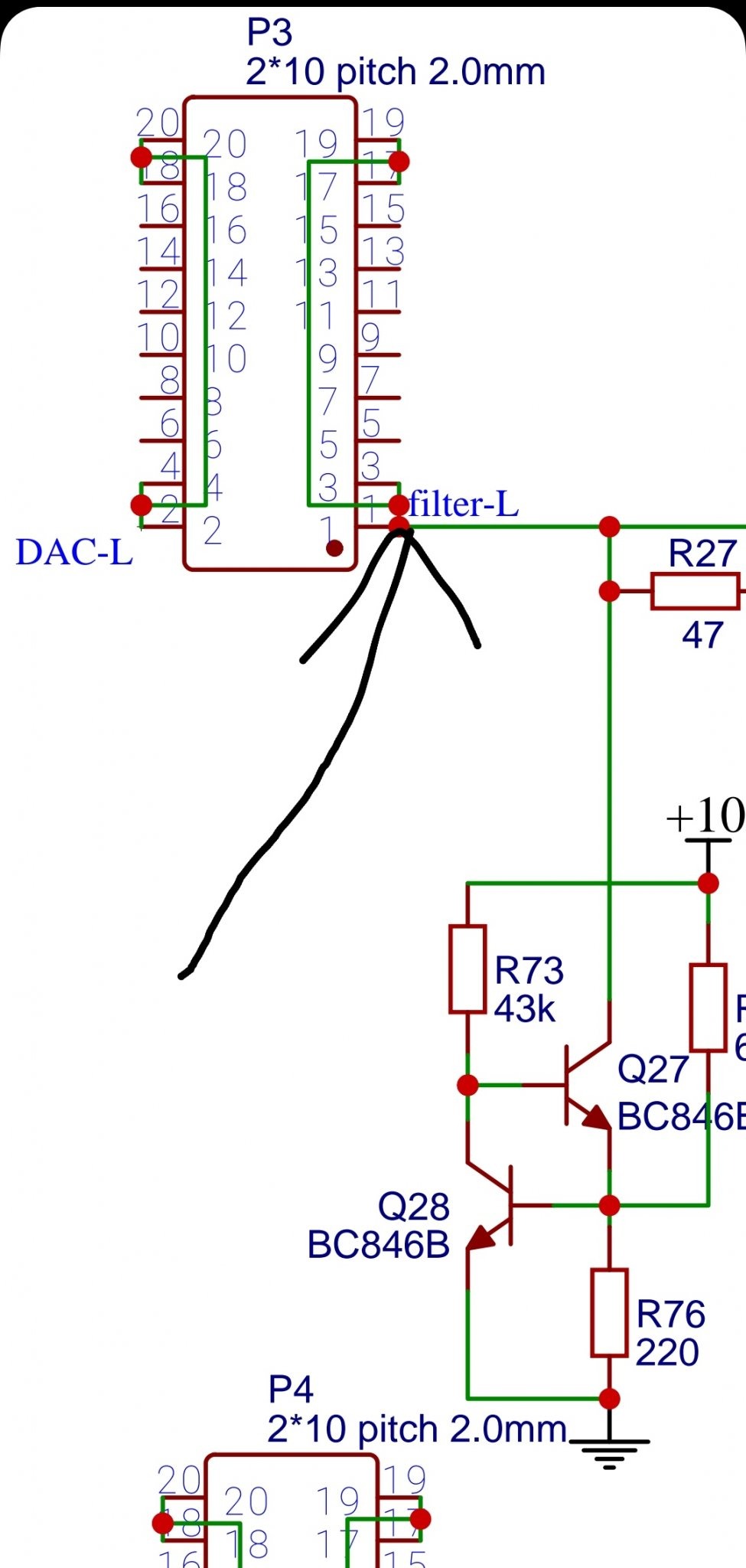

Thank you for your response. I made a class A headphone amplifier. It was designed by Hugh R. Dean along with Xrk971. Altoids pocket Class A. Is it possible to take the signal from the TDA1387 output and amplify it with this amplifier? To try it out.Incidentally, 'hex' could be upgraded to give lower noise through some component changes in the output stages. If you're interested in how to do that, shout. For a start the AD829 can be swapped to LT1028. This isn't a direct substitution though, it needs a small change to the circuitry. AD744 can be swapped for a lower noise JFET such as OPA1641 along with some component value changes to take advantage of the 1641's lower noise.
I'd not recommend taking a signal direct from the TDA1387 as that'll be unfiltered. You could use a resistor to terminate the LC filter and feed the voltage across that resistor into your xrk971 amp. That would likely work well though I don't know what the input sensitivity of the amp is. so I'm unclear if you'd have enough gain.
abraxalito, can you send me a pm? I am interested in purchasing some kits but cant send a pm still.
From this place? And what resistor value should I use?I'd not recommend taking a signal direct from the TDA1387 as that'll be unfiltered. You could use a resistor to terminate the LC filter and feed the voltage across that resistor into your xrk971 amp. That would likely work well though I don't know what the input sensitivity of the amp is. so I'm unclear if you'd have enough gain.
47ohm is the terminating resistor, and it needs to terminate to a DC voltage between 5.5 and 6V to remain within the compliance range of the DAC chips. Yes, you got the right place.
