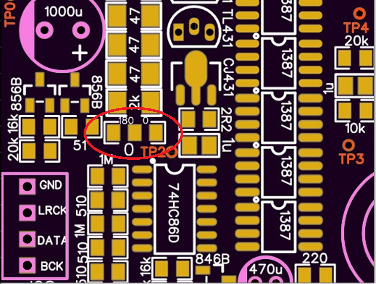

My downhill is more rocky than I hoped. Please help - I have no idea what to do with R23. I see a couple of 0R resistors and assume they have some part to play here, but there are 3 solder pads. Do I have to choose between two pads, based on what? Sorry for the noob question.
