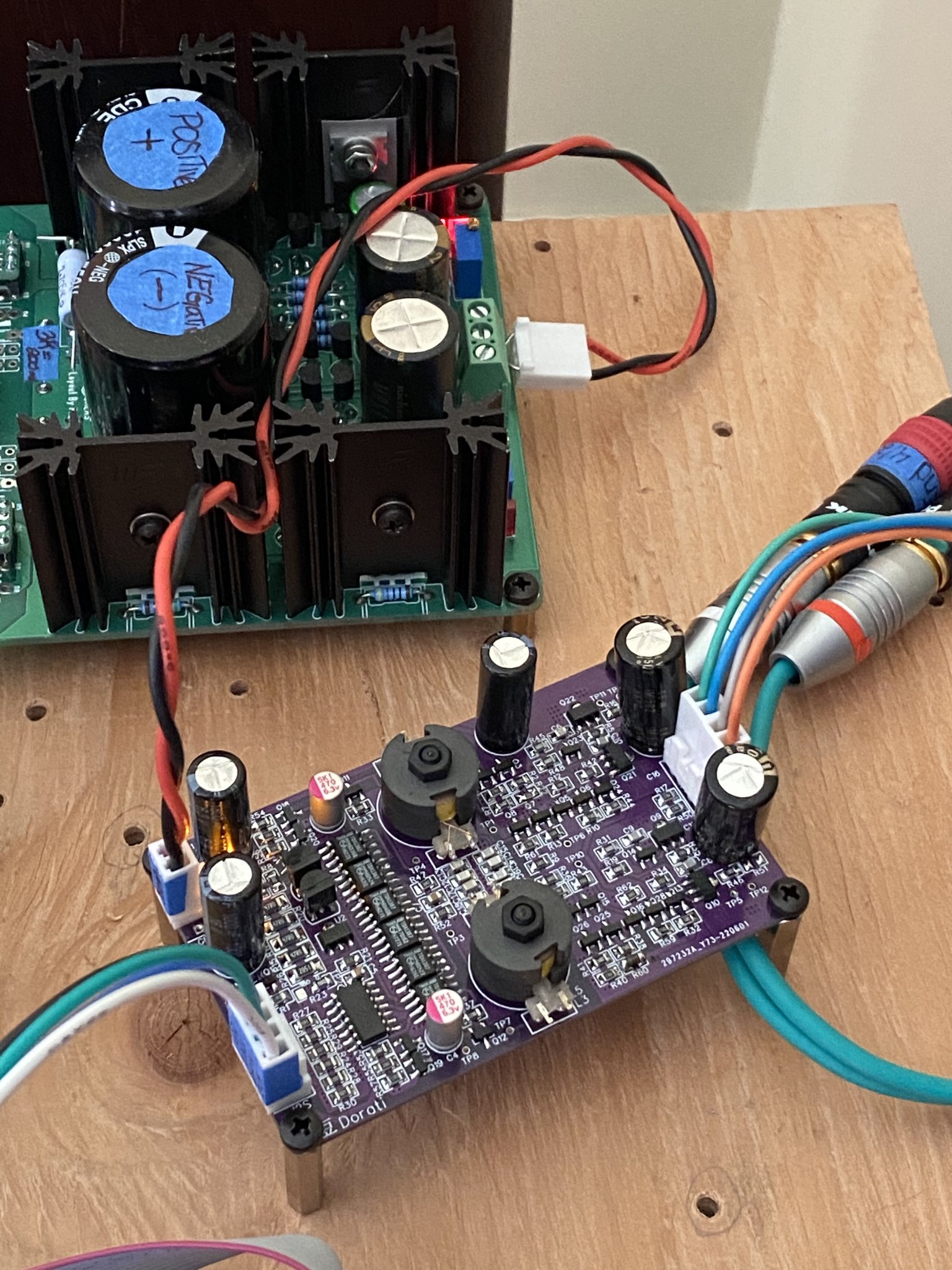

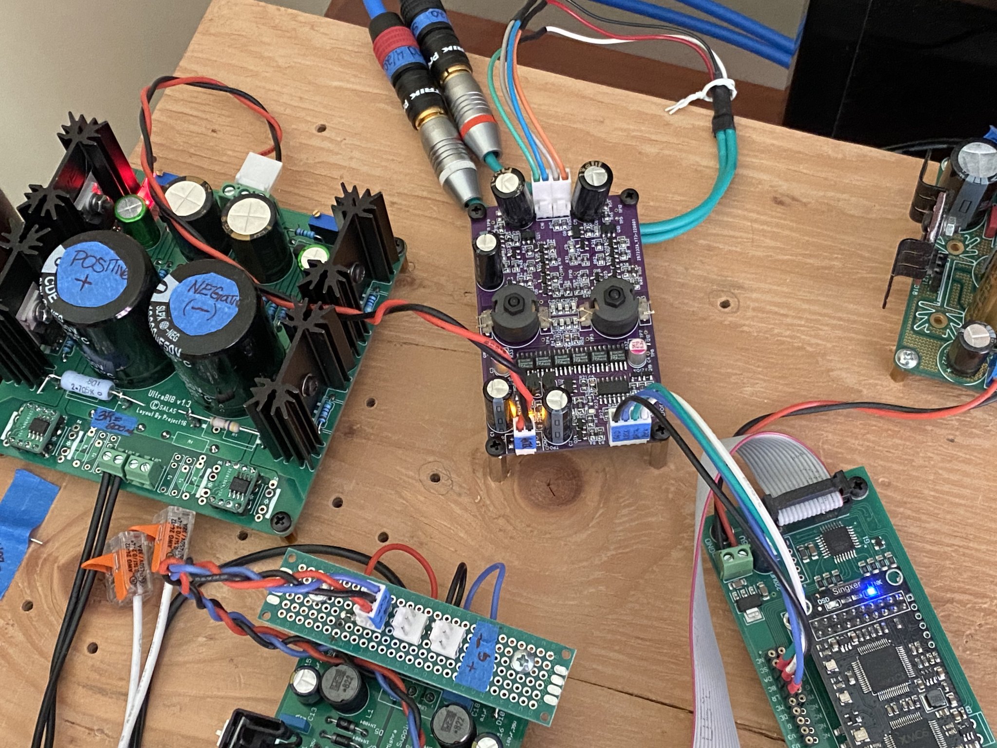

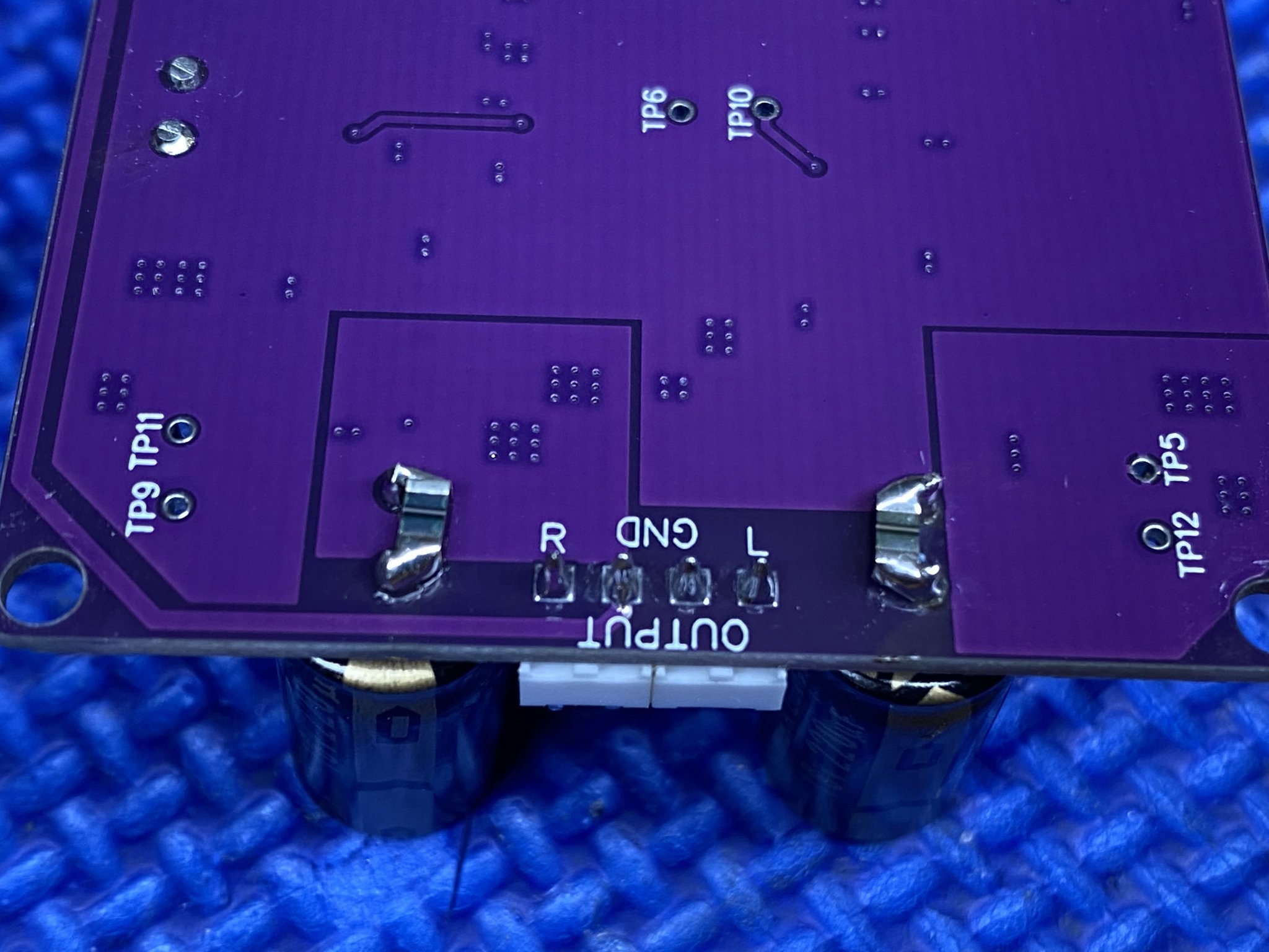

I’ve had mine playing for past few days. A clone Salas Ultrabib shunt psu is setup to deliver 250mA@14vdc to feed power to Dorati. Initially, my TP4/7 readings were low. After consulting with Abrax he calculated the values for each channel SOT resistor. Installed these resistors and TP4/7 are bang on perfect! (4.90v/4.92v)

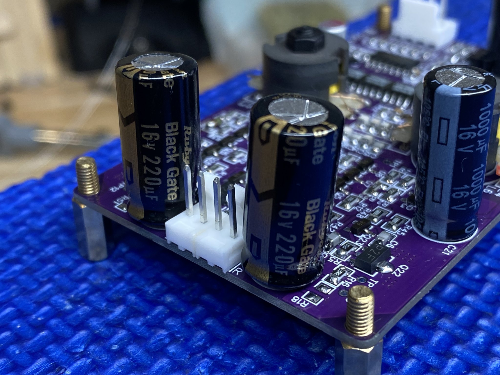

Dorati was built in stock form just to get started and confirm all works as it should. I was very pleased with what I was hearing, but after two days I felt the need to play with the output capacitors. I didn’t want to get crazy with offboard cap banks and added wiring so my experimenting was limited to what I could reasonably fit onboard. I ended up with BlackGate std 220uF, 16v elco’s with smd CDE FCA film bypass caps soldered between the legs underneath the board. Dorati now sounds wonderful!! And it’s dead silent between music tracks, no hiss or noise of any kind. I was concerned with the lower value cap negatively effecting the low frequency response, but that is not the case, all is still good. This is my first experience with a TDA1387 dac and it has a slightly different sound compared to my NOS R2R dacs. This is a nice change though and Dorati is definitely a keeper. If this is just a “starter” dac, I am intrigued by how the sound would improve going up the conductor name ladder 😉.
Btw, Richard and his wife do a fantastic job packing these kits and their support is top notch! Well done Team Abraxalito

The best I can describe the difference I hear with Dorati is the music sounds closer (distance-wise) to me. (and I'm splitting hairs here)
Dorati is quite an excellent performer, especially when you factor in how wallet friendly it is. I'd say the easiest way to take Dorati up a notch is tweak the output caps.

Interesting reading Vunce. Are they SMD LT4320 with transistors underneath?
Are they your own boards? Looks great whatever and a great review . Mine on its way soon hopefully! How does it compare to Miro 1862 in your opinion.

Great stuff Vunce and thanks for the feedback. I will start soldering soon, I hope.Dorati was built in stock form just to get started and confirm all works as it should. I was very pleased with what I was hearing, but after two days I felt the need to play with the output capacitors. I didn’t want to get crazy with offboard cap banks and added wiring so my experimenting was limited to what I could reasonably fit onboard. I ended up with BlackGate std 220uF, 16v elco’s with smd CDE FCA film bypass caps soldered between the legs underneath the board. Dorati now sounds wonderful!!
I'm wondering why/what was the motivation to change the output caps from polarized 1000uF caps to non-polarized 220uF caps? And you are very happy with the results. What preamp are you using or are you also feeding a power amp directly from the Dorati?
Hi Jim,Interesting reading Vunce. Are they SMD LT4320 with transistors underneath?
Good eye! Yes, I replaced the silicon diodes with LT4320 active rectifiers. Very small size because they use a pair of dual mosfets and both sides of pcb are populated. JPS64 designed them to use with a revised Yarra preamp regulated psu. Dorati is the perfect "set it and forget it" component, the size, layout and components don't lend themselves to much tweaking. Enjoy it how Richard designed it, it really sounds great. MiroDac is a living entity that can be configured from "mild to wild", so it has potentially a higher level of performance.
The BG caps installed are polarized. My motivation was driven by past experience with output caps in various gear. If significant capacitance is required I try to use the smallest size electrolytic cap without reducing low frequency response. This topic is a hotbed of differing opinions, but I fall on the side that different caps can make a difference in sound. My current audio chain is: Dorati-->SCG Preamp-->Big Mofo Class A amp = 😍

Yes that's the main reason. A secondary reason is I'm usually driving a trafo from my DACs and they tend to need a larger coupling cap to keep the LF resonance well damped.I guess there must be special reasons for the very high original 1000uF output cap. Perhaps to drive low impedance HP directly, perhaps designer's choice...
The resistor is an attempt to pre-charge the caps so there's not such a huge thump on plugging in any headphones.There must also be a reason for the 27k resistor at the output (to ground, saving a short cut or too low output impedance?). Or am I missing something?
