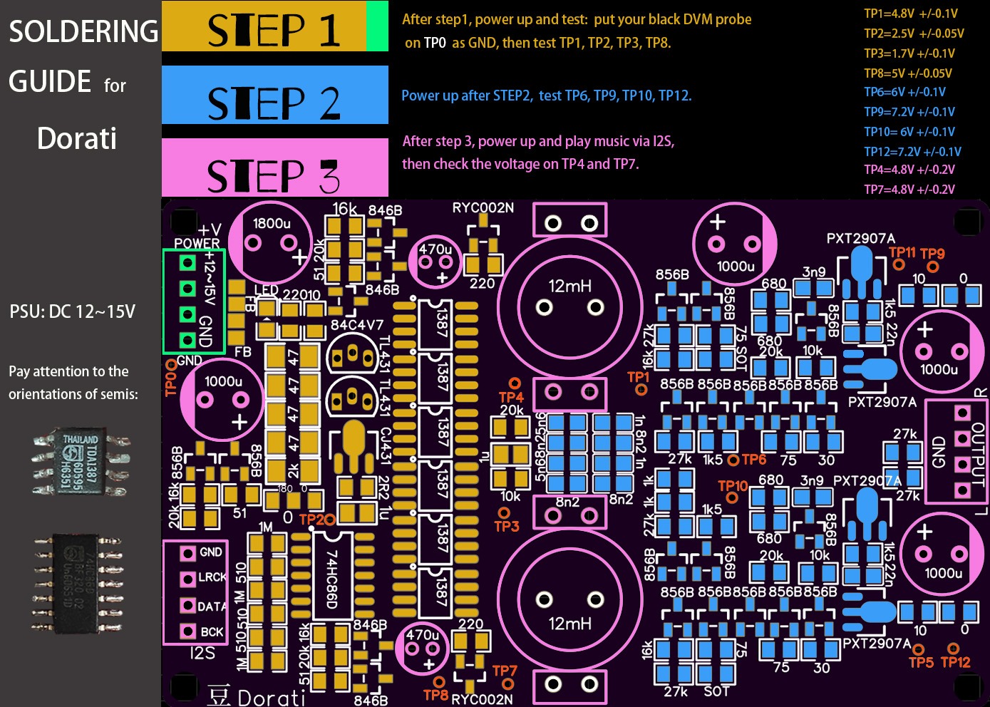

Help. Noob question - R22 and R60 are indicated as SOT - what does it mean and what to do with these two?
SOT means 'select on test' - you can fit resistors here to trim the DC offset at the I/V stage. The DAC will work fine without those being fitted.

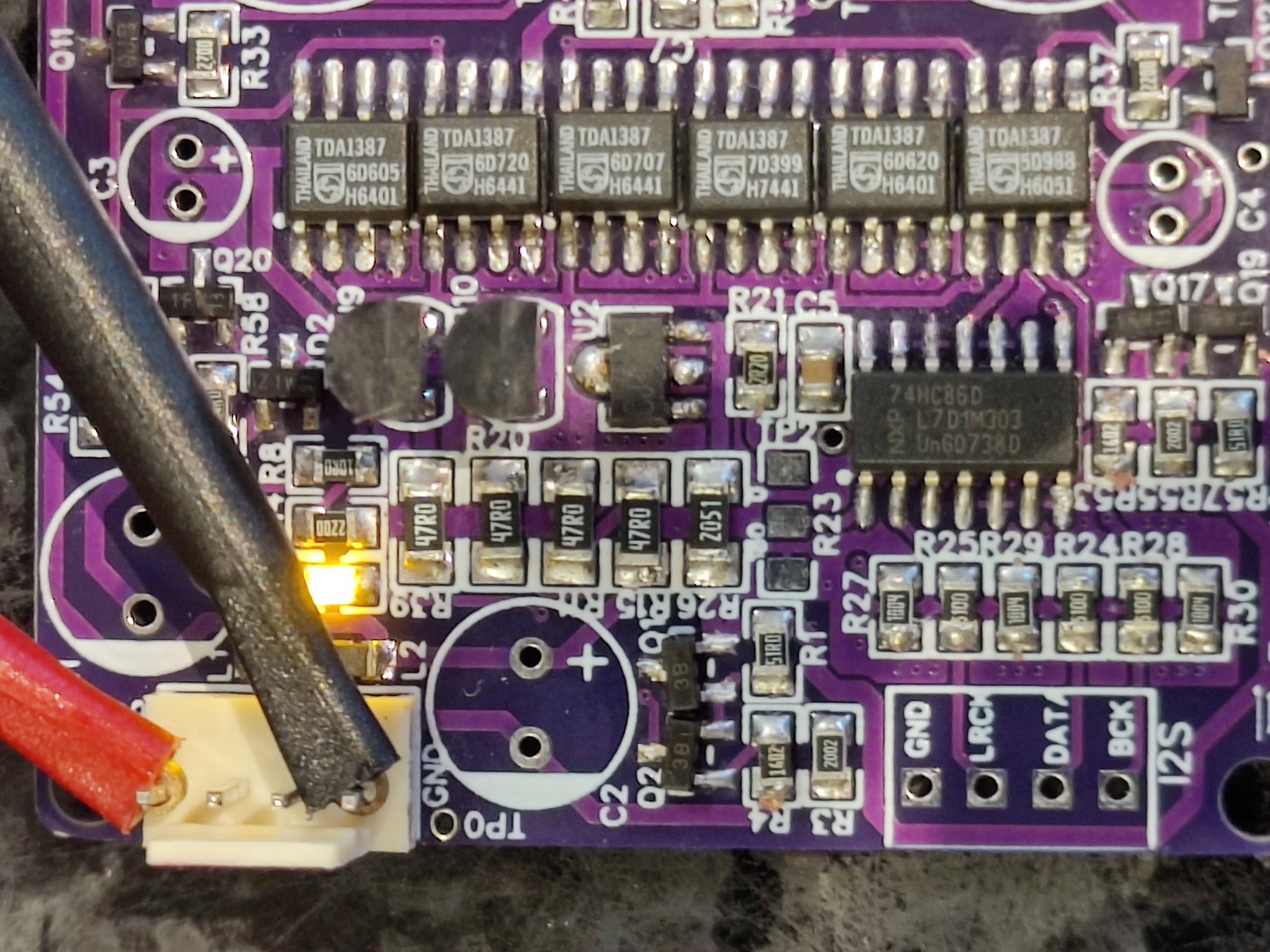

Got the first stage of my Dorati populated today. Well I got a bit carried away and started on all the small items until I looked again at the stuffing guide!
Performed the 1st test. Used a current limiting PSU to make sure I didn't mess up. All seems good at 14v. Drawing 0.06A.
My measurements seem OK to me but aren't quite within the tolerance so I share them here to get a confirmation that I'm good to proceed!
TP1 4.86v
TP2 2.49v
TP3 1.66v
TP8 5v.....good on this one!

I'd say you're well set. Good job, soldering looks neat!My measurements seem OK to me but aren't quite within the tolerance so I share them here to get a confirmation that I'm good to proceed!
Great news Richard thanks. SMD soldering is improving but I'm a way off my goal to solder like Vunce!

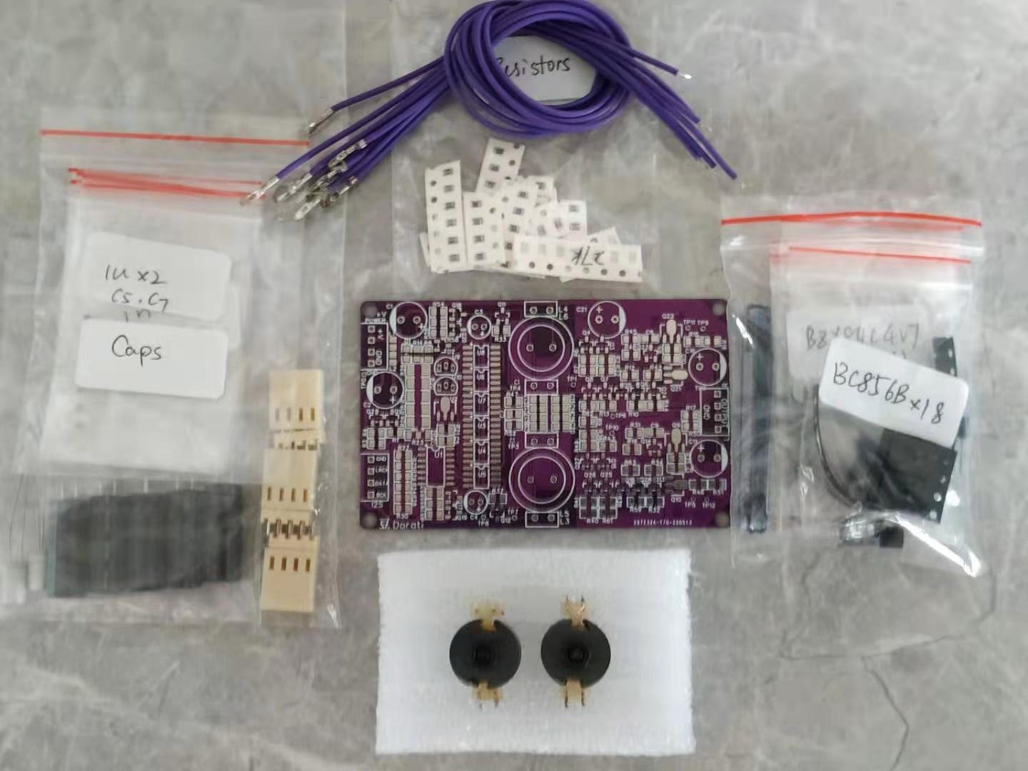

hi,Orders now are open on Dorati NOS DAC kits - PM me and be sure to include your payment method and location so I can quote you inclusive of fees and shipping. Dorati offers a sound quality upgrade over its predecessor 'Kubelik' but retains the same physical footprint of 81mm * 50mm, slightly smaller than a credit card; the maximum height is 24mm. The design is non-oversampling (i.e. there's no digital filter on-board) uses passive I/V and has a discrete output stage. What sets it apart from typical NOS DACs is the use of an LC filter prior to the active stages. The input format is I2S (three signal wire) at 44k1/16bits. BCK can be 1.4 or 2.8MHz, no MCK is required. Output is CD standard 2VRMS and headphones at 300ohm impedance and above can be directly driven. Power supply requirement is a single 12-15V rail at 150mA max. There's a digital invert function, selectable by a 0R resistor. Schematic may be found here : Dorati schematic updated 6.23
Preferred payment method is via Wise which typically adds a 2% fee. Our receiving currency is CNY, alternatively USD or Euro. PayPal may also be used, in USD but will attract higher fees, about 16%.
Price for a Dorati kit : 168RMB (~$25)
Shipping is in addition and depends on your location and speed of service. Courier (FedEx, TNT, DHL) typically takes 8 - 10 days and e-packet four to eight weeks. Not all locations can be serviced by e-packet though.

You'll need some fine diameter solder (0.3mm is recommended), a temperature controlled soldering iron with a fine bit and a pair of tweezers. A magnifier comes in very handy but that depends on your eyesight. Desoldering braid is helpful for correcting mistakes. If you've never soldered SMD before then maybe Dorati will be too challenging for a first project as there are around a hundred parts. However none of them are microscopic (the smallest is 0805) and none of the ICs has pins closer together than 1.27mm. For testing you'll need a DMM (digital multimeter).
What's supplied in the kit?
There's a picture directly below of the contents (to be added) : the bare PCB plus all the components that mount on it (resistors, caps, inductors, LED, ICs etc.). Given that 0805 sized components are incredibly easy to lose, we include a spare or two for each value. Input, output and power are supplied via 4pin Molex-style headers, we supply the mating half with crimped wires to these too.
