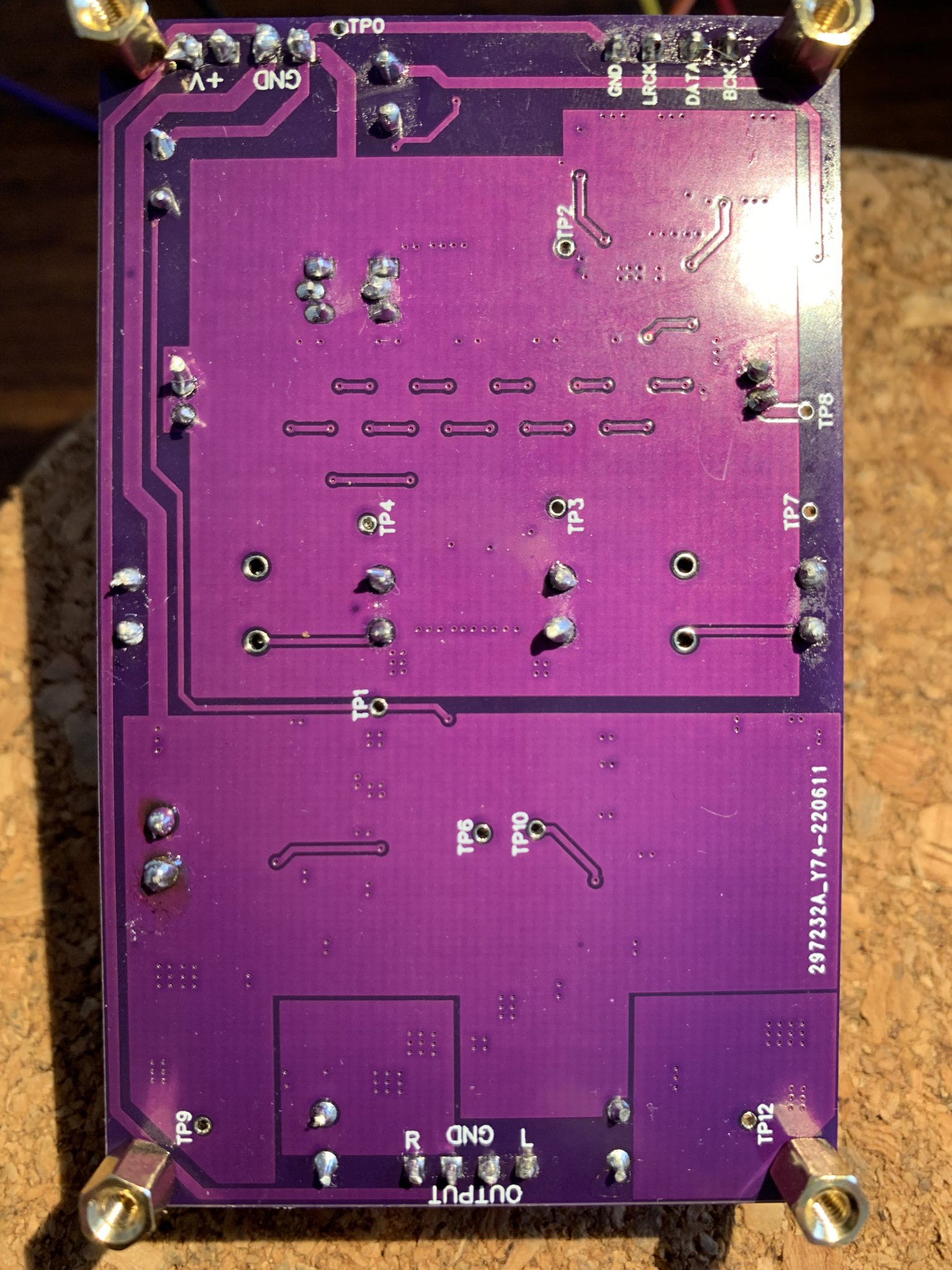

After the resoldering, are the voltages on R5 still the same? If Q22 is really soldered down on all 3 pins then those voltages indicate Q22 is damaged.

I found the culprit (actually me): Q22 right pin was not well soldered.
Now I have the following voltages:
TP1=4.86V
TP2=2.49V
TP3=1.66V
TP8=4.99V
TP6=6.09V
TP9=7.32V
TP10=6.09V
TP12=7.32V

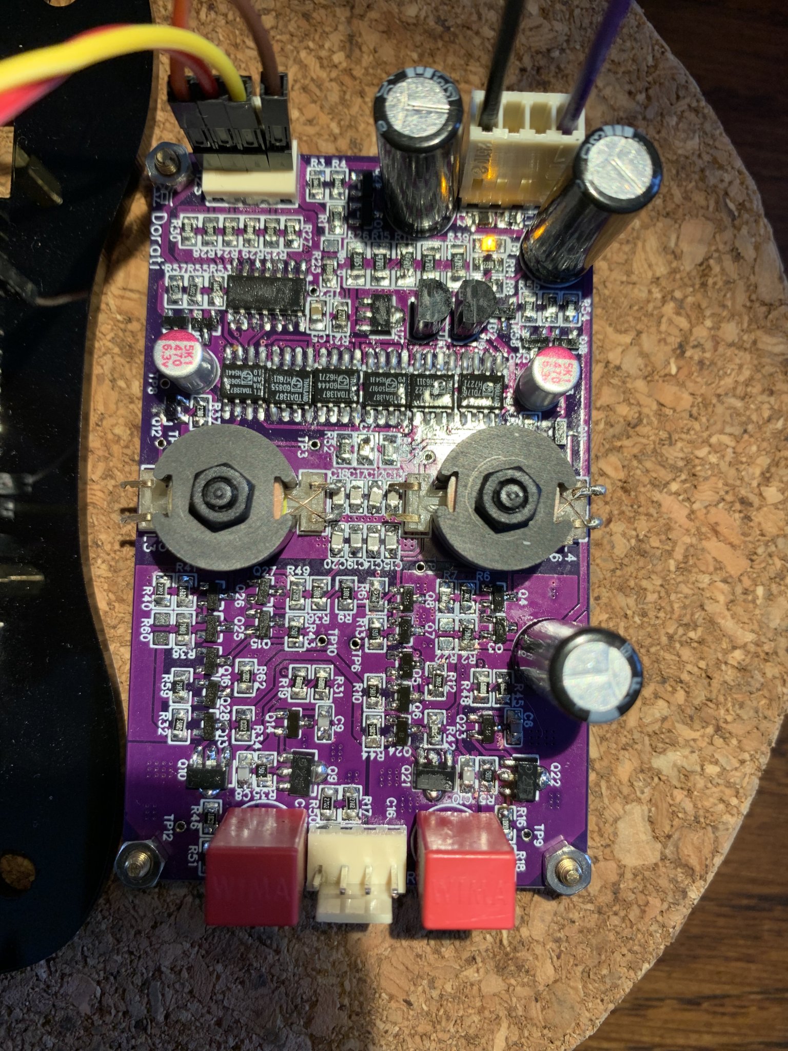

Hi Marco,
To better assess your soldering, clean the board in 90% Isopropyl alcohol and a soft bristle brush. I can’t be sure but looks like you have several places where cold solder joints can be giving you some issues.

I understand the output capacitor could be a minimum of 4.7uF if no HP is used. I have asked @abraxalito
I have already cleaned and brushed the board with Isopropyl alcohol. I will do it again.
However previous measurement were ok right after the cleaning.
Marco
Marco

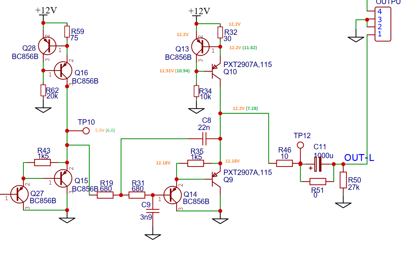

Hi Richard, my Dorati was working perfectly until I started putting it into a nice enclosure and now I don't have any output on the left channel - I didn't suppose the enclosure was actually the problem so I've taken some measurements and would welcome your opinion. The fact that one channel is working correctly means that the digital front en is OK and the issue is likely to be in the analogue filter/output stage of the left channel.
Firstly the complete set of test point measurements:
TP1 - 4.9V
TP2 - 2.5V
TP3 - 1.7V
TP4 - 4.7V
TP6 - 6.0V
TP7 - 4.6V
TP8 - 5.0V
TP9 - 7.3V
TP10 - 5.9V
TP12 - 12.1V
All look OK except for TP12, which suggests the problem is with the final stage of the left channel output, so I took some more measurements and annotated the schematic as per attachment. The voltages in orange are for the left channel and those in green are for the right channel.
It looks as though the problem is around Q10, Q13. The soldering looks good and I can't see any bridges (and it worked previously) so I'm thinking a part replacement is required? what do you think?

Hi Ray - my suspicion falls on Q14, it maybe has failed. Check its base voltage (pin1 on schematic).
The measurement you have for Q14 emitter (pin2) looks improbable, its higher than Q9's emitter but there's no way to make it so high, other than a short on the PCB. Oh, it could be that your 11.18V measurement is in error, seeing you have two voltages for the same net. That the 11.18V is wrong would explain it.

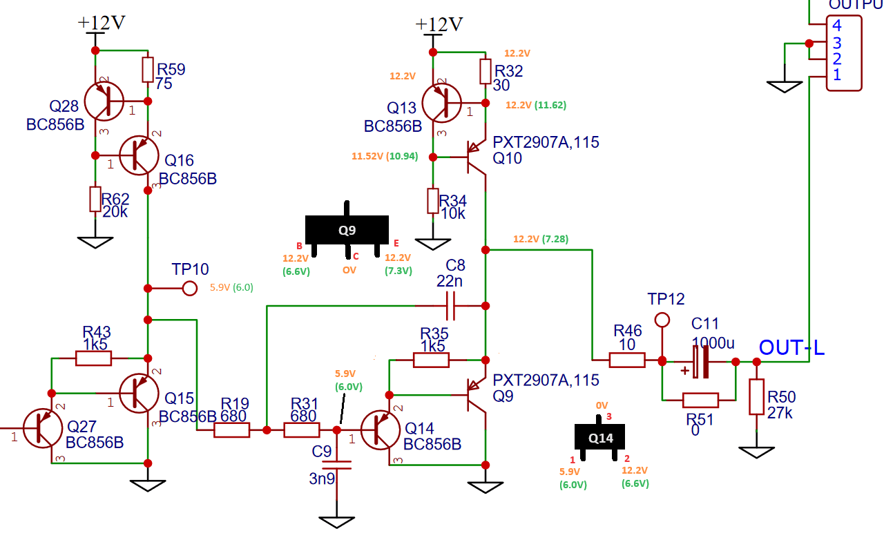

Hi Richard and tanks. Just looking again and it appears I made a transcription error when annotating the schematic from my notes - my bad! I'll double check later and update with the additional info you mention.
Hi again Richard. After some distractions I got back to the Dorati DAC today and have checked previous measurements and included some more - see the schematic below. As before, the voltages in orange are for the bad (left) channel and those in green are for the good (right) channel. I added some diagrams for Q9 and Q14 to keep the annotation clearer. Thoughts?
@abraxalito Hi Richard, I still need to troubleshoot my Doarati - any thoughts on my measurements in the previous post?
