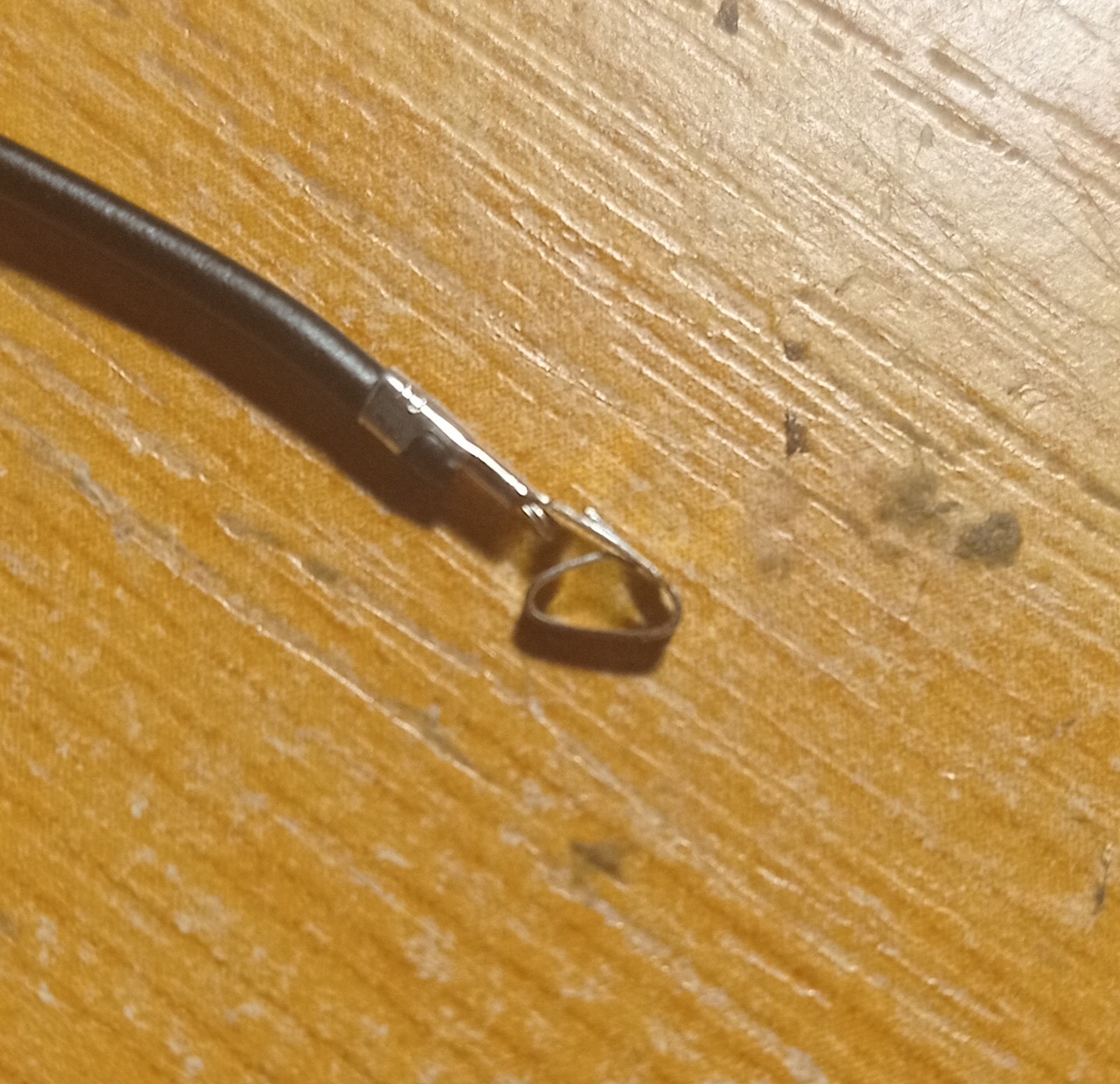

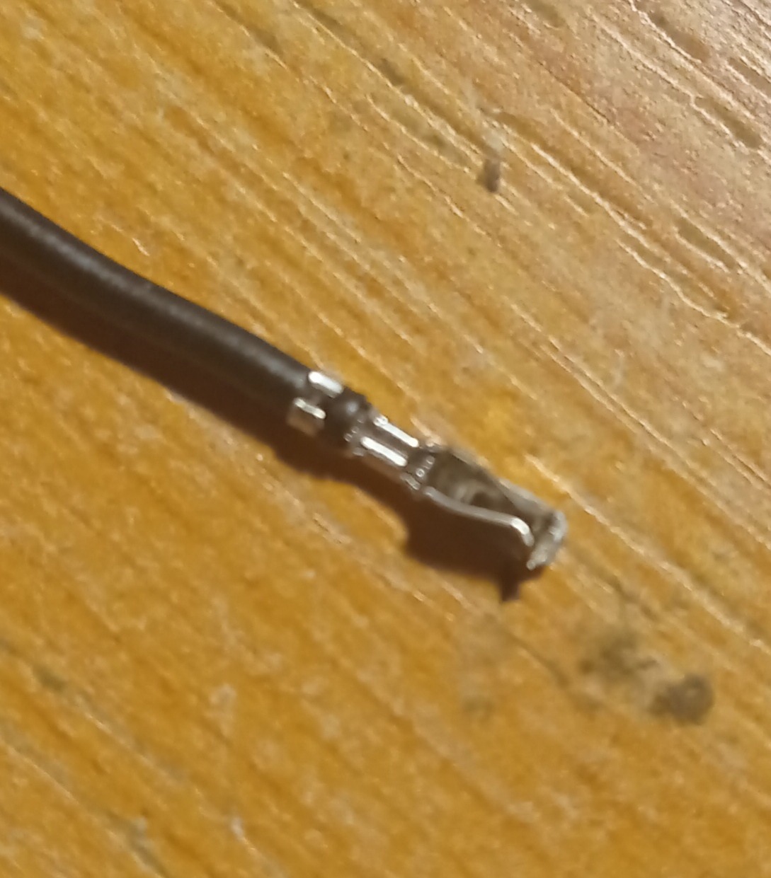

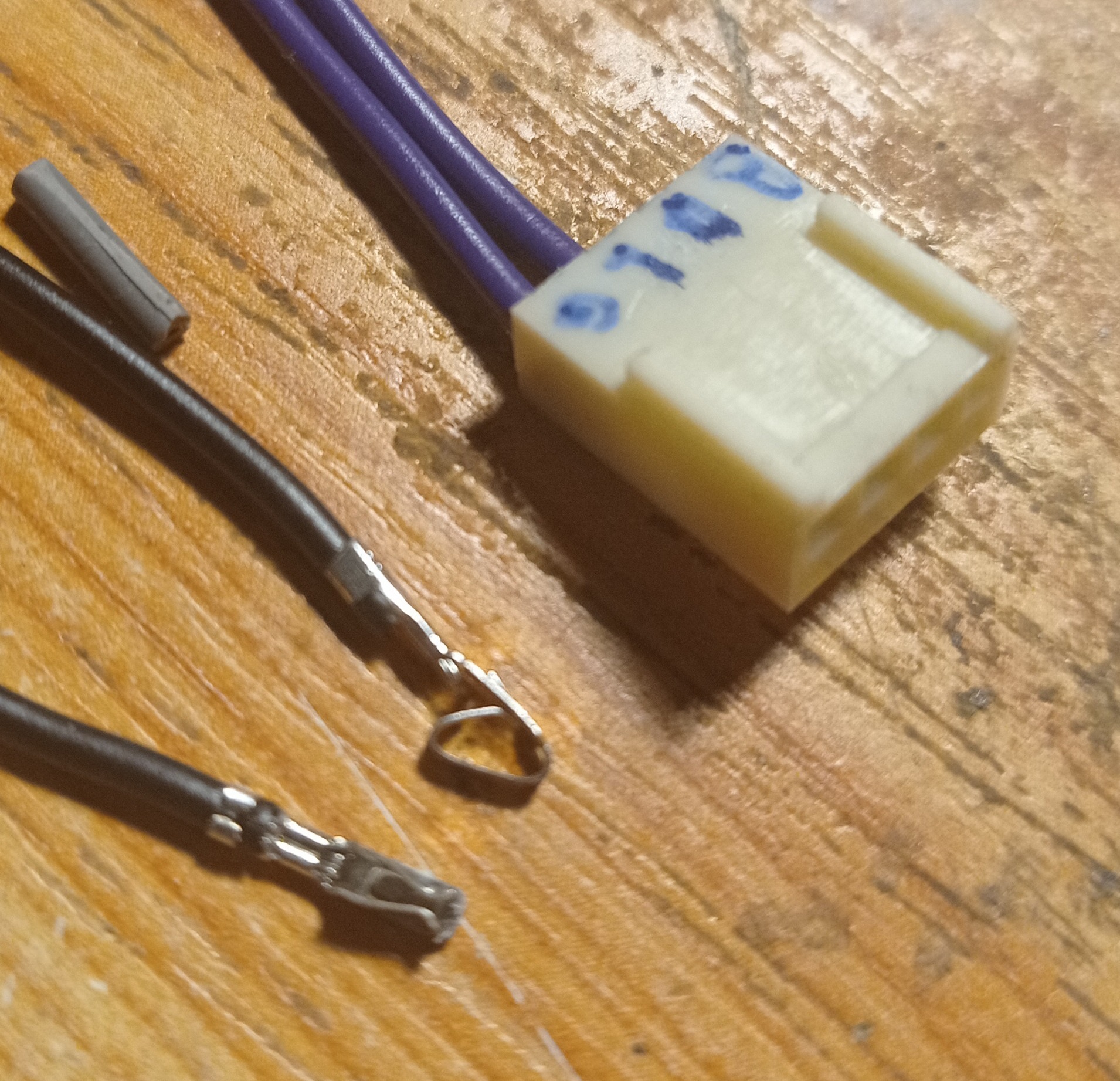

But I found a problem with Pin1 BCK - 0V. The problem is in I2S 4PIN.
See the picture P1.
All pins should be the same as on P2, and BCK is set as on P3. Bad contact P3 and BCK = 0V
I replaced the bad pin and BCK and bad, distorted sound appeared.

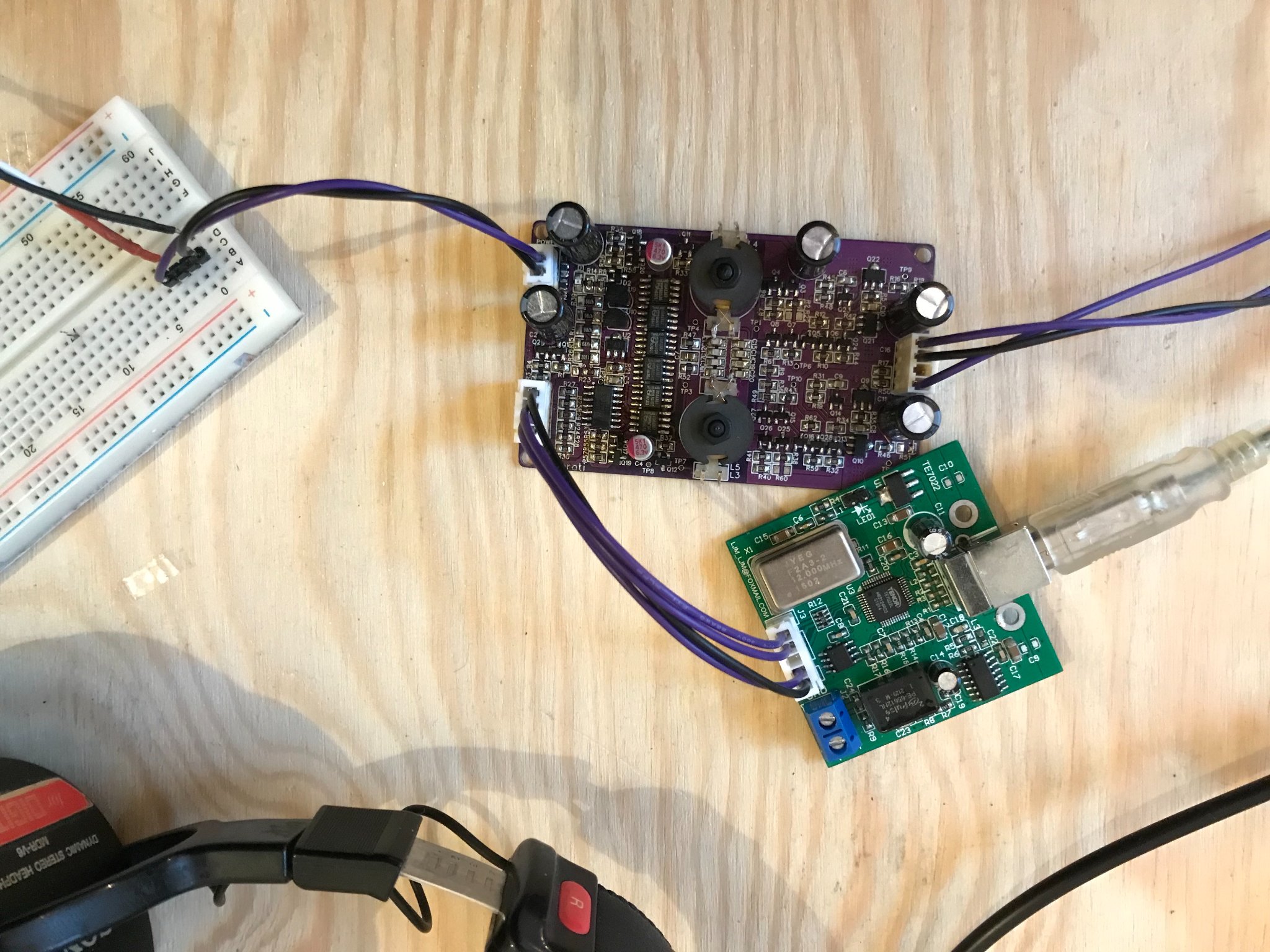

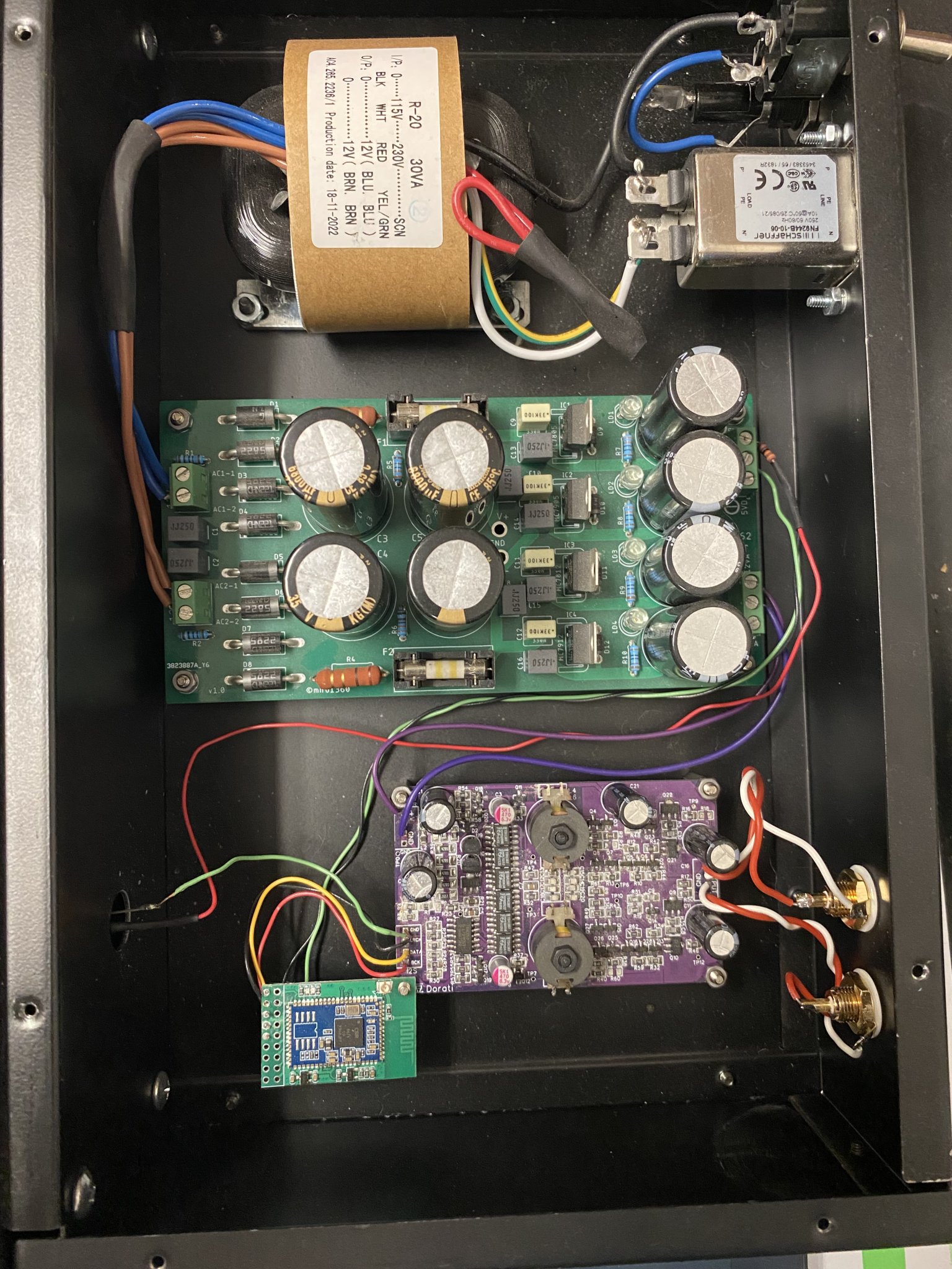

Hi there, I have been enjoying my Dorati for the last year or so, but when I turned it on the other day, it sounded like the speakers were blown (their not) and a little investigating revealed that the LED on the Dorati board was not lit. I can confirm that 12vdc is still supplied to the board but I have not tested anything else.
Richard, let me know where I should start trouble shooting.
Thanks,

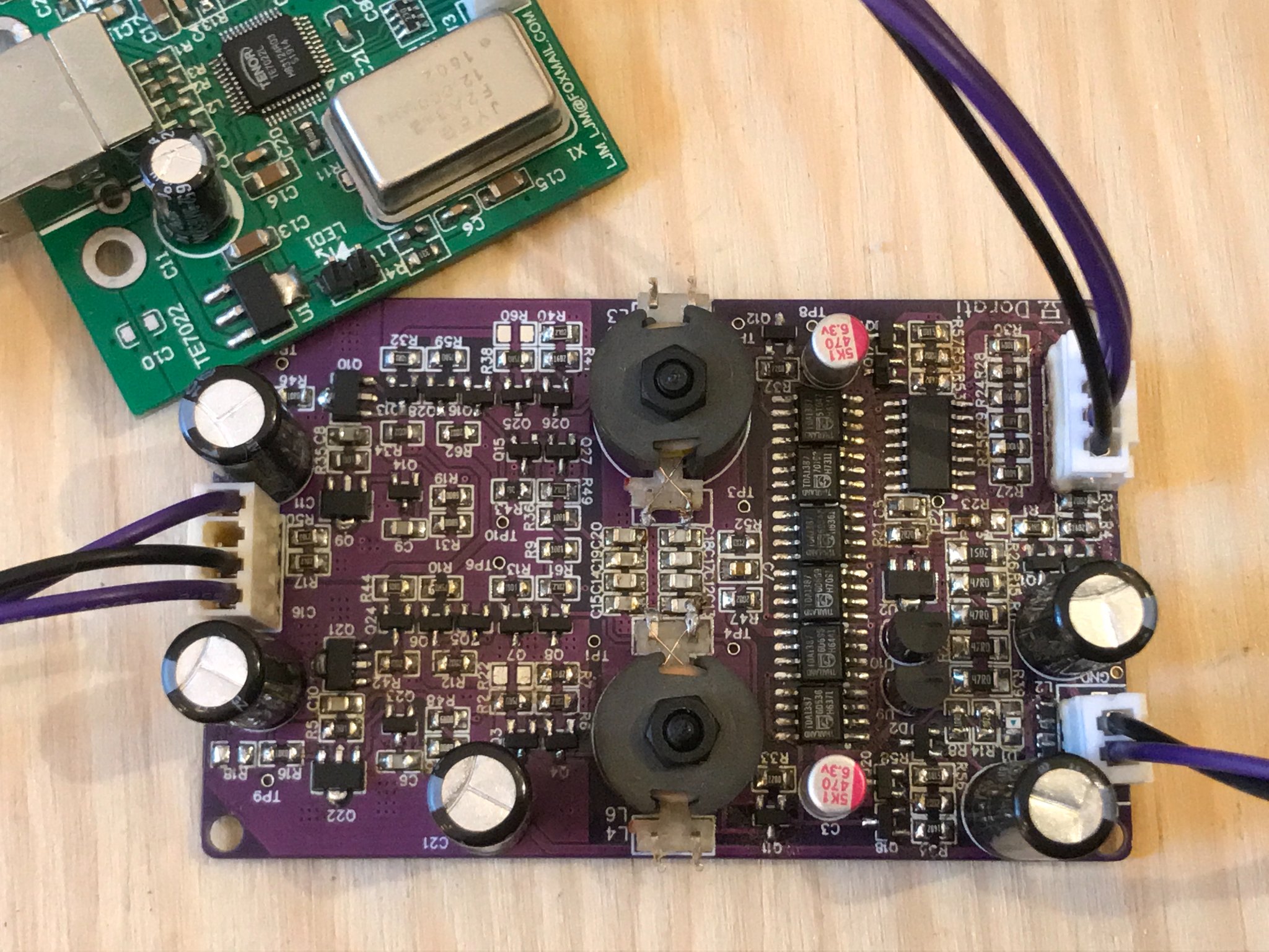

Here another happy Dorati is born. Freshly built but I was immediately convinced with the sound. Running it straight into headphones and it is clear, full of detail and body, the bass is incredibly defined and very physical. The fact that there are no opamps is lovely and it is truly pleasant to listen. I monitored some soundtracks and got carried away, wanted to keep on listening for hours if I wasn't surrounded by prototype cables because it was so revealing. Didn't do much measurements but the output is like 6Vpp at 20mA. It was more than enough for my HPs (63ohm 106dB/mW).
Everything on the design seems is just genius. The mosfet to increase the DACs voltage, the filter before IV to smoothen wave steps, the class A output stage.
Assembling was very fun and only encountered a few challenges....

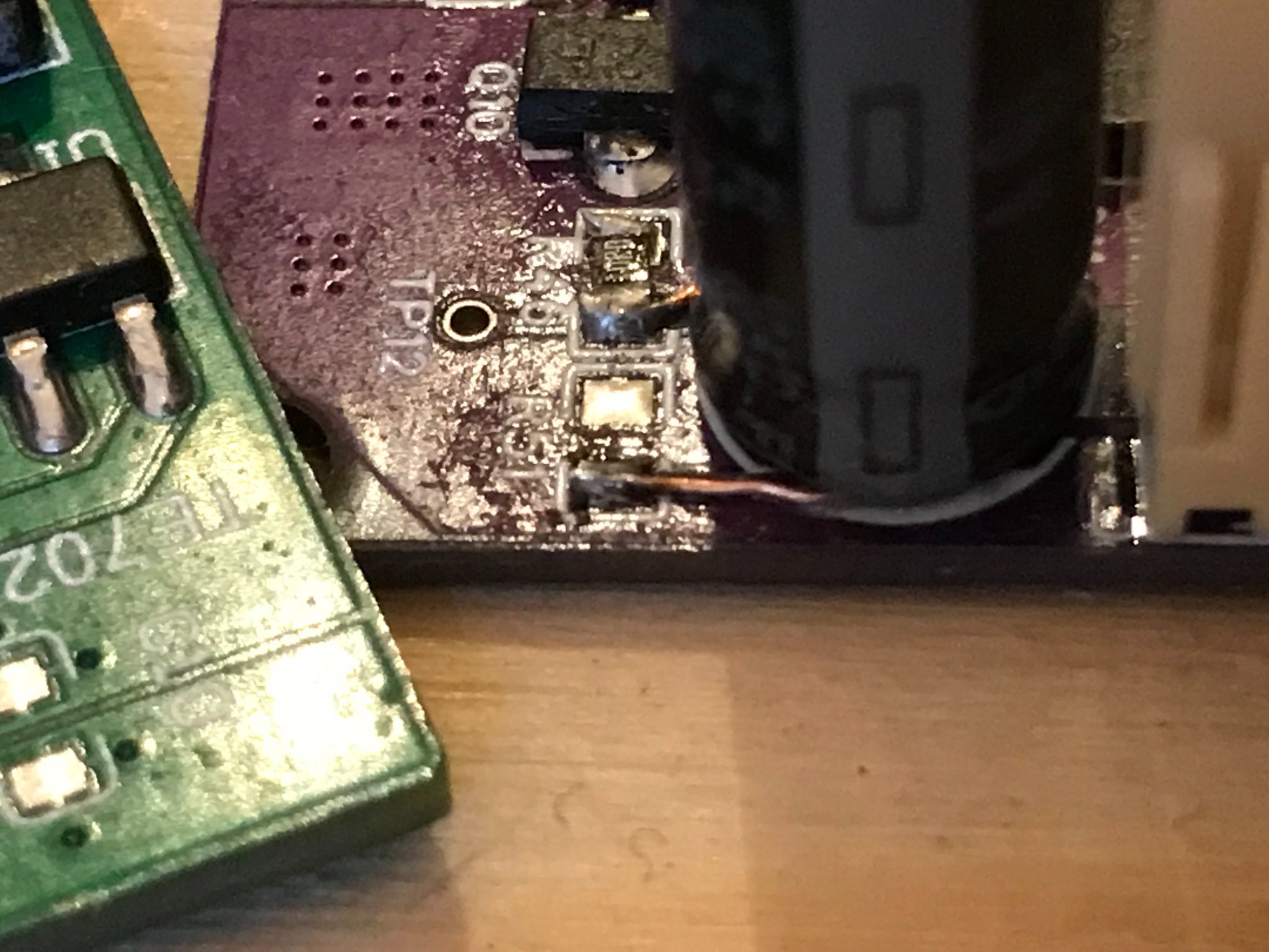

I used no-clean flux and some joints didn't make contact at first. I noticed this with the test points that are very useful and well documented! I guess it is best to use a soldering iron first and then heat all SMD parts with a heat gun to be sure. In my case one of the lose joints was the CJ431 regulator so the 74HC86D got 12V and might got damaged. Fortunately the kit brought a spare one so I changed it just in case.
Then I soldered a 1800uF in place of a 1000uF, at the L channel output–they came in the same bag:/. Desoldering broke the output tracks, but I managed to replace the tracks with copper wire (see pic). Fixed 🙂
Last thing it took me a while to realize that I soldered the 0ohm resistors that bypass the output capacitors, so I was getting little to no signal on headphones. But that was it, I removed them and all the glory came in. I still have to experiment with a USB isolator that @abraxalito included in my kit, next a TE7022 USB-I2S converter.
It puzzles me a bit that the output driver is a current source where the power transistor (PXT2907A) is biased with only 10K at the base. The series resistor is 30R and I measured 130hFE for the transistor, so I guess that the base resistor should be 3.9k at least (30*130) to fully saturate the PXT2907A. Or 2.6K if the 30R would be replaced by a 20R for lower impedance headphones. But as said it works perfectly with my mines as it is now.
Oh, and I'm also not so sure if the series 10R at the output is beneficial when driving headphones.
Overall a lovely DAC and it will be very difficult to replace with anything else. It will substitute my current JLH HPamp for daily usage and monitoring.
