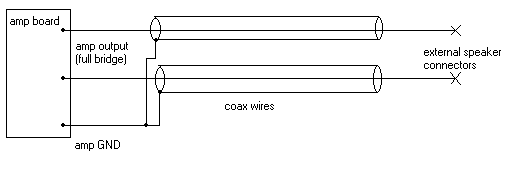

It is better to use twisted regular wires for output too, especially for full bridge output... In full bridge each output wire will conduct in antiphase, and if they are twisted (or phisically paralleled), then this will eliminate all parasitics.

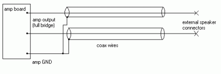

Sure, it is possible to use coax wires too, but then I would like to connect them as it shown in then picture. 🙂
Why two cables for output? The shielded cable I have has two threads already inside it. One if for output and the other is ground.
In my case wouldn't it just be the single cable with the extra insulated wire being the output and the other one being ground.
Although your the third person today who's told me to use regular wires at both the power supply and the output as well.
So I'll go with regular wires but in twisted pair fashion and just use coax for the input and pot.
In this project you are using the full bridge configuration. So there is NO any 'ground' output wire. Both wires have an output signal with residual, etc. So you cannot simply say, that for example the wire A is a 'ground' wire and connect it to the shield of coax. Shield must be always connected to the GND, to get any effect from the coax cable. So, because of it there was needed to use two coax cables. 🙂
