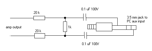

Leave the music input as it is now, and connect the output of the amp to the PC aux input as shown in the picture below.
Need to say, this can give you wrong result, because of residual. This will interfere with the soundcard ADC sampling frequency and distort the measurements. I have seen somewhere the AES recommendations about the FFT/THD analyzer input filter for class D amp parameter measurements. Ideally, this filter should be used here. :rolleyes:
I gotta build that circuit with the resistors and caps?
Or just Headphone input and Aux input connections are enough.
Without these resistors and caps you will produce the short circuit for some of the half bridges in your amp via the PC Gnd connection, and deliver the 20V wave into soundcard aux input, where usually it is designed for 0.7-1V only...
Allright I will produce another circuit-board for this and take the output of this into the microphone jack input of the PC.
SpeactraPlus Manual tells me the audio you are trying to measure should be connected here or into Line-In.
Okay, I have simplified the schematic slightly, so it will be not so hard to build it. :D This should work too, I think... :rolleyes:

Also does it matter which capacitor I connect to which leads of the jack?
At this moment I'm thinking the capacitor for Phase Leg A goes to the positive Input and the Phase Leg B cap goes to the ground Input.
Am I Correct?
Am I Correct?
Yes, it is ok so. ;)
Ideally it is needed to use the op amp here to convert the differential input into single output, but it is real overkill for this project... :)
