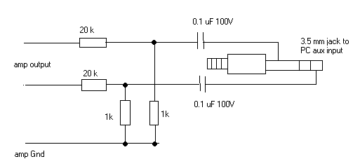

Also you know how i can test my amplifier in software?
Any recommendations?
I'm almost there now, just take a few THD graphs and FFT graphs and Hallelujah I am done (thank god).
You know how the professionals show graphs of distortion and decibel range and such. I would like to plot something similar just to at least show the teacher I tried.
What Else can I do to polish up my circuit 81bas?
Oh, you can do a lot to polish this 🙂 New PCB, add feedback, use toroids in output filter, and a lot more... 🙄 But this is an simple education project, and if you are satisfied with the results, then it is done! 😉

Ok Dumb question (more dumb then usual). How exactly does this work?
Like how?
At the moment my input music is coming from the headphone outlet of the PC. If your saying use the sound card, I'm guessing more wires and such. Which means plugs I gotta get. Can you explain which plugs.
I'm guessing there will be like a input going to the amp which is the wire I am using (I think), but also a output which goes to something in the PC and this is where I am lost.
Leave the music input as it is now, and connect the output of the amp to the PC aux input as shown in the picture below.
Need to say, this can give you wrong result, because of residual. This will interfere with the soundcard ADC sampling frequency and distort the measurements. I have seen somewhere the AES recommendations about the FFT/THD analyzer input filter for class D amp parameter measurements. Ideally, this filter should be used here. 🙄
Also, the schematic below will measure the parameters of the single half bridge in your amp at the time. But this should be ok anyway. 🙂
Last Edit: 😀 do not forget to connect some load to your amp (usually it is an 4-8 Ohm resistor).
