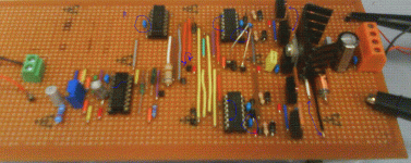

Here's a pictures of my veroboard design.
http://img225.imageshack.us/img225/5331/dsc00037q.jpg
I couldn't avoid the long wires between the XOR gate and the second Gate Driver. It was Either that or long wires between the gate driver and FETS.

This is good. But I meant the cap on the audio input of the TL494. The sound input wires or wires from the volume pot can act as an antenna and produce various 'effects'. So, place the 100pF cap between the sound input and the ground, directly on the TL494 pins maybe. This should help you to solve the problems with power current spikes, when you wheeling the volume pot.

You have NOT an 3'rd order LC filter. Actually, there are two 2'nd order filters. 😉 Also, I slowly understand now, why you had such a 'huge' residual at the output (+/-5V): you have a relatively low switching frequency (196kHz) and a relatively low inductances in your LC filter (20uH ?). And the cap in the output filter is not so big too, as I see it in the photo (is it here at all? 😀). And we have not seen any ringing in this residual too! This is good too.
Hmm Not sure if i can put right on the PWM chip. Because the Music input is the green connector you see. Again with the latest photo I'll upload tomorrow it'll become more clear.
So throwing a 100pF cap here would minimize my problem and i can punch the pot all the way up without the power supply going insane?
By close to the TL494 as possible. You mean Which Pin? Pin 16? Which is the Pin the Music goes to Ultimately. So between Pin 16 and ground is what your saying?
I'm a little lost for space if that's how it should be. >_<
Is it ok to just chuck the 100pF cap close to the music rails?

And the cap in the output filter is not so big too, as I see it in the photo (is it here at all? ).
yep there is a 100nF capacitor in parallel with the speaker. And the two inductors are connected to either leg of the capacitor. It's silver thing you see behind the bus capacitor.
it is much better to place small caps (0.1uF) around the board (near to each IC and around each pair of mosfets!).
That's what the 100nF blue capacitors are there for. You see them on the TL494 and the XOR chip. Also each half bridge has a 100nF cap connected between drain of high side mosfet and source of low side mosfet.
Edit: Ahh crap, bad view. You don't see the high freq caps on each pair of MOSFETS. But I have added them.

So all I am missing then is the 100pF cap between the Input of the Music signal and Ground?
No. It is highly recommended to place the 0.1uF caps where it is shown with blue arrows in the picture below too.
The 100pF cap should be placed directly between the Pin 7 (Gnd) and Pin 15 of TL494 on your schematic (this is NOT shown with blue arrows in the picture below).
Wait what? Add 100nF caps from 12V Vdd pin to Vss pin?
Also why add a 100nF cap on my power rail. You've drawn the blue line right under 2 red wires. Which are the input supply to the XOR IC and also the second input to one of the XOR gates.
Again bad angle but I do have a high freq 100nF cap from drain to source on each pair of MOSFETS.
I couldn't directly connect the 100nF cap from the supply pin of the chip to the ground. So I've just taken it from Supply Pin to the common ground (Best I can do).
The teacher doesn't want me to solder bits underneath. He want's it all on the top.
And Alright I will add a 100pF cap from Pin 15 to the ground Pin.

You do not kow where in your schematic the music goes into? In which pin? 🙄 It is Pin 15, according to your old schematic: (http://img216.imageshack.us/img216/617/schematic.png)
No. In the case with Veroboard design it is needed to be mounted directly on the TL494 pins.

20uH and 100nF explains the +/-5V residual for me.
You need to understand the simple thing. Each piece of wire or Veroboard trace is simultaneously an inductor, an antenna, an capacitance connection to each other points in your schematic, etc. These parasitics cannot be avoided, but only minimized with a good PCB layout or a ground plane. So you need to shunt all your antennas and power connections properly. Generally, it is even more complex to do on Veroboard, than developing of a good PCB. 🙁 But in your project it is not need to have it all ideal. It should work with my recommendations too, I think... 🙄
Yes! This will clear the input power supply of IR2110. The HF cap after the TO-220 reg is too far from each IC.
I meant you need the cap here too. The 12V traces are too far from TO-220 reg here.
Connect it OVER the IC (not under) 😀

Ok I already have a 100nF cap in parallel with my Bus Cap. You can a little blue guy right behind the fat bus cap.
So I'll add another 100nF where you drew the Red Line, since as you say the 12V line is literally drawn out and the HF cap is too far away from it.
