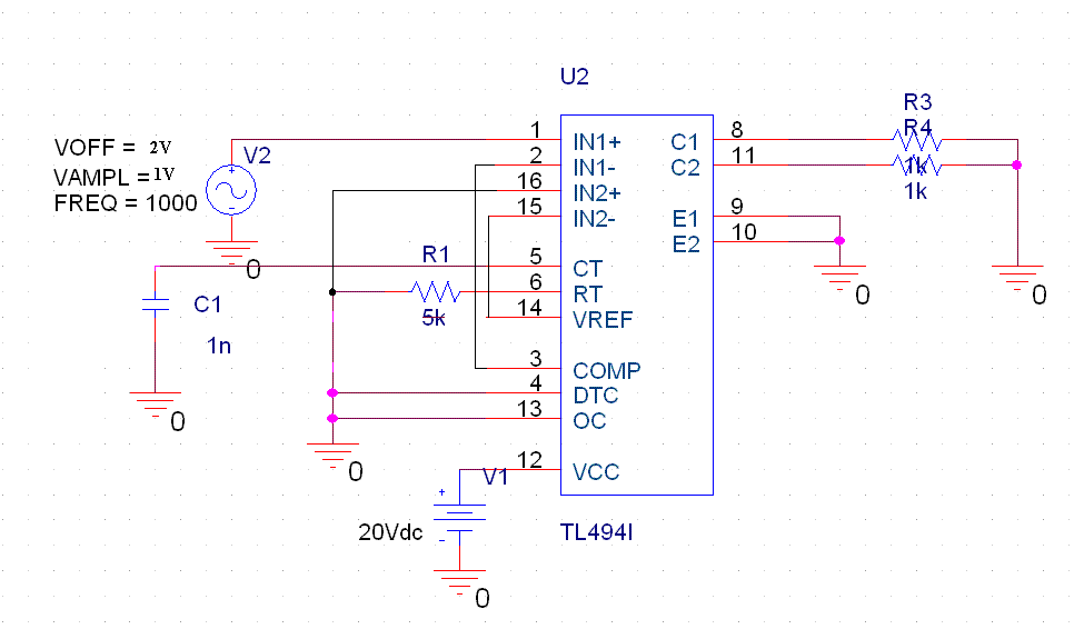

Doing a class D Amp project using TL494
Is this essential to use XOR gates instead "These tricks" ?
Also why not invert the square with only a single BS170 or a BC547 and a resistor ?
Phase accurate and 81bas dont know the mode control pin of 494. It can work in 0...90 % mode and produce complementary output with the "trick". I built 2 slightly different versions, both worked acceptable. However with the same effort you can build UcD with much better quality.
I've readt in this thread that the one pulse is more long than the other when using this trick :confused:
I like the trick but this confuses me. I am having an oscillo but its not here and I cannot test.
The problem is not really the length difference of pulses, but asymmetrical dead time (can go negative in one direction). You have to trim it by carefully chosen R(D)C network, and still it will not be perfect. You definitely need an oscilloscope.

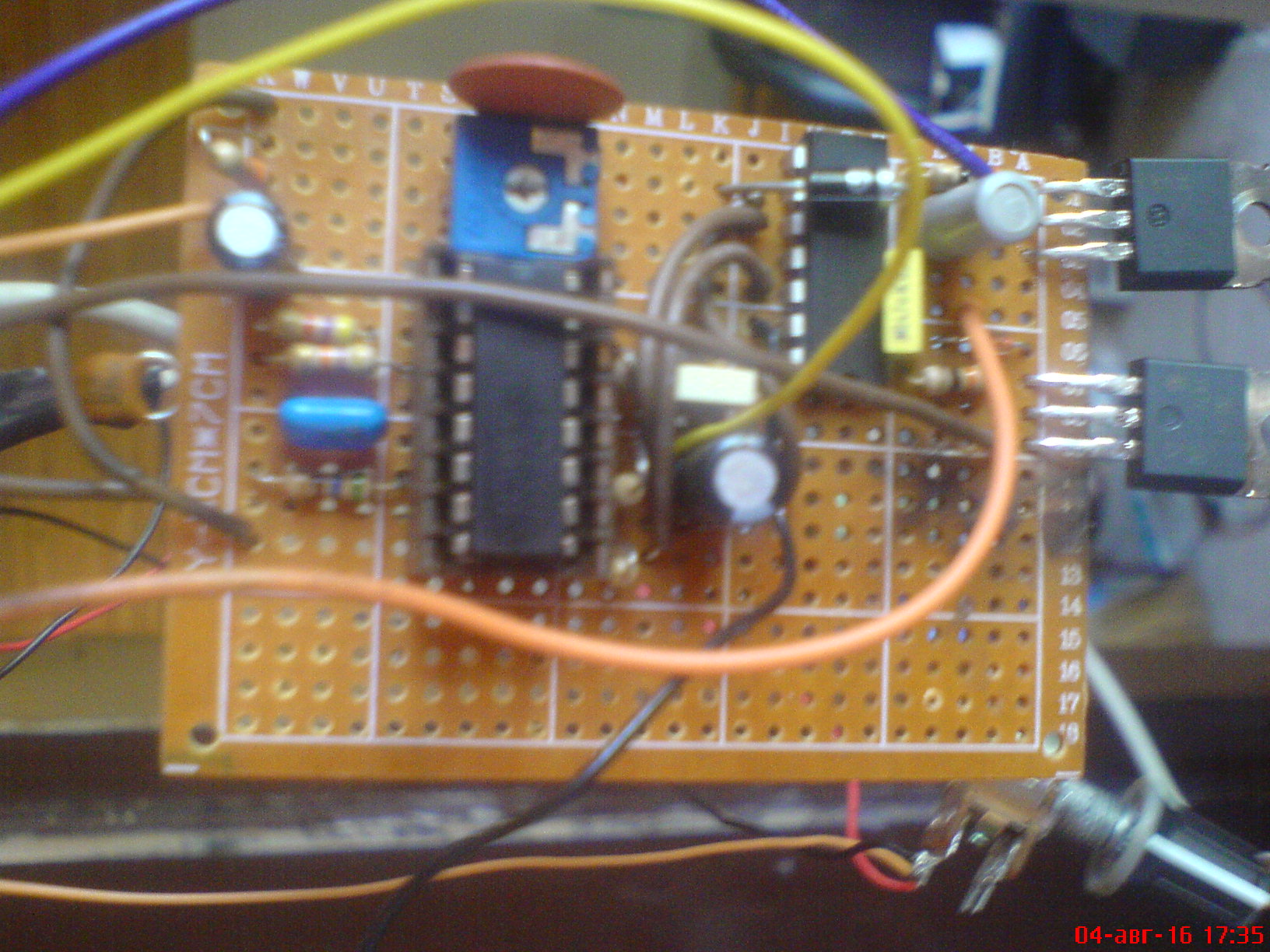

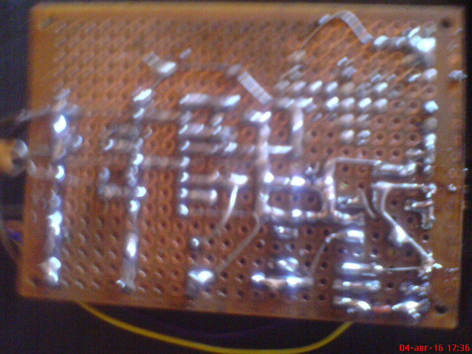

Attached is mine tl494 build which uses the "trick" but its very noisy and its not very loud. Its single supply design and im suppliyng it with 100Vdc.
And this is the biasing scheme im using ->
Thank you for encoarageing me to bias one myself.

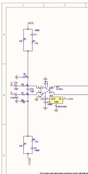

How to use the attached for half-bridge ?
Just to remove the 2nd feedback ?
I cant display this pdf on mobile.
