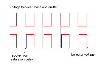

So if you do reduce output current of the TL494, by increasing the pull-up resistor, 81bas, what happens. Do you get more distortion?
You already mentioned it takes longer to recover from saturation (the bipolar transistors). But because of this increase in recovery time, what happens?
Simply try to simulate it in your head! 😉
Also, look at the picture below...
