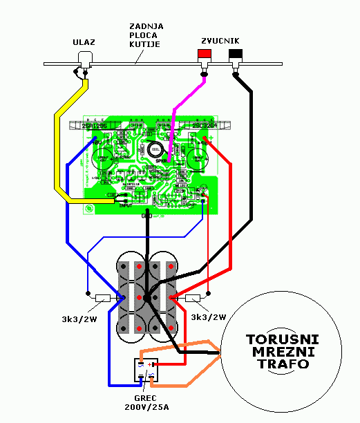

Hello,
I am interested in building a DOGC Amp by Dr. Jagodic.
Since I already have two torioidal transformes from another project (each 200VA and 2x24VAC) my question is if this would be sufficient for the
DOGC-MK3?
I understand from previous posts that recommendation for the DOGC-H would be min. 35VDC, does this apply for DOGC-MK3 as well?
Many thanks in advance!
Werner

52V should be fine. Make sure you have big enough heatsinks. DOGC-H dissipates little bit of heat.

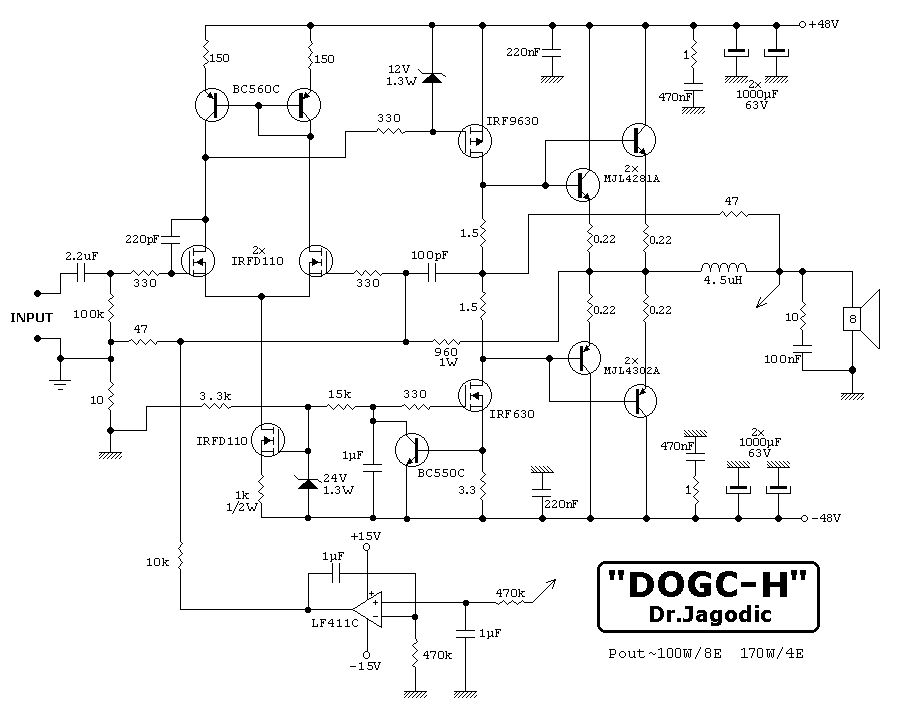

does the voltage increase from 48 to 52v x power the lf411 at 15v starting from the amplifier psu with resistor 3k9 2w , as per the diagram, does it not involve any problems? and ok also x frd110? thank you
Something isn't complete here or something isn't clear.
You need 15v zener diodes after 3K3 resistors.
Positive side cathode to 3K3 anode to gnd.
Negative side anode to 3K3 cathode to gnd.
Are those zener diodes on the amplifier pcb?
I think they are on the pcb
Kacernator,
Have you actually solved your overshoot problem in post #33,34 ?
Fir example increasing the value of the 100p capacitor ?
Or put a 1.5n FKP2 across the 960R 1W ?
Do you have a spice model to try out first in simulation ?
Patrick
I was scoping the amplifier without load and there was this overshoot. With load (8 ohms) overshoot is gone.
