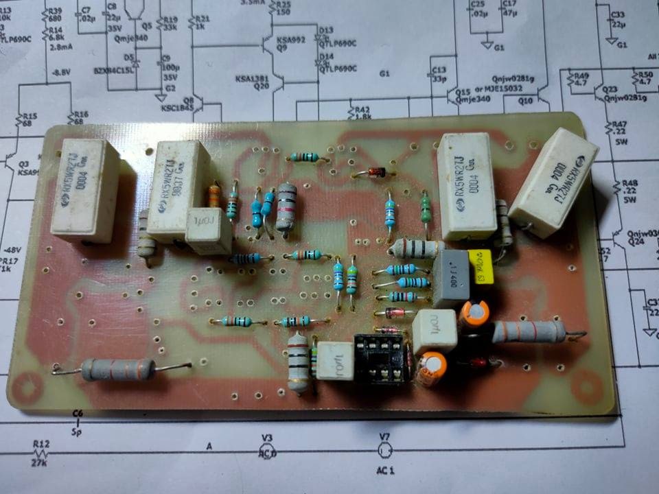

LF411 is not available online. Can you suggest and equivalent.
TL071; or TL072(dual).
OPA1611 is a good choice in terms of low noise and distortion slew rate almost
the same as LF411.
the same as LF411.
There is one 960 ohm resistor on DOGC board. Cant find anf 960 ohm resistor. Will the closest work. Say 976 ohm, 953 ohm or 1k.

that value is critical, because it forms the "bridge" together with the coil and the 120pF Capacitor. I got mine from mouser: 71-RS02B960R0FE12

I would chose 976R, with a very little bit higher gain and distortions, but also little better stability.There is one 960 ohm resistor on DOGC board. Cant find anf 960 ohm resistor. Will the closest work. Say 976 ohm, 953 ohm or 1k.
LF411, like most opamps used for DC servos, has a JFET inputs and very low input bias current.
OPA1611, on the other hand, is bipolar input.
Input bias current can be up to 250nA, compared to 5ßpA of the former.
I would suggest the likes of OPA140, LT1792, etc.
976R // 56k will give you 959R. Close enough.

A DC servo usually deploys high impedance RC network, e.g. 1µF 1M-ohm.
A high input bias current of the opamp will create a much larger DC offset than otherwise.
A FET input opamp is usually preferred with such high impedances.
Also they results in lower noise.

Hi Patrick,
thank you very much for your explanation. So I might try a FET or JFET input opamp. In my DOGC the OPA1611 does a good job with a DC-offset of about 5...10mV

Looks good. Will give it a try.
